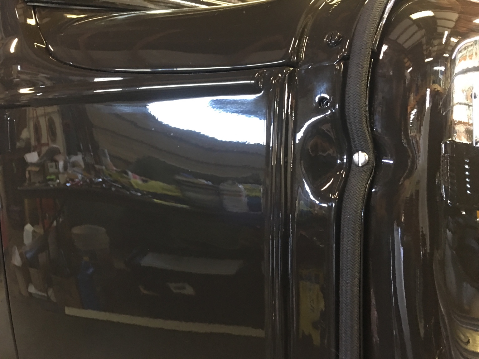

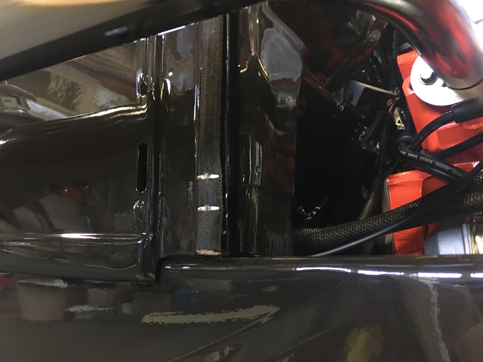

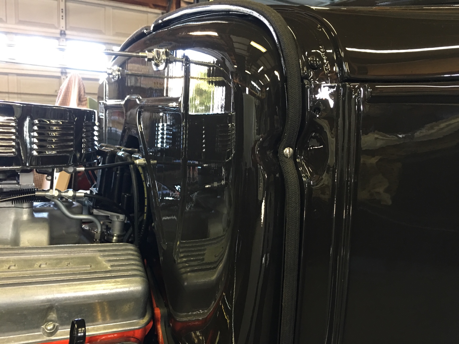

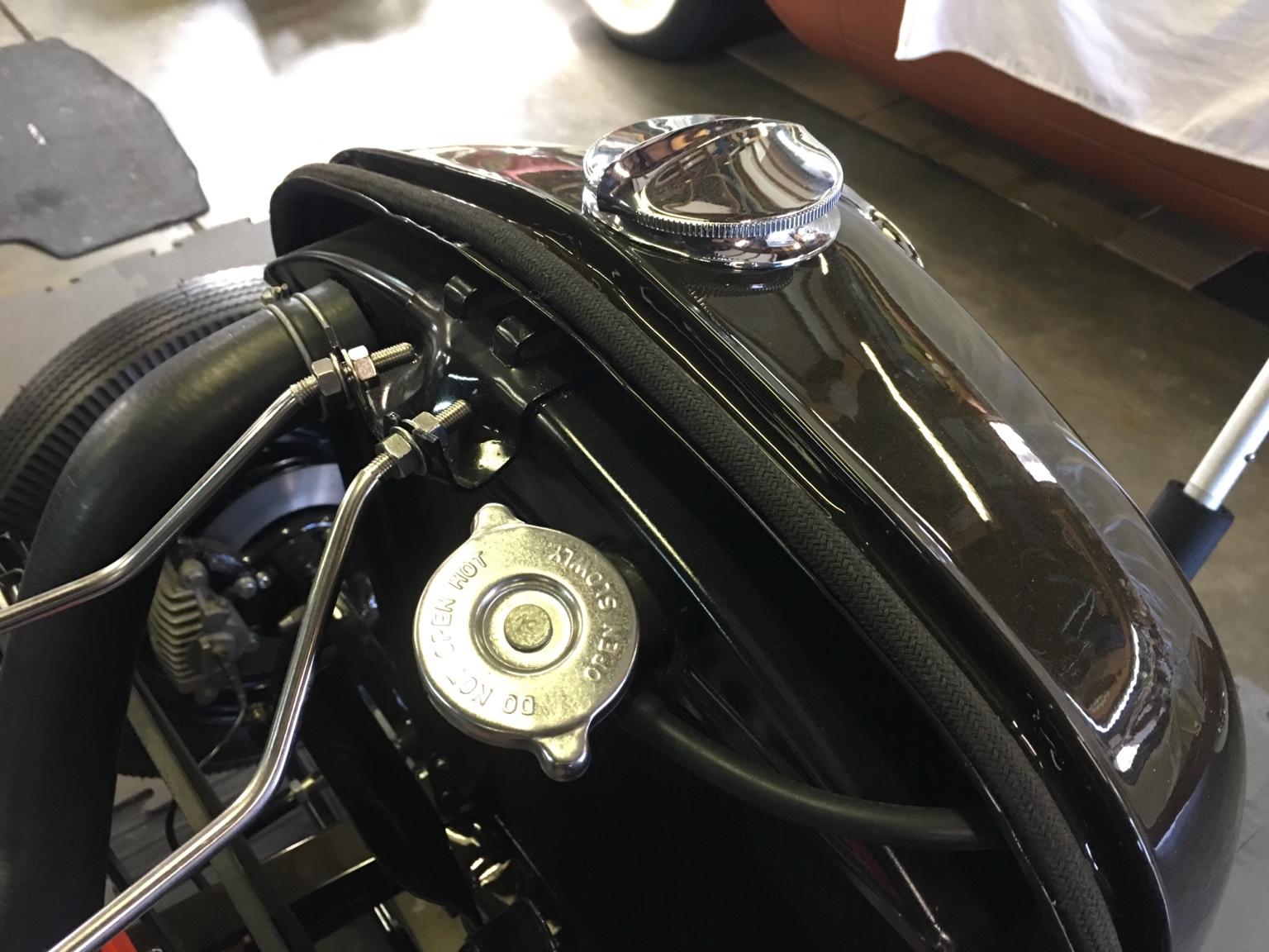

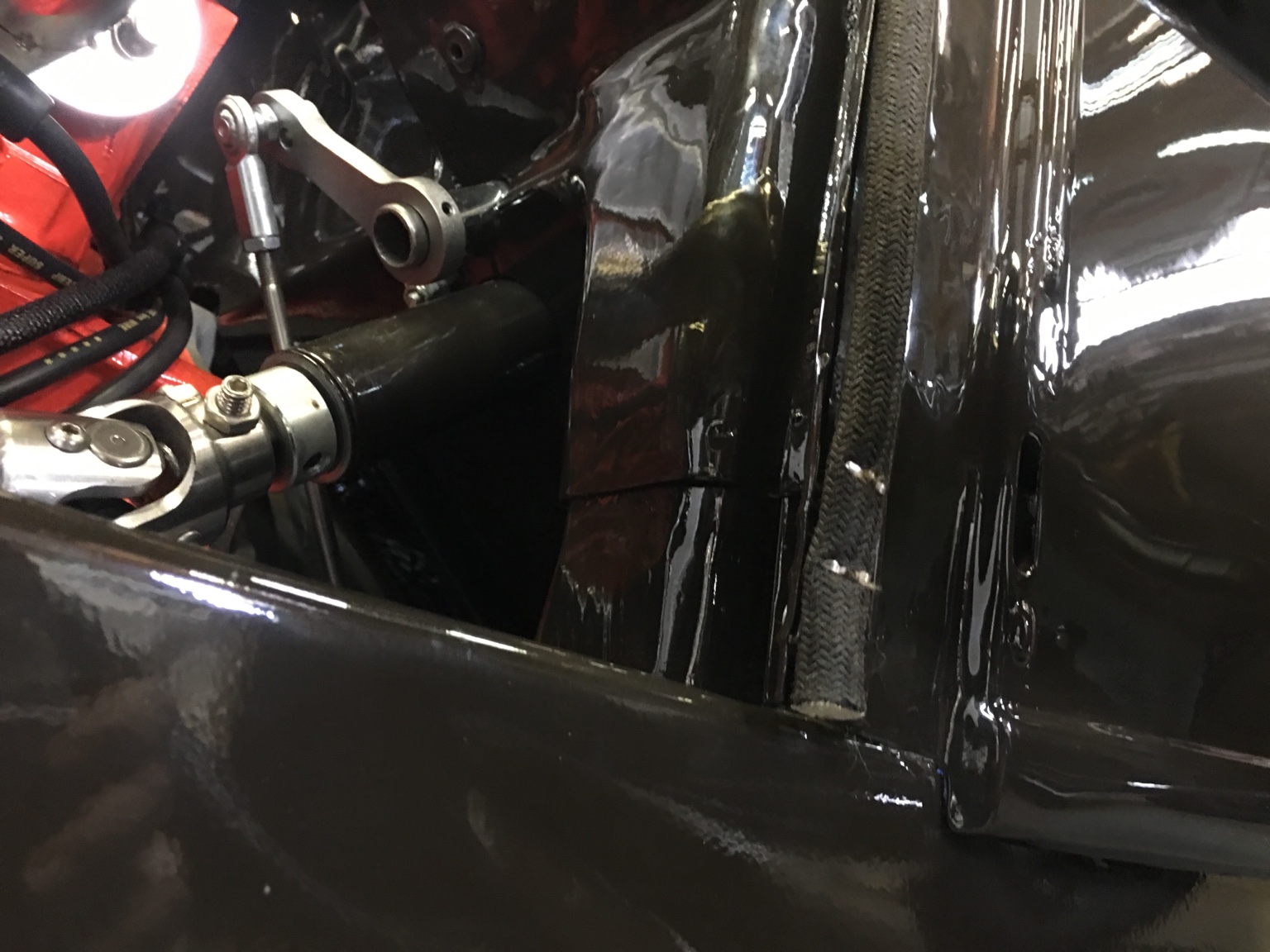

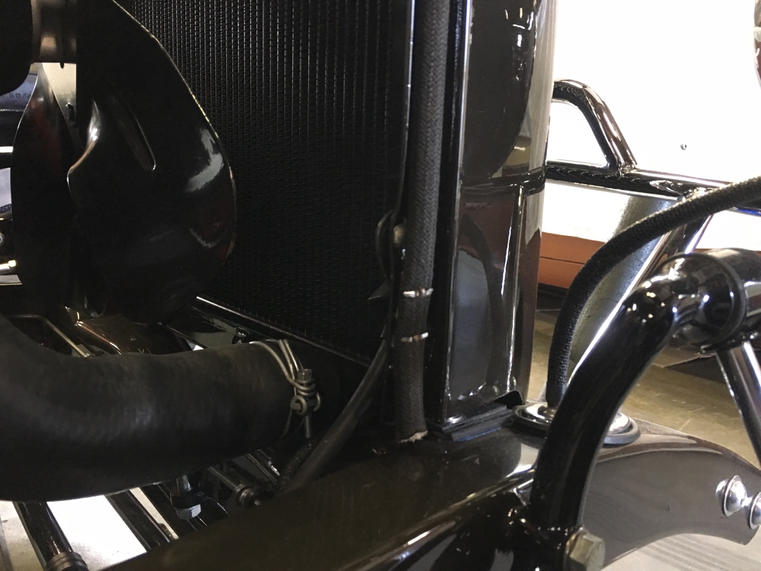

    Would you care to take a couple of pics where it attaches to the cowl and shell bottom ?
    I ordered the lacing kits from Synder's
    Thanks in advance !!
  6. HelmuthBrothers
    Joined: Oct 11, 2007
    Posts: 789
    HelmuthBrothers
    from New Jersey
    Yeah no problem. I'll post them tomorrow.

    awesome !!!!
    thanks !!! Looks killer !! Beautiful car

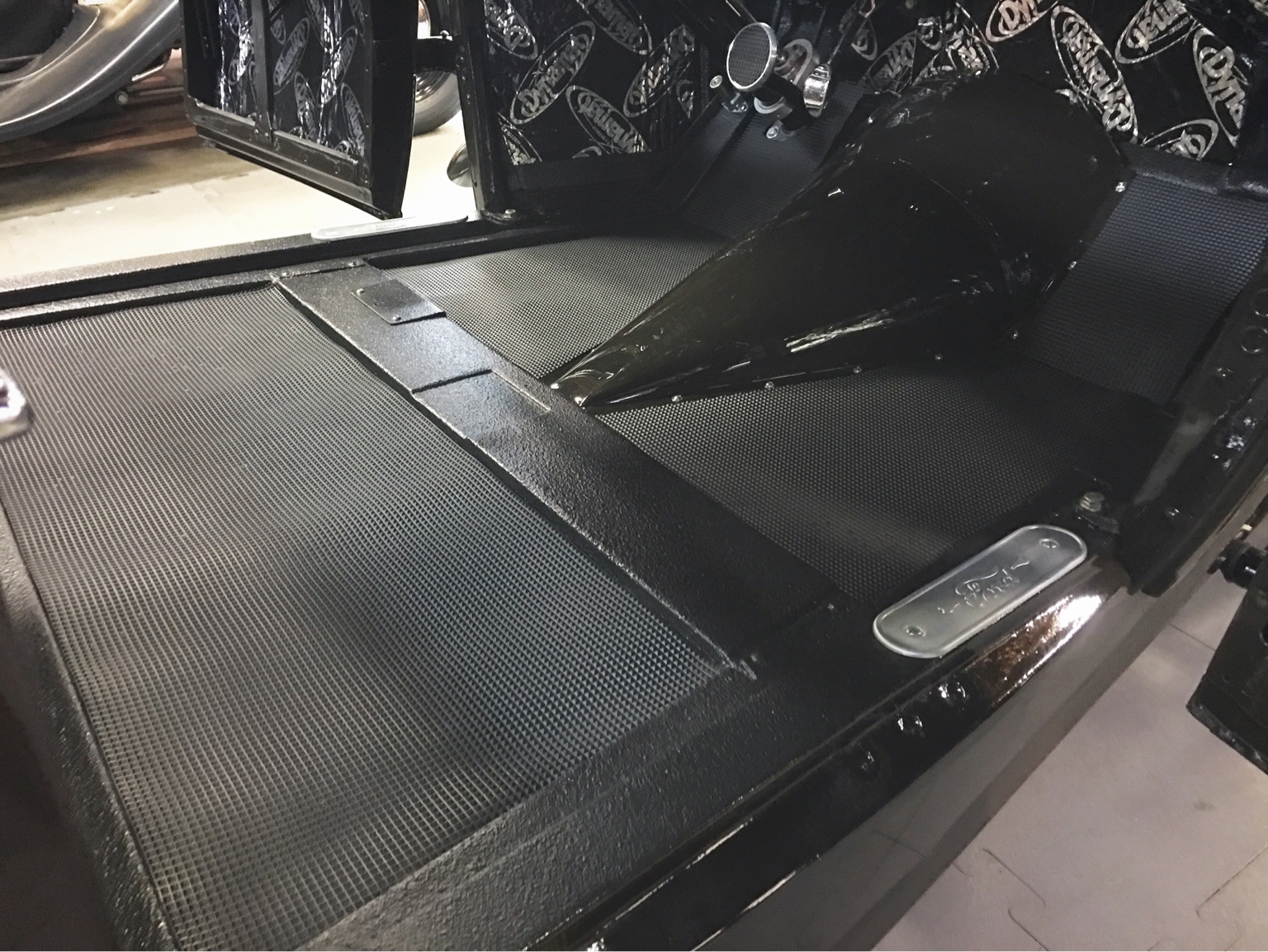

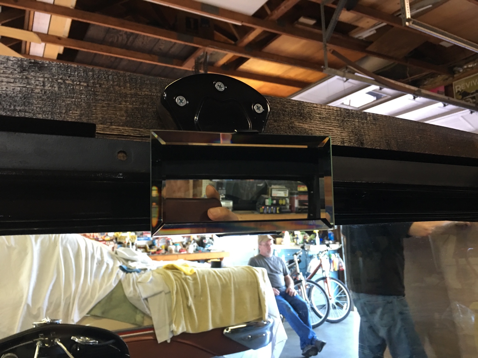

    We were suppose to have the soft tip from Labaron Bonny Friday to install on Saturday but it came a day late so we were only able to tinker with the car. Installed the mirror and made a spacer for it since we're bolting it right to the wooden header panel. Finished up some more insulation and fit the rubber floor panels to cover the dynamat.

    Beautiful coupe. Where did you get the rubber mat for the floor? Thanks
  11. HelmuthBrothers
    Posts: 789
    HelmuthBrothers
    from New Jersey
    Thanks a lot. Got it from eBay actually. It's pyramid running board mat.

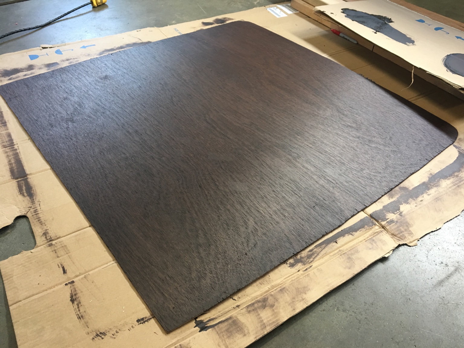

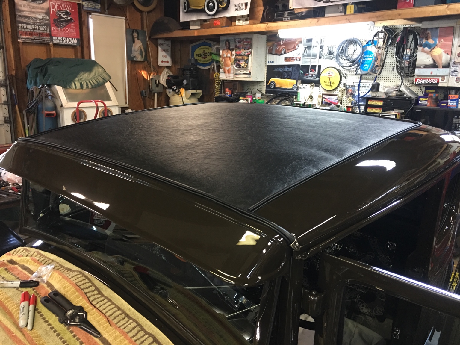

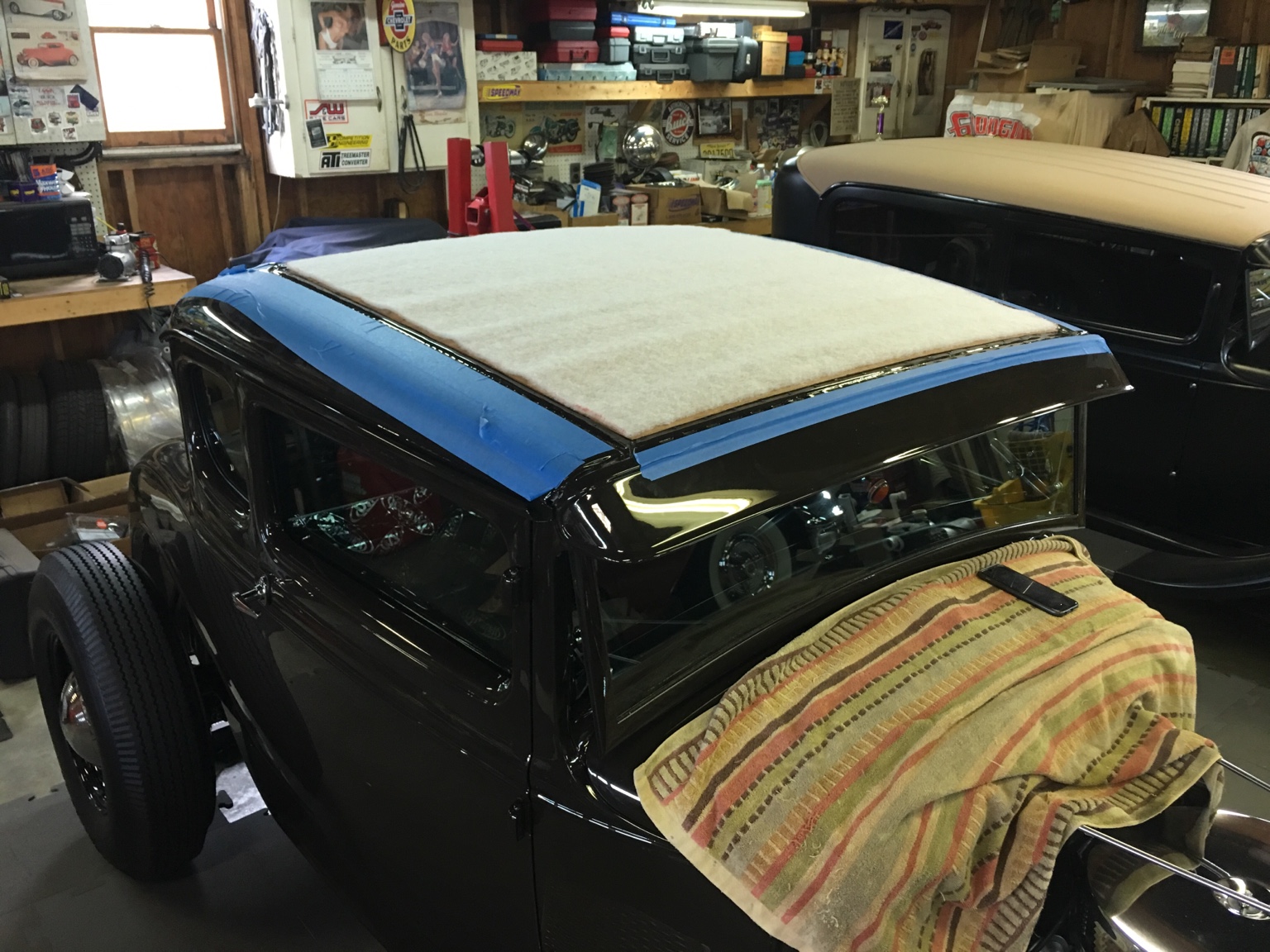

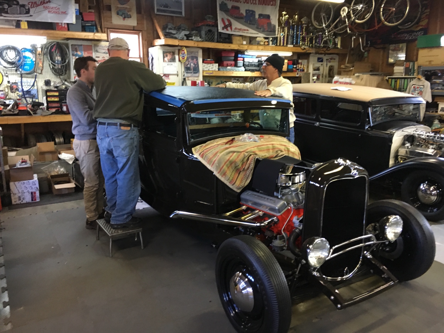

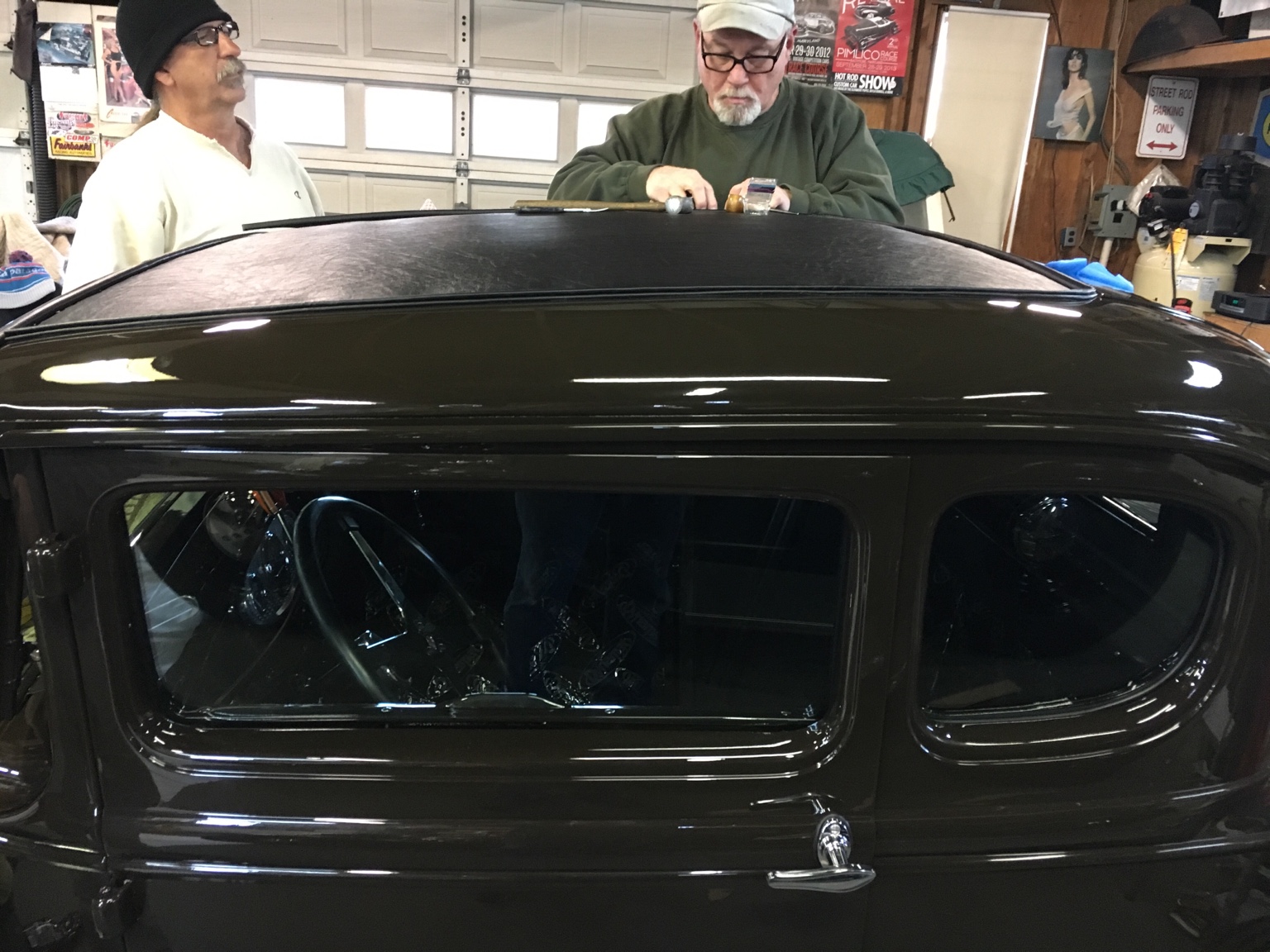

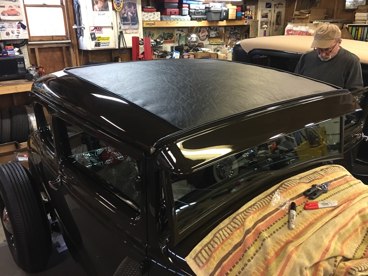

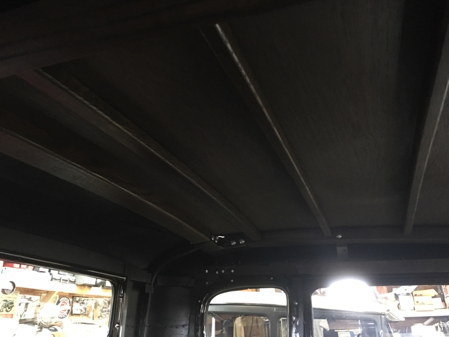

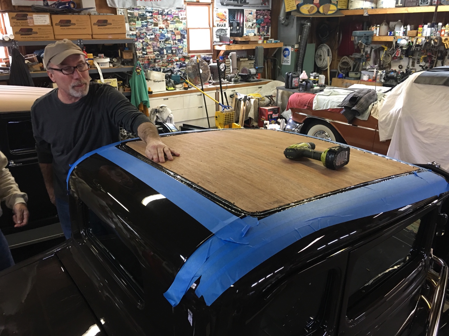

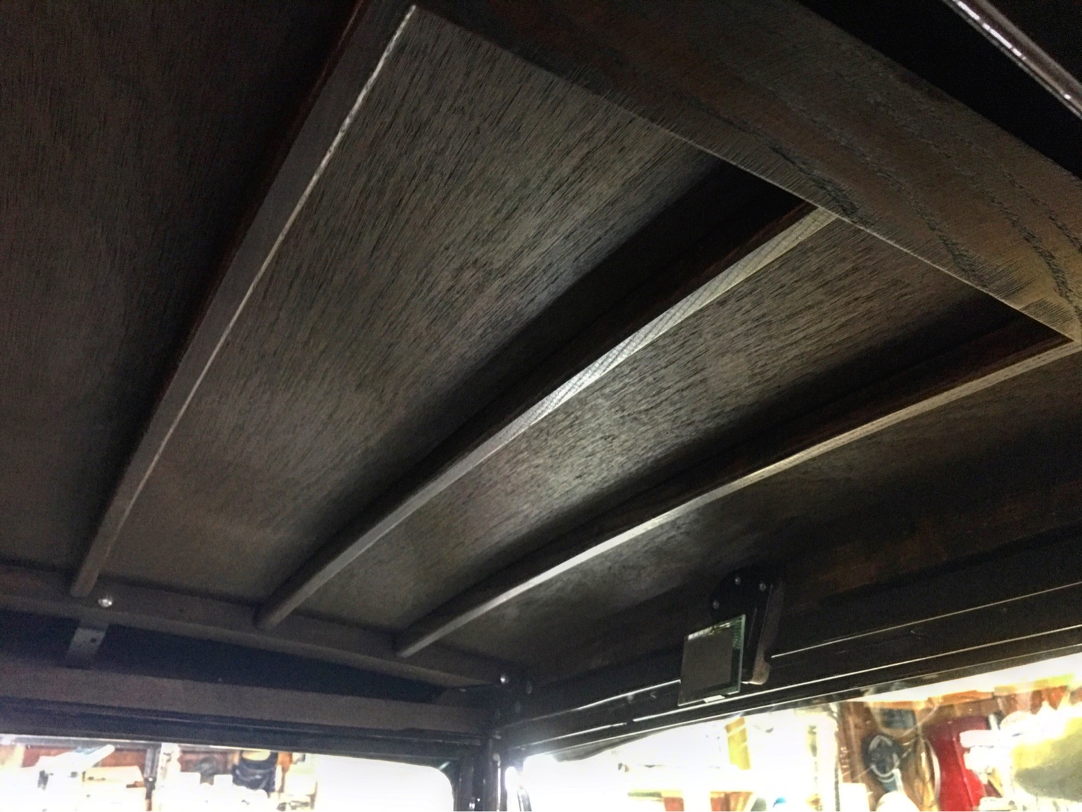

    Today we installed the soft top. We've never installed one before, so there was a little guess work. Bought the kit from Labaron Bonney, but asked to swap out the long and short grain fabrics in favor of the colonial grain as seen on Cory Taulberts 32 5 window. We also ditched the chicken wire and denim steps and laid down some 1/8" pine. We laid down some 1/2"x1/8" felt adhesive padding between the ribs and the pine sheet to buffer any noise. I stained it to act as the headliner in the car, so when you look up it's all stained wood. Really happy with the results. Once the sun bakes it some of the wrinkles should smooth out.

  19. Hurley50
    Joined: Feb 3, 2012
    Posts: 604
    Hurley50
    from NC
    love the wood stain on the underside of the roof, nice detail!

    Nice lightweight good looking headliner good thinking. Coupe looks good next to it's brother sedan.

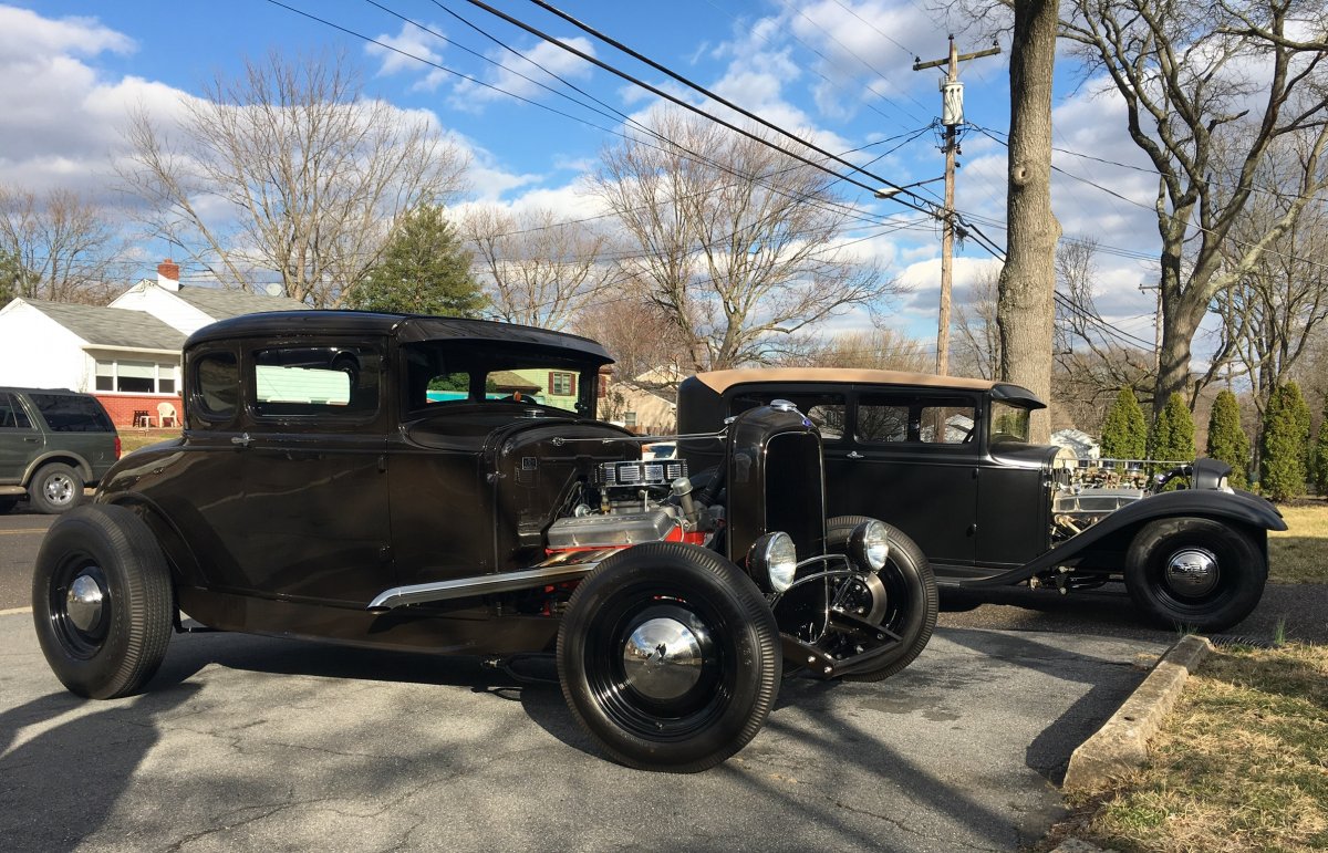

  22. Very nice, should be on the road in the spring?

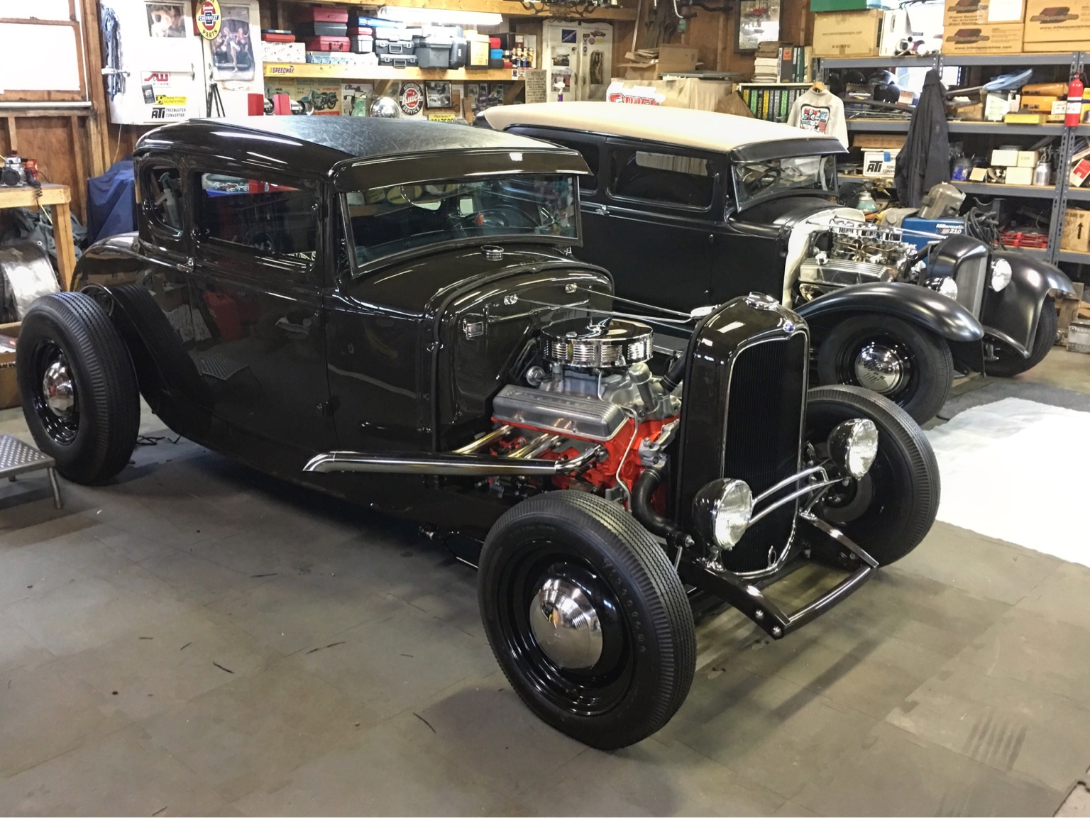

    Maiden Voyage! Yesterday was a sunny, exciting, nerve-wracking, FREEZING COLD Sunday. We have a blizzard on our tail today, so yesterday was the only day we had an opportunity to take this thing out for its first drive. Its insured, but still waiting for the registration. Took it around the block a few times and we couldn't be more happy. It was everything I'd hoped for, plus more. I'm still in shock we actually drove it. What a weird feeling. Only need to address a few issues and its on its way to the first highway trip. Enjoy!
