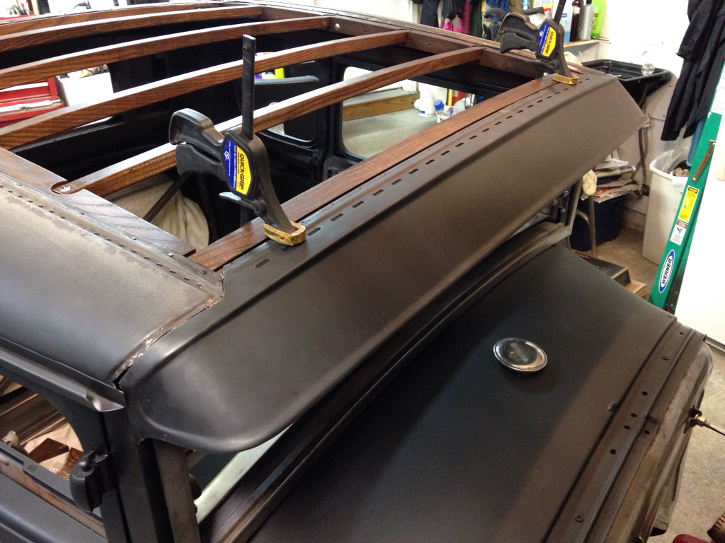

    Slow progress but got the visor fitted and my air condition all together. Onto mounting the seat.

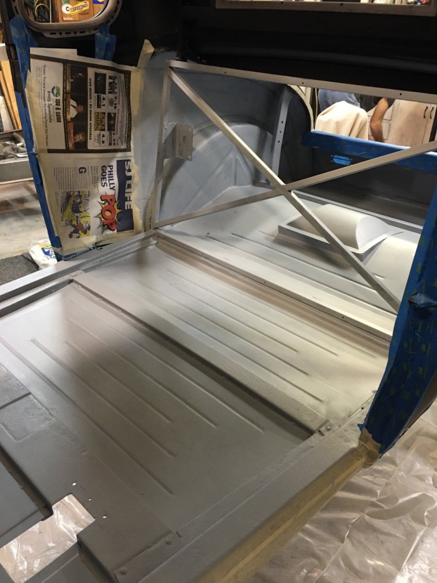

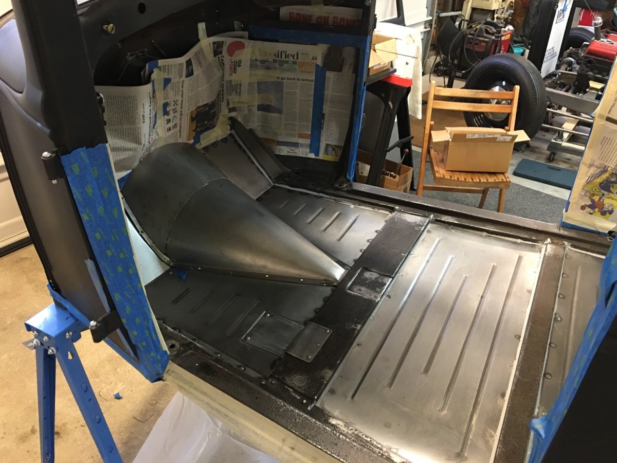

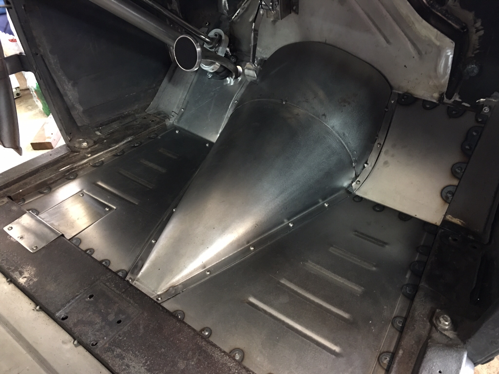

    Finished up shaving the firewall, welded up the front floor pans, and bolted down the trans tunnel. Ready to break it down the paint under the car and plumb the brake lines.
  5. The37Kid
    Joined: Apr 30, 2004
    Posts: 32,548
    The37Kid
    Very nice! I like the detail work, like taking the time to roll the beads in the inner firewall section. Should look great in paint! Bob

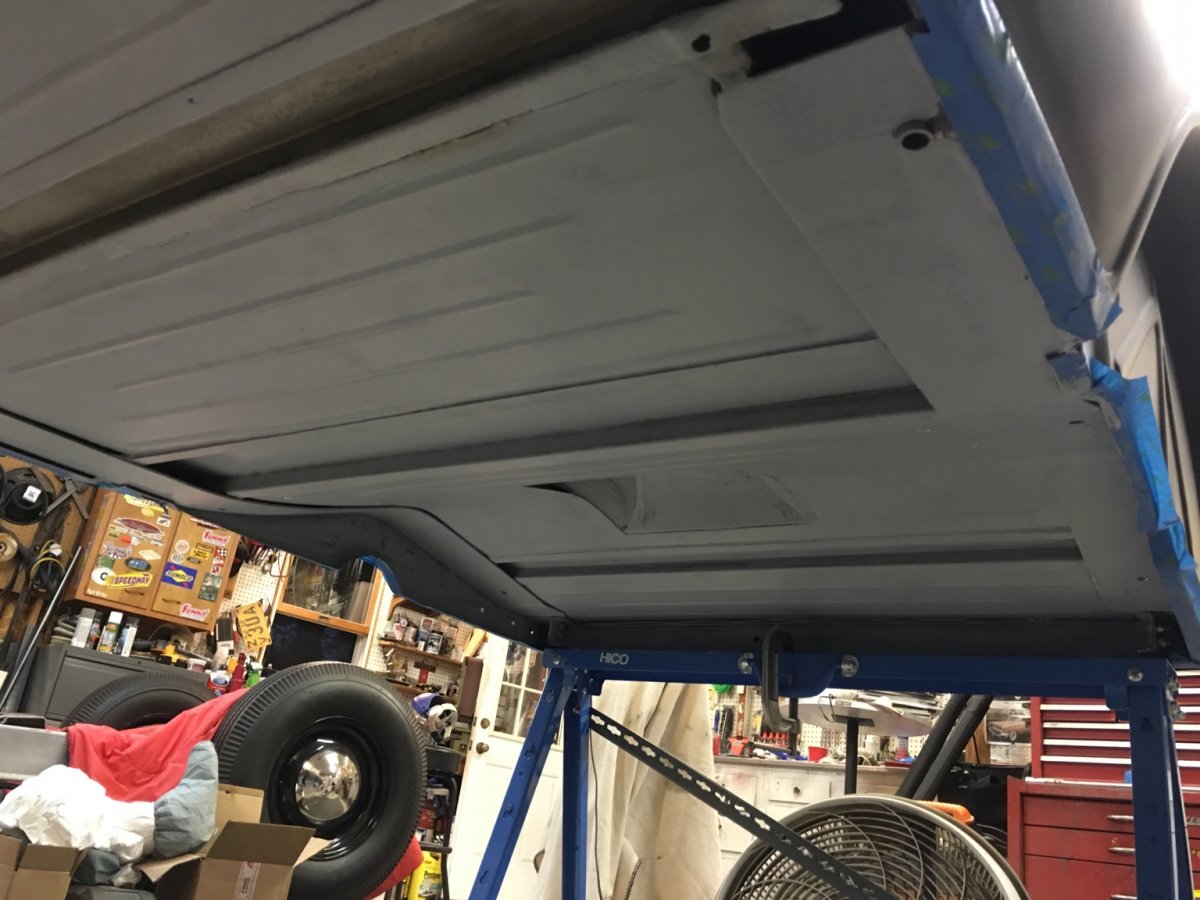

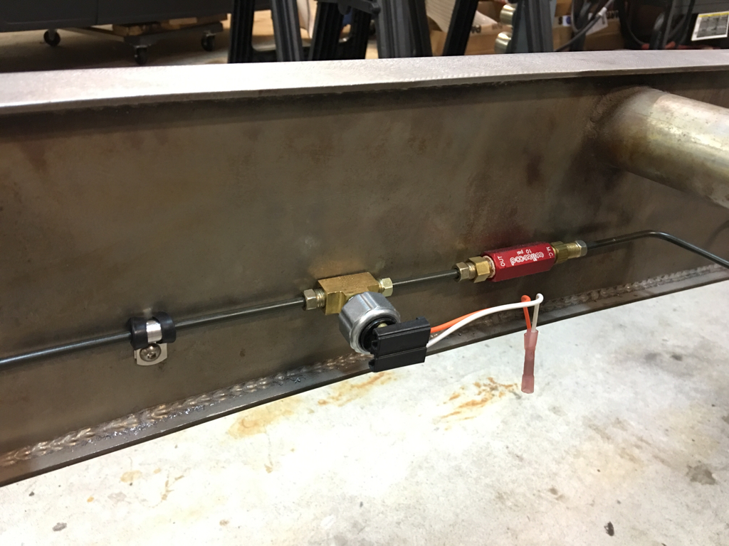

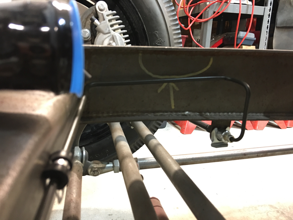

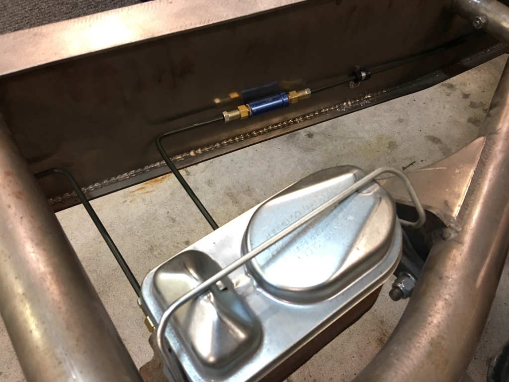

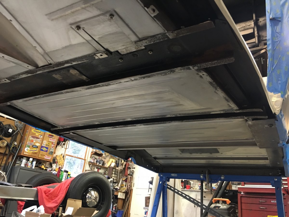

    Pulled the body back off to prep it for paint. Going to start spraying the underside and inside floor pans. Banged out all of the brake lines. Just waiting for the trans cooler to come in to finish the trans lines. Capped the frame rails out back.

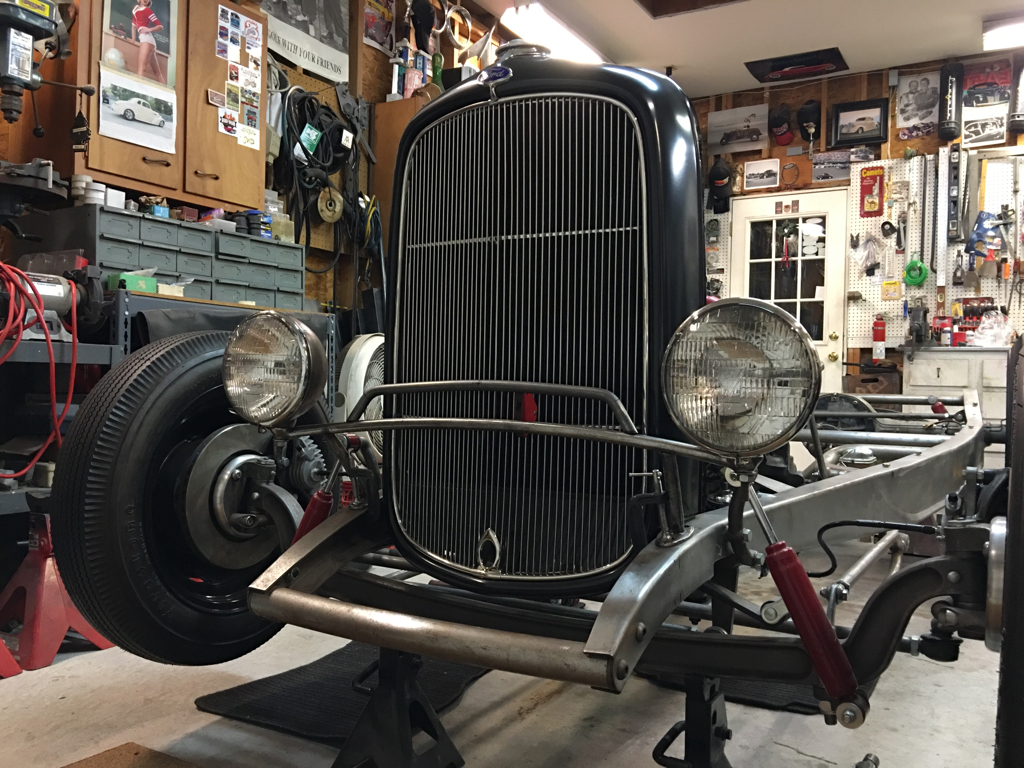

    Banged out a little nerf bar tonight out of some 5/8" solid rod and a harbor freight pipe bender. I'm pretty happy with it. Chroming the headlight bar.

  13. loudbang
    Posts: 40,347
    The double bars look good.

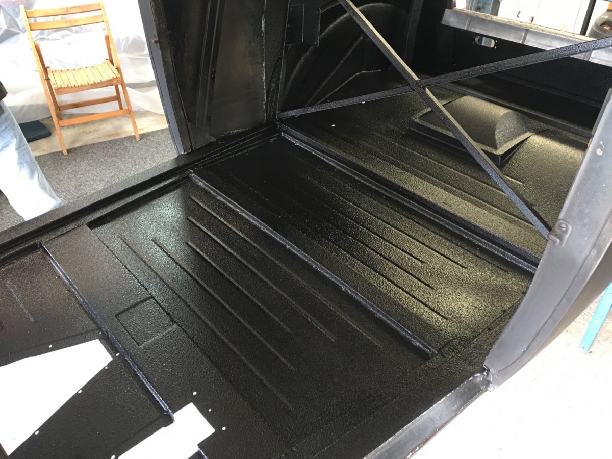

    Prime time and then liner time this weekend

  23. 19Eddy30
    Joined: Mar 27, 2011
    Posts: 4,043
    19Eddy30
    from VA
    Very nice build ,
    BUT do away with the Brake pressure switch!!

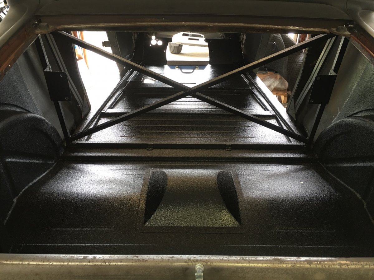

    All raptor lined up. Terrible lighting but I'll get better pics down the road.

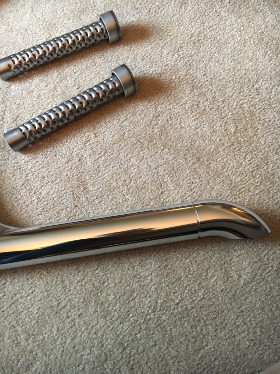

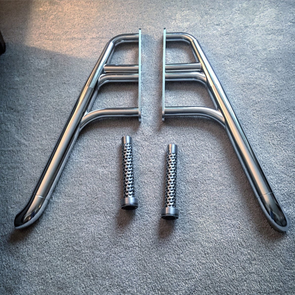

    While the frame is getting painted right now I was able to start ordering engine parts. First on the list were headers. I ended up ordering the flash chrome finish driveshaft style headers with inserts and baffles from gear drive. Completely knocked it out of the park. Super excited to see these on the car. Yes the flash chrome finish is not perfect because of the minimal metal prep that goes in before they dip these, but it basically resembles old chrome or new hardware finish. Perfect for my car and what I can afford.
