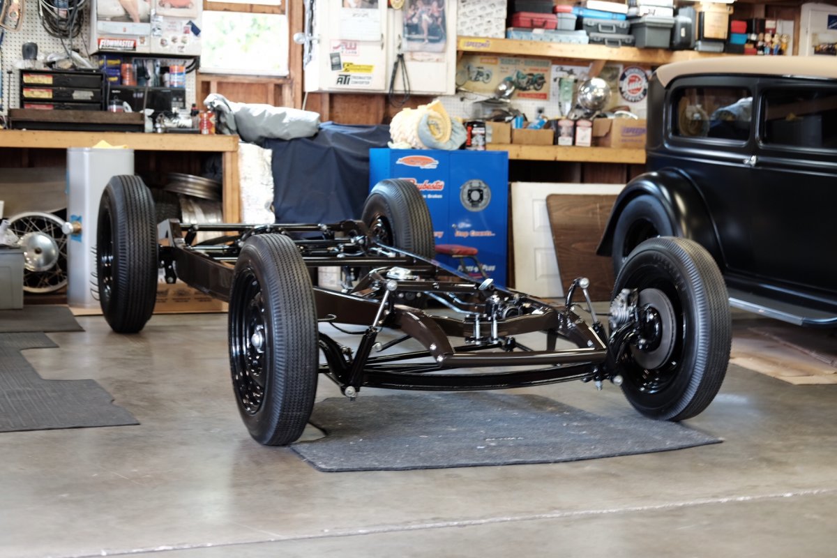

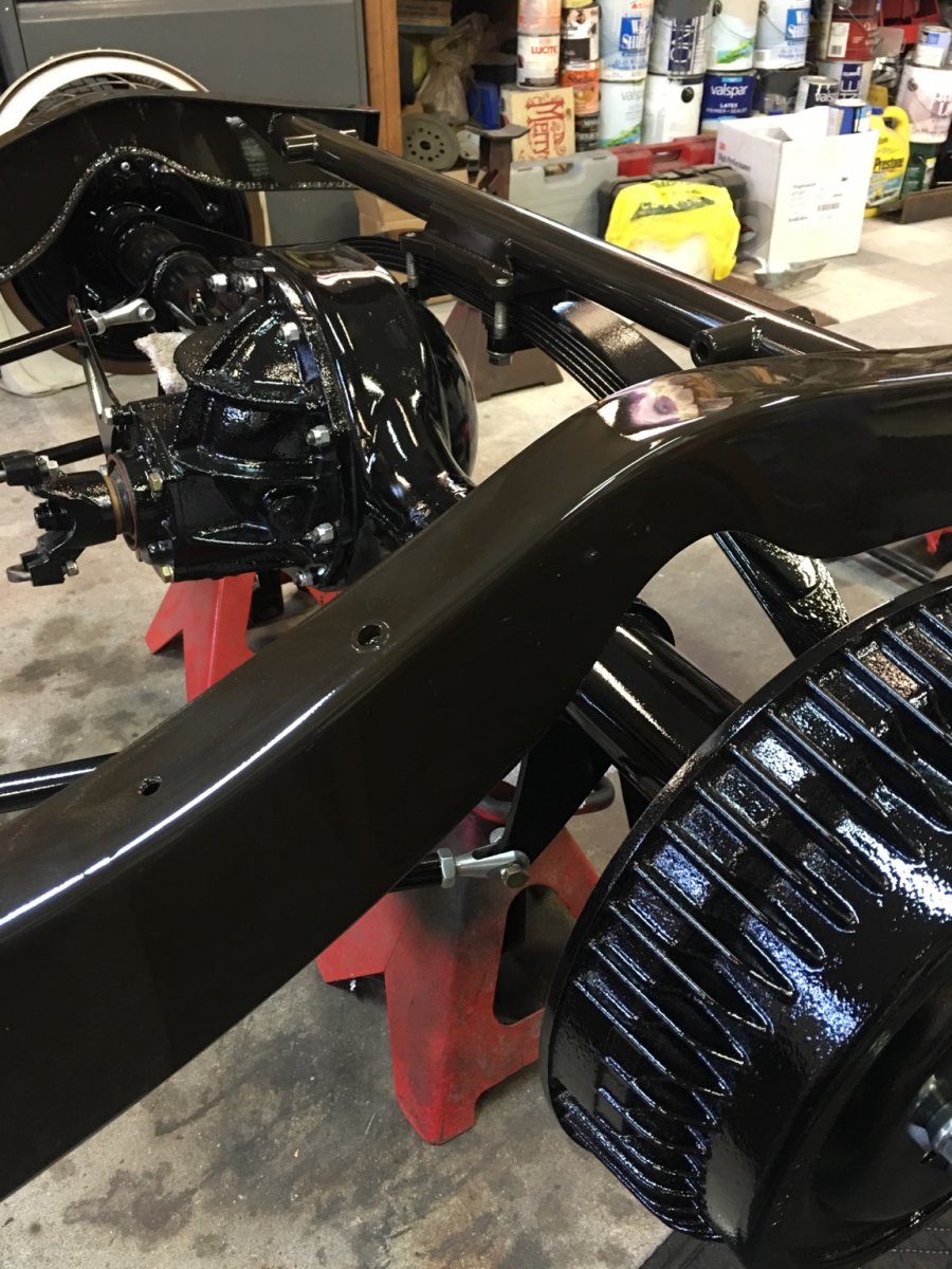

    Some exciting updates. Dropped the body off to get painted today and took home the freshly painted frame. Super hard to take photos of this color. It's basically UPS brown but it looks green under florescent light, brown in the sun, and black at night. ***embling the ch***is back together right now and will post more pics as it comes together.

    So exciting to see things come together! I like the frame color. very subtle.

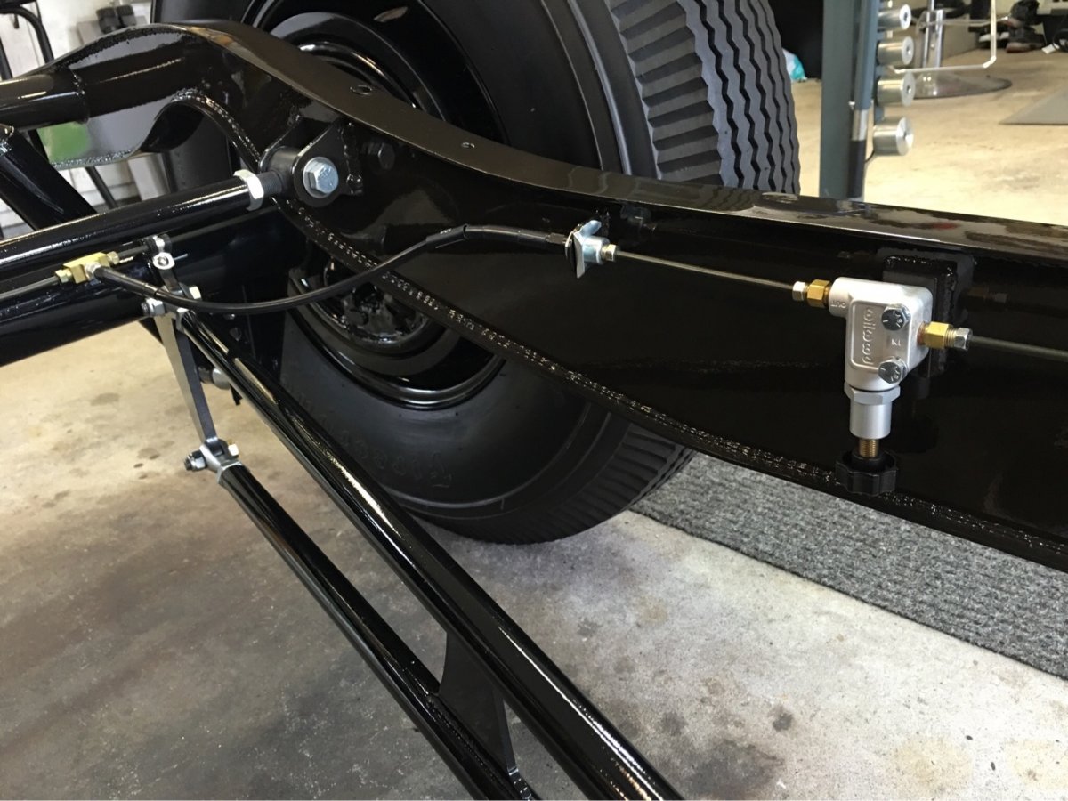

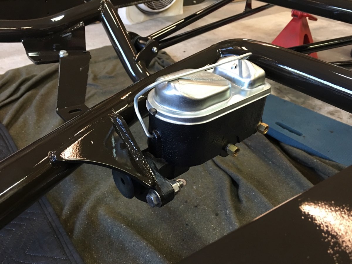

    She's a roller! Brake and fuel lines are all back on. Love it. Engine and trans next up. Can't wait to hear it run.

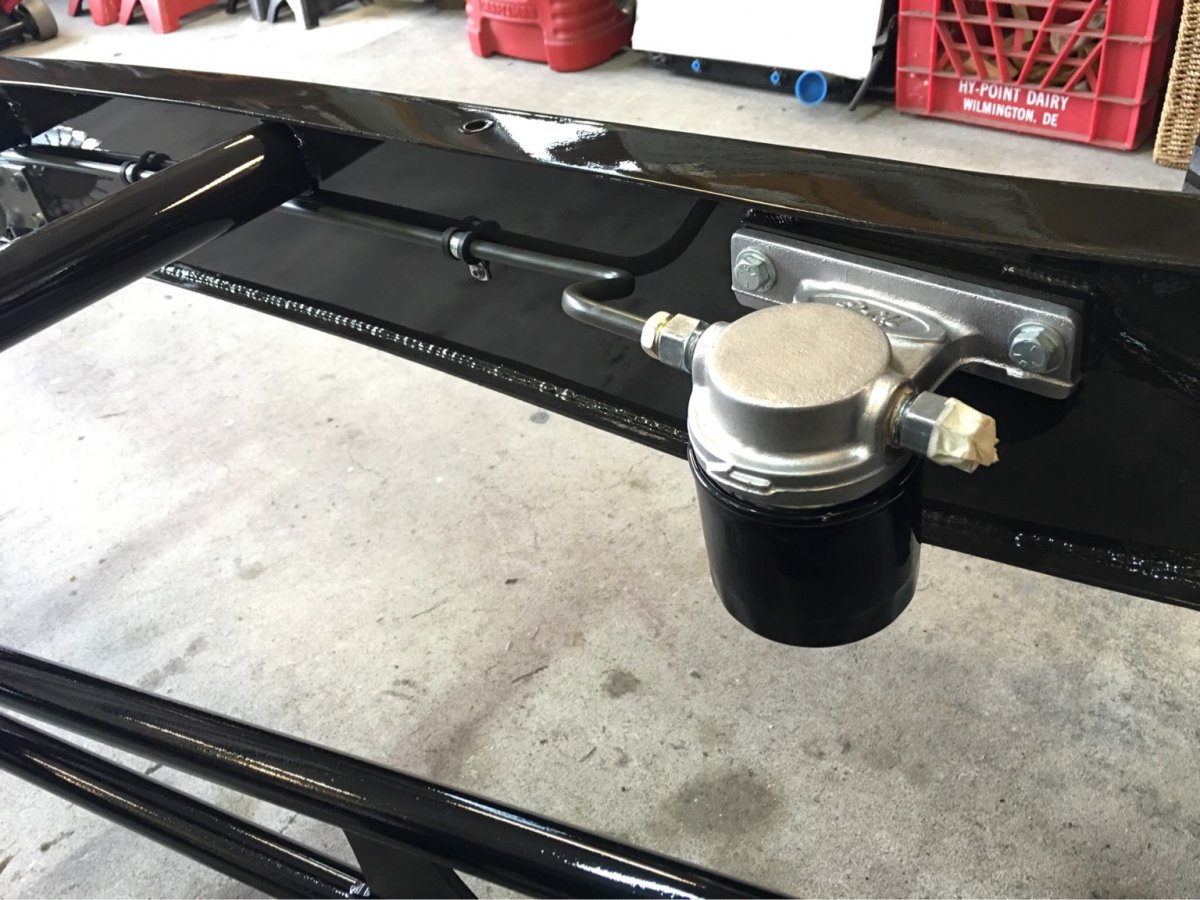

    If you don't mind, what fuel filter is that?

    Yeah no problem it's a setup made by SoCal that bolts directly to the inside of their 32 step boxed frame frame. I'm not exactly sure the type or model of the fuel filter though. This is the link to the part - http://www.est1946.com/so-calfuelfilter.aspx

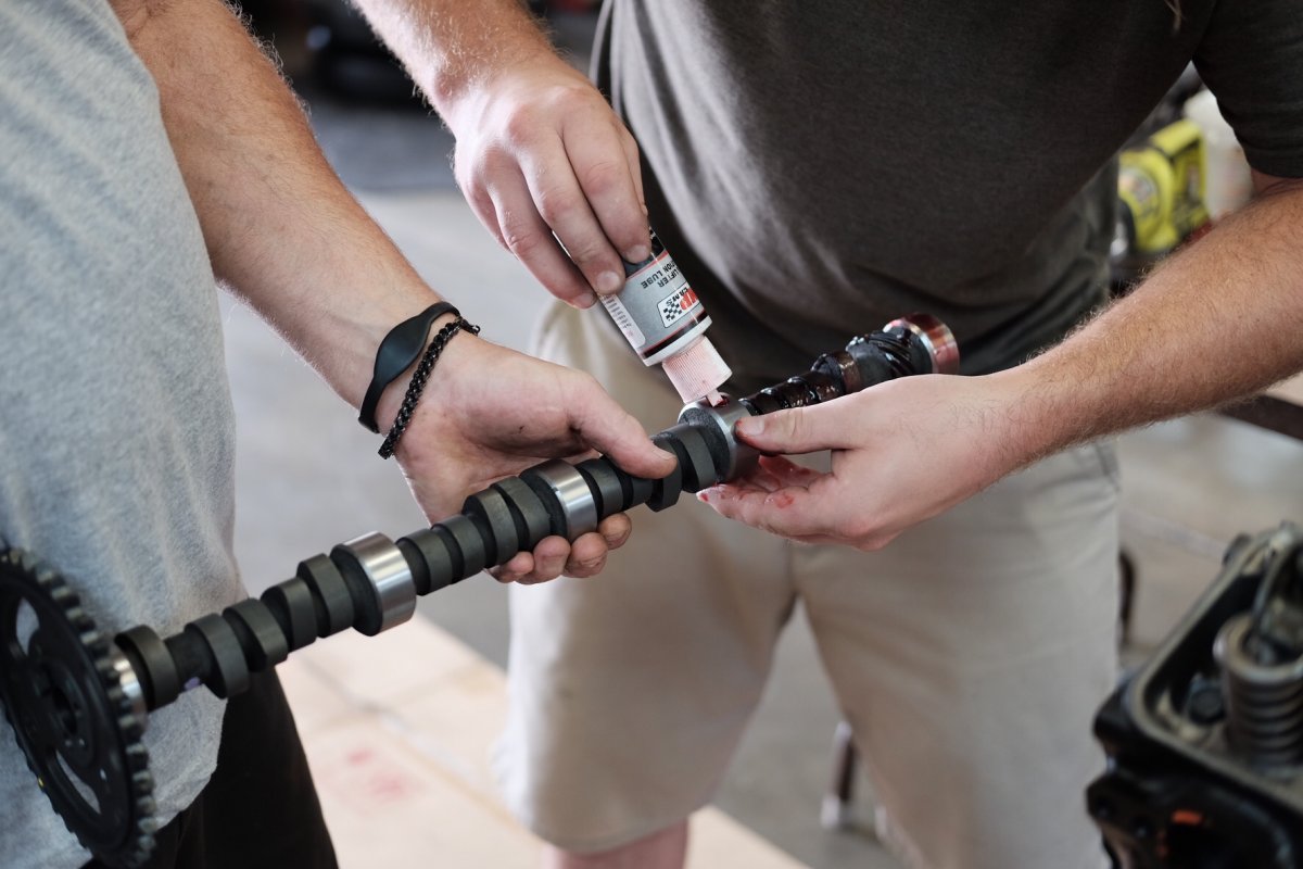

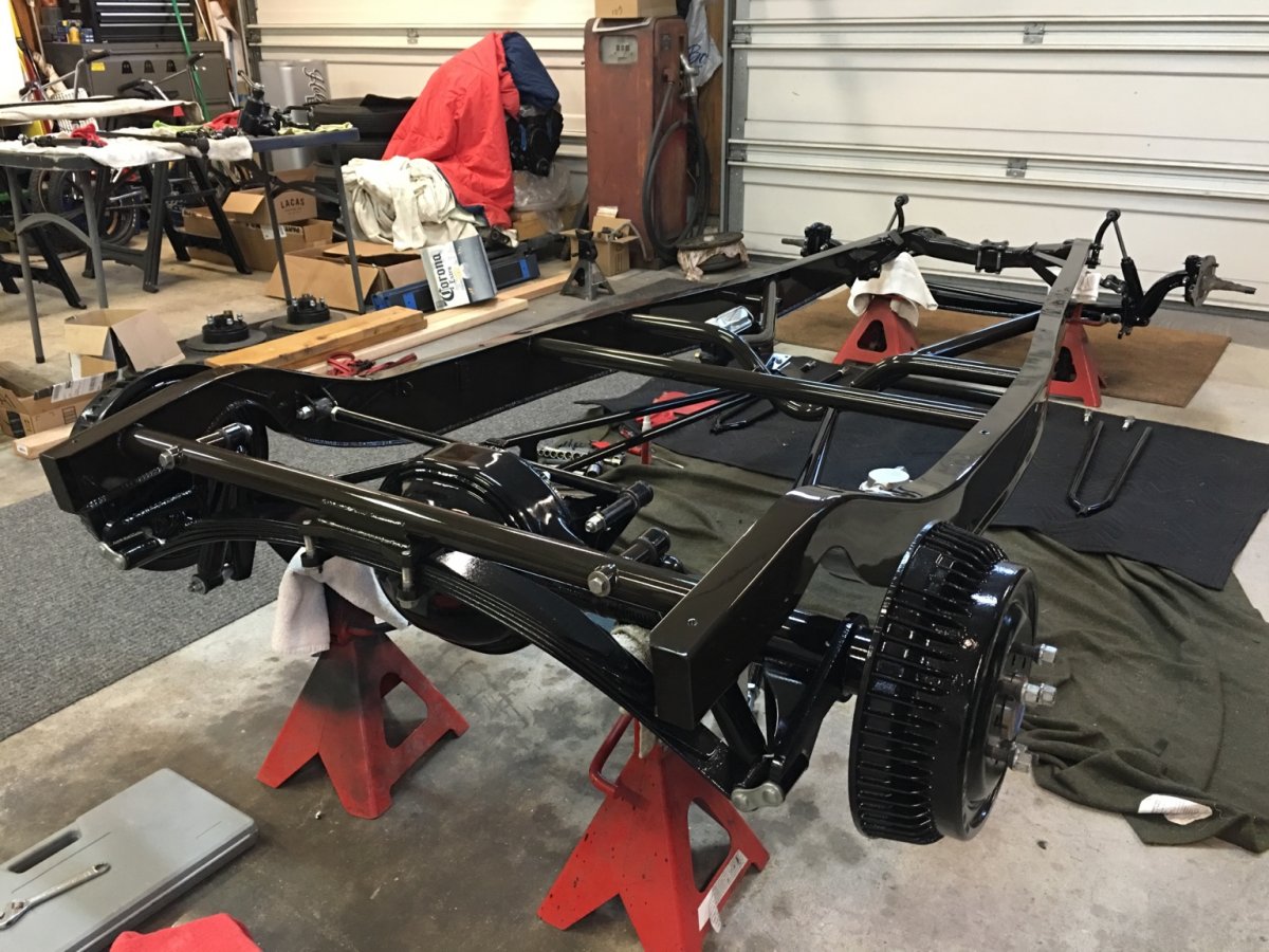

    Some updates. Moved the ch***is, engine / trans, and a ton of boxes of new parts over to my uncles shop to finish the car. Still waiting for the body to be finished getting color but we can get this thing running now. Got the engine ripped apart to install a flat tappet thumper series comp cam, and installed some felpro gaskets on the oil pan and timing chain cover. This week I'll get some paint on the engine and get it ready to mate to the trans.

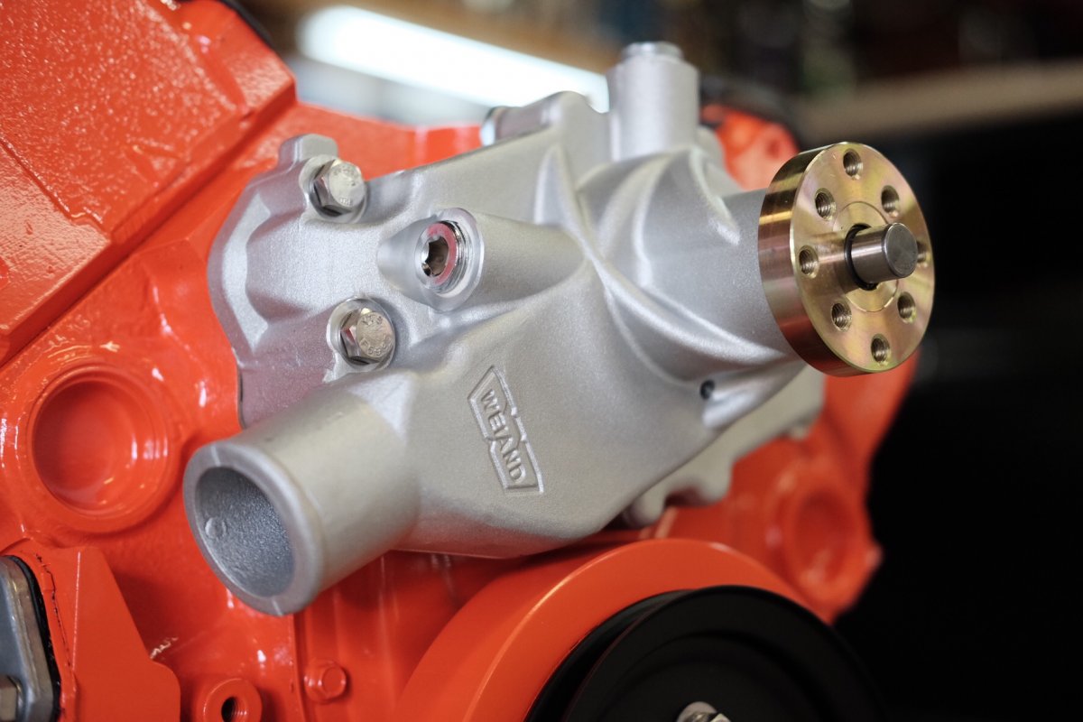

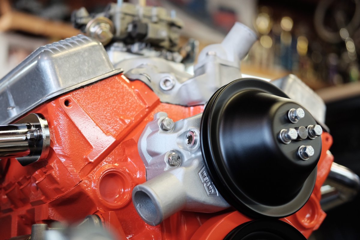

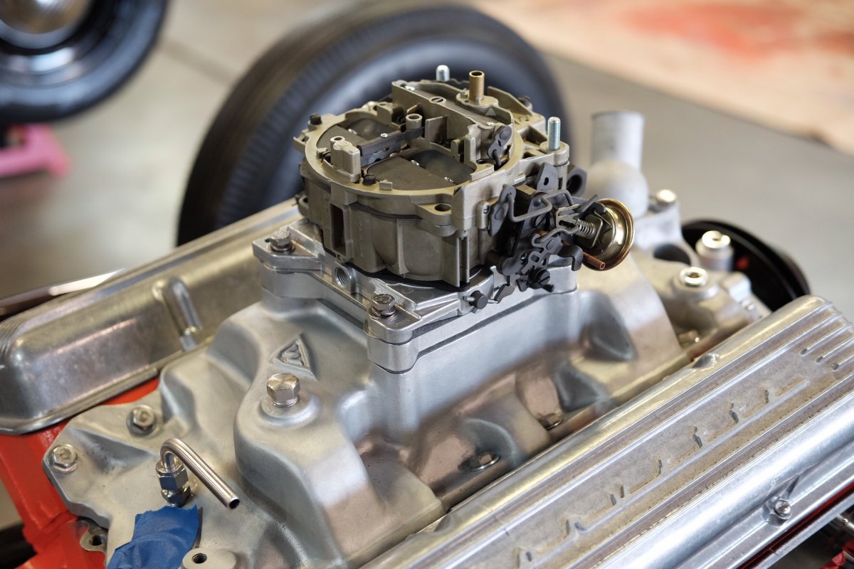

    Some good updates this weekend! Painted the engine factory Chevy orange, mounted it to the fresh 700r4, dropped it into the frame, and started bolting **** up. Got the aluminum corvette valve covers early 60s Weiand WCVSQ aluminum 4 barrel intake, weiand water pump, factory fuel pump, early 60s corvette aluminum thermostat housing, rebuilt early 60s QJet and some Geardrive flash chrome headers. Super excited to see this engine to come life. It's been in my head for so long and now it's right in front of me. I'm really happy I painted it orange. It pops against the chocolate brown and all of the aluminum parts. Only need a few things to get it running. Hopefully get to that next weekend. Here are some shots of where we're at right now.
