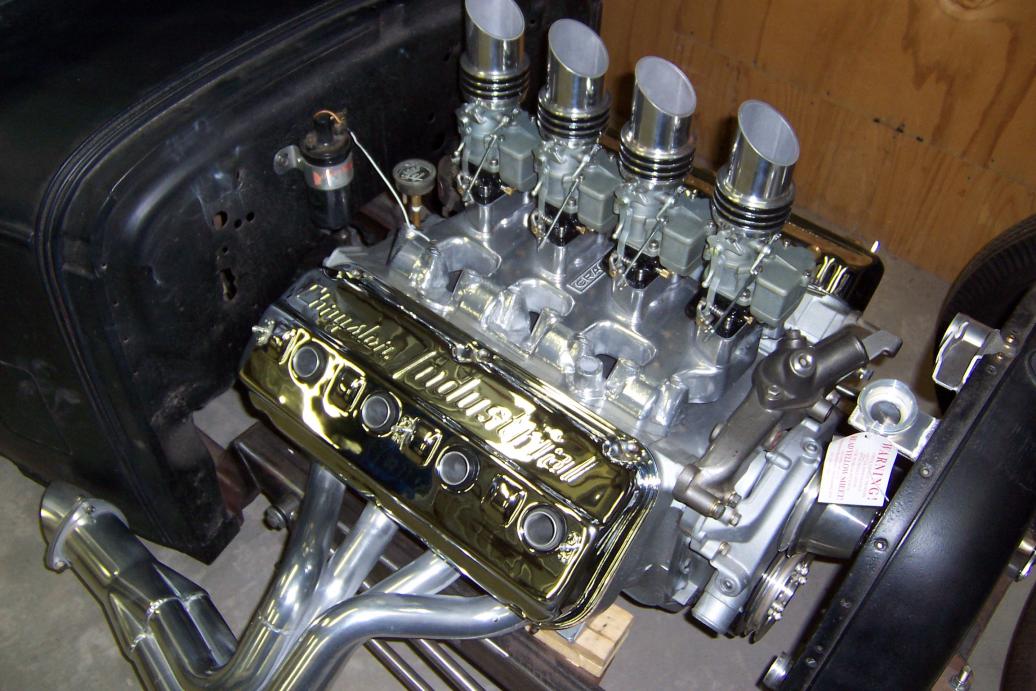

    Here's my newly chromed industrials

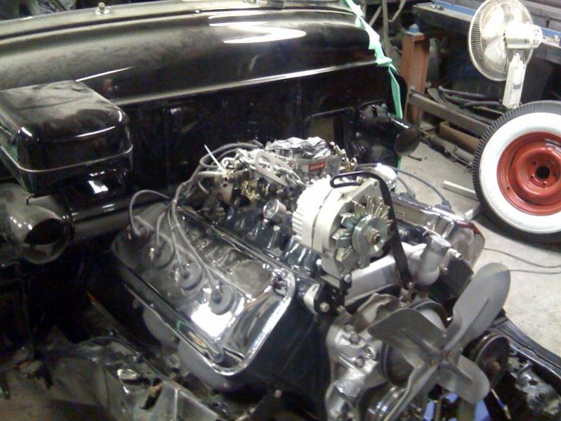

    Here's mine. Looks like I need to do something with those plug wires...

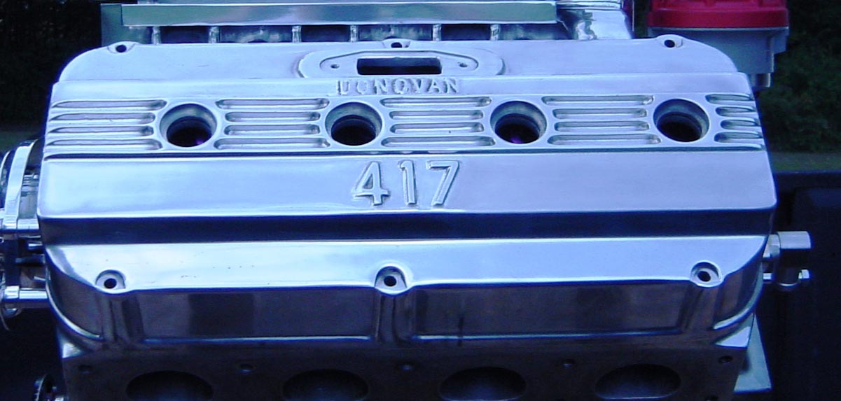

  28. Here is a set that I don't think are on here as of yet. I spent almost 3 years looking for a set - couldn't even find a picture of them, let alone a real set. Somebody finally convinced Donovan to recast 6 or so sets of them to help restore some cacklefest FEDs - I managed to get my name onto the "list" and got a set. When they arrived - I was like a kid with his first minibike at XMas.
    They fit the 417 head profile exactly right - much better than anything else I've found. This engine will be in my 34 coupe sometime next summer . . .

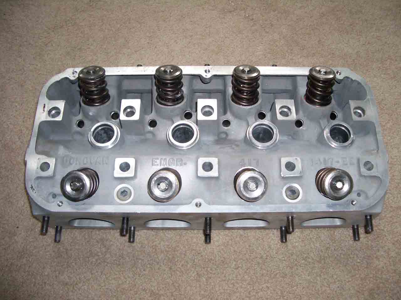

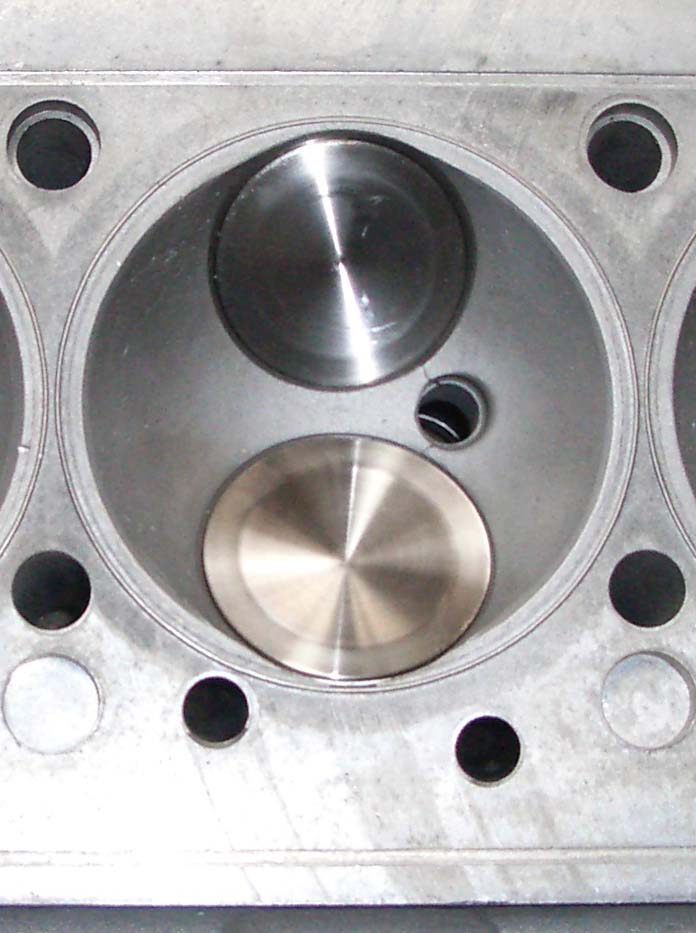

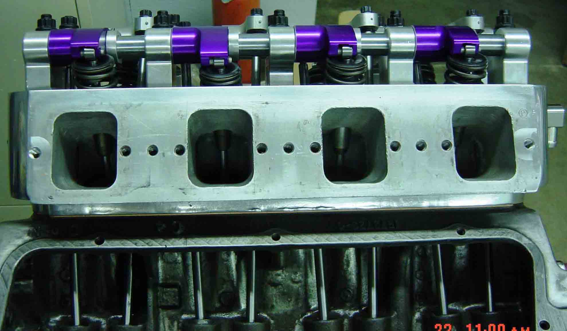

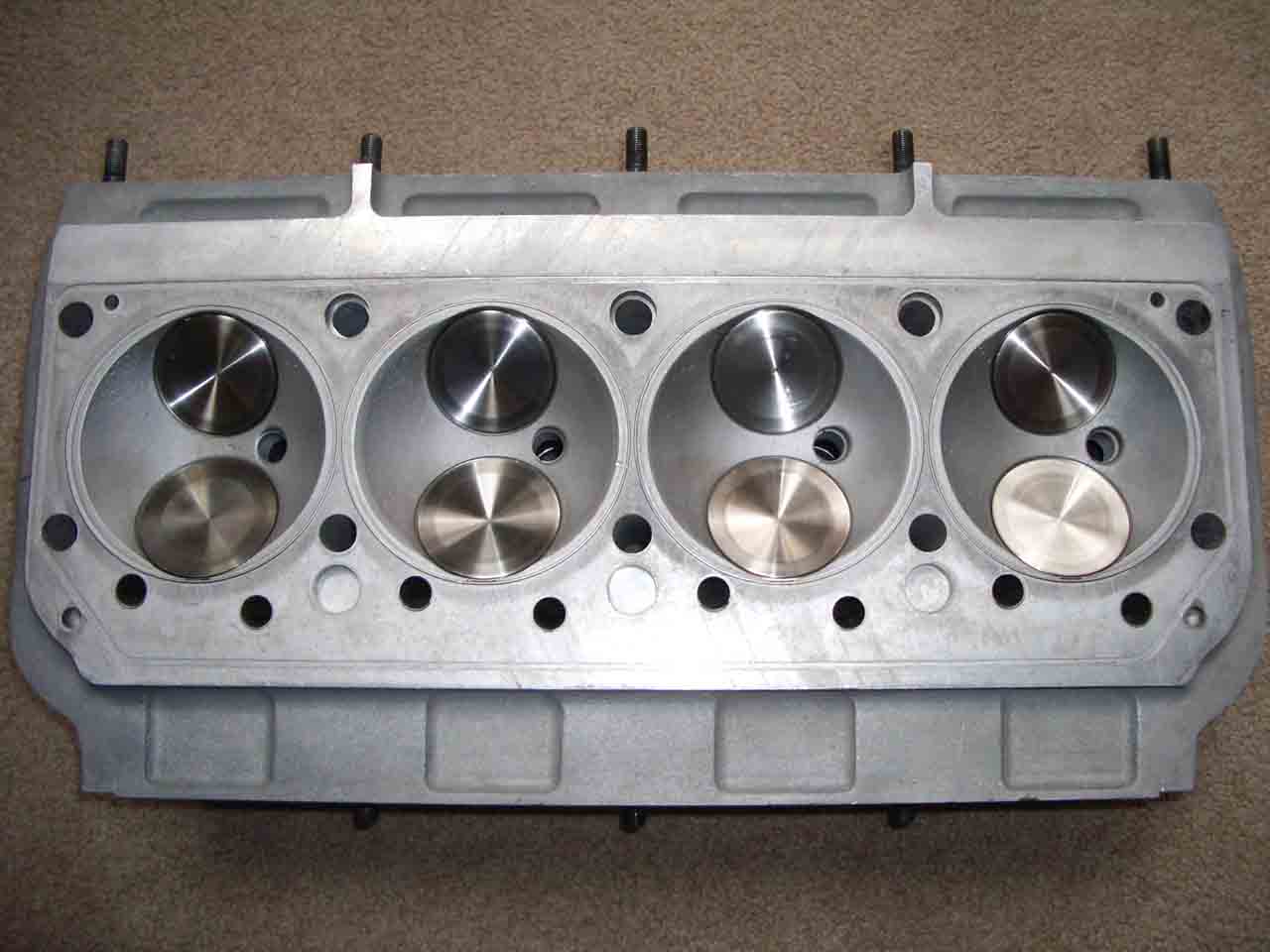

  30. The 417 Donovan was the first purpose built aluminum nitro hemi motor. It was designed with the same dimensions as a 392 - most of the parts will interchange (cranks, rods, cams, etc). Donovan created a few different sets of nitro aluminum heads - all were similar. The 417's ran a larger bore than you could bore a 392 to - like 4.250+ - so the chambers are a bit bigger than a 92. As the heads were for race only, they only have water on the exhaust sides -- and come with dry decks.
    My Madness . . .:
    I located a set of 417 heads and decided I wanted to build a 392 block with 417 heads - for the street (blown). I could have bought the HotHeads setups - but they come in a box, I wanted something that I had never seen on the street. Took almost 3 years of work to rework/rebuild the thing and fabricate the goofy stuff. The engine has not been fired yet (next spring) - and I'm hoping that we can move enough water through the heads to cool it. Given that they are aluminum and there is water jackets on the exhaust side, I believe/hope it will cool. The engine is patterned after a late 60's top-fuel motor.
    Things that are different between the 417 heads and 392 heads:
    1) Due to the huge ports, the pushrods have been moved out at a wider angle. This means that you'll need a rocker setup that is designed for the 417. Also, the valves are a bit longer as well. I had Rocker Arm Spe******ts make my rocker setup -- 2 year project in itself. Gary at RAS is great - but very busy.
    2) Getting Water Into Them: We drilled the lower part of the heads to pickup the small water p***ages from the 392 block and bring it into the exhaust water jackets of the heads. That isn't enough water though, so we drilled a 3/8 NPT water port in the block - at the back of the cylinder bank - to route water from the cylinder bank into the head and circulate it back to the front of the block. I'm also running a high-volume BBC race pump.
    3) No Oil Pressure Hole in the Heads: We ground a little oil transfer 'slot' on the block to bring oil over to the stud hole (from the block's oil pressure hole) - where it will work its way up to the rocker shafts.
    4) Due to the huge valves, we had to "eyebrow" the block for valve clearance and the pistons are custom venolia slugs. (Man they do nice work!). Also, we had to enlarge the pushrod holes in the block deck -- Smith Brothers made the custom push rods.
    5) Welding/Rework: The heads had to be totally redone - welded up the entire deck surfaces, 4 exhaust ports had cracks, all plug holes, chambers, etc.. Even though they came off of a running nitro FED car, they needed a huge amount of work to get them ready for a street motor. I knew that going into them - sometimes you have to roll the dice and see WTF happens. (Fowler Racing Engines in Columbus did all the ugly head work - can't say enough about them).

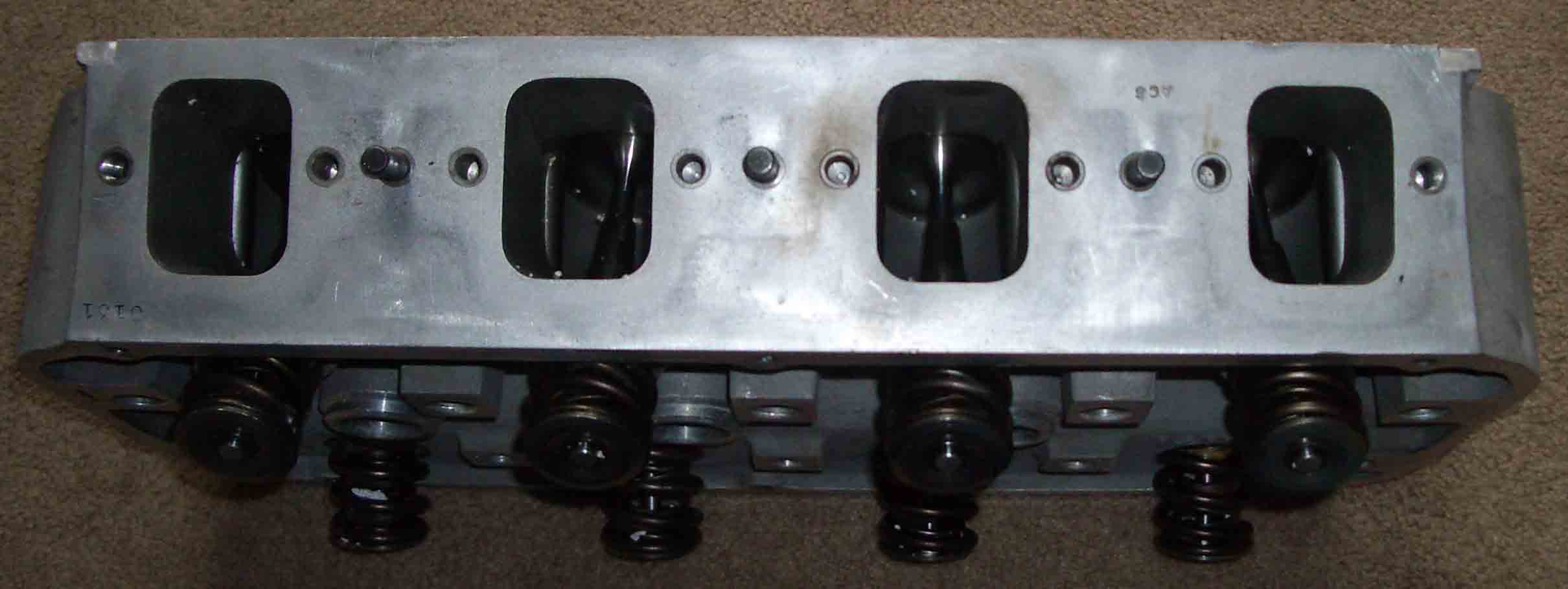

    Anyway, here are a few more 417 heads pictures: These are two different sets (needed a spare - in case this damn thing works and I manage to hurt it!):
    Spare Set - Ports are a Bit Smaller:
    Set on the Engine - Don't have a picture of the chambers:
