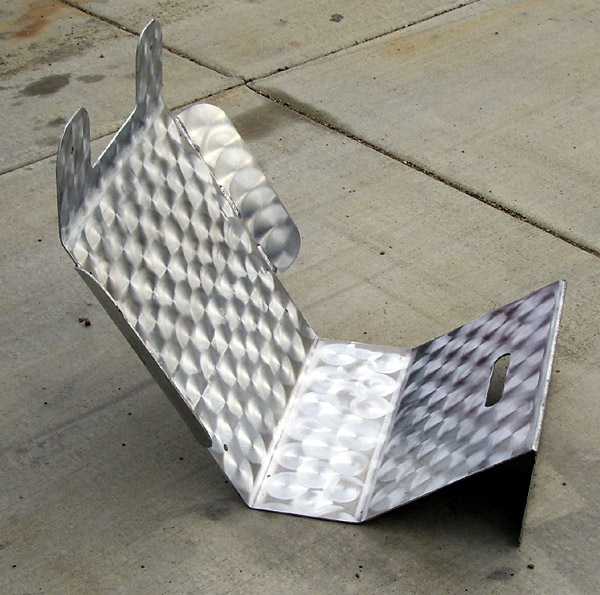

    What thickness of aluminum is that seat? Mine will look similar.

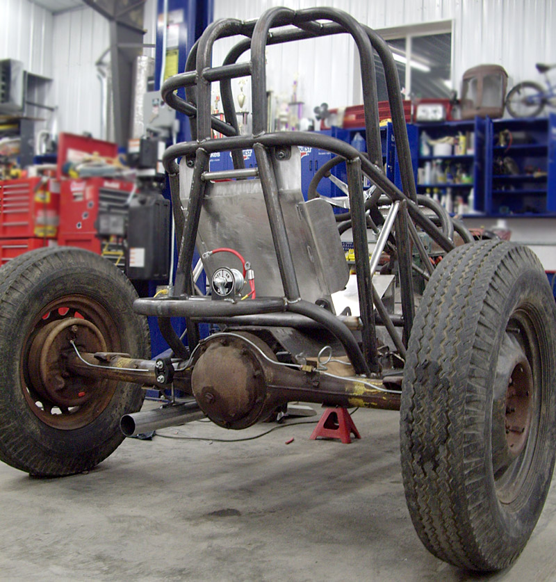

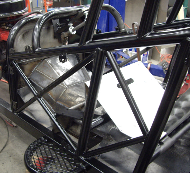

    Yep, 1-1/4 sch40, .140 wall thickness. 90% of dirt track hobby stock cars in North America are made with it. ;) The 1" stuff is some DOM .120 wall with a .166 outer diameter. I've got the correct dies.
    I've seen some foil welded... impressive.
    Yea, RV, that might be the ticket. Have to look around a bit. Seat is .1 thick.

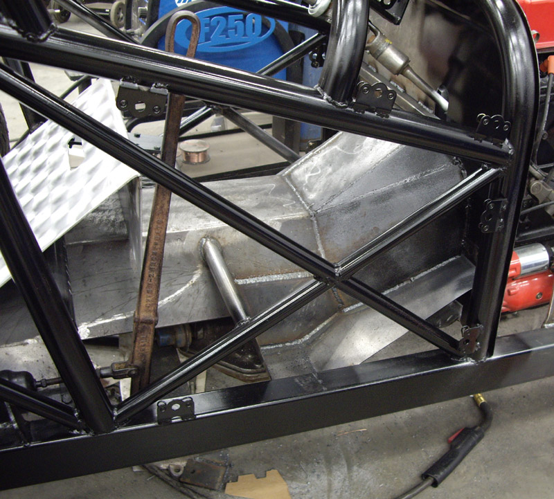

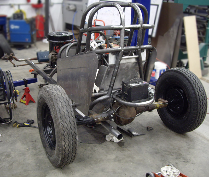

    battery box, made and mounted
    switch mounted.
    Seat and seat belt mounts, mounted.
    Next cars are gonna get a FLAT floor with minimal "humps". Speed up the build IMHO.
    I think I'm gonna add some side wings to the seat with little "speed" holes in them. :)

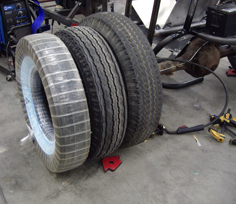

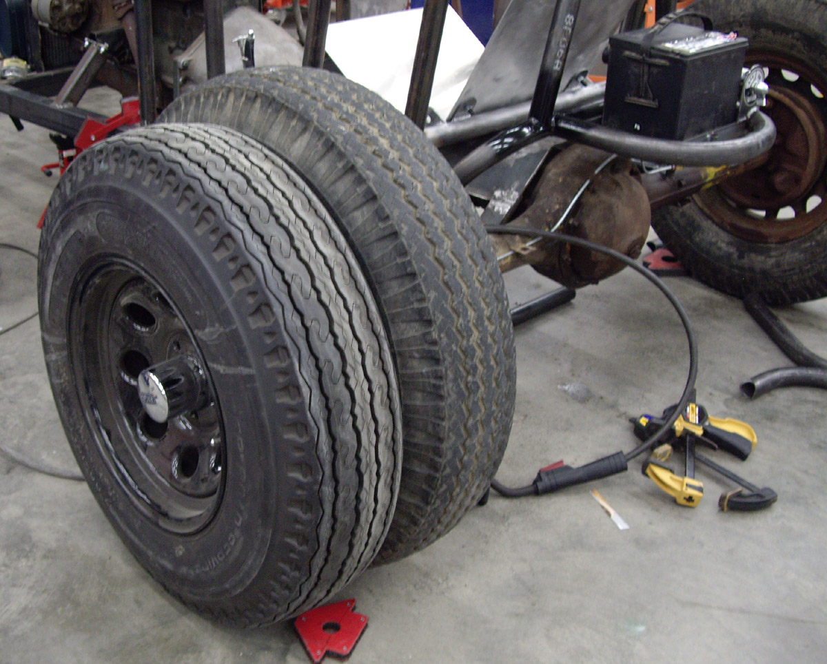

    tire comparison.

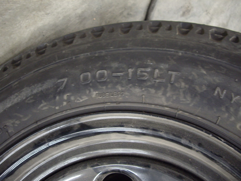

    "likely" on a local level, I see us running the 30" dimple wall tire you see. 5 ply 7.00-15. those bad boys run us $114 mounted and balanced.
    Similar in size to the cokers but 60% cheaper. For all we know they might work like ****, but they are similar in physical dimension and as good a place to start as any. "locally".
    The 32" tall 7.50-16's are about $150
    Also, they make enough different sizes, you can get similar tread tires front and back to enhance the visual appeal of the car.
    I'd say the group of us here are leaning toward this series of tire as our spec tire. If they **** real bad, back to Coker.

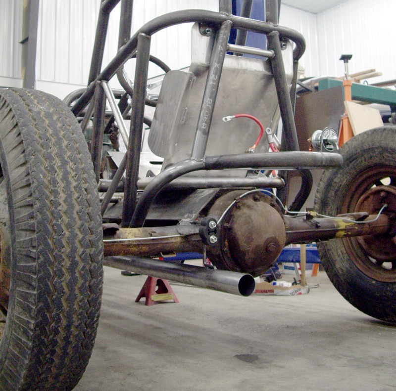

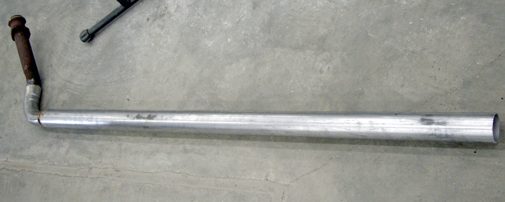

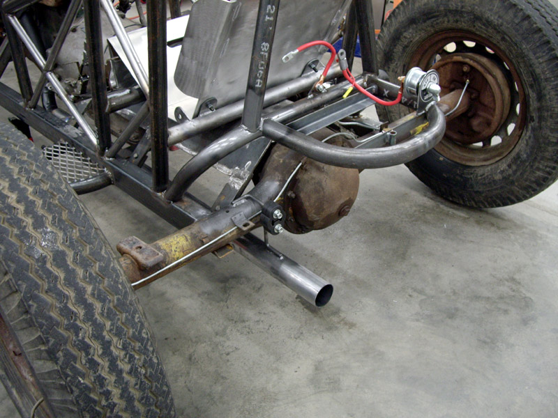

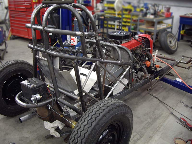

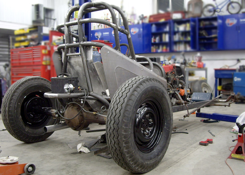

    Exhaust flanges didn't get here on time, so we made us a tailpipe. :) Seat looked narrow from the back, so we added some wings to it. Feels better to sit in it. X and K braces on the cage. Used 1" .125 DOM for them. Gave us 3/8 " more room for your hand around the shifter. might not sound like much, but it adds up. Wiring for the battery is in place.
    Also... CRIKEY, it takes forever to weld up all these little tubes... :D

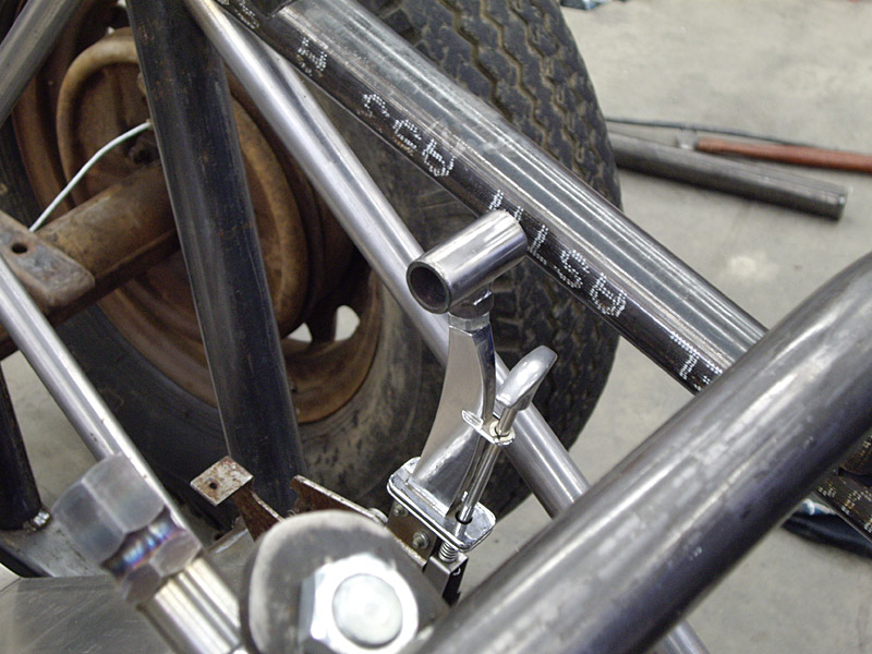

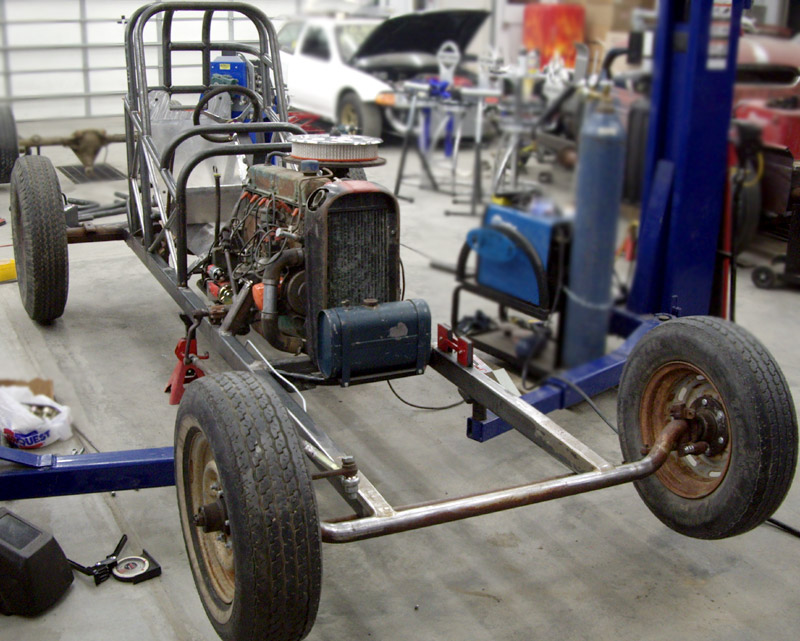

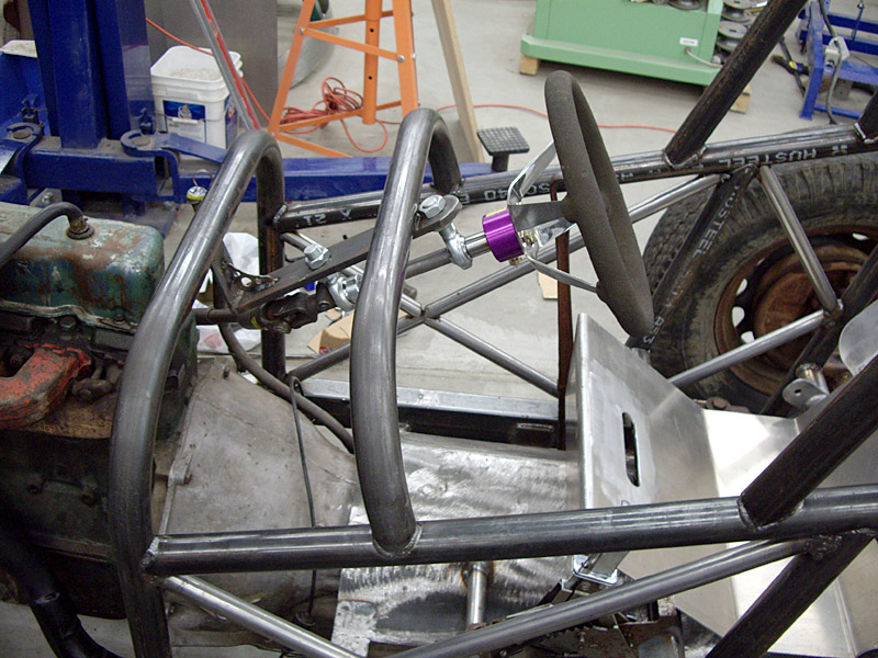

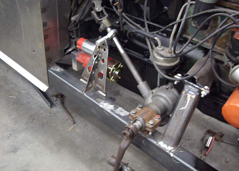

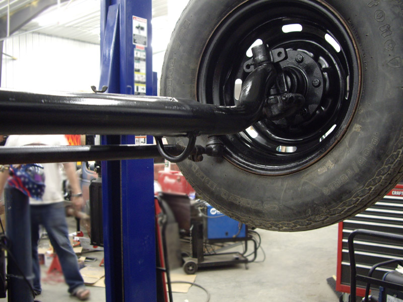

    Steering and shifter are in. Scrounged up a ratchet shifter. Submarine strap mount is finally in, seat cut to match. fuel line bent. We're toying with the idea of running idiot lights on the dash instead of gauges. "if you see lights on the dash, you need to shut it down, or SHIFT..." ;)

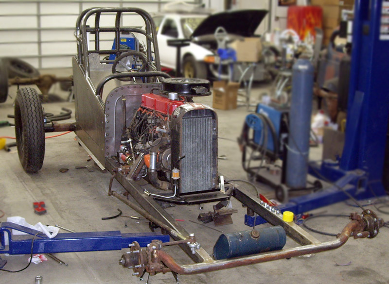

    talked to a guy tonight that just pulled a 250 and 4 speed out of something he did a V8 swap on. Says it runs perfect, no issues. I can have the pair for $100. Gonna pick that puppy up! I might bail on that 305 for the other car. Even locally, good deal or not... The respect level is proving low for a v8 gas rail. 2 less pipes to worry about on the header anyway. ;)

    Couldn't find the shift nob, so we made this little ******, and started on the body panels.
    Lot to do if we're gonna have this on the track by Sunday... time will tell. Gotta get REAL lucky in a Lot of areas. :)

    Ah, the rims.
    Sad part is, I think the rears are gonna get the boot. This build is for a friend. He's got a pretty tight budget... VERY tight. the tires we found for it on the 17" rims in the pic priced him out of it. We need to scrounge some 16's to save him a few hundred bucks.
    I'd love to leave those rims on there though. Gotta go where the wallet points ya. :)
    And we need the gear ratio those 32" tires are giving us. I got it pencil'd out at 3500rpm = 89mph. 30" = 83mph
    Mostly an 1/8 mile car (home track is 1/8 mile).

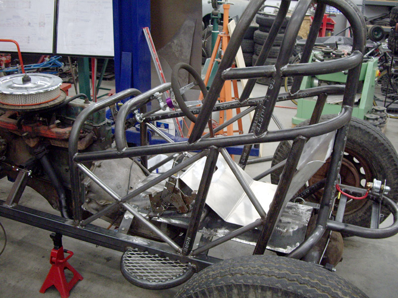

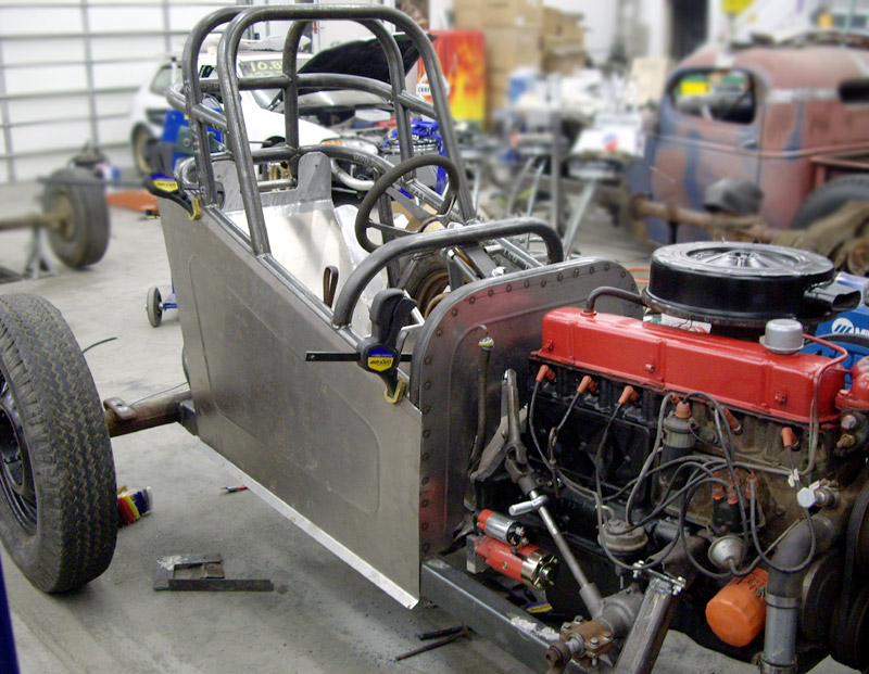

    Got the firewall designed and installed. I'm glad we put the bead roll on it. Got the pocket for the left foot about mounted and started on throttle linkage. rebuilt the steering box ...again... something in it feels funky. And we're adding another support heim just above the starter. It turns "heavy". little over 1.5 turns lock to lock. I think we need a different box. But we'll see how it does when we get to drive it up and down the street. Might not steer as heavy as a person might think.
    A quick build tip for any noobs thinking about a build. Before you go knocking in the driveline take a HARD look at where the floor boards are gonna be. the flatter you can get them and the less humps and curves the easier it will be to finish that area. This means setting the engine low in the frame and or running the frame rails higher. Look at bobw's build. Much better floor design, more room, easier to fab. Thread can be found here.
    http://www.jalopyjournal.com/forum/showthread.php?t=325361&page=5
    Still can't get the body panels mounted. After 30 years in the same location, JEGS decides that my last order should be more scrutinized than usual and they delayed my "next day air" order for a day while they checked. 30 years, same location...Lot's of 4 figure orders. This one for $300 for dzus fasteners, they gotta really check out. I suppose I get it though. the amount of fraud in the mail order business is rough.

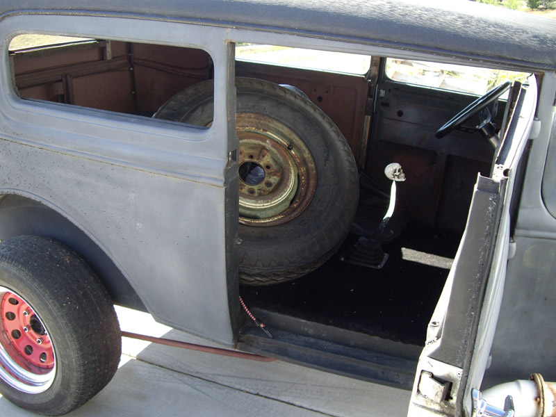

    Great story on the tires. First of all we got them for FREE from our local tire store, as they dig the car. How cool is that. 7.50-16's. Just got to put their name on the body, and the lettering should be done in the AM.
    I took my model-a down to the tire store to check on when they could get to them, guy said their done. I wasn't about to drive all the way back home to get a truck so we just stuffed them in the car. Was a tight fit, and they were precariously wobbling around and leaning on each other. But I figure, no big, I'll be home in a jiff... Took 9 ounces each to balance them by the way... What's the deal with bias ply tires being kinda ****y? ;)
    Half way home, I'm going 50 around this corner, the tires decide to roll off each other and head toward the dash and they knock the shifter into reverse... There I am, sidways, tires squealing and trying to also get this 60 pound wedged-in tire off the shifter while not sliding into the rhubarb. I'm sure the guy behind me was curious WTF was going on. :D

    Thanks guys. We're at I think 15 degrees for castor, that might be the hard steer. I'm gonna put the car on the lift until we have 15 degrees of body angle, putting the front end at zero, and see if it stills steers hard. Then at least we can put a finger on what we are seeing.
    Next build, I'm putting in the MW funny car steering box. Based on the amount of work to adapt and trouble shoot other options, it's a bargain.
    Dzus fasteners... I would love to watch a professional mount a body on a tube car... :p

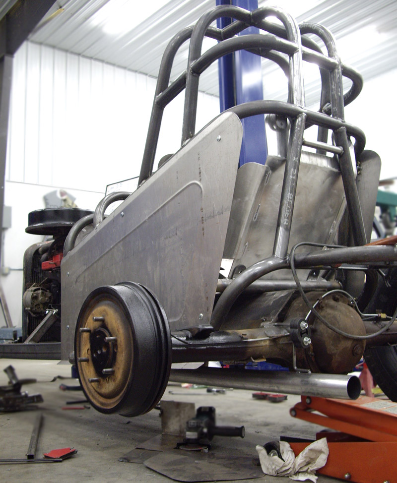

    Both side panels done and mounted. Correct tires on. Had a flat, rim had a hole in it. They tubed it.
    Starting to finally look like a race car.
    What's left?
    Hood section.
    starting and on off switch
    interior floor on both sides
    6" section of ****tershield up to the firewall
    Transmission cable
    throttle pedal and linkage

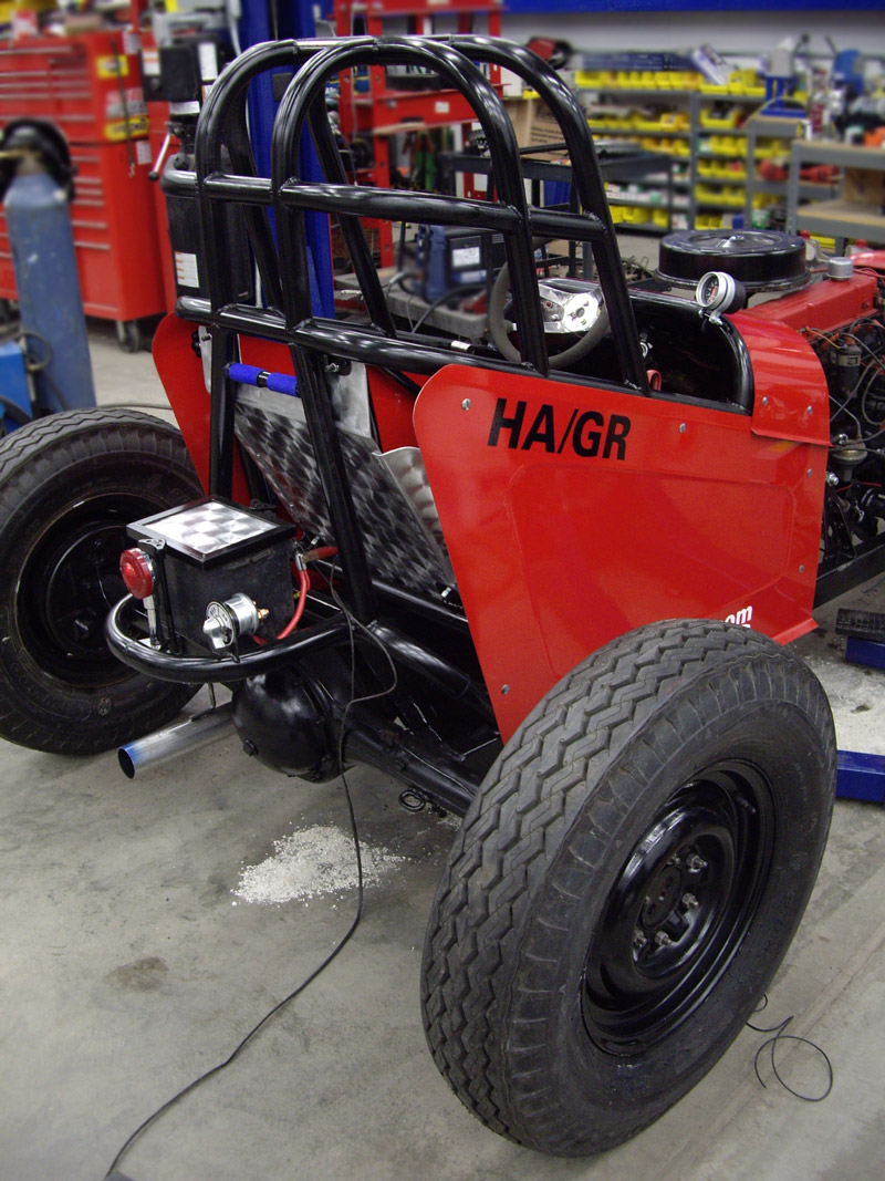

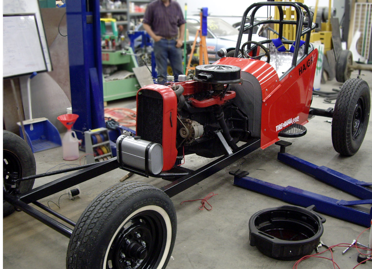

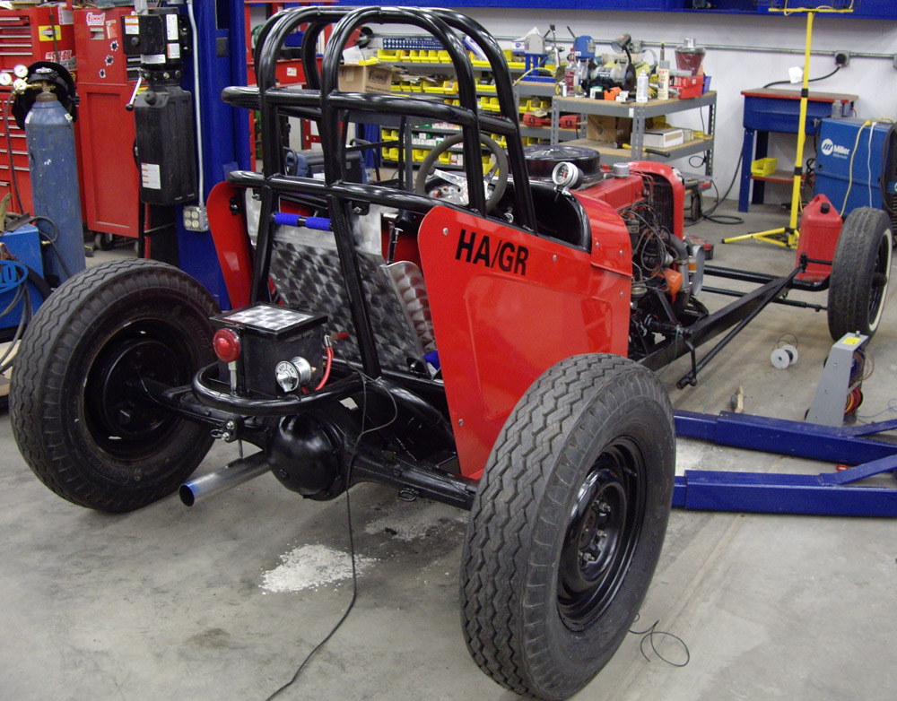

    Got the hood done, and all the tins are off to be painted in the AM. Whipped up a little bracket to put one more heim on the steering shaft. ****tershield is getting close.
    Entertained the idea of running a bead on the hood, but decided the windshield will add something to the panel and as we haven't worked it out yet, hate to have the windshield interfere or hang up on a rolled bead.
    Rest of the body tin is 18ga, hood is 24 gauge.

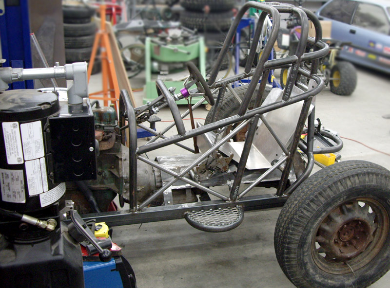

    Diggin' your running board. Cuts down on "high centering"!

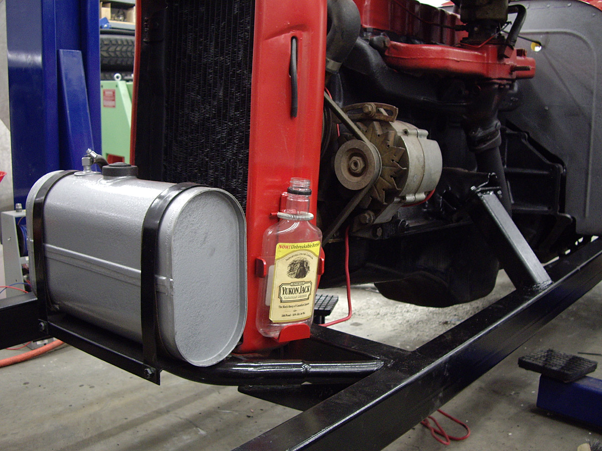

    Got the ****tershield and floor finalized and welded in. Started looking for things that needed to be welded that we forgot. little things here and there.

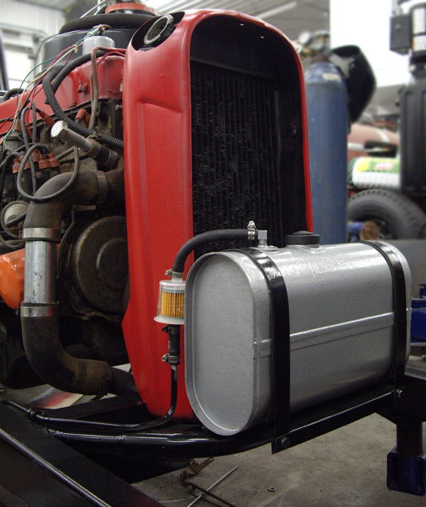

    Got the fuel tank painted mounted with filter.

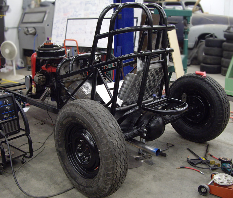

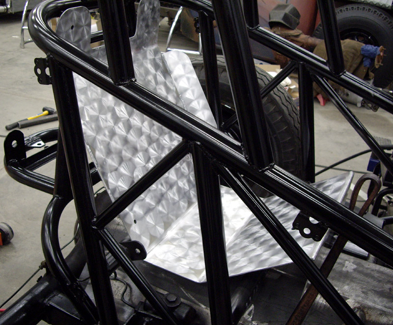

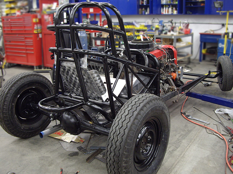

    Spent more time than I care to admit trying to put an engine turn finish on the seat. here it is with 5 coats of clear on it. :eek:
    We rousted up an old motorcycle blinker that looks pretty slick, it's gonna get mounted on the battery box when we're done.
    The tins are drying at the body shop. Should be on the car tomorrow. Sadly, we have blue seatbelts for the car. Gonna need to pick up some black or red ones to match the rest of the car.
    Hopefully
    be driving it, in less than 24 hours.
    Rained all day. There are races in the morning, I'm confident they are rained out for Satruday. It's still raining right now. We're still gonna push for a Sunday shakedown at the track. We'll see. :)

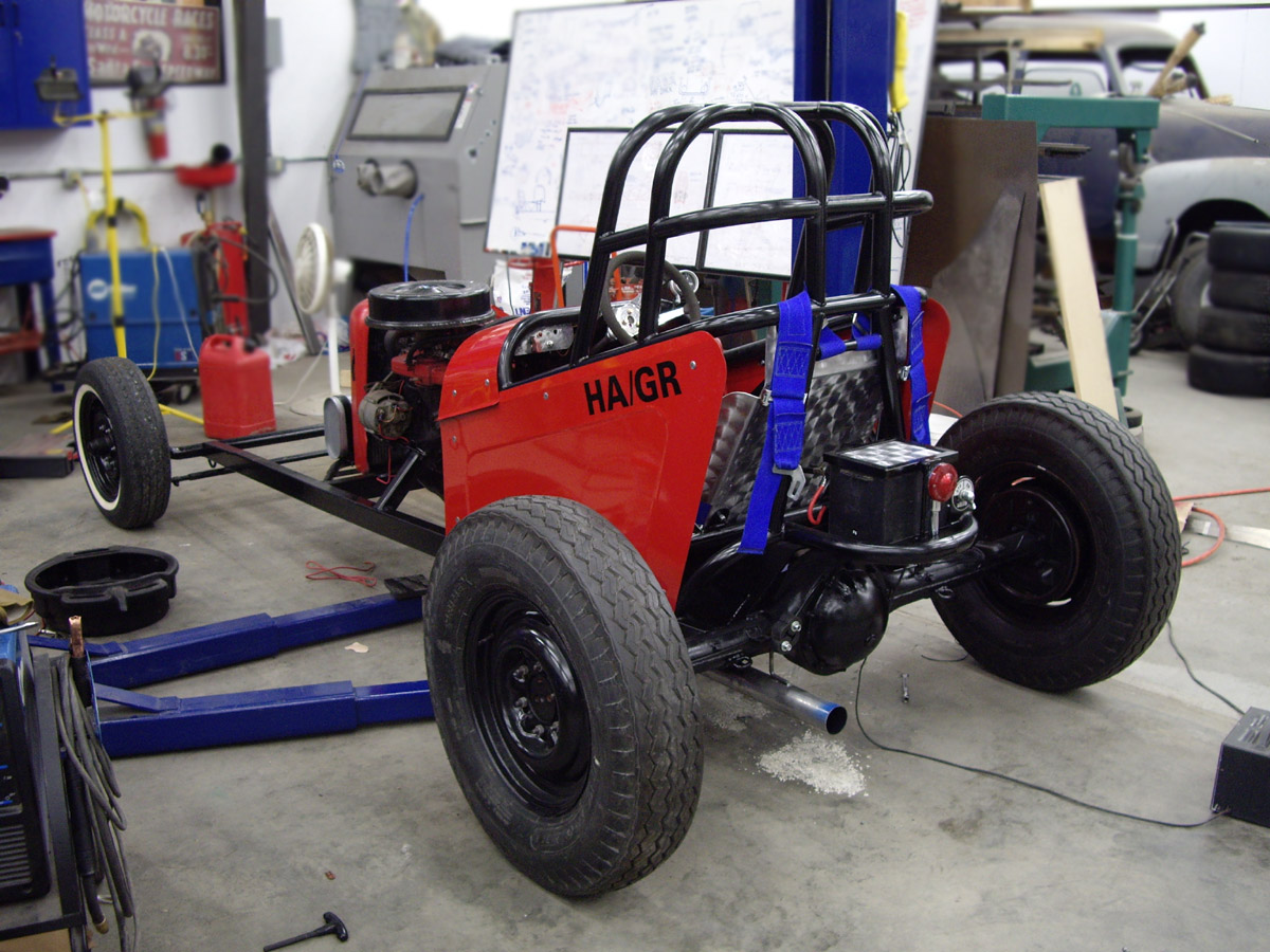

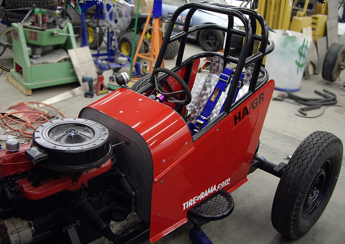

    Got the battery box done and added a panel on top to match the seat. Throttle pedal in. Tow/tie-down hooks put on the front. Got an overflow tank built and mounted. Got the shifter linkage run and mounted
  30. vectorsolid
    Joined: Apr 28, 2008
    Posts: 498
    vectorsolid
    from Montana
    Just about done.
