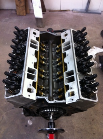

    Well a little update, putting a new engine together more purpose built to handle the whole blown alcohol deal. Got the long block together this weekend she's got a forged crank forged H beam rods and a set of Flat top blower pistons. I got a nice set of used Brodix track 1s and had Bullet grind me up a nice .690 lift solid roller. Should progress pretty fast from this point I hope. ImageUploadedByTJJ1335180764.424042.jpg

    You're out of control now...I love it!!!! :cool:
    I can't wait to see it run! :D
