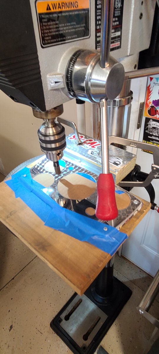

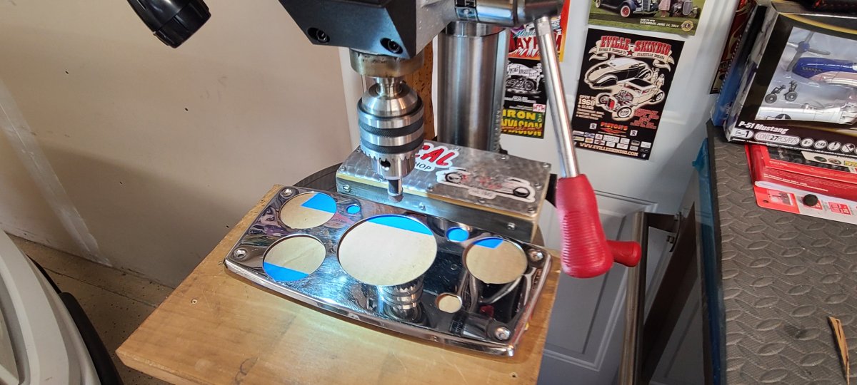

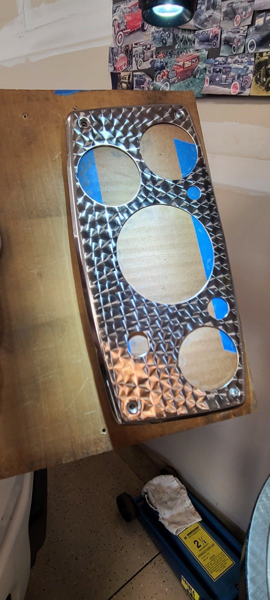

  3. Teaching my girl how to turn panels for her dash. Started out with some clean aluminum and a drill press with a cut down 3 M “Cookie”. Think she did a pretty good job. 32E160B1-36B0-4A30-9050-B819028B5801.jpeg A64CFCAB-4867-49AD-AD58-8F25764FE4B5.jpeg

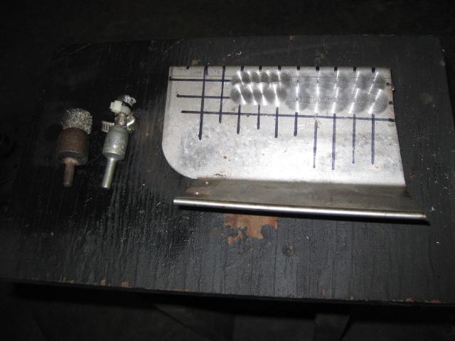

    I use a end type wire brush with a small hose clamp around the wires, Chuck that up in the drill press . Make a plywood table mark it front to back with 1/2 marks, and a center line ,clamp a yardstick on the first line left to right. Line up a constant number (say 20) ..run the first line of swirls ,move yardstick in to next mark and left or right 1/4in line material up with constant (now offset),run 2nd line move stick in to next mark and back left or right 1/4to line up the constant. Moderate pressure on handle only 10seconds per swirl. When you can't advance in because of press post rotate work peice 180 and move in the other direction (if you moved the work right to left to start then move left to right)
    No lube or it takes longer to make the swirls.
    Did 2 12x 18 panels brush did not lose much length . If it seems to slow down cutting run it against a bench grinder (lightly)to sharpen.

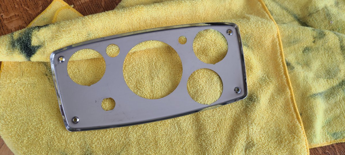

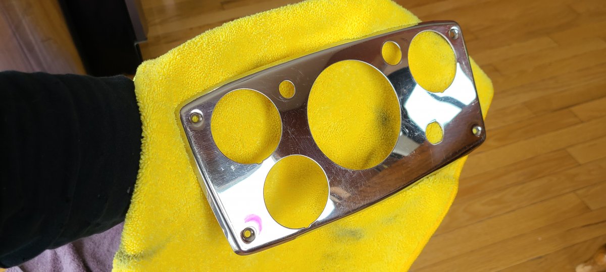

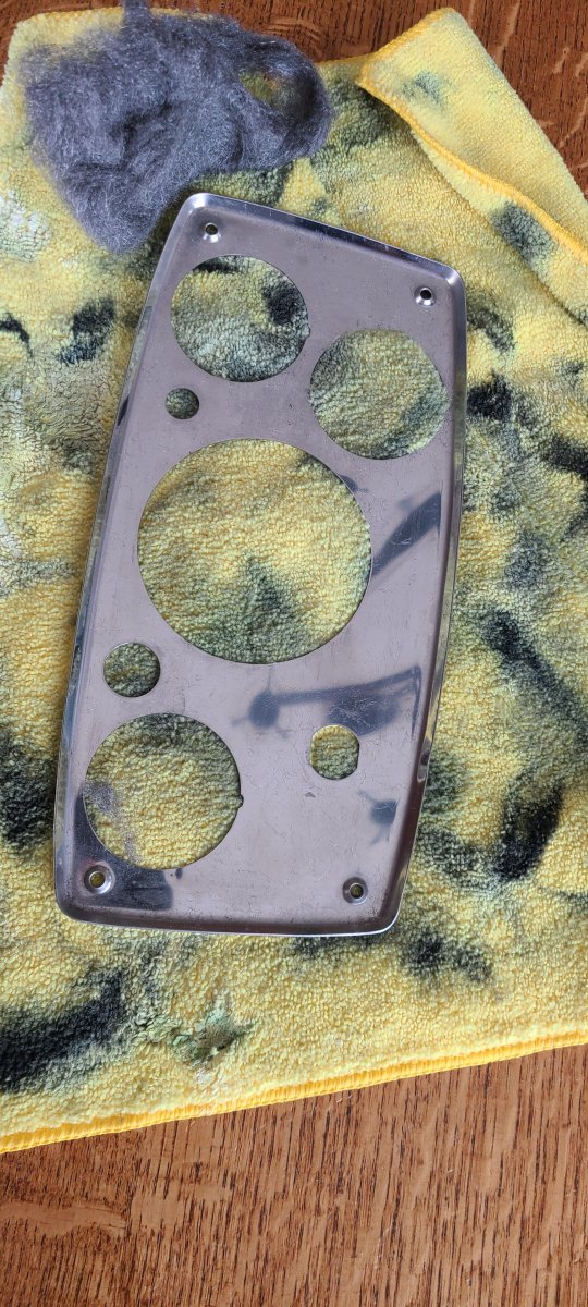

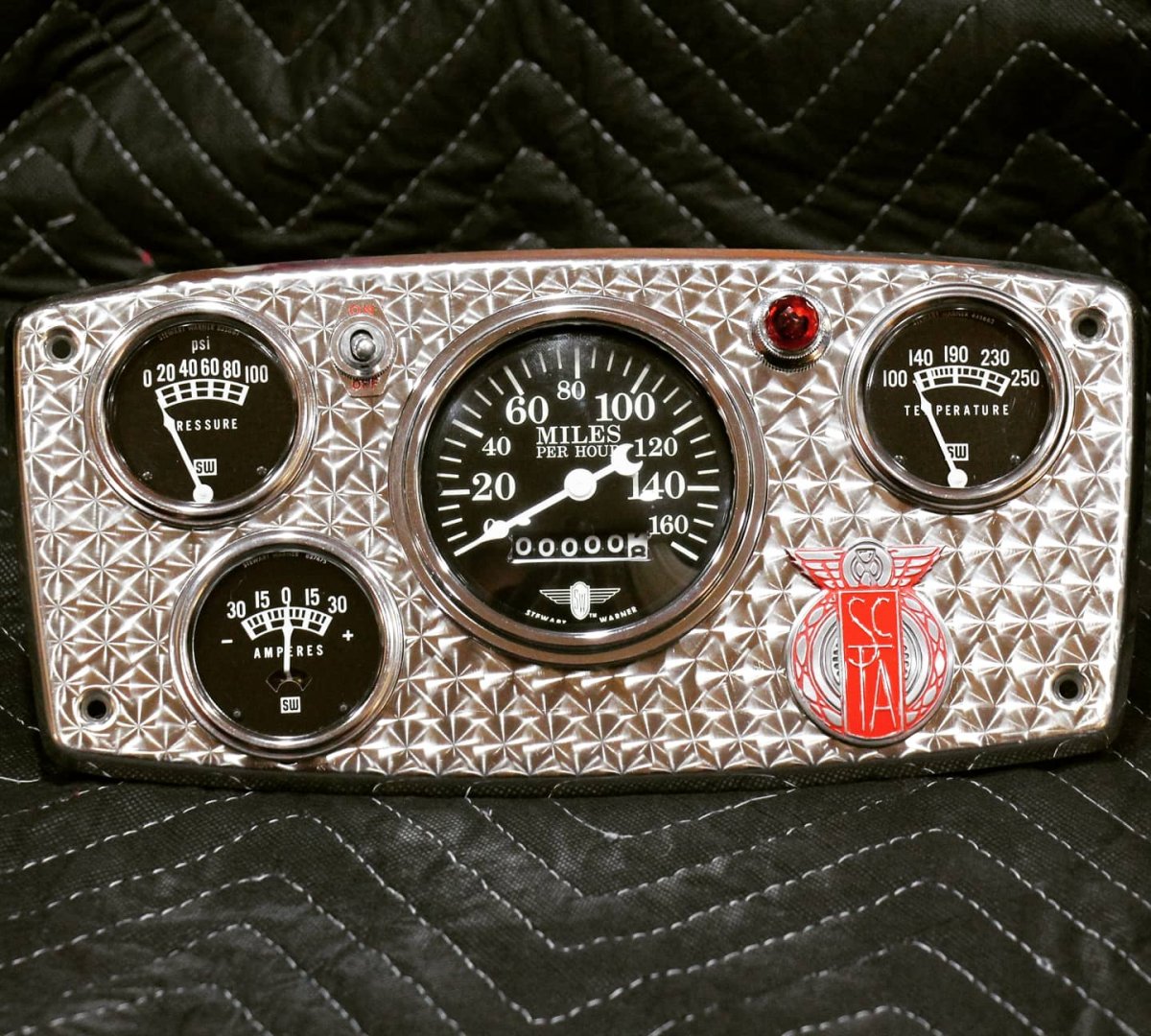

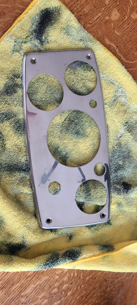

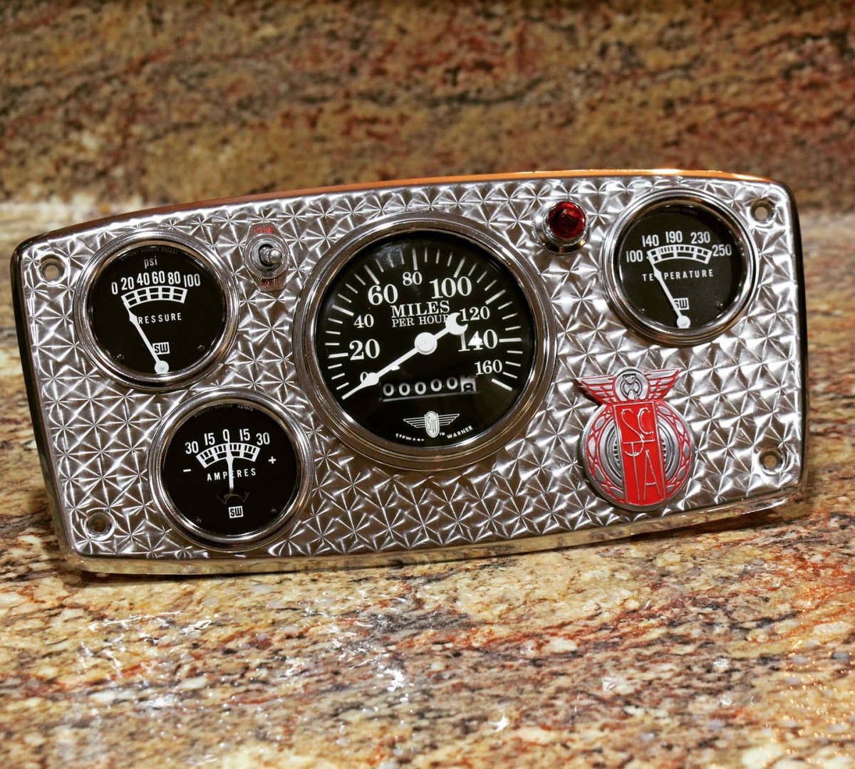

    I came upon an old dash that I knew had potential. After striking a deal it was mine. Here is how it looked when I began.
    First, I rubbed it down with 0000 steel wool. Then I polished it with Mothers.
    Then off to the drill press for some engine turning...
    Then I filled it with gauges, a SCTA medallion, red jewel light and a toggle switch...
    Can't keep them all....time to list it for sale...

    Nice work! Does not even look like the same panel... did you use cratex abrasive?
    kadillackid, loudbang and Speed~On like this.

    Thank you so much @big duece ! Yeah, it really transformed into a very nice looking panel.
    I used a Cratex stick, Medium Grit, 1/2" diameter.

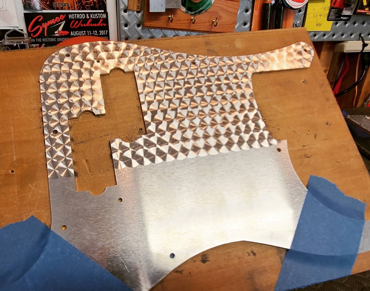

    A friend laser cut several guitar pick guards and asked me to engine turn a few.
    These pieces are aluminum and are particularly soft. Typical I use a "medium" grit stick. For aluminum this soft I used a "fine" grit stick. It's important to only make contact for a fraction of a second when laying your swirls. Allowing the sanding stick to make contact for any longer will score the aluminum and it will ruin your job.

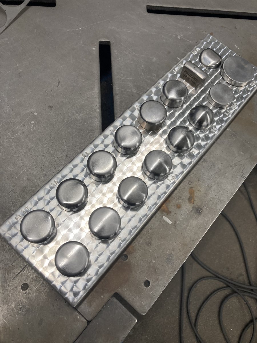

    We needed a rack for our new planishing hammer dies, so I decided to make it with some style using some extra engine turned material we had lying around.
