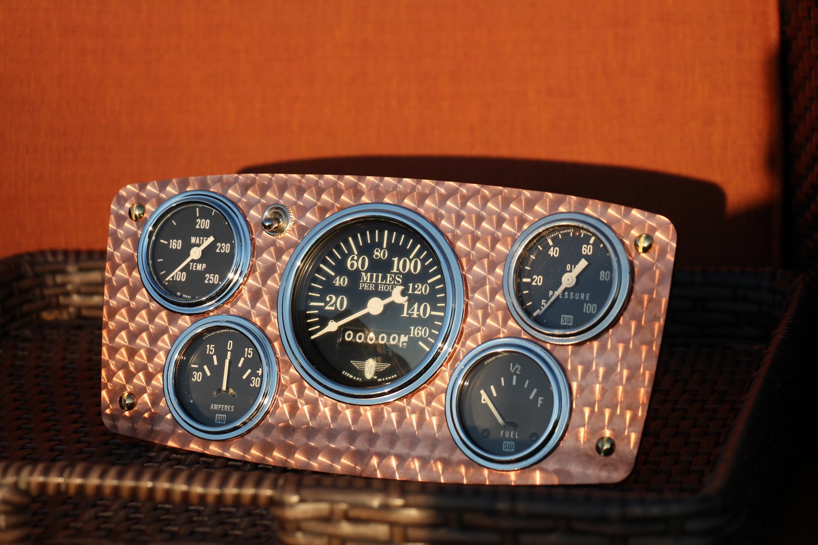

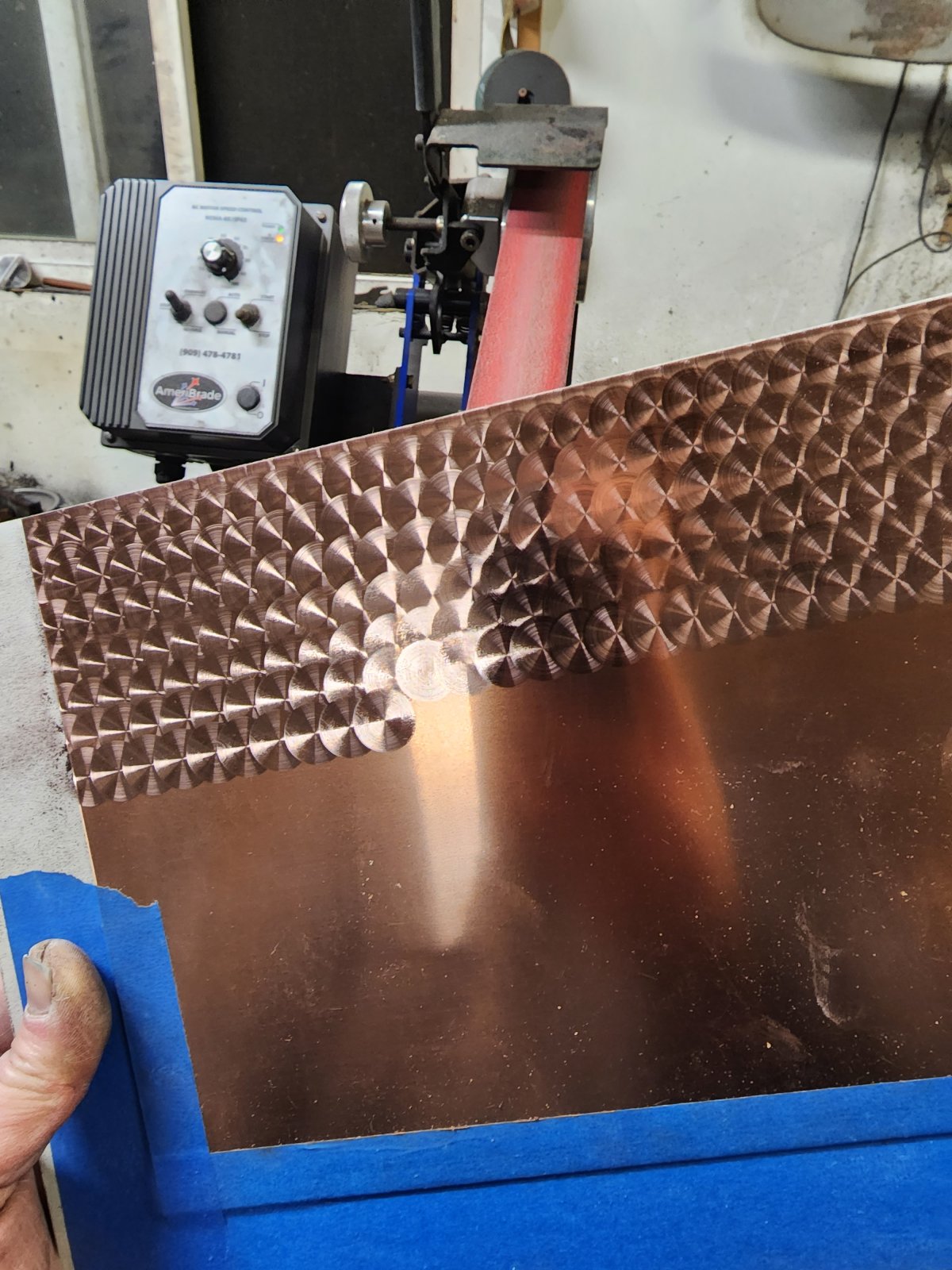

    @fleetside66 I was surprised at how well the copper took the Cratex. With that, the Cratex only had to contact the copper for a fraction of a second to create a great swirl. It was far easier to turn than I had anticipated.

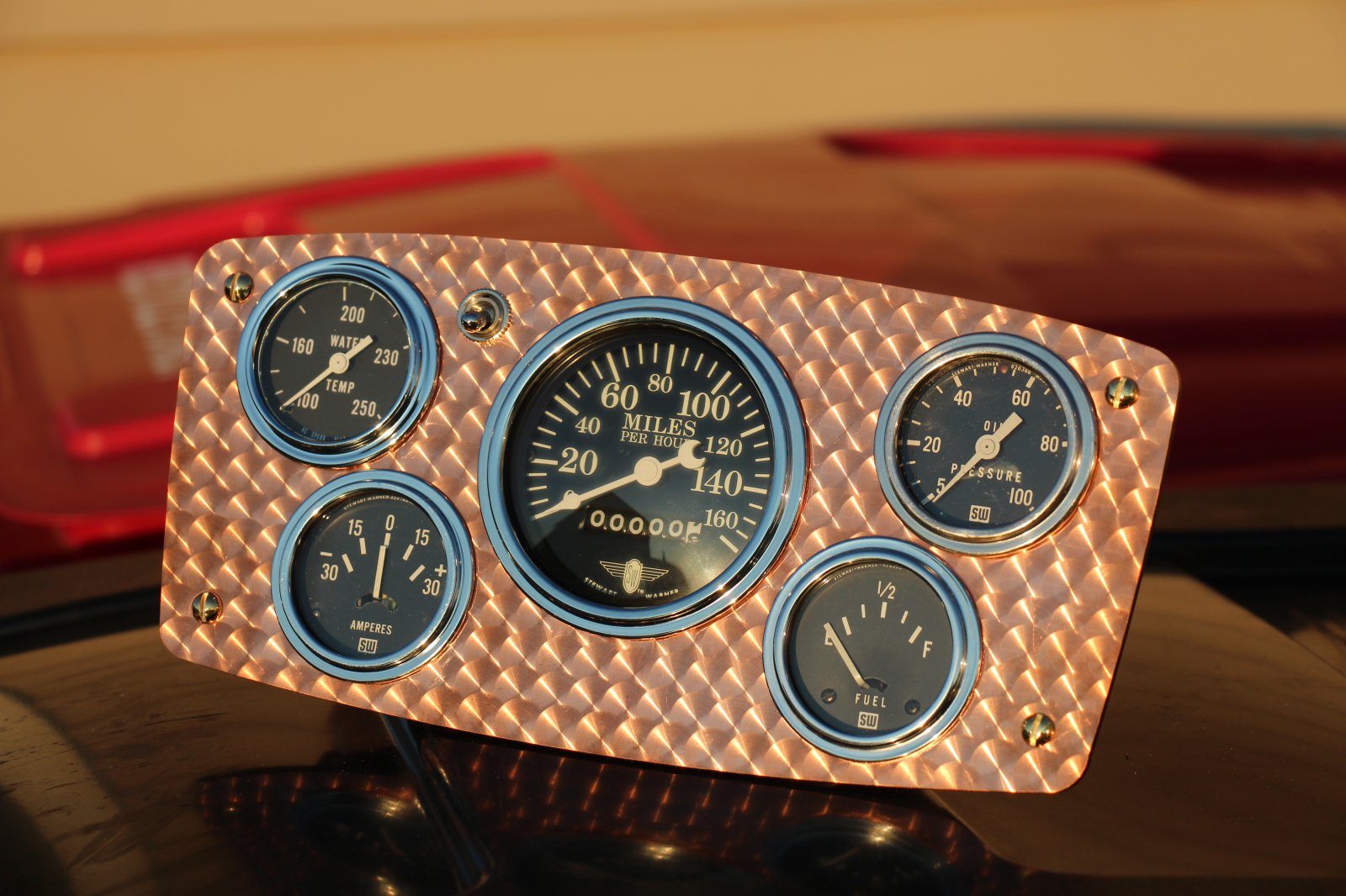

    Sorry to post another photo of this, but I finished the copper dash today. I just had to share. And YES, copper should definitely be engine turned!!!!
    It's a copper kind of sunset......

    Neat copper insert! Did you apply varnish or clear coat the copper? Would shark hide work? How to keep it from tarnishing...? Thanks

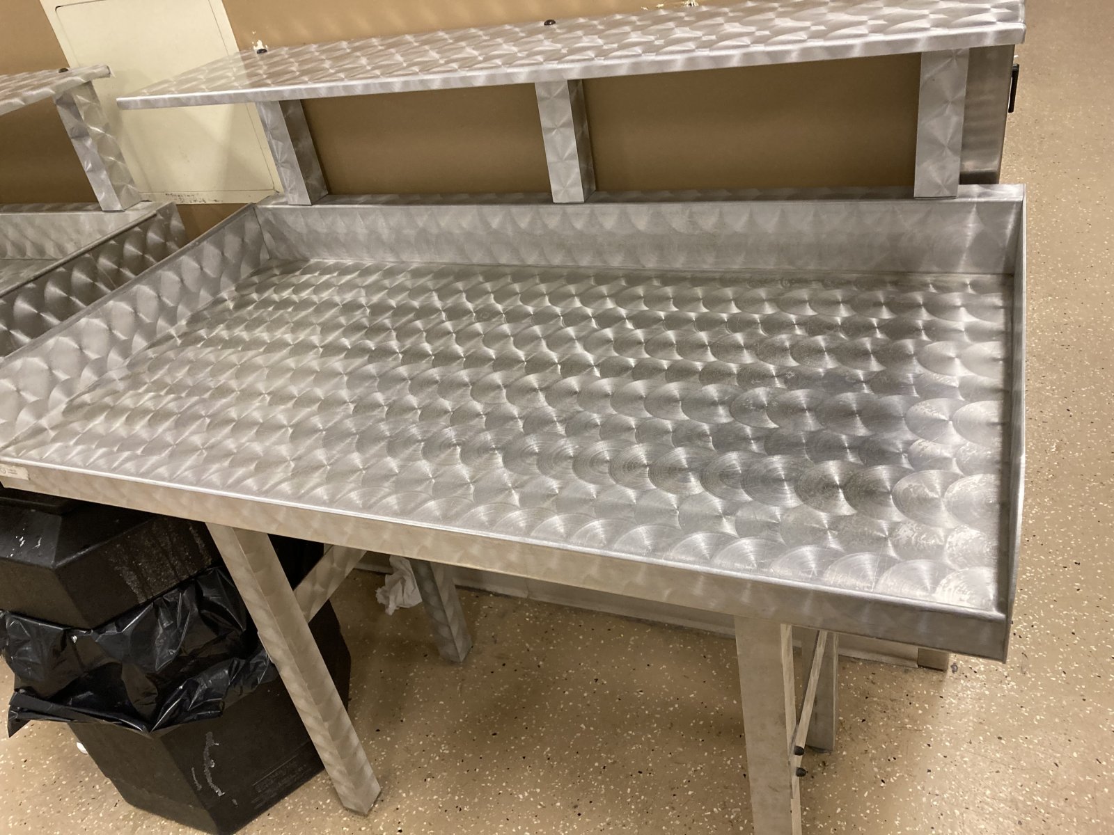

    Not mine. But I spent a couple hours staring at these tables at the local laundromat the other night, now thinking maybe I want something like this for my garage.

    Be interesting to talk to store owner, track down shop that made tables ( including legs ) just for conversation & helpful hints to do yours

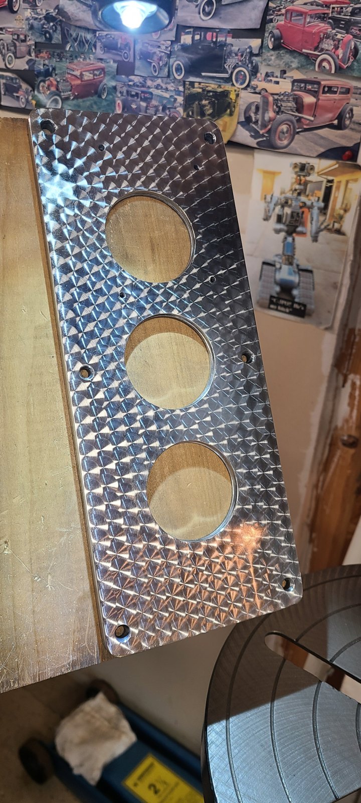

    Alllright, so I was back at it agian today. I've been meaning to the do this for years as I've always liked the look of vintage hand fuel pumps mounted with 1950's era Stewart Warner gauges. I've spent several years looking for a 2 hole panel that has a hole to fit a 2 5/8" gauge and a hole to fit an 1 1/2" pump. As you can imagine, they pretty much don't exist. so today I made my own!
    This was my afternoon project. The aluminum was not ready to engine-turn once I finished the fabrication so I spent some time buffing it on my buffing wheel. Once I had it shining like crazy it was ready. Note, this aluminum was somewhat soft. I used a Medium Grit stick and only allowed the Cratex to come into contact for about 1 second for each swirl. I'm pretty happy with the results.

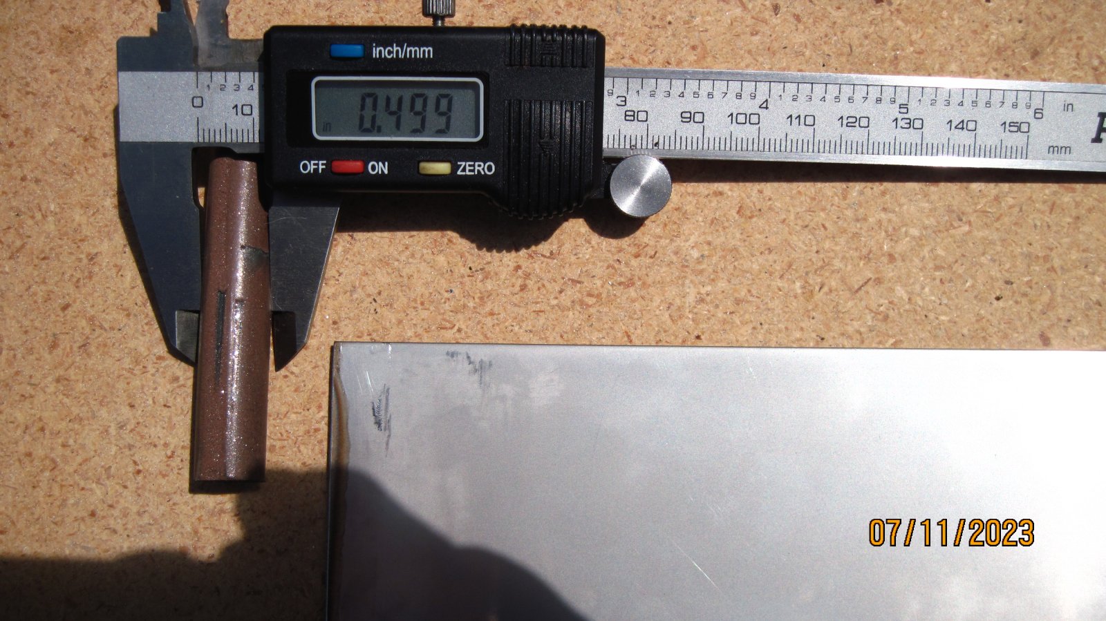

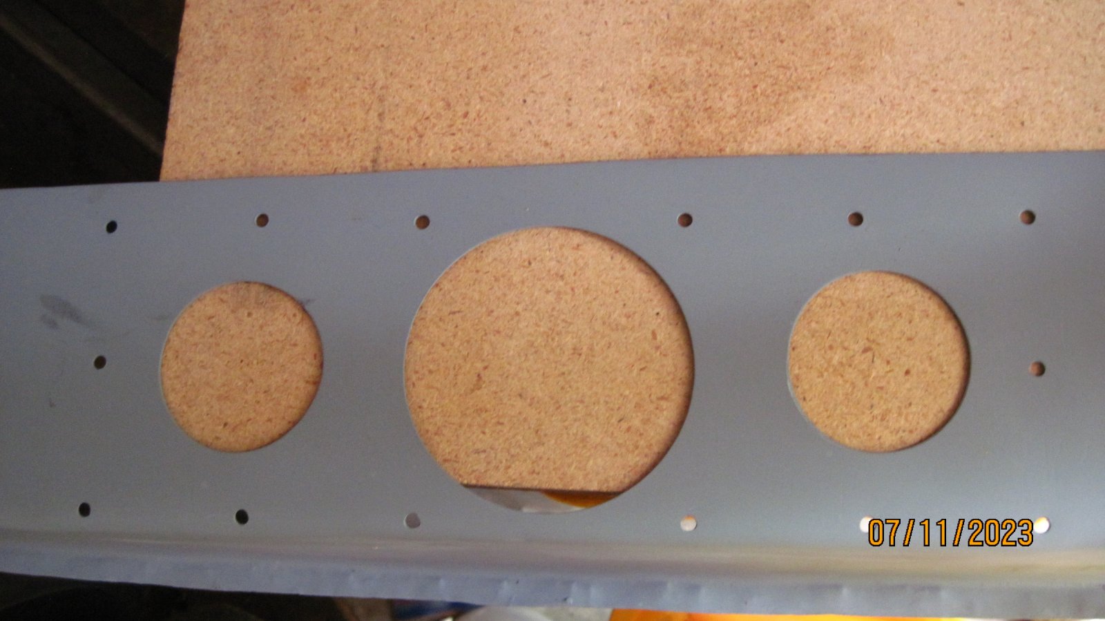

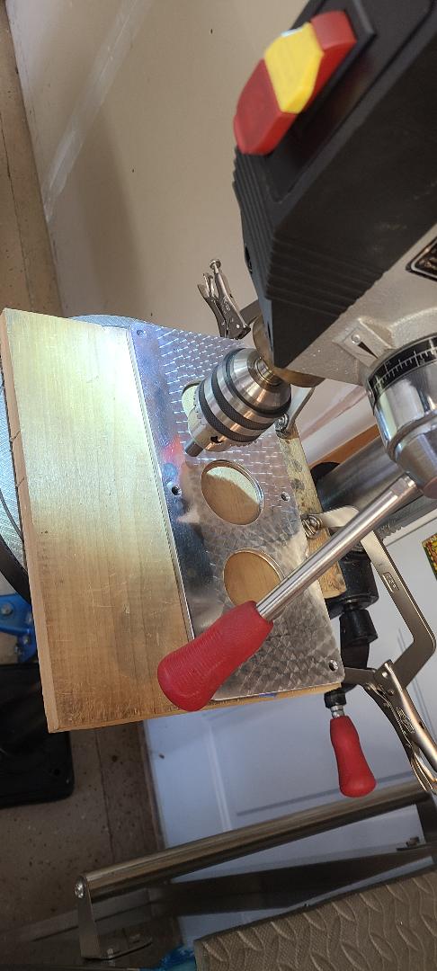

  17. IMG_2277.JPG IMG_2274.JPG IMG_2281.JPG IMG_2279.JPG IMG_2280.JPG IMG_2285.JPG I made an engine-turned overhead dash plate for the three gauges on my '29 AA that I wanted front and center: the engine and transmission temperature (2-1/16") and the tachometer (3-3/8"). I started out with a 4-inch wide piece of 18-gauge stainless steel (short piece for illustrative purposes). The dash plate would be 4 inches tall and about 12 inches wide. I used a half-inch Cratex cylinder to carefully engine turn the face, then measured and spaced the pilot holes for the three instrument holes. Next I used carbide-tipped hole saws (bi-metal won't cut it, especially on the larger 3-3/8" hole) to accommodate the gauges I wanted. I needed to ensure the edges of the faceplate were tight to the underlying 18-gauge cold-rolled sheet metal overhead console so I measured and drilled 14 holes for 8-32 x 1/2" Allen head ****on bolts - nice black ones to contrast the engine turned faceplate. Finally, I attached the faceplate to the sheetmetal console, installed a couple of gauges to check fitment, put the whole thing in place above the AA windshield and confirmed the line of sight visibility. I'll add some green jewel-type turn signal indicator lights on each side of the tachometer. Not bad for just using a cutoff wheel, drill press and a couple of hole saws. I still get to keep the stock 28-29 Model AA dash, which will have the fuel gauge, oil pressure gauge, voltmeter and original speedometer/odometer/trip meter.

    The pattern is pretty durable. It’s scratched in to the surface by abrasive and really visible because you start with a shiny polished surface. Cleaning it won’t damage it.
    The light pressure on the Cratex is important. You don’t want to generate any heat. Heat melts the Cratex and you get burnt end of Cratex stuck in your scratches.
    Somewhere up-thread I posted pictures of a table in a local laundromat. The aluminum surface is turned, and you can imagine the abuse it takes from baskets and stuff being slid over it all day every day.

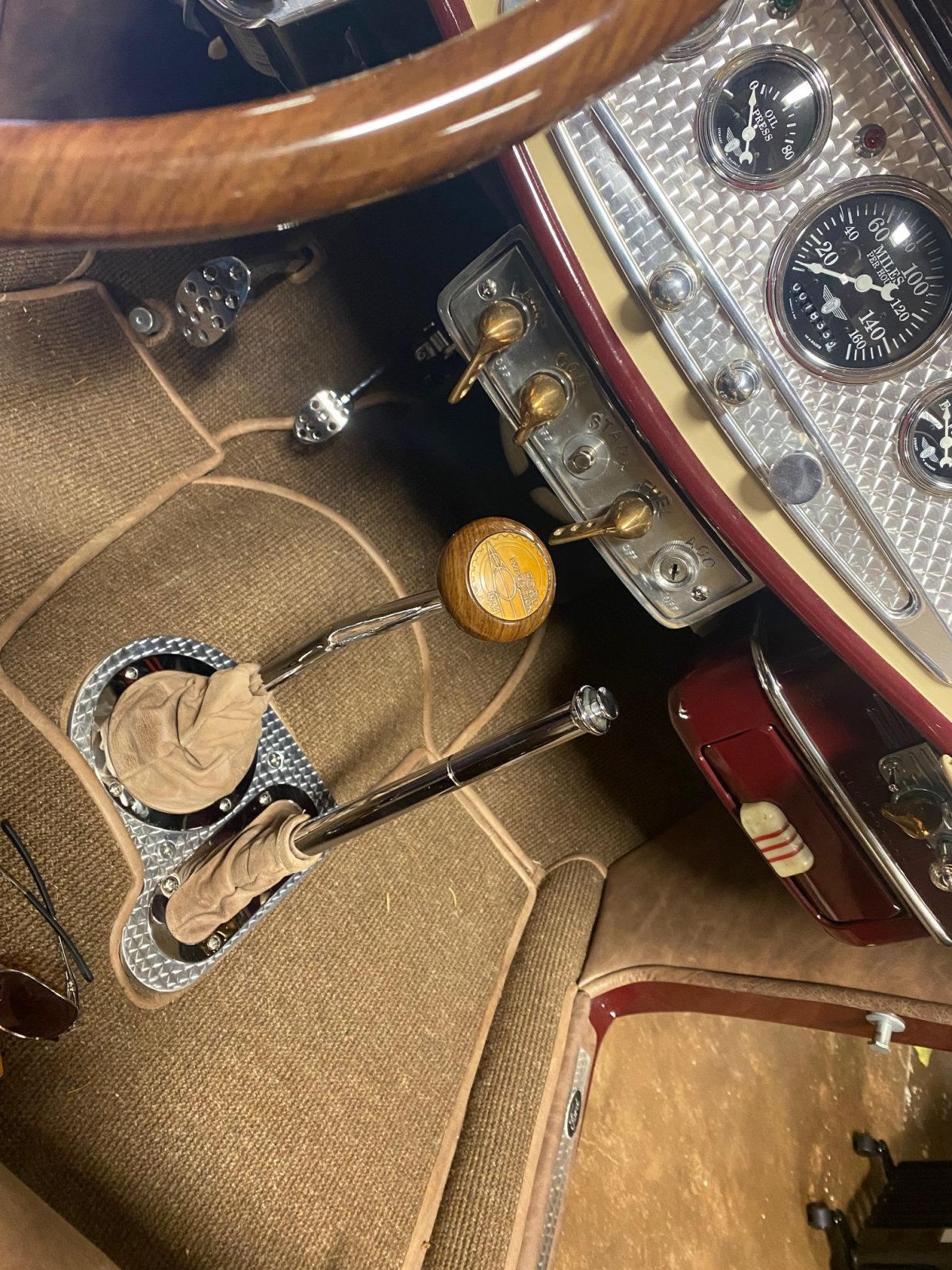

    I turned the shifter plate to match the dash in my roadster a couple of weeks ago.
    It is easier to take care of as it doesn't show fingerprints and light scratches.

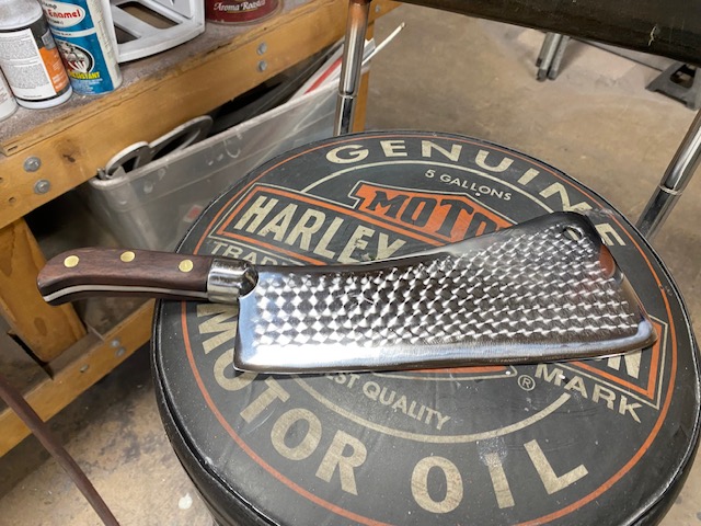

    This thread taught me a new trick, thank you. Here's a project I did for one of the guys on here. I taped off the edges to leave a border around the blade. Sometimes it works better than running the pattern off the side and this allows for the edge to be sharpened without losing the pattern. Great thread!
