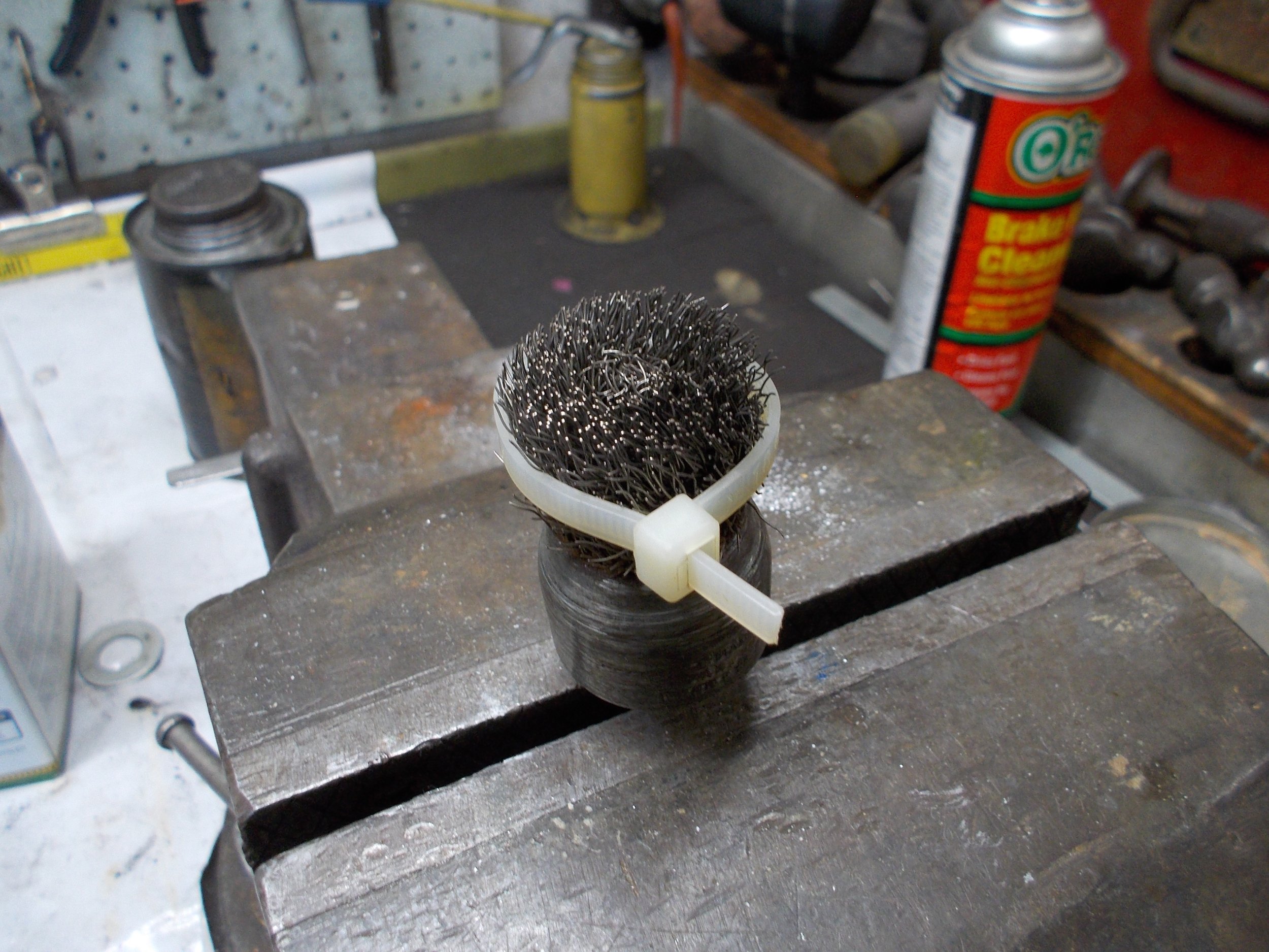

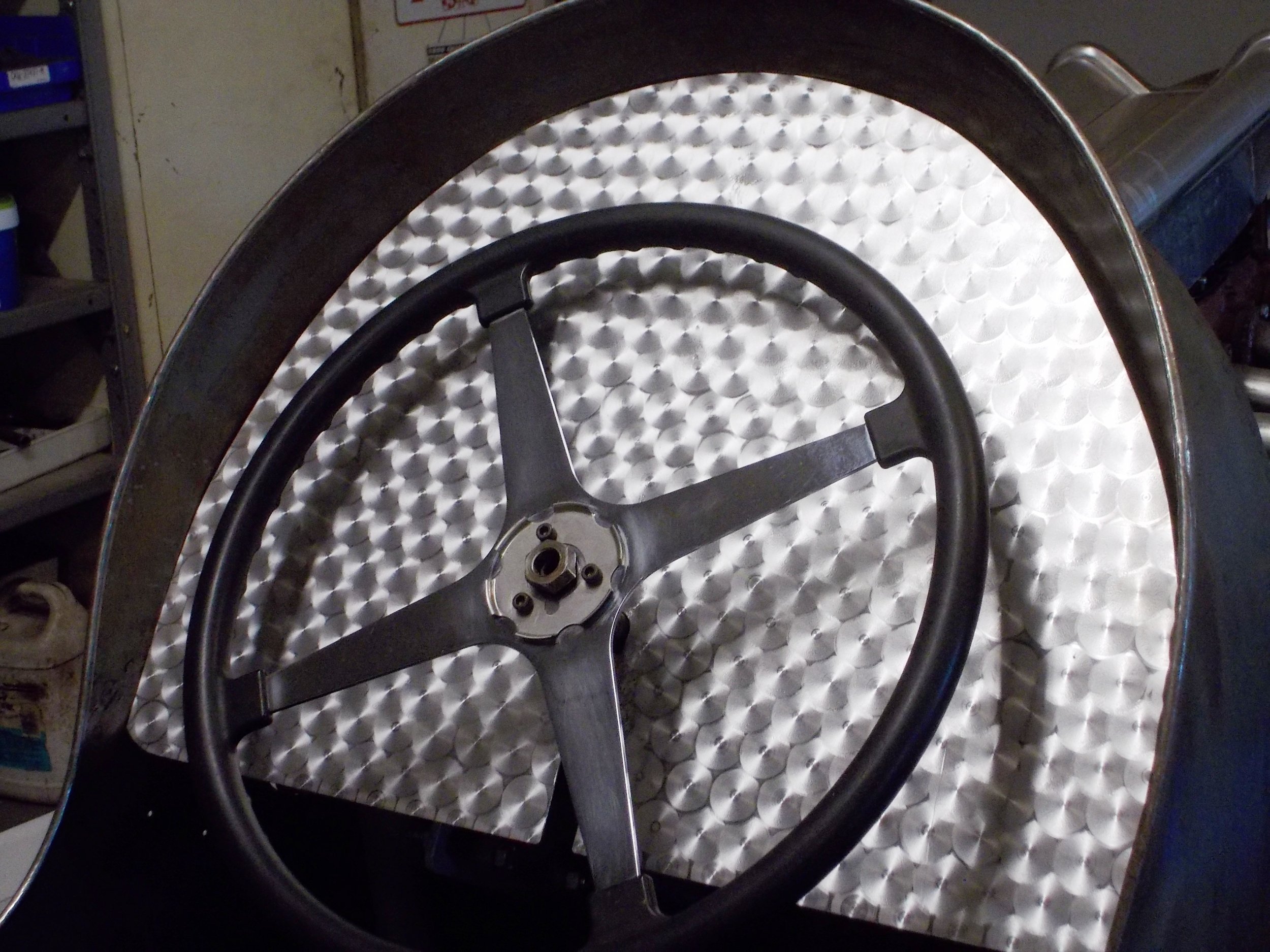

    In my champ car I used a tightly bound wire brush in a drill press. inst panl 04.jpg inst panl 10.JPG
