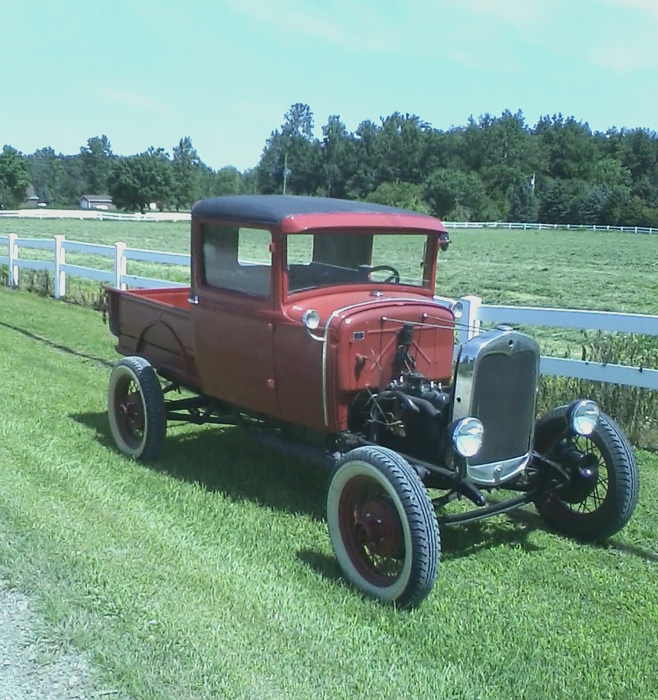

    Matt, Do you think you will make the E vs W run? I'm beatin feet to get my A there too! I just go the brakes working and took it for a spin around the driveway this evening! Here she is now, I'm hoping I'll have it ready for the run. If you make it I'll park mine next to yours, well that is if I get mine done!

    Its a tight fit, but I don't have a real seat back, just some old patio cushions. But that stinken steering wheel is the tough part when I brake or push the clutch in. The flat head run will be the shake down, I might have to do somthing else with the seat and or steering wheel, or go back to a later pick up.

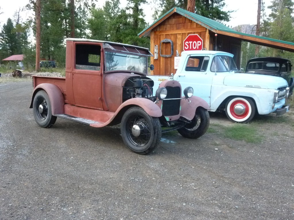

    This makes me want to hurry up and get the fenders back on.

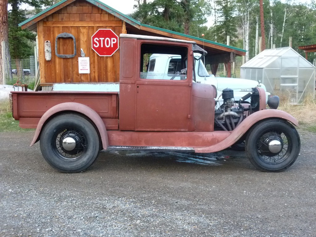

    Well, since I can't post pictures I might as well tell you guys. I pulled the windshield for new gl*** as it had a huge crack and I also pulled the tank for cleaning and to replace the welting as it was leaking water when it rains from between the tank and cowl side, which surprisingly is the only place water gets inside the cab

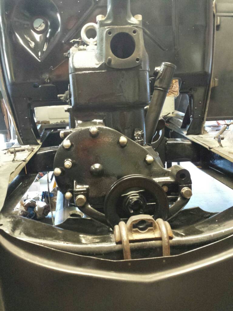

    Re ***embly thrash in progress. Hope to fire tomorrow? Or day after. Lots to do. No time for many pictures. Here is a firewall shot to hold you over.
