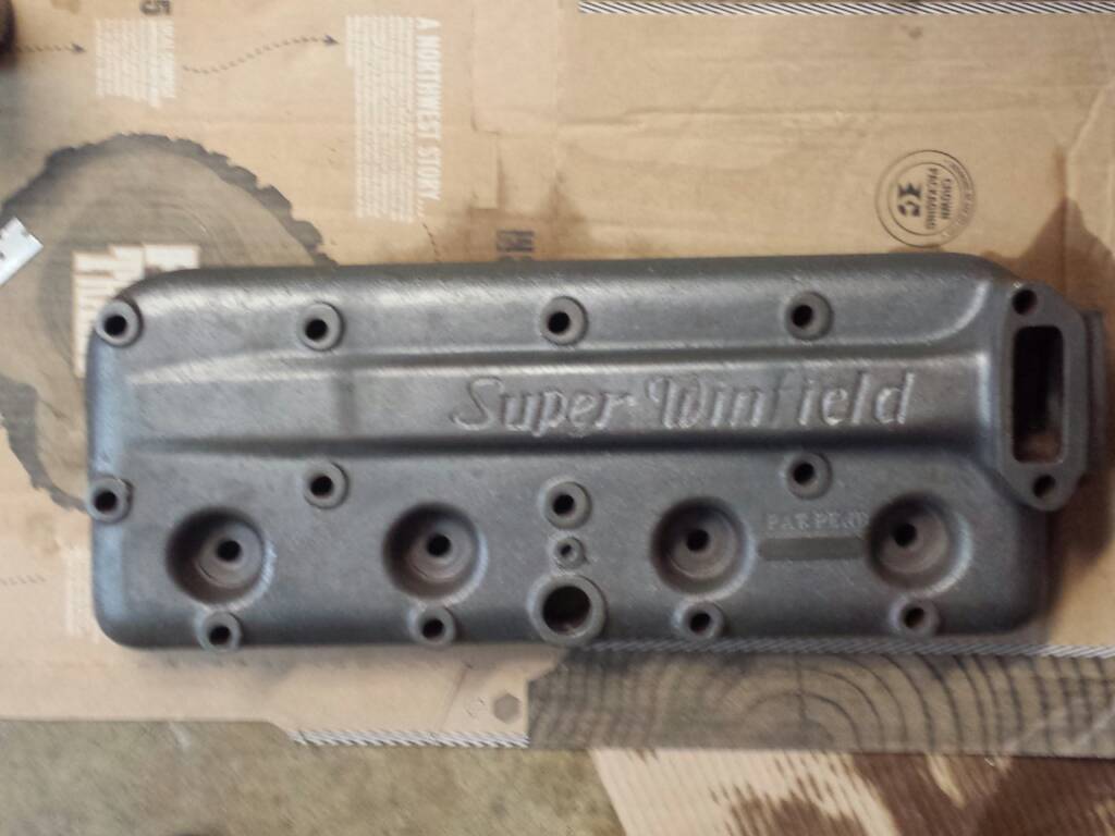

  4. Did some cleaning on this late last night.

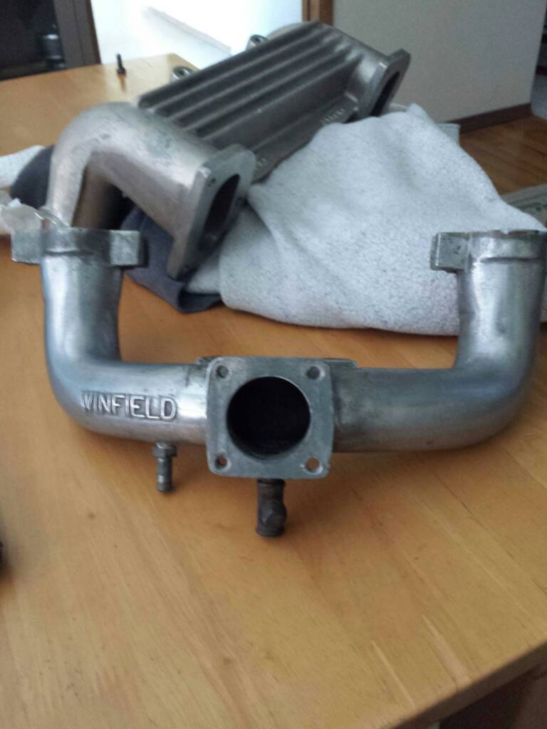

  6. I think the decision has been made for me... I am 99% sure the Winfield intake I have is a downdraft. The carb that was on it is a Winfield updraft setup as a downdraft, which won't work like that and all my other Winfields are updraft as well. So I 99% positive that the Thomas 2x2 will get the go ahead.

    I thought I read somewhere that you could convert the Winfields from up to down with certain parts??? But I could very well be mistaken!!!!!!

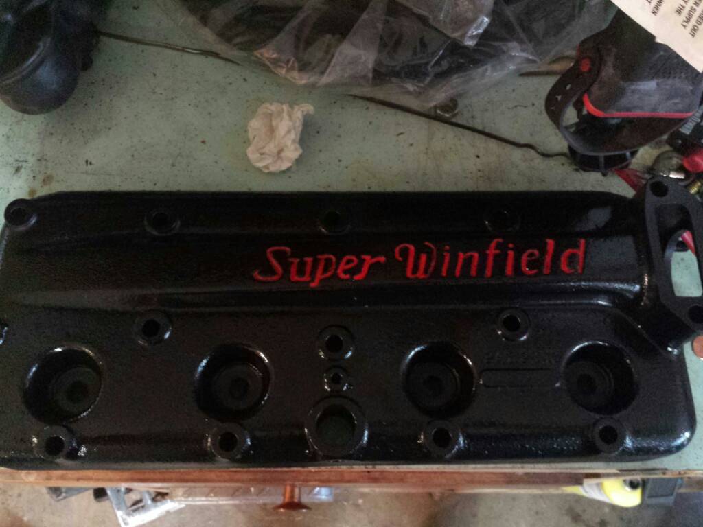

  26. Paint.
  27. Looks good!! You should paint the lettering a different color to help it stand out, and make you look even cooler!!

  29. Like this?
  30. Looks great. I'm very jealous.
