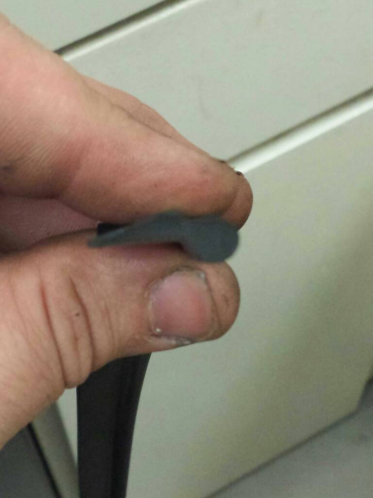

    Anyone know which way this faces on the windshield frame?
  20. olskool34
    Joined: Jun 28, 2006
    Posts: 2,636
    olskool34
    When I did my coupe, I put the part touching your thumb towards the car and the part touching your index finger towards the frame. I do not know if it is right, but it seals up nice and tight.
