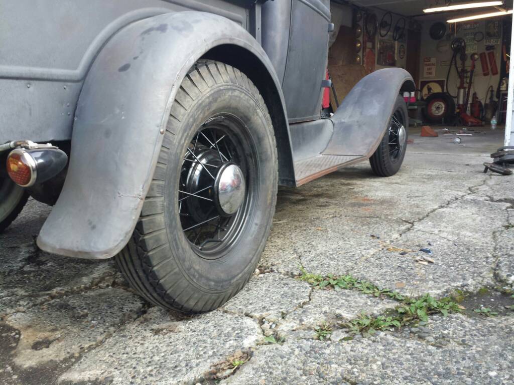

    Better side profile. Now I need to do something with the front. I'm considering a 32-36 axle and 17 inch front tires and wheels with mechanicals. Or maybe a dropped 36 axle with the same size tire, but solid steel wheels and juice brakes. Thoughts?

    I vote for 32-6 axle and 17" wires with mechanicals. You could upgrade to 32-4 12" front brakes.

    Yeah, the back looks good, fills up the fender perfectly. I'd say drop the front and keep the wires and tires in the pic. Cool truck!

    This is the way I am leaning, But I already have a dropped 33-36 axle and all the brake stuff, which would make that route financially more attractive at this moment, but I can also use those on the next project.

    You could throw a cougar through that gap between the top of the tire and the fender..............drop it!

    yeah man throw a dropped 32-36 axle under there the front has to go down a ways I would keep those wires on there they look too cool

    I'm really just struggling with "how much?"
    Do I slam it with the drop axle I have..
    Or
    Do I do a stock 32-36 which I believe is 1 1/2 inches lower VS a stock A axle and the a 5.50x17
    I think I am going with option #1 and will do option #2 with a different car.

    Maybe a three inch dropped 32-36 would work well then overall you would get 4 1/2 inches dropped

    So I am guesstimating that a 5.50x17 is around 29 inches tall. Which is close to the size of a 6.50x16 I have here. So I tried that on. Even with a 32-36 axle. It still doesn't get it anywhere close to the fender. I'm just going to drop it with what I have.
    Photoshop end goal. I actually don't think it will be that low in front and the rear is a little lower, so hopefully it will have a little less rake.
