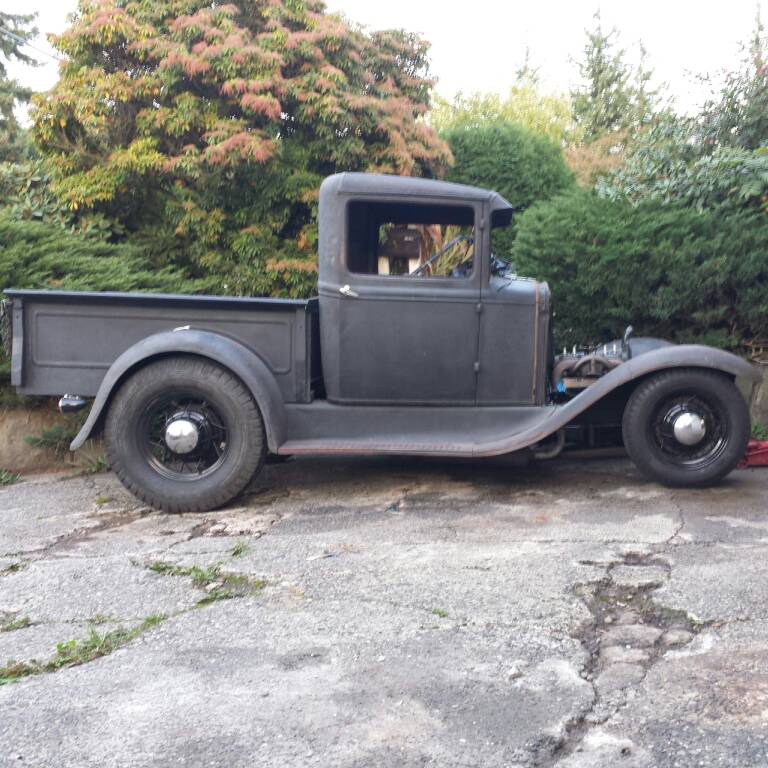

    Edit: dropped 36 front axle by 296V8. Reverse eye front spring, three of the leaves removed and cut,then moved to the bottom. Round back spindles. 40 juice brakes.

    If my '28 roadster comes out looking anything close to that I'll be tickled.........
    Looks right!!!

    Matt, that looks really good. Looks like a plan.

    So *****in! Here's my advise from experience: drop the steering hoop and shorten the pitman arm...it'll bump steer and death wobble like crazy if you don't

    You gonna try to figure out the mechanical brakes with the drop or just bite the bullet and go the juice route?
    I'd like to see how it looks with 17's up front. ***y I'd imagine...

    Thanks! It's all bolt on stuff. I know from your other cars whatever you do it will be *****in.
    thanks!
    Thanks dude. Definitely going to do both.
    thanks, Yours is looking rad too.
    Thanks. You know I was looking at it and I don't think it will be that hard to make the mechanicals work. But I also am pretty sure I figured out how to bolt a master in without cutting. which would make the juice brakes a bolt in. With the amount of miles I put on it already, I would prefer to go with the less maintenance afforded by the juice brakes.
    Now that I have the axle in I am fairly excited because I am pretty sure I can fit a 5.50x17 in there. Which will help fill out the wheel well a little more and would raise the front up just a little. I have a pair of 17's for the front, but no tires yet. I'll probably make that change in a little while as what I have works fine for now.
    thanks. It seems to have worked out.

    Pretty low.

    Ahhhh...........................that ain't low. Low is when worms scream in terror!;)

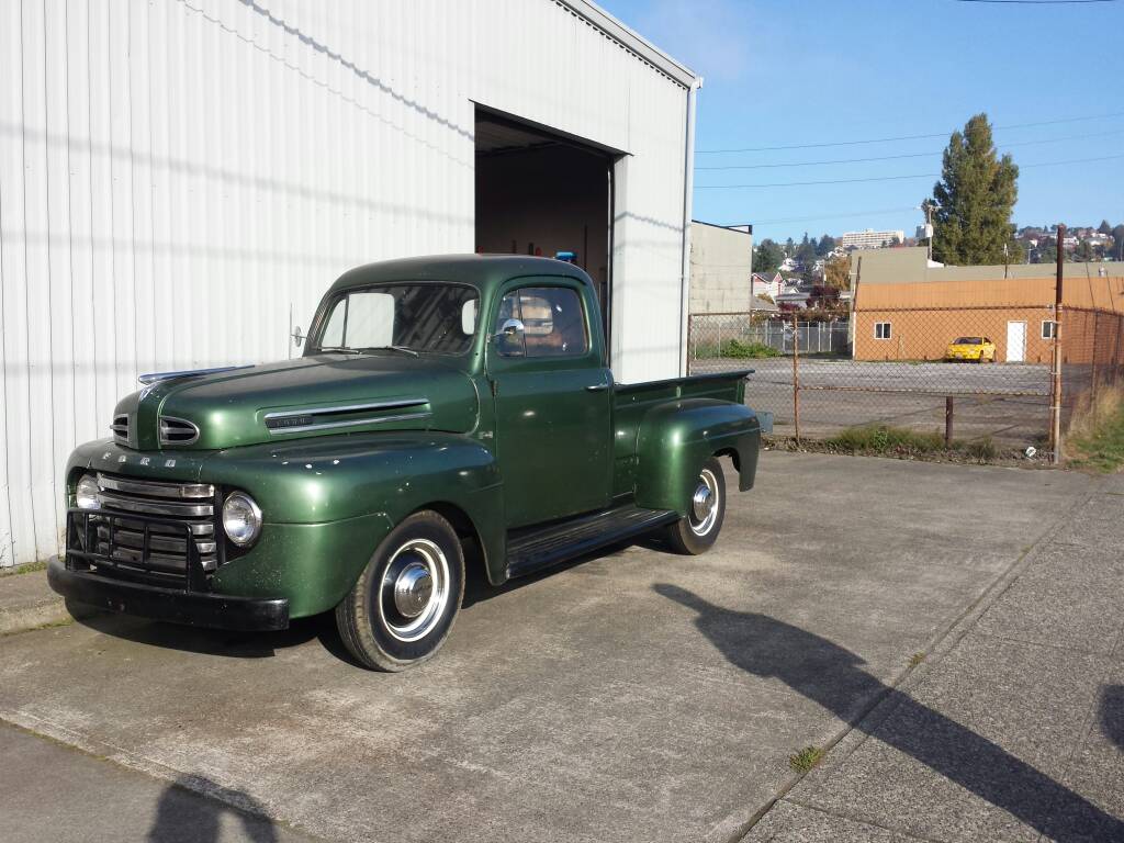

    Thanks guys, I'll look in to everyones suggestions. Also I picked this up today.
    brEad likes this.
  24. Chris
    Joined: Jan 5, 2005
    Posts: 14,500
    Chris
    Nice looking F1. More pics!!!
  25. Hitchhiker
    Joined: May 1, 2008
    Posts: 8,507
    Hitchhiker
    Just the one from the day I sent picture to you. I will grab more tomorrow.
  26. Looks like that green truck has had a well taken care of life.
    Congrats!
    I dig the grill protector
