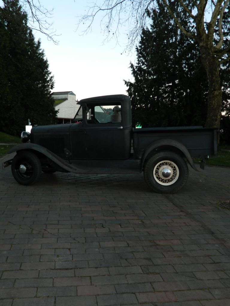

    Well, I've been driving and thinking for the last couple days now about what I want to do. Basically just getting to know the truck. It runs and drives pretty damn good. Fires up easy. It has good power. No problem keeping up with arterial speed limits. Braking isn't as bad as I expected, but still leaves a lot to be desired, but sure stops better than J scow's t RPU on a stock A ch***is. The one thing it really needs is a steering box rebuild. I'm not sure if I should keep and rebuild the stock one or use the f1 steering box I have. I had originally wanted to AV8 this thing, but that was before I knew it had the original engine. So the v8 is out. Besides. I figure the 4 will be fine around town. The pickup is to small to make lots of major road trips, so around town is really all it will see 99% of the time.
    I forgot that it does have a reverse eye front spring on it already, so check that off the list.
    here is what I am currently thinking of doing.
    Stage 1:
    I have a set of some 7.50x17 wires for the rear and some 5.50x16 firestone ribbed fronts I will run for now. I just need to paint the wheels black. and mount the tires. I hope to get that done this week.
    Stage 2:
    Either drop a model A front axle or use the 36 dropped front I already have
    F100 brakes
    f1 steering----- maybe???
    reverse eye springs front and rear.
    6.00x16 and 7.50x16 firestones on solids. (have the rears already)
    Stage 3:
    B engine. Counterbalanced crank, full pressure with inserts. 7:1 head. Downdraft carb. header and cam.
    v8 trans maybe a Columbia rearend.
    dropped headlight bar. Brush paint black .....done...:cool:

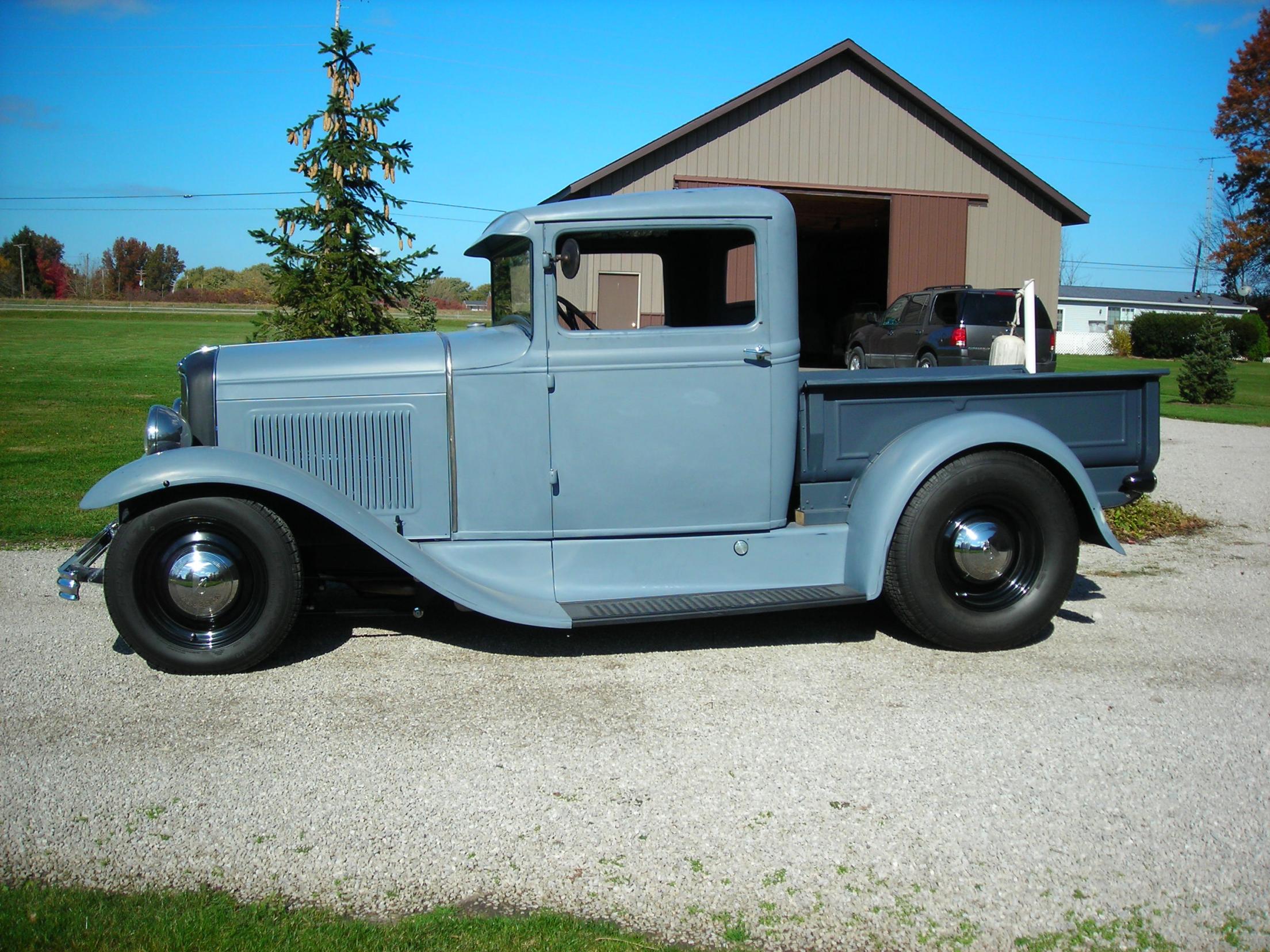

    Congrats on your truck I'm sure it will turn out fine. Here is a pic of mine I have owned it 48 years bought it when i was 13 still working on it. Good Luck and have fun!

    Well I got some new wheels and tires on it today. I was going to try and dismount the rears so I could paint them. But I'm afraid I might tear them, as they have been on there awhile. So I just threw them on. I will take them off and mask them asap....or maybe paint the fronts white. As I think it looks pretty good too.
    They are 5.50X16 firestone ribbbed fronts and Denman 7.50x17 rears.
    They totally change the at***ude of the truck, along with making it ride and drive better.
    Chris gave me a lowering spring for the rear with it, so I am going to give that a try next.
