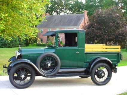

    As for paint, I really like the dark green on Model A trucks. It just seems like such a 'utilitarian' color...

    Something like this...

    I just see this truck with darker colours. I feel it fits the build and stance more so than a red would. If it were mine, I'd be painting it a darker green with black fenders.
