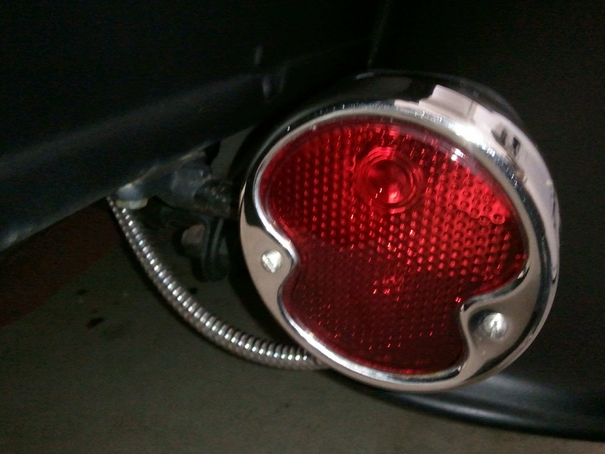

    I love the new lights!
  30. Hitchhiker
    Joined: May 1, 2008
    Posts: 8,503
    Hitchhiker
    thanks dude!
