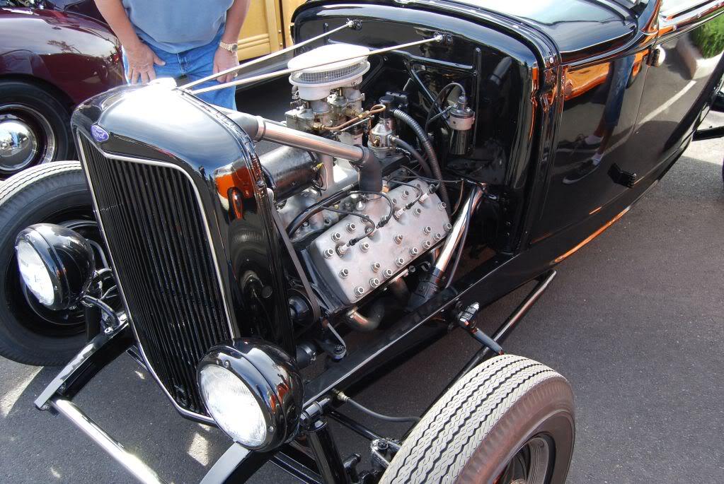

    I'm also using a F1 column in my AV8. I ordered a set of flathead headers from Red's. Just called them up and told them what I was building and they whipped out a set. Got them in about a week and they fit great with plenty of room for the steering box. Well worth the $$

  6. Mine's a '32 frame, but if you look at the pic it should give you an idea. You're goig to want the box almost touching the inside of the rail to give enough room for exhaust and cylinder head.
    If you don't have any luck with that trade maybe we can work out something for the dash rail I have.
  7. Thanks for the picture! thats Kinda what I figured. Now I need to get a hole saw big enough.

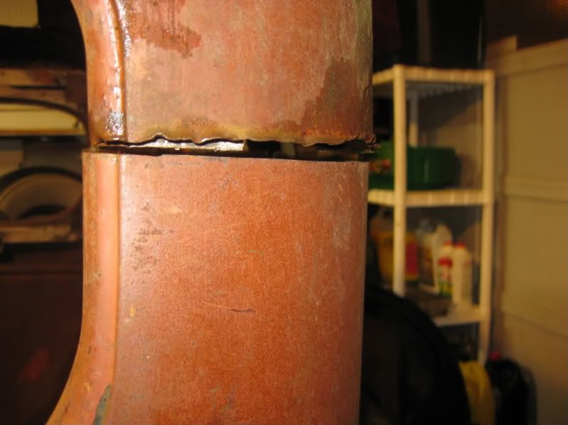

  11. I got a lot done today. The body is almost 1 piece! I've got everything tacked where I like it and solid. I started to finish weld, I don't know what it was today, but I was burning through sheet metal like nobodies business. :D Luckily I ran out of wire. I think it is because this thing has horrible gaps that don't match each other. All the tight ones weld fine. but the big ones I burned through easy. Hopefully this thing won't look to hacked together when it is done. :rolleyes:

    Sounds like its coming together. Did you ever get the rough chop sorted out?
  14. I hope to have it running by the end of the year, but you know how goals go...:D
    Where it is curled on the back or the act of no bracing? I basically measured the door gaps so it matched side to side as best I can. As far as the back where it is curled I've tried straightening it a little, it hasn't worked great. I think I should have done it with the roof off the car. It's to late to do that now. My basic plan at this point is to get everything else welded up, then I'll cut out the curled metal and replace it with the cut out pieces from another chop I have. I think that will end up the cleanest.

  16. I'll I have to say today.....Is gaps are super important! The gaps are so bad in some places I'm not sure what to do. I'm about ready to buy another body and throw this one in the trash:mad:.....or take another inch or two out. not sure what to do at this point.

    Why not make the gaps a little wider in the bad spots and weld in a filler strip? I have cut out material and then welded in a 1/4" to 1" strip when there is too wide of gap to start with or too thin of material.
    Don't get discouraged. Some times you need to just back away from it and come back on a fresh day.

    Hey... if it was easy, anybody could do it??? Hang in there and take your time... Sometimes you can use a backup block like a chunk of alum. or copper to help keep from blowing thru...

    You might consider cutting that lower lip off the top edge and either having a bit more of a chop, or replacing it with a new piece. Because the thickness is not consistent and because its still a little raged, the metal that you've straightened will tend to wander in different directions once heat is applied. Same thing happens when you use too much filler rod, inconsistent cooling results in little buckles in the metal as it shrinks.
