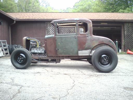

  6. Also does anyone have any opinion on how far to have my axle dropped? I'm thinking 3 inches and keep it 49 inches wide. But maybe there is something I'm overlooking as far as the relationship to other parts and a less severe drop is better? Just checking really. Obviously you want a narrower axle with fenders. I personally like wider axles on fenderless cars like mine so I want to keep it as wide as possible and as low as possible.

    It's easier to raise a car back up than lower it down, so i'd get as much drop as i could in my axle.
  8. Are you talking 3" total drop, or 3" more drop? If 3" more, that would be equivalent to a 4" overall drop which is about as much as I think you'd want to go without it looking "stretchy". You'll lose a little width, but I think it stays around 48-9 inches. All these numbers are approximate, but close. Have you talked to Adam yet?
  9. I am talking 3 inch more. About the limits before it looks stretchy from what I have read.
  10. I pushed the car outside to look at it today.
    Side view
    Last picture with the undropped 36 axle to be sent out this week.

    Nice '36 axle, I just got word there's one for sale near me. Looks like there's no issues with the spring perch's, reversed spring and wishbones. Right on keep up the good work!
  12. No issues yet, I'm sending the axle out this week to be dropped and then we will see about the steering. Thanks for the compliment.
  13. I didn't realize you had a '36 axle, thought you were using Model A. You might want to only add another 2 inches of drop to the '36, 3 additional on that one would get you to a 5 overall and might be more than you want. The mockup is shaping up nicely.

    Im not positive, but I think mine sits a little lower in the rear then yours, lookin great though brother!
  16. Thanks Bob, I'll take that into consideration.
    Remy's gonna have a sweet car with that Tudor. The body looks in great shape and I love the color.
    I think yours does sit lower. I haven't really played with the rear spring to much yet, so I am hoping I have some more drop there.
    Thanks for the compliments guys.
  17. So just measuring my 36 axle it has 1 1/2 from the factory. I want 4 inch total. So I need 2 1/2 inches.

    Just wondering, how have you come to wanting 4" of drop in the axle?? is it that you know that much works? or some other reason.
    It may sound like a dumb 'Q' but, I'm just curious??
    OB
  20. I saw a picture of a 4 inch total drop on a 36 axle by the guy who is dropping my axle. I really liked how it looked. So that is what I am going with. Also 4 inch total drop seems to be a pretty common drop height on aftermarket axles.

    You might want to set it up running a little higher than you want to end up with. Things will settle after some initial driving, and it will get a bit lower. Once everything is settled, then look at making fine adjustments to get the height you want.
    Just my opinion, but those rear wheels are very big. nothing wrong with that, but I'd say they are better matched to the undropped 36 axle, (which is already dropped relative to an A axle), and the car might look a bit too cartooney with the extra rake brought on by a dropped axle. Or the dropped axle might look better with 16's on the back.
    hard to say from so far away, but just saying what was going through my mind.

  27. When you are talking dropped axles, when a guy says 4 inch dropped axle, that is not the ammount it has been streched, it is the total ammount of drop. A 1936 axle has a 1.5" drop over a model A, so it is dropped another 2.5", making a "4 inch" dropped axle.
