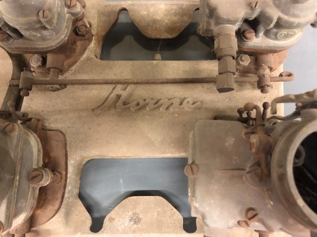

    Looks like I have a Oldsmobile one that hasn’t been accounted for in Wisconsin. It’s been on a shelf in my mom’s garage for probably 25 years since her late husband brought it home.

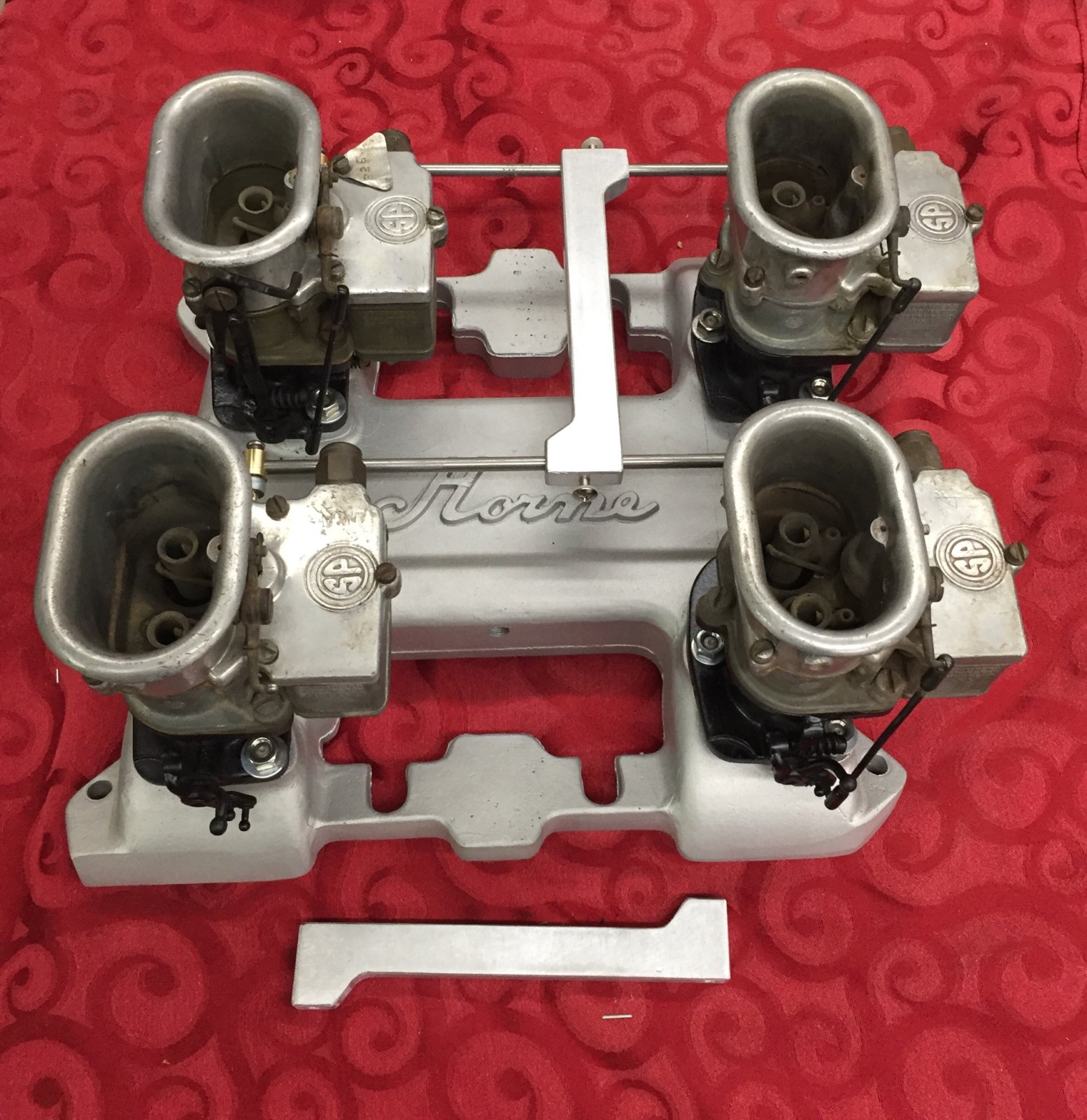

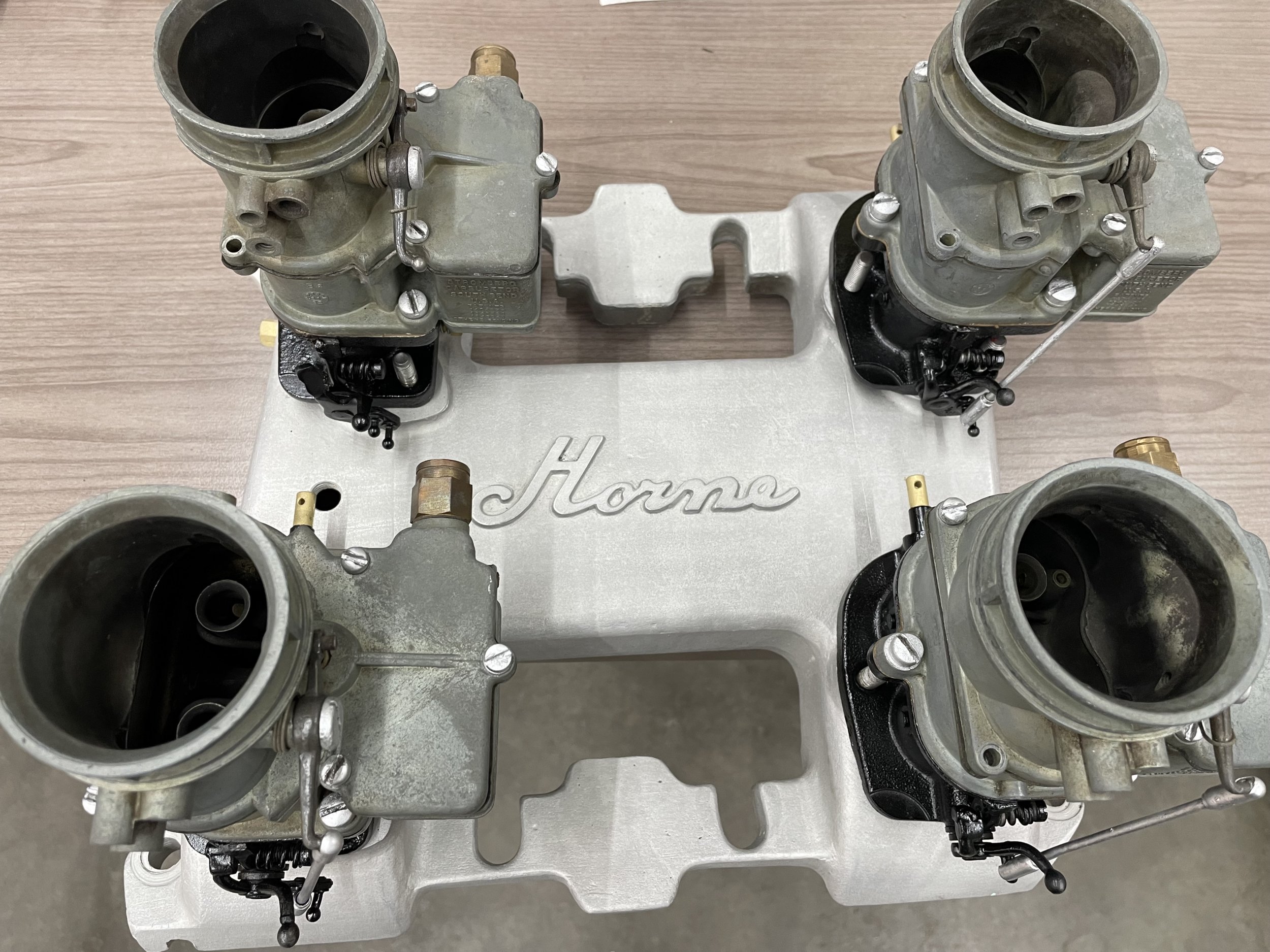

    Quick trip through the bead blas cabinet and 4 large number 97’s with SP tops, just have to make the dog bone and the linkage 3D66806F-7D91-4A42-A003-05DA4C0B2A26.jpeg

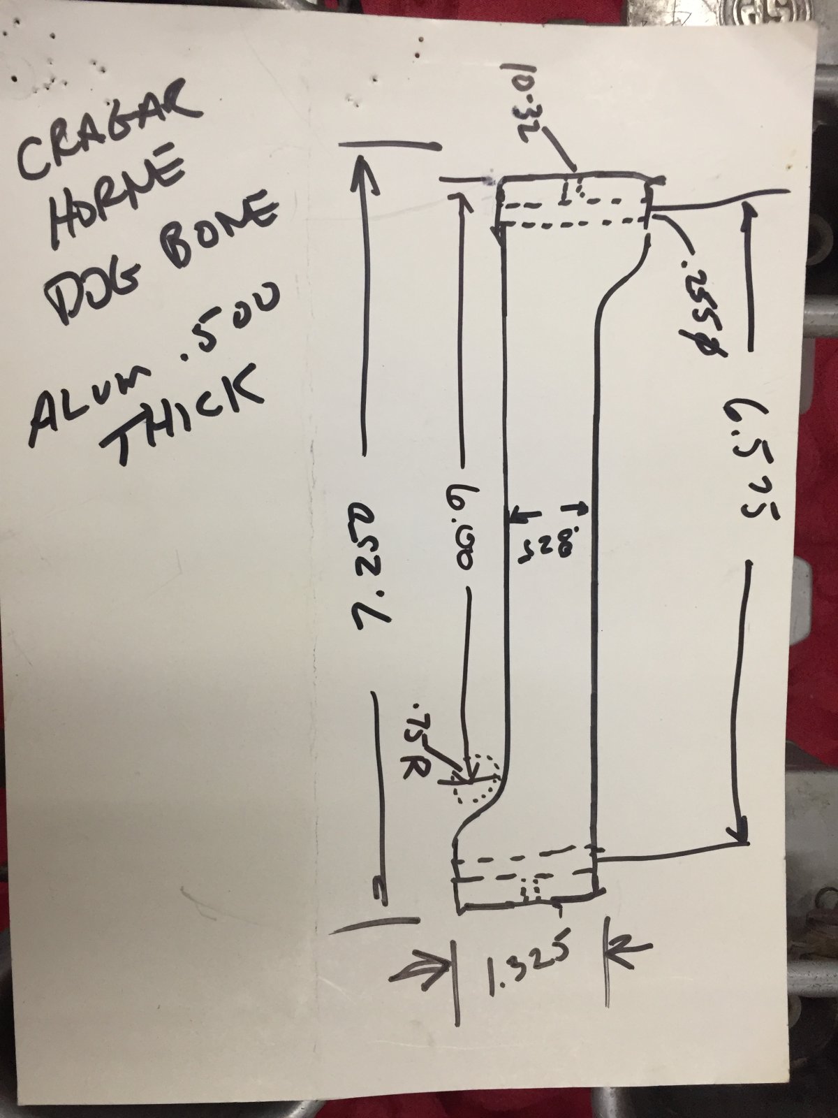

    Awesome Mark! Make me one Too? Dogbone? I'll pay you! I need to add to my Moriarity Coolness..

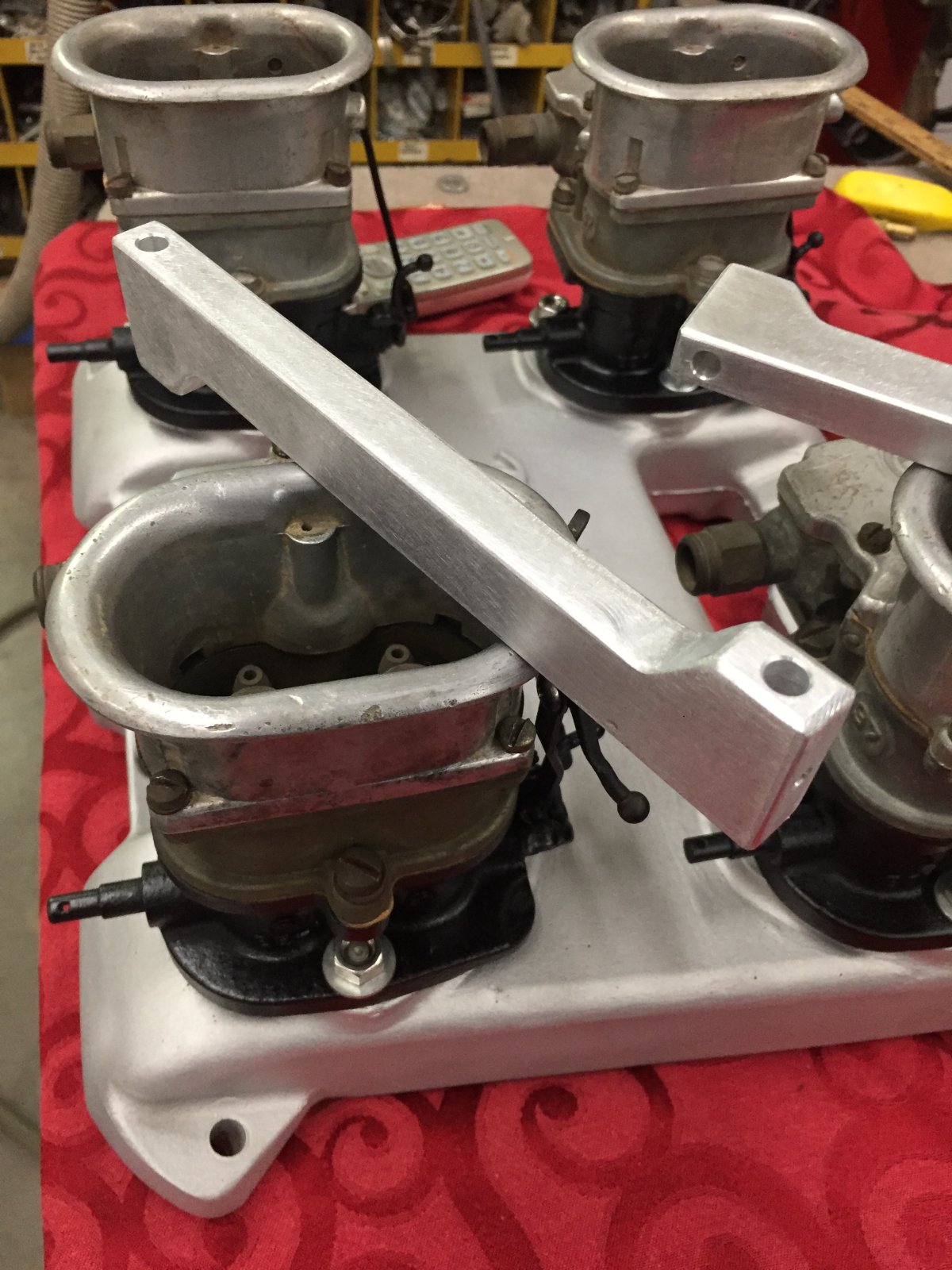

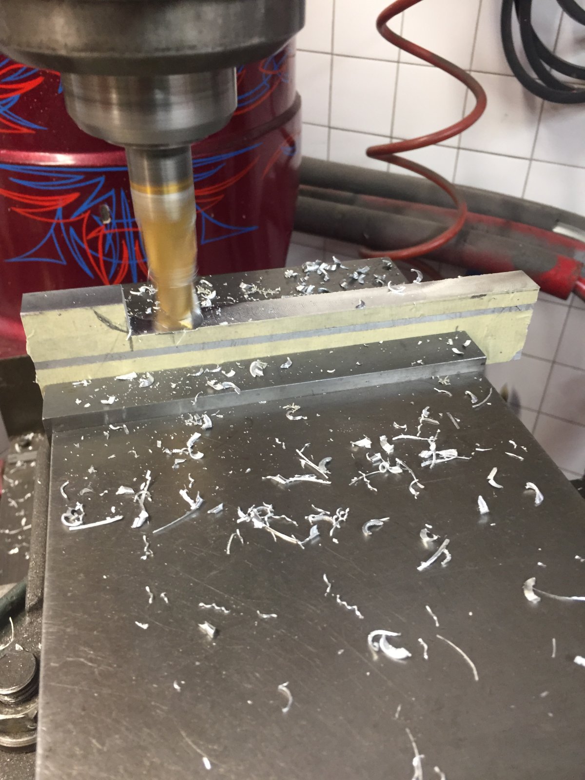

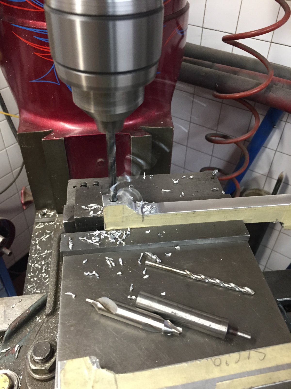

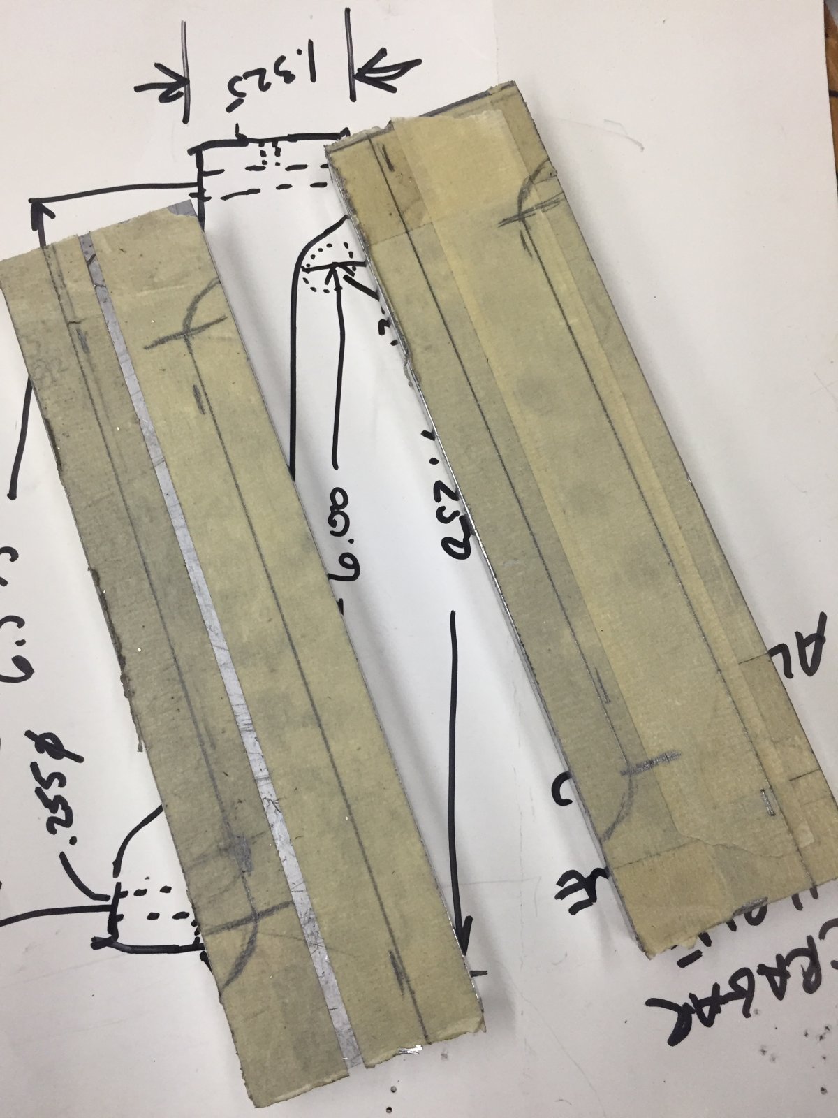

    Dogbone and linkage

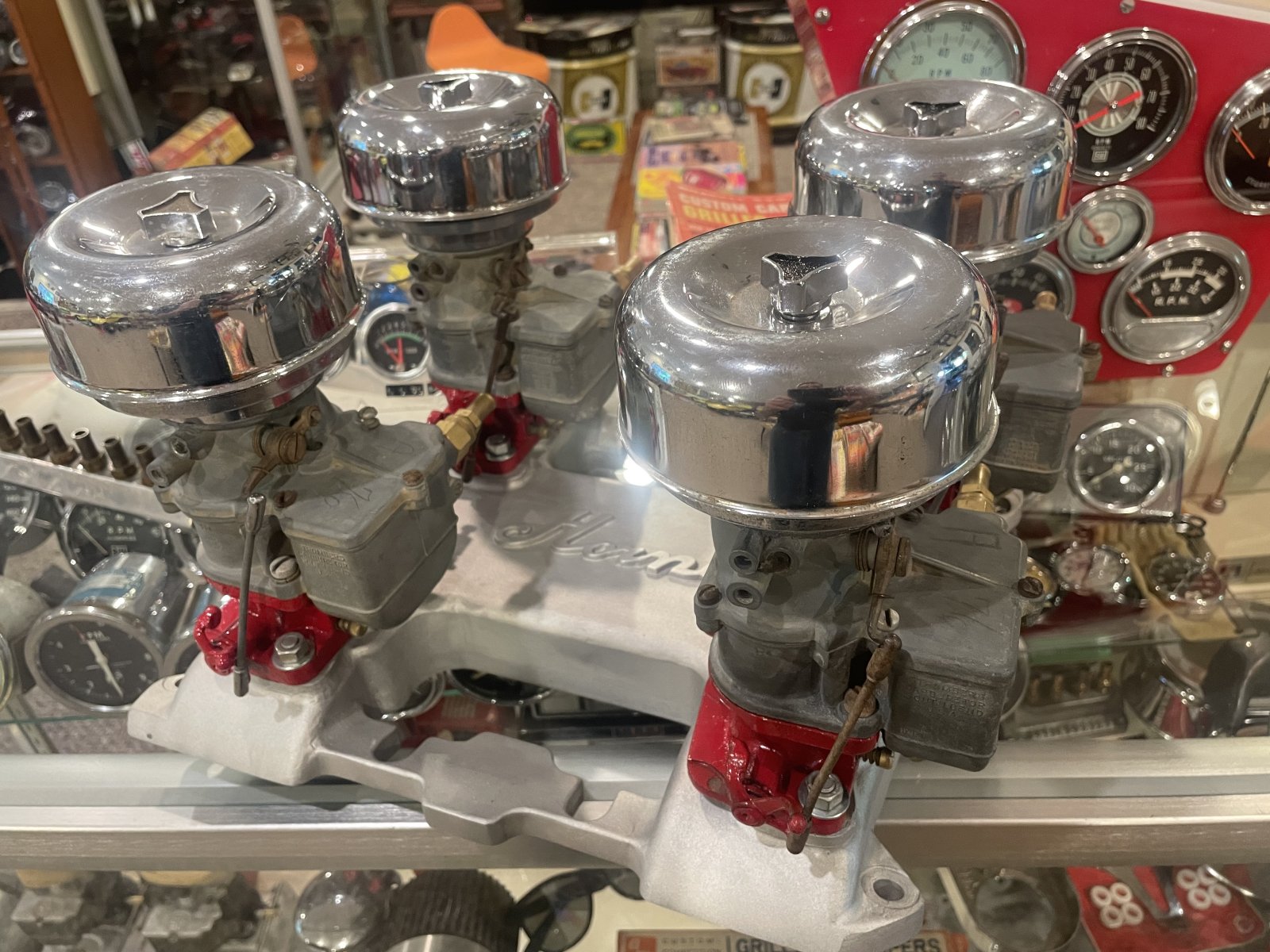

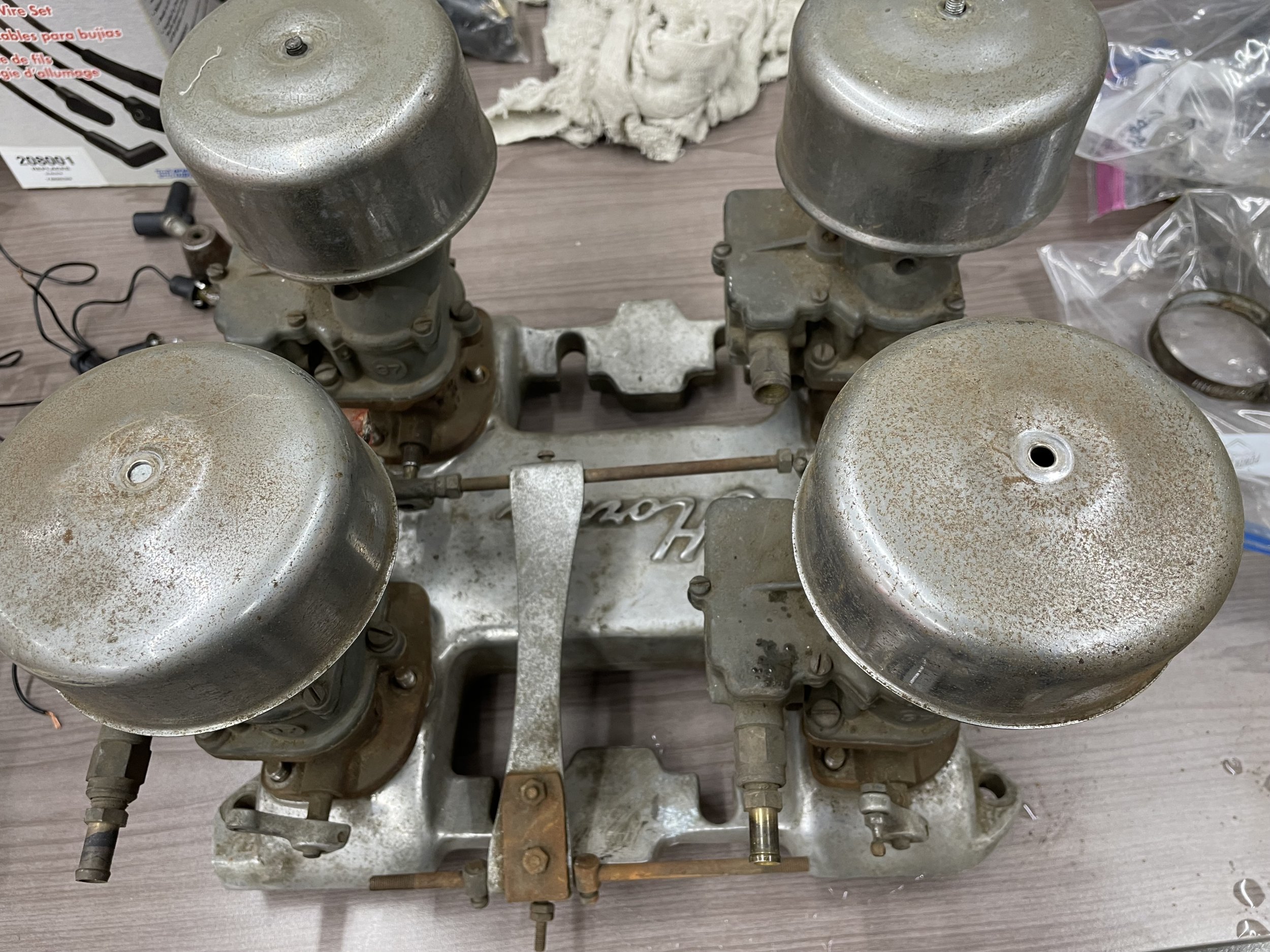

    Picked this one up a few weeks ago. I currently have 3 caddy horne manifolds

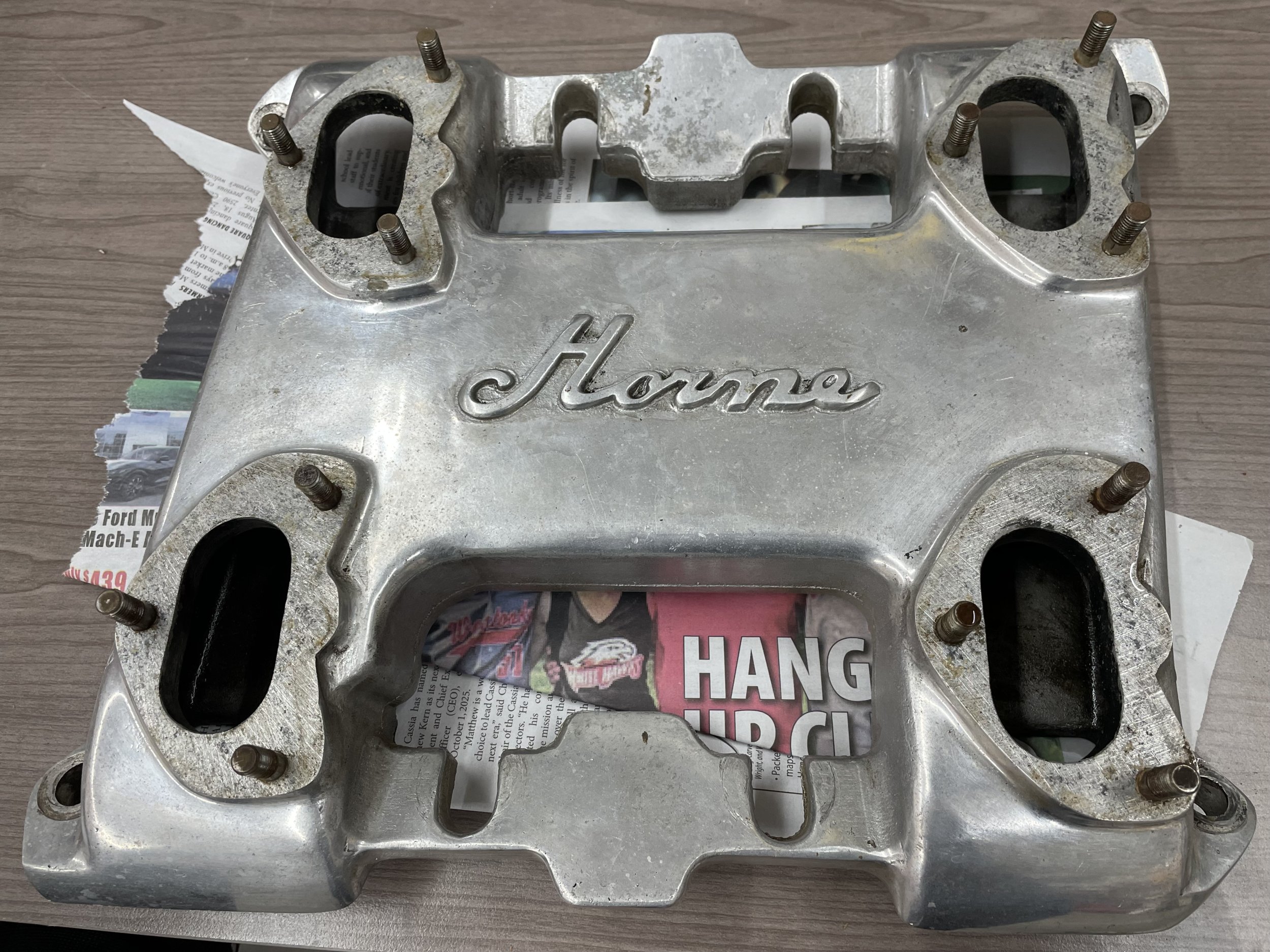

    After a soap and water wash, look at that… polished. It was so filthy that I didn’t know

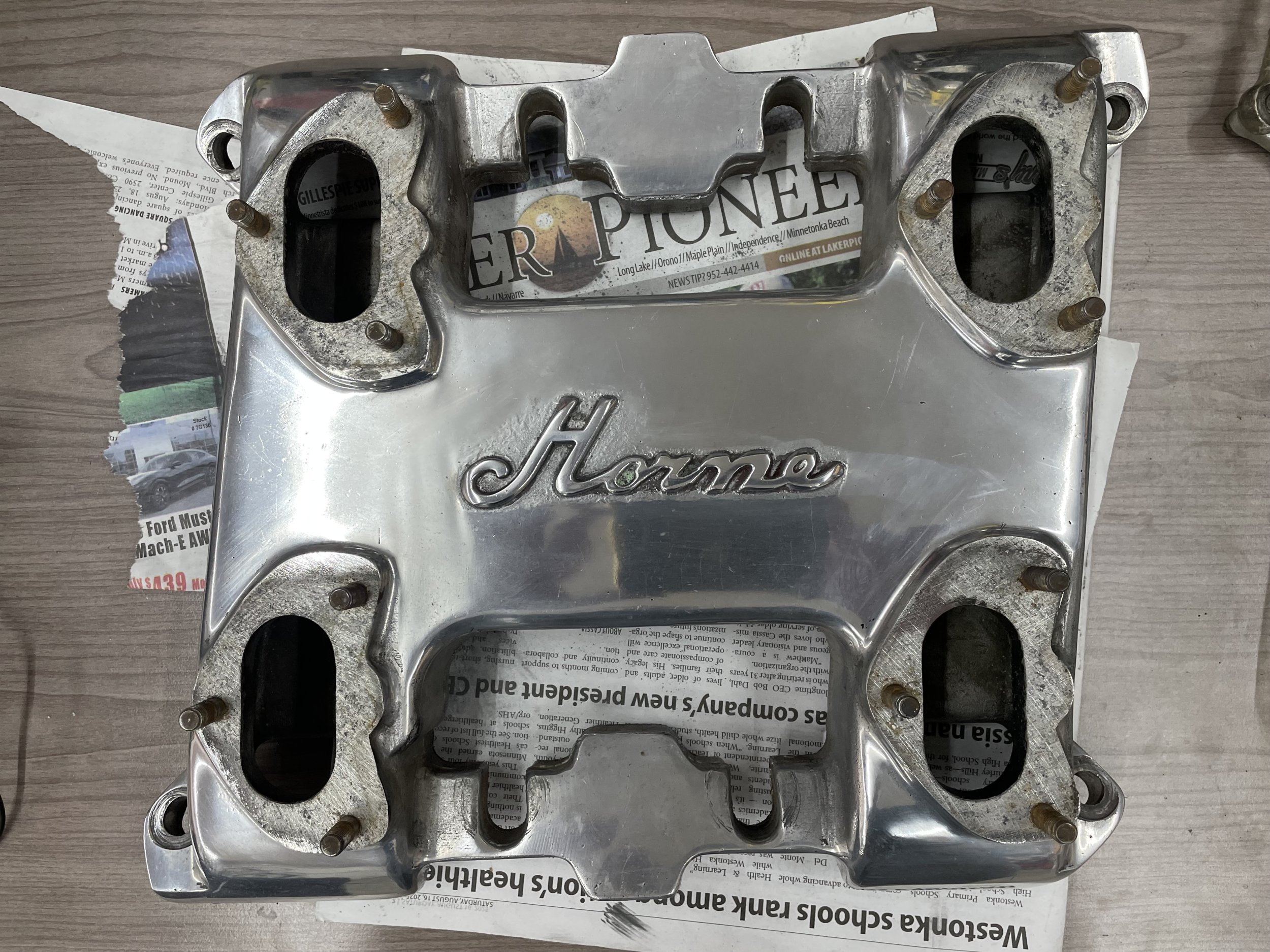

    Shined up ok
