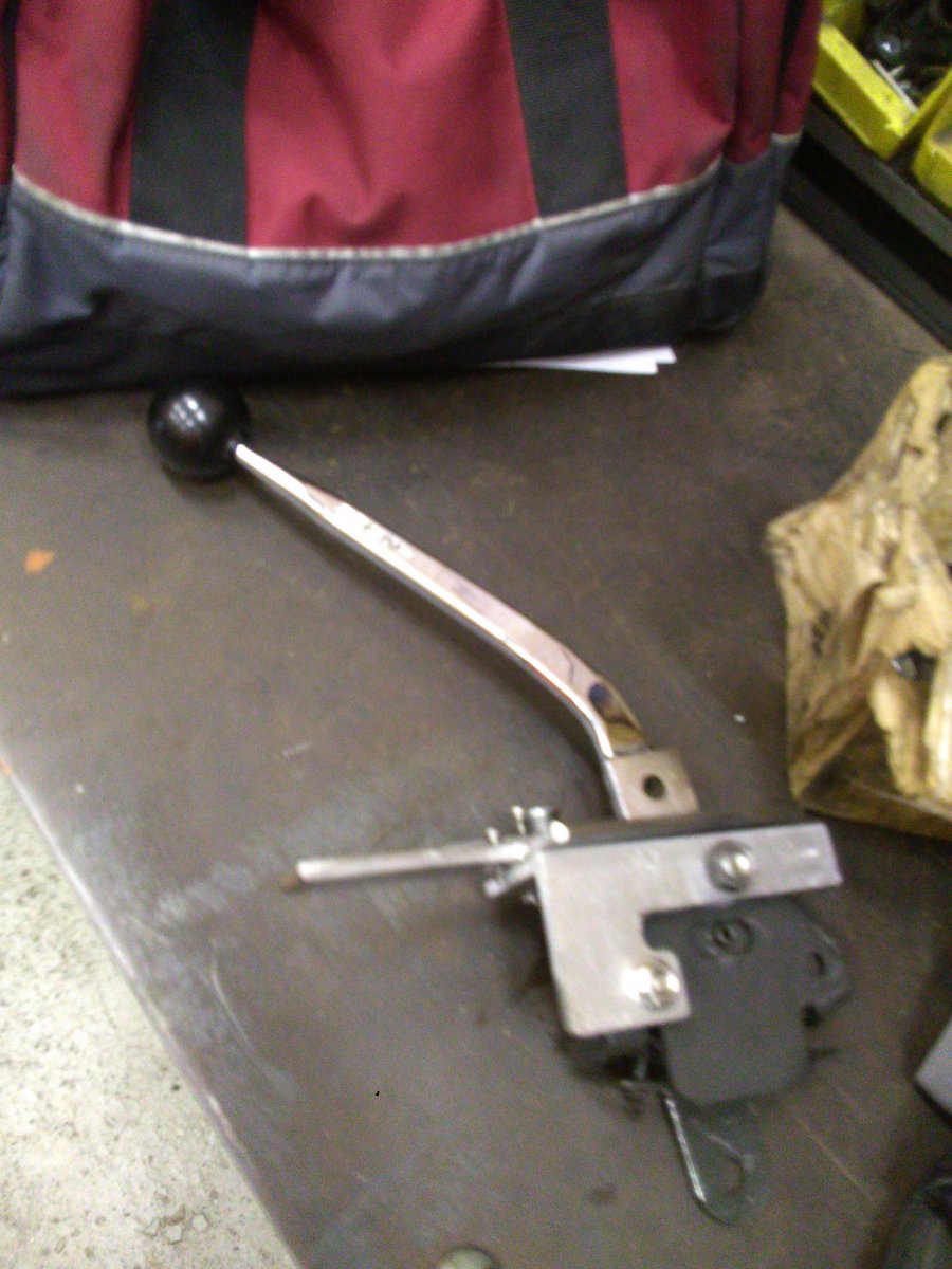

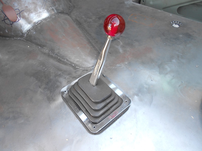

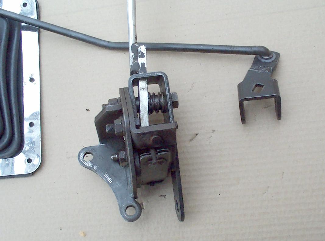

    I am so thrilled, I just scored a Hurst Auto Stick I shifter for the Turbo 400 in my car. I had one on a 64 Pontiac once and it spoiled me. They look and feel like a four speed and have a gated side for racing. They bolt up to the transmission and have direct linkage..
    Are there any other Autostick fans out there?

    Lets see, I currently have four of them. And had a very rare Powerglide one in the 51 Bus Coupe. Bolt on and welded on sticks, TH350 and TH400 mounts. They should start making them again; they would be flying off the shelves.

    This one has the welded on lever, my last one was bolt on. I may cut the lever and make it a bolt on. It would be easier to install..

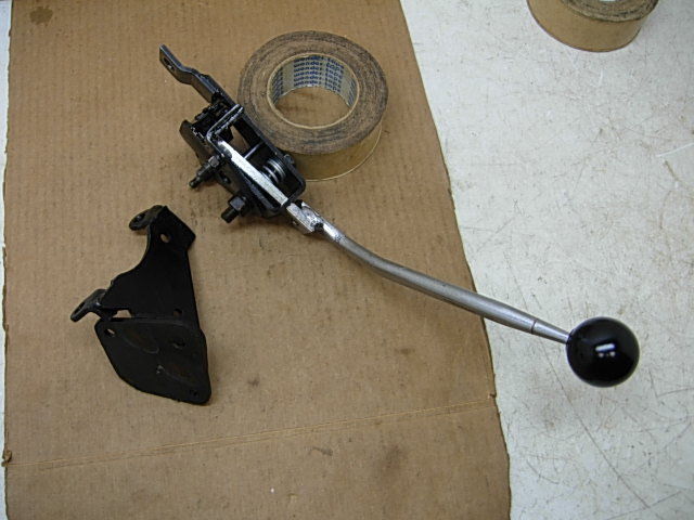

  8. Elcohaulic
    Joined: Dec 27, 2017
    Posts: 2,213
    Elcohaulic

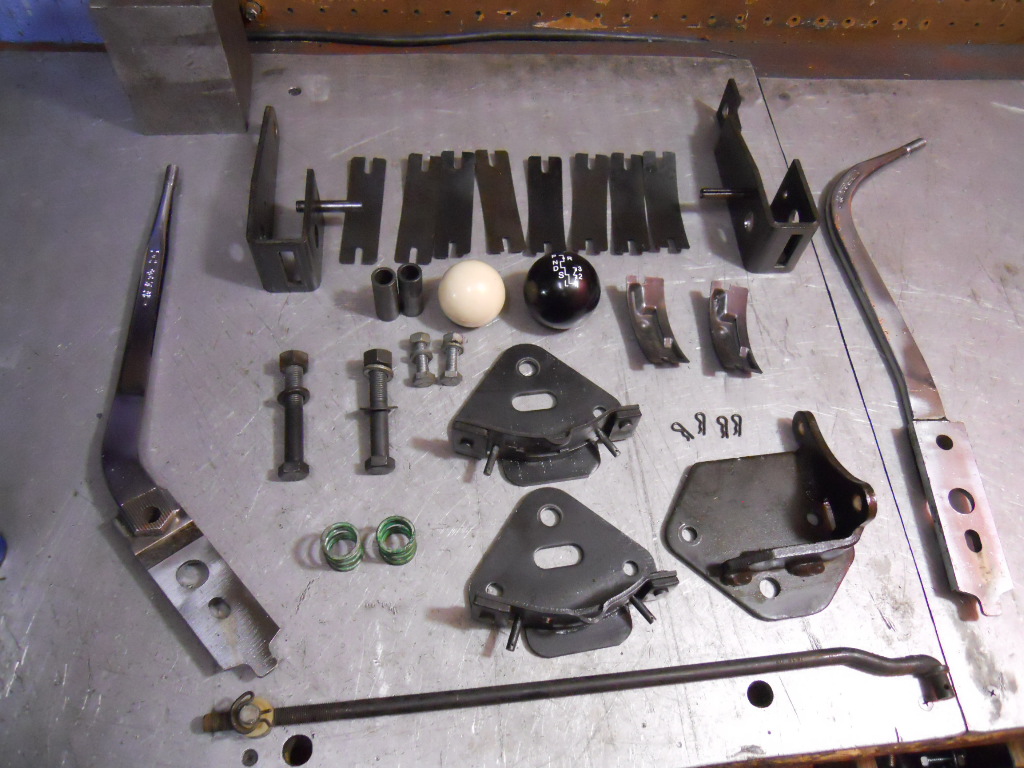

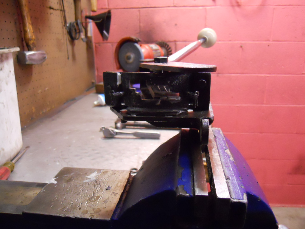

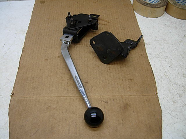

    I have two of them now and took them apart today. I just cleaned them up with baby oil. I don't want to remove the black plating they come with.. I should be able to build one nice shifter for my th400... One handle is for bench seats I believe..

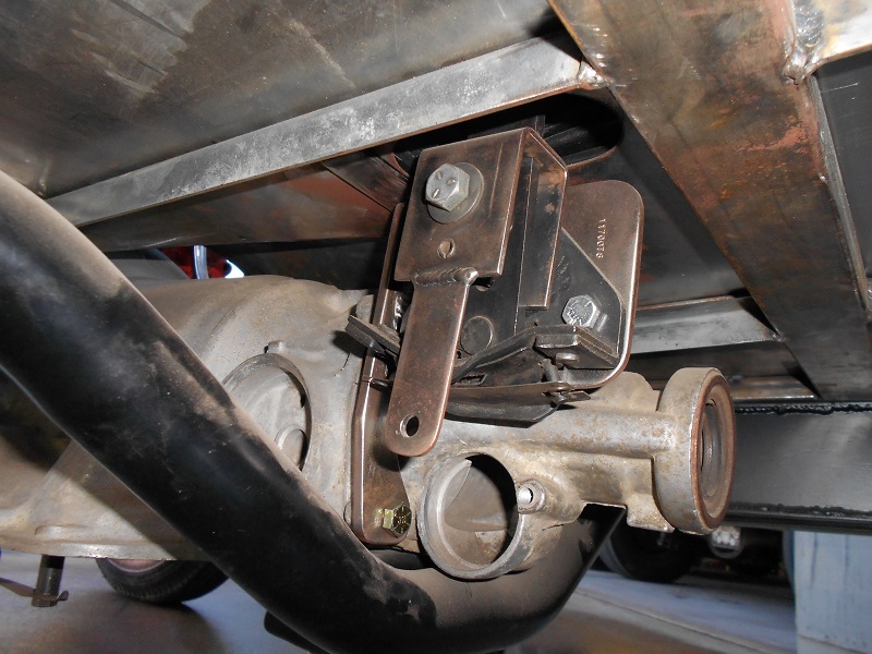

  10. Elcohaulic
    Posts: 2,213
    Elcohaulic

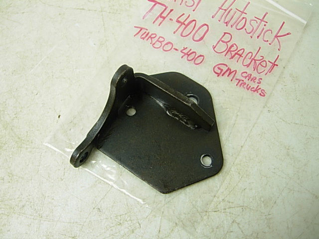

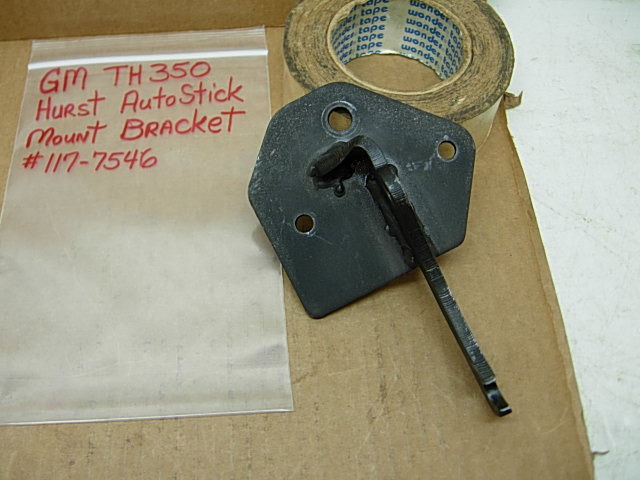

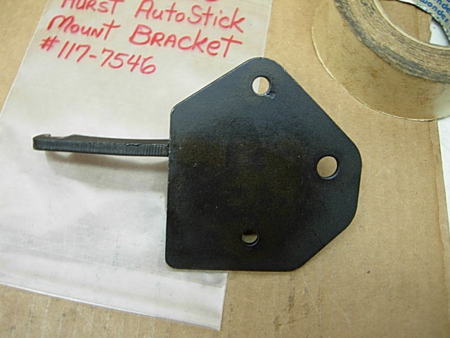

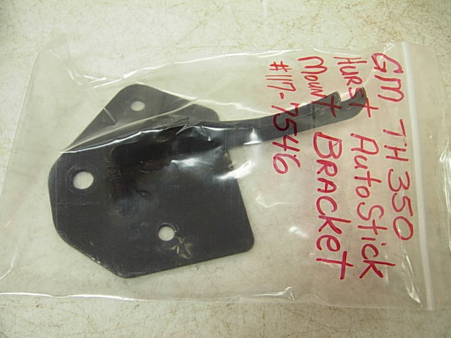

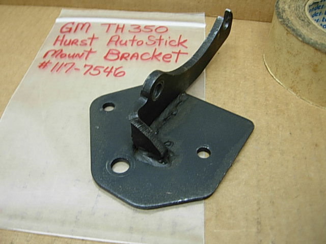

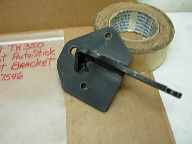

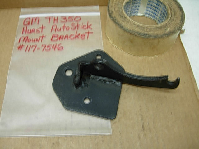

    The Turbo 350 bracket..
    chevy57dude, 1Nimrod and loudbang like this.
  11. Elcohaulic
    Posts: 2,213
    Elcohaulic

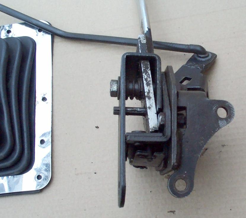

    The Turbo 400 bracket..
    1Nimrod, hemiuk and loudbang like this.

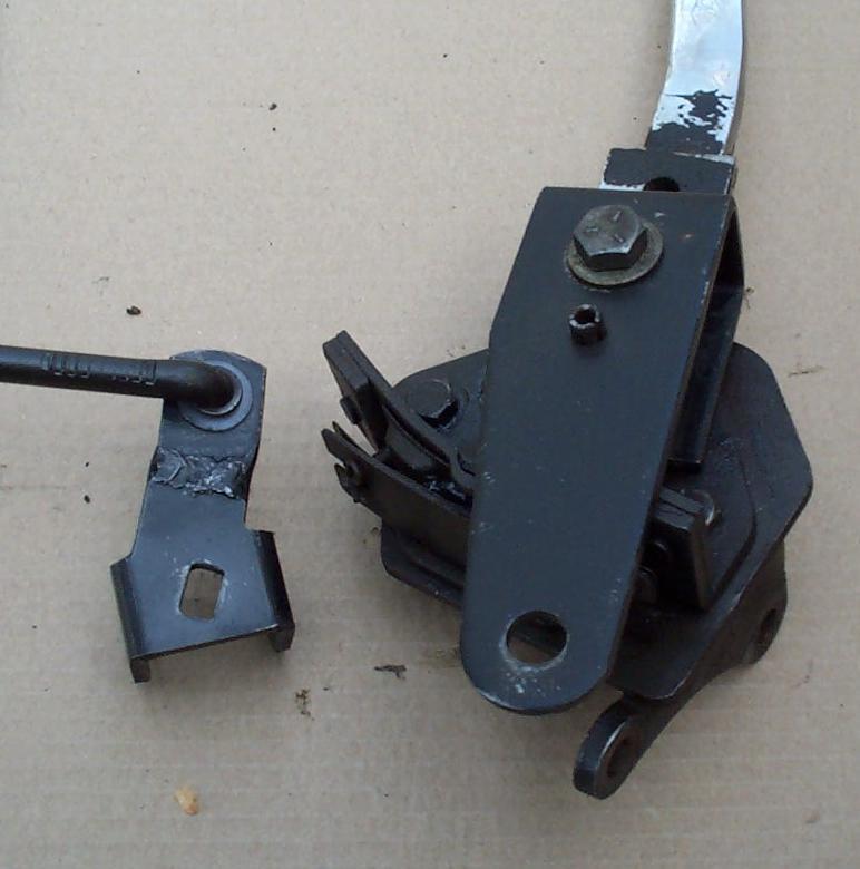

    Here is a few pictures of the Hurst auto stick we installed in Dads Dodge coupe. We started with a NOS auto stick kit for a Torqueflite and ended up with a later auto stick shifter with the bolt on lever. $(KGrHqNHJBUFJ)PSNFp9BSeZ94rUl!~~60_57.jpg $_57.jpg 1-21-17 trans tunnel.jpg 6-11-17 carpet and tunnel.jpg

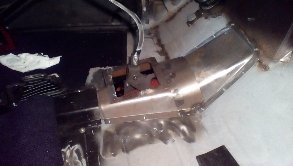

  15. slayer
    Joined: Jun 5, 2005
    Posts: 2,074
    slayer
    After realizing the auto stick has no provision for a reverse lockout I decided to make my own. With a little inspiration from the shifter Squirrel built I came up with this. When the installation will post pictures with the shifter boot off and on. KIMG0058.JPG KIMG0059.JPG

  17. slayer
    Joined: Jun 5, 2005
    Posts: 2,074
    slayer
    I have two auto stick shifters. The welded stick shifter was with all the parts to use on a Torqueflite and the bolt on stick was purchased as just the shifter. I tried using the bolt on stick shifter on the Torqueflite, but the shifter arm was not long enough to shift through all the gears. I ended up using parts from both shifters. I ended up swapping some parts between the two shifters so i could use the bolt on stick on the dodge.
    I don't know if thee shifter arm lenght was different for different applications or was there other changes when the when Hurst went from a welded stick to a bolt on?

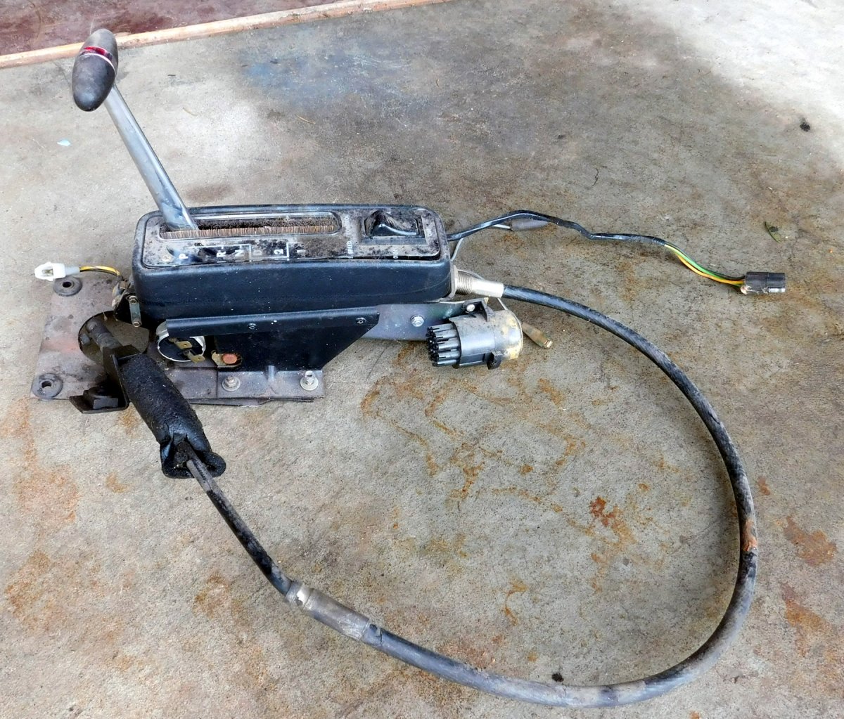

    '75 though early '90s Jaguar XJS. Low profile, very positive detents, neutral safety and back-up light switches, and cable operated. Designed to operate a TH400, it should be adaptable to most late automatics. If you can find a mid-90s version, it will be set up for a GM OD trans. With a bit of fab work, you could swap out the handle.
    Anyway, food for thought...

  24. Elcohaulic
    Posts: 2,213
    Elcohaulic

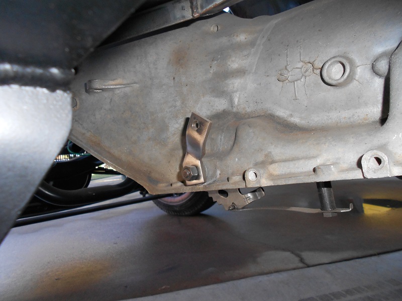

    I removed the neutral gate detent and added a shim behind the spring. I prefer this to having that weird spring plate that makes shifting kind of erratic... You can't change that spring to a heavier unit because that spring end fits precisely into that shifter handle. Amazing the tight tolerances used on these shifters! Hurst made some good stuff back then!
    I'm either going to make a bracket for a back up light switch or install another foot dimmer switch for the back up lights.. Having a hand switch for back up lights is a pain in the ***..

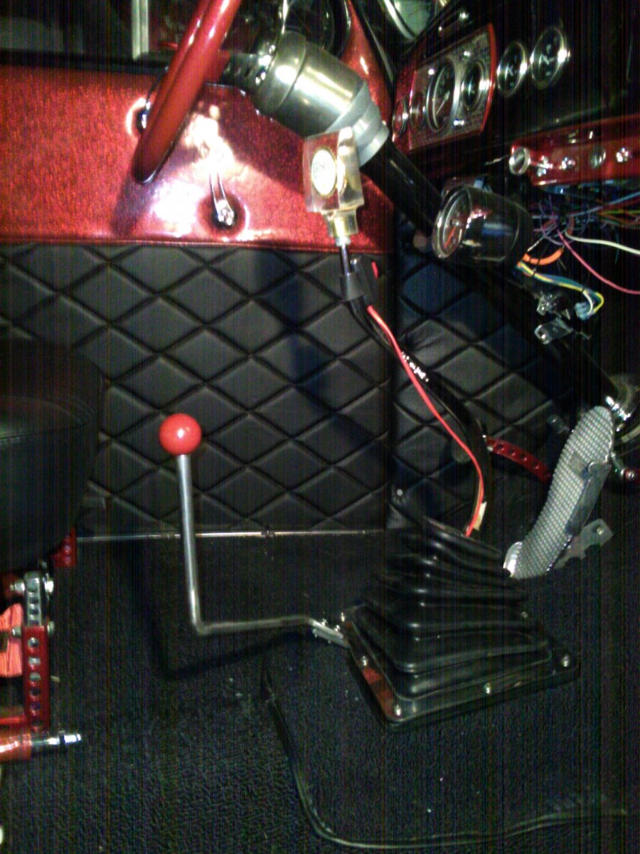

  25. Elcohaulic
    Posts: 2,213
    Elcohaulic
    chevy57dude, 4ever18, slayer and 3 others like this.
  26. Elcohaulic
    Posts: 2,213
    Elcohaulic

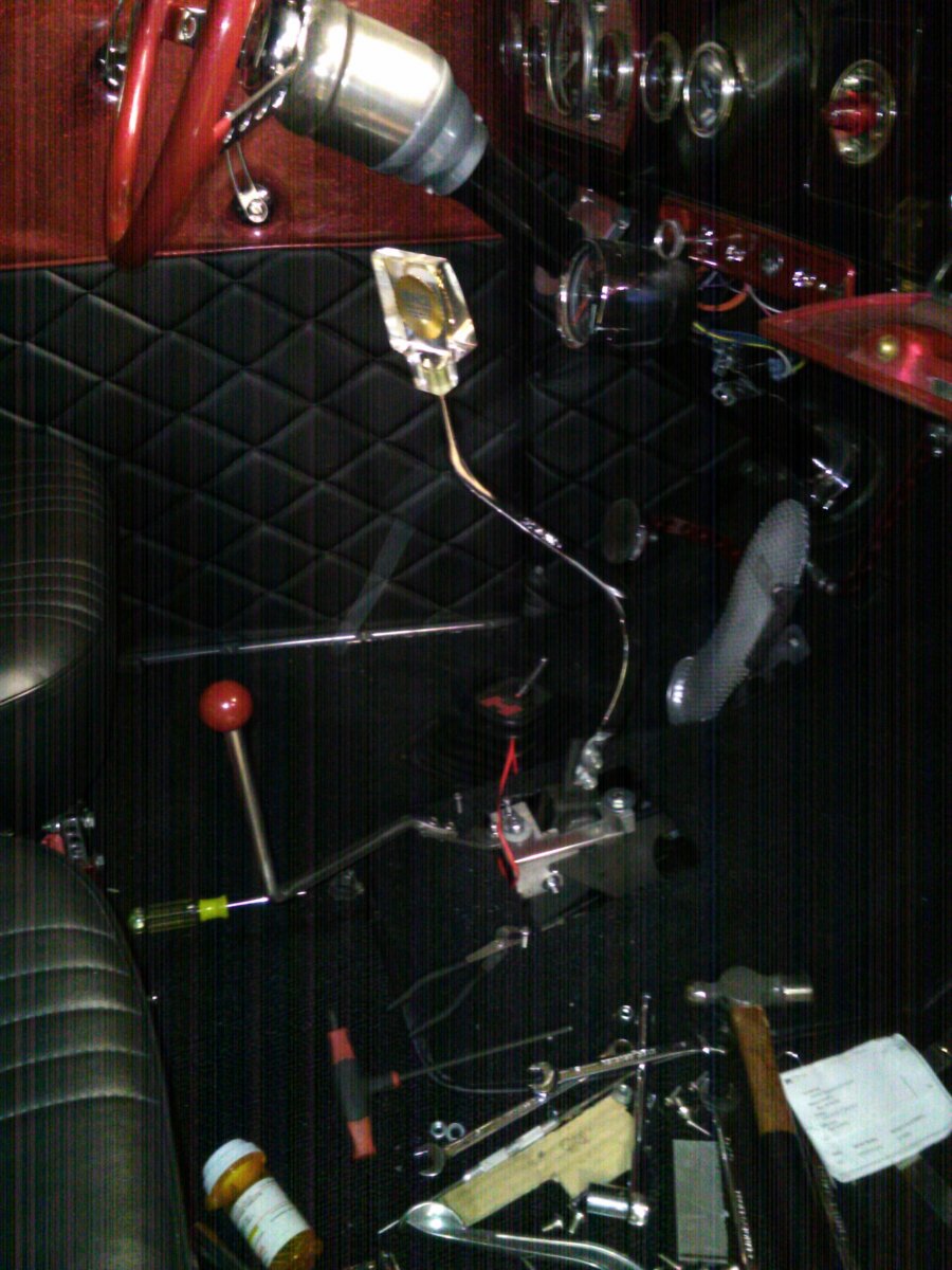

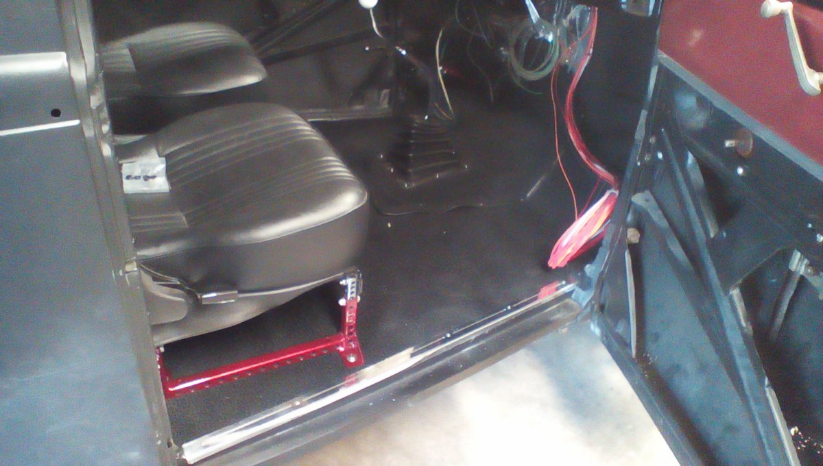

    The finished product.. Love the way this shifter feels!!
    If you look into the top left of the picture you'll see a hi beam floor switch next to the gas pedal, I'm using this switch for the back up lights..

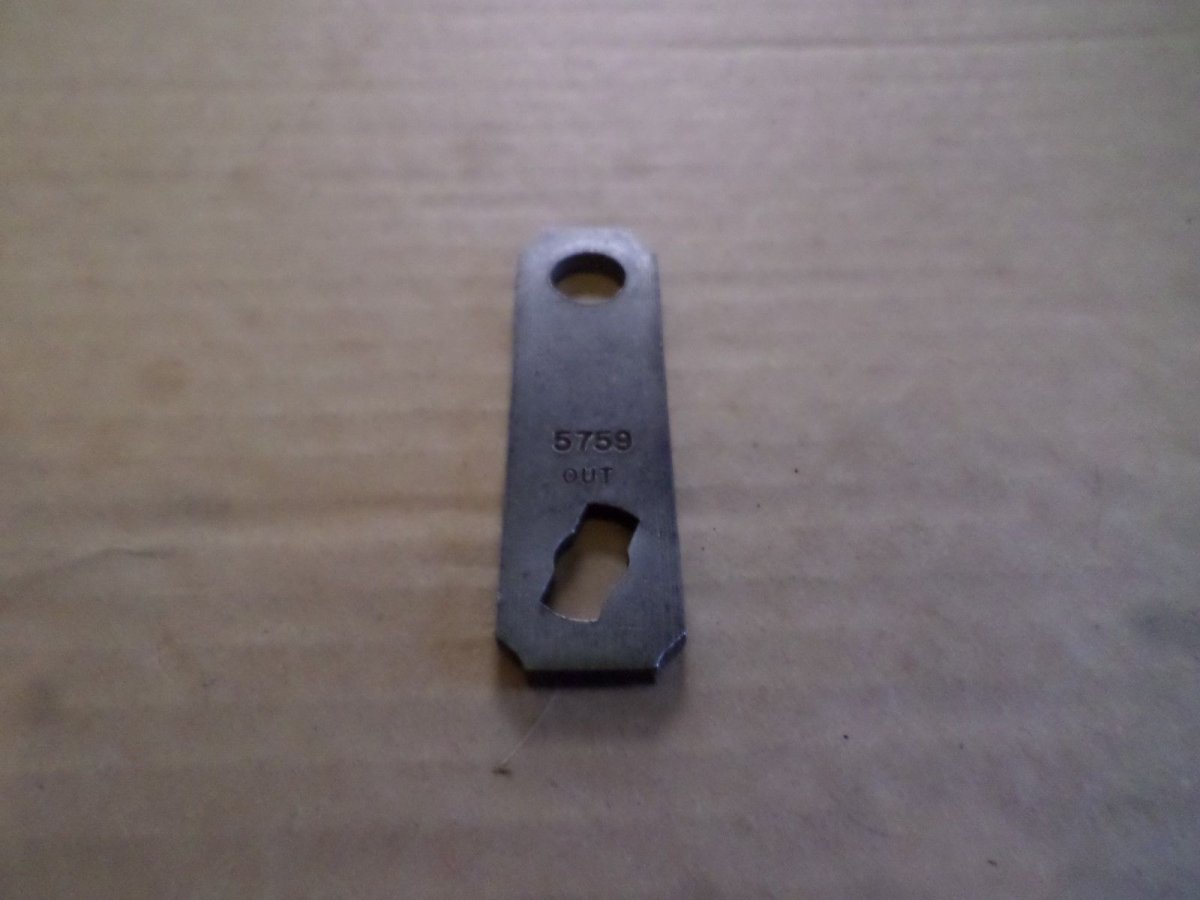

    The 5759 lever works just as good as the stock lever! I don't use the bottom plate and springs that keep the shifter locked into full detent. I think the shifts are much smoother without it..
