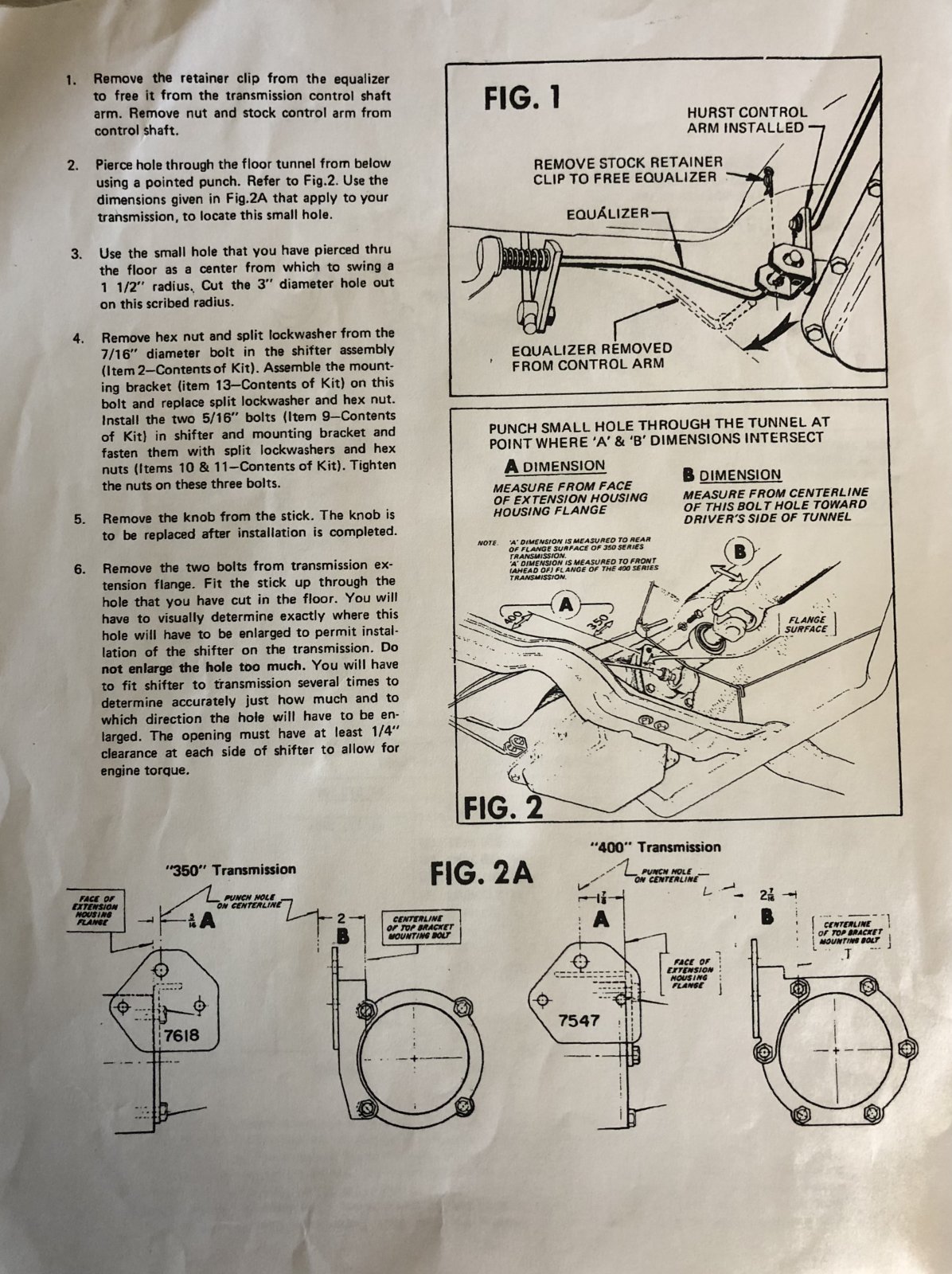

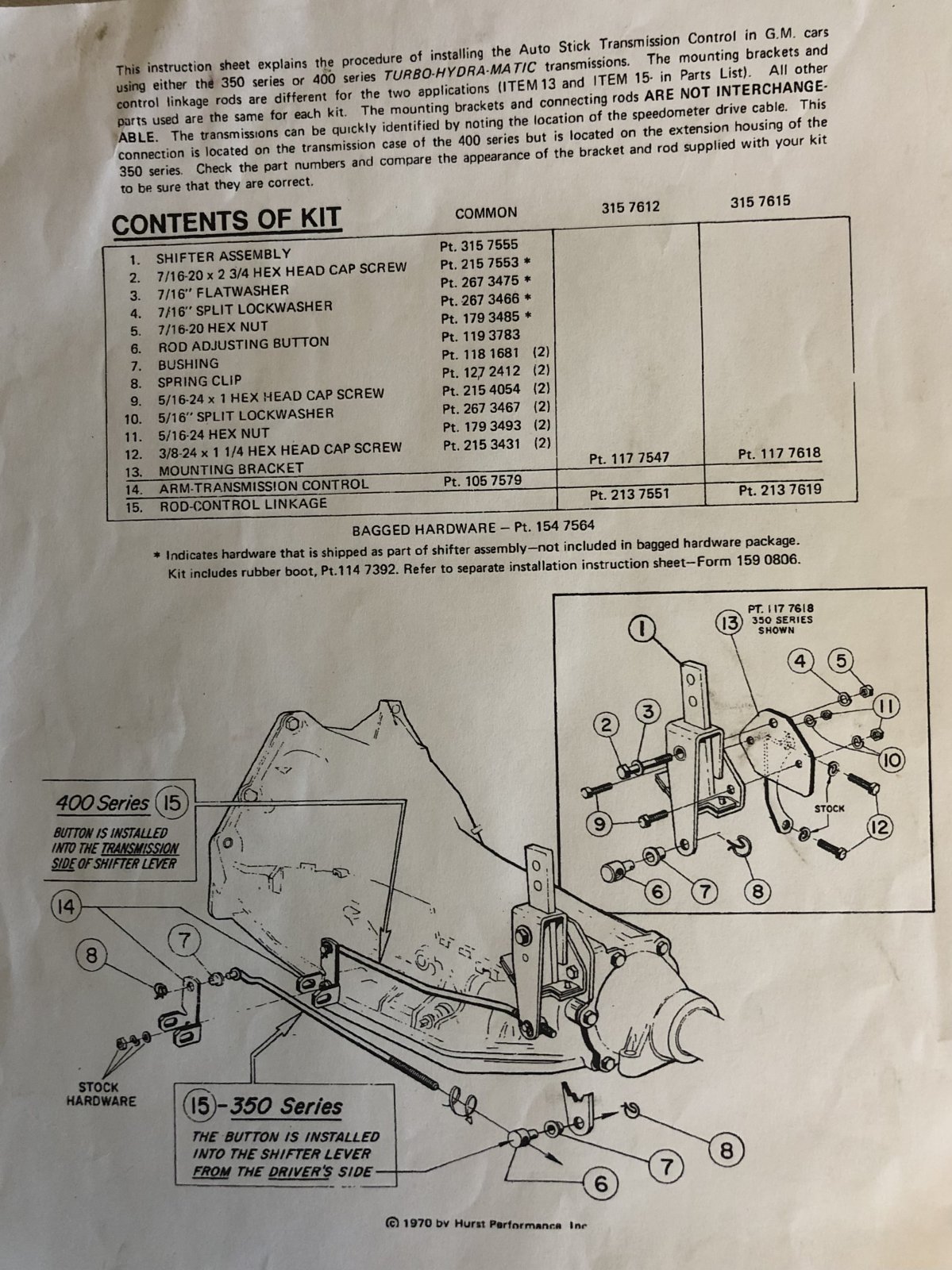

    These are what I down loaded from Hurst’s site a few years ago.
    9AB70F43-A749-4D7D-A2DF-65ED87E95668.jpeg 065AED3B-0F3B-4DFB-BB1F-3072AC2C1206.jpeg

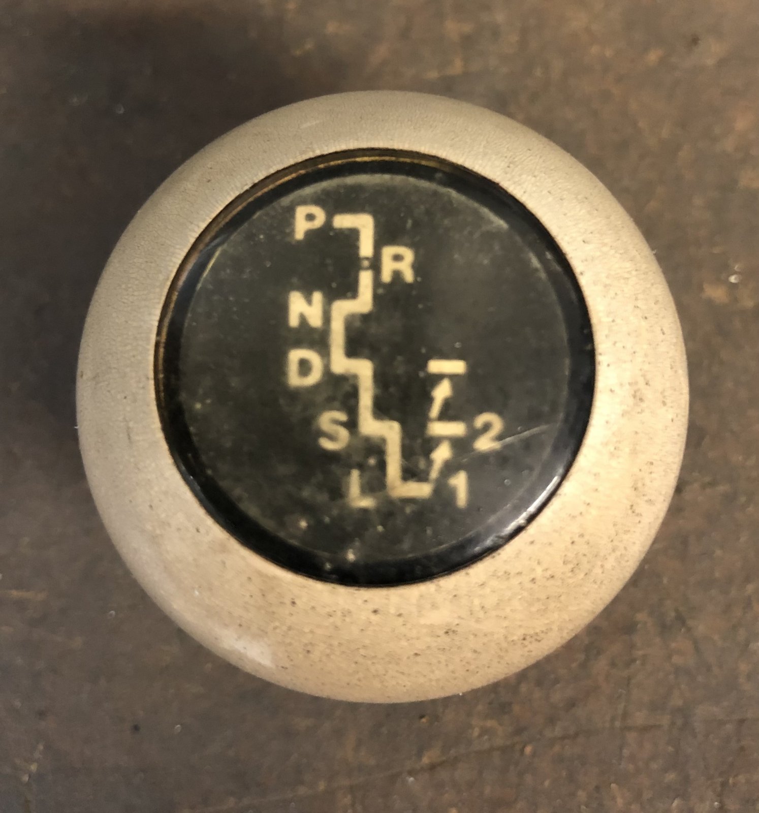

    Bought one from Von Hartmann several years ago then while going through stuff the other day I found an original with the inserted pattern that I did not even know I had.
  15. 1Nimrod
    Joined: Dec 11, 2018
    Posts: 762
    1Nimrod
    Mine is pretty rough almost all numbers faded away now after all she was made in 1968!
    I see you can have them made in any type of ball out of wood aluminum plastic and T-Handle as well from a Company on the bay.
    But I like my original Black Ball Shifter knob and it's used to me so I guess we are stuck with each other lol...

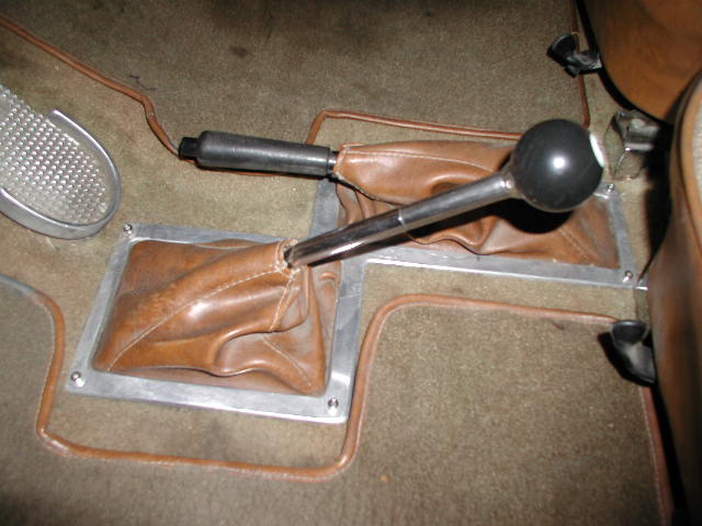

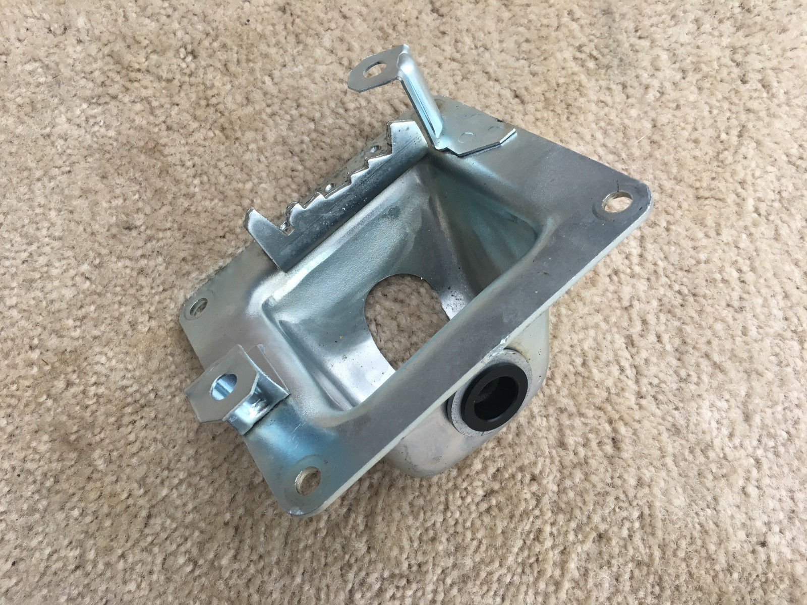

    I made mine from a MII shifter. Filed notches in the detent bracket to match the Hydro sequence then converted the stick to look like a stick shift, got rid of the hokey T-handle. Now to change gears I lift up on the knob, shift and let the handle drop into the detent.

  20. @willys36 , like the modifications you did to the old Ford shifter. I saw that somewhere else, tech article in a rod magazine? Did you do the article?

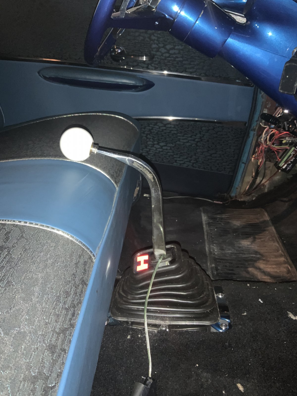

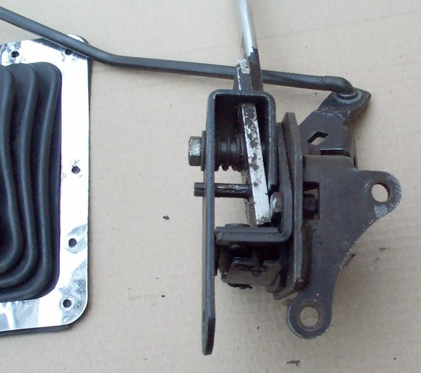

    Since my coupe has a 700R4 I couldn't use a Hurst Auto/Stick, so built my own using an old Hurst shifter.

  24. @1971BB427 , do you have a picture of the mechanism?

    No, I built it all from scratch. Under the floor is a spring loaded gate I cut from thin steel sheet to stop the shifter in each gear, and keep me from hitting neutral accidentally. It works great and cost me nothing more than a $20 used Hurst shifter, a couple 3/8" heim joints, and a piece of 3/8" rod I bent and threaded the ends to screw the heim on each end.

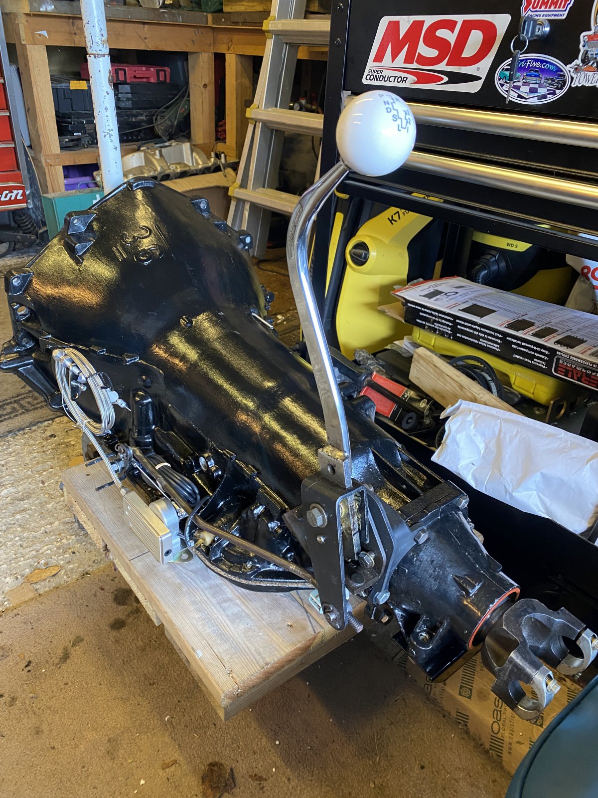

    So its finally in the car, can't wait to be able to try it out, still got to finish up the exhaust and break the motor in but im getting close
    1Nimrod, Elcohaulic, MUNCIE and 3 others like this.
  29. kbuhagiar
    Joined: Apr 3, 2007
    Posts: 148
    kbuhagiar
    Looks good - you're gonna love it!
