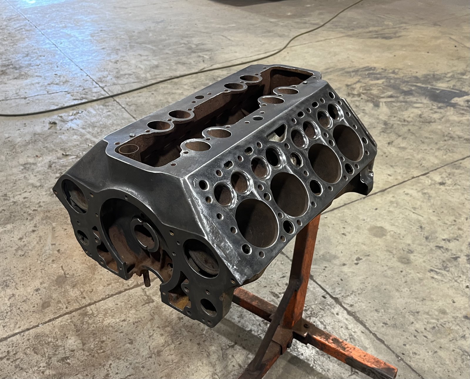

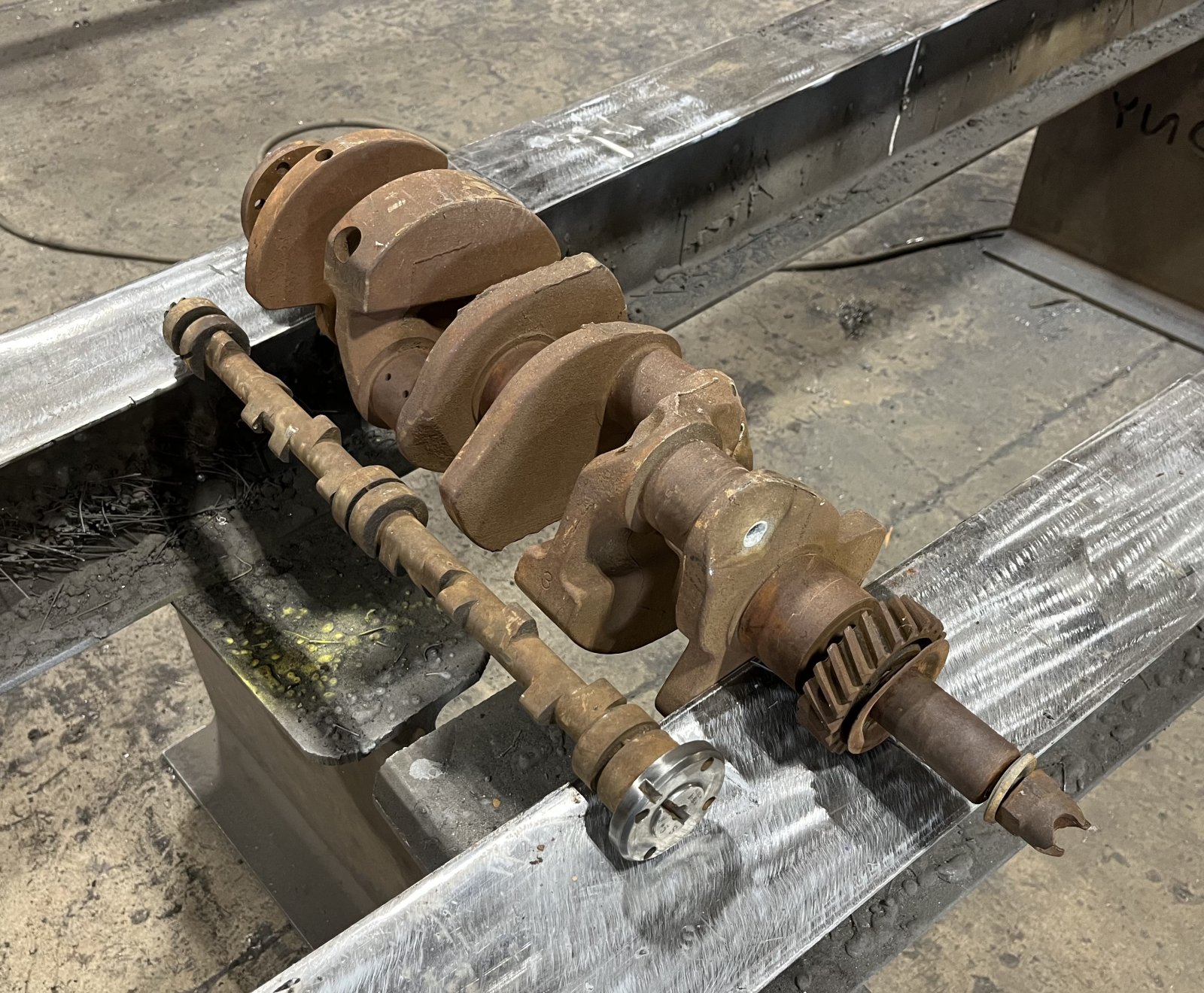

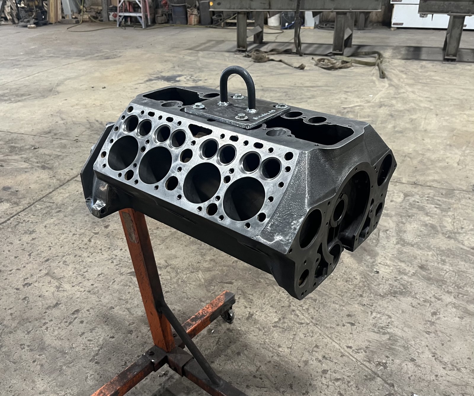

    This is engine number 6. I’ve been buying flatheads like they’re going out of style, which they are. Everyone had issues but only one was completely junk. This is my latest.
    59a block with 3-5/16 bore
    Merc crank 4” stroke

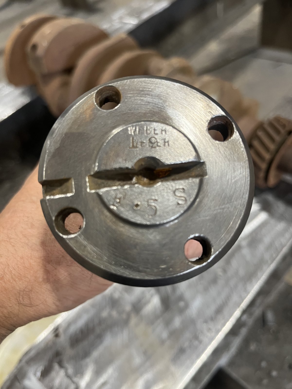

    Weber cam? Never heard of it. 15E59485-6214-499C-8E15-D7EEAC69722E.jpeg 84736172-DBB3-4CAA-B44B-FC5588D0A66F.jpeg AB4BBBE7-69C9-428A-A783-C7FE6AFAB484.jpeg
    I figure the crank was worth the price. This is the last flathead I’m buying. If I can’t get a usable flathead, I’m detuning my blown nitro 392 Hemi and using that.

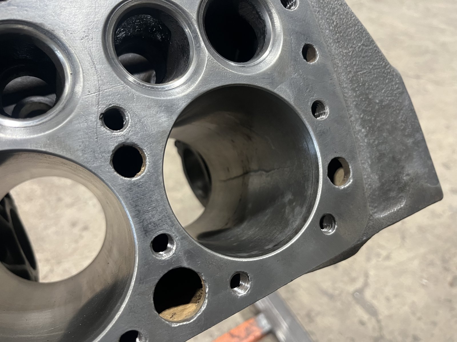

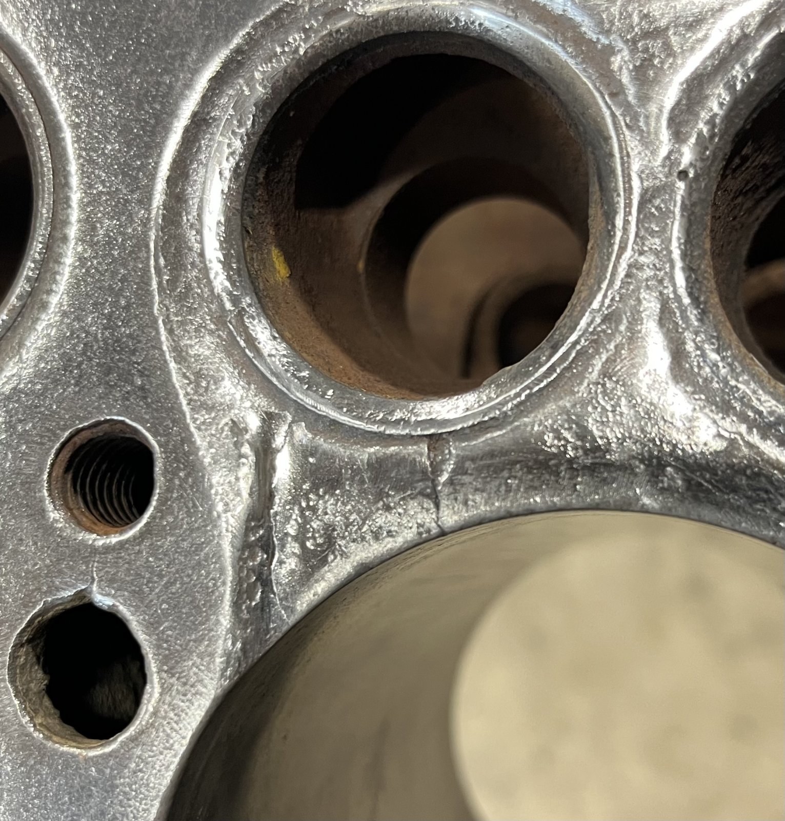

  3. 65standard
    Joined: Jun 14, 2011
    Posts: 1,096
    65standard

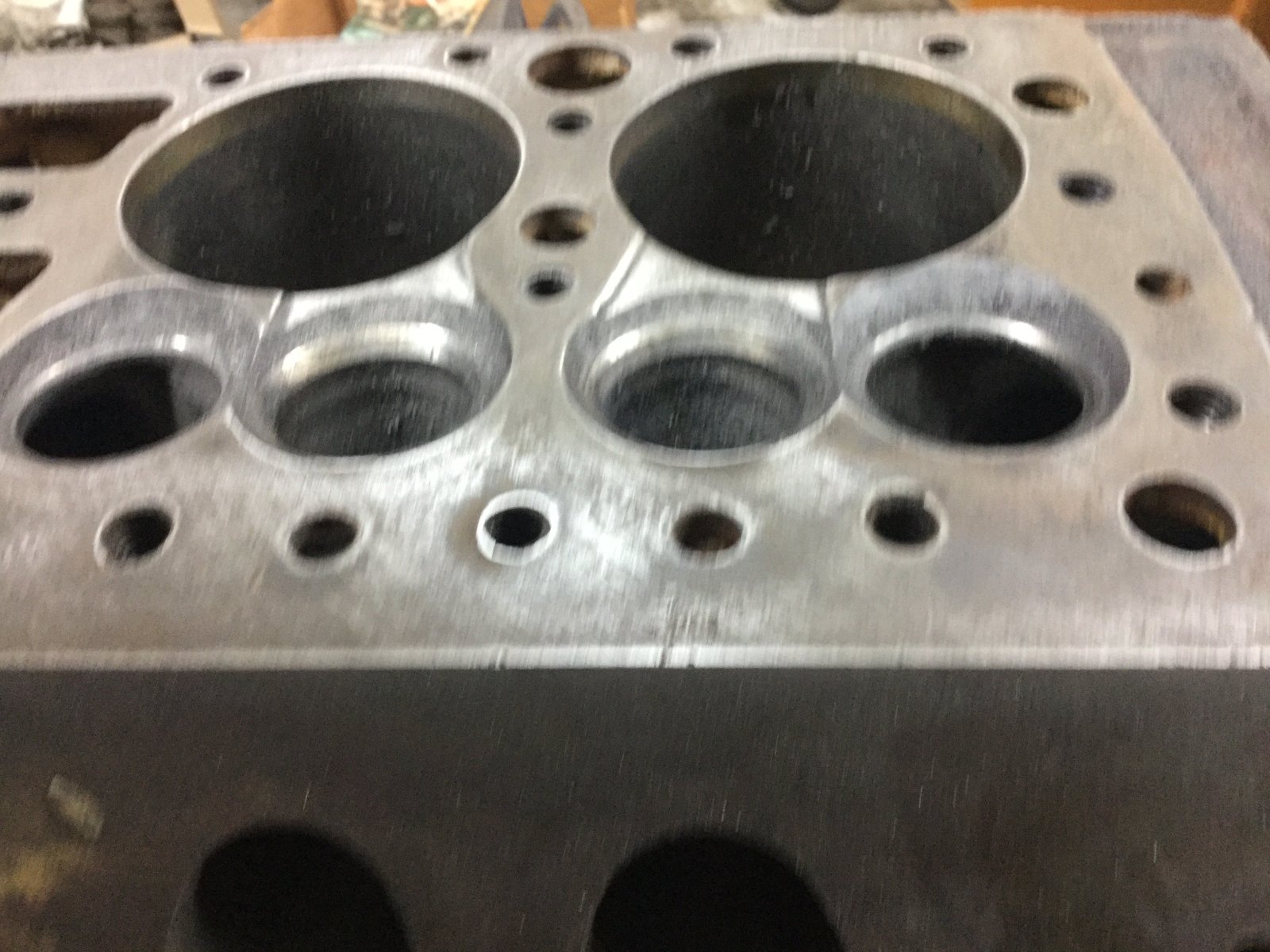

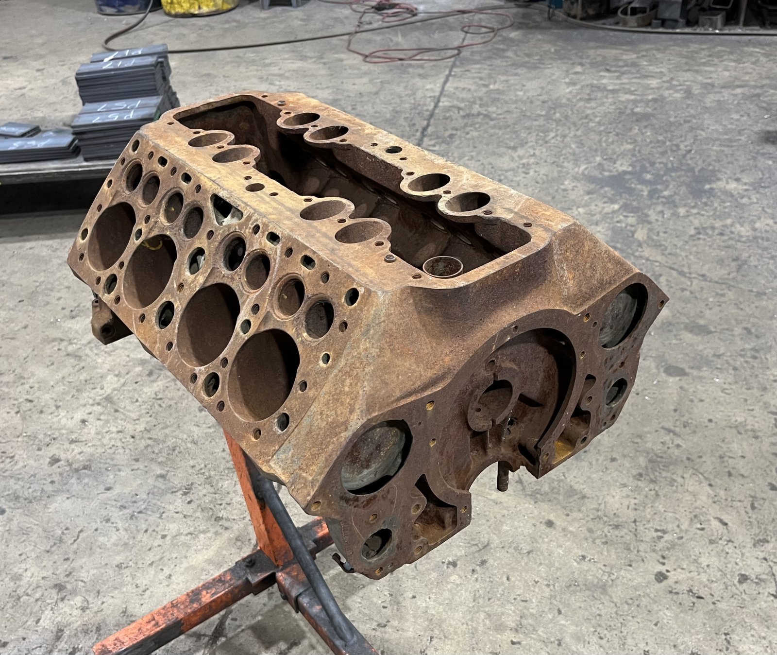

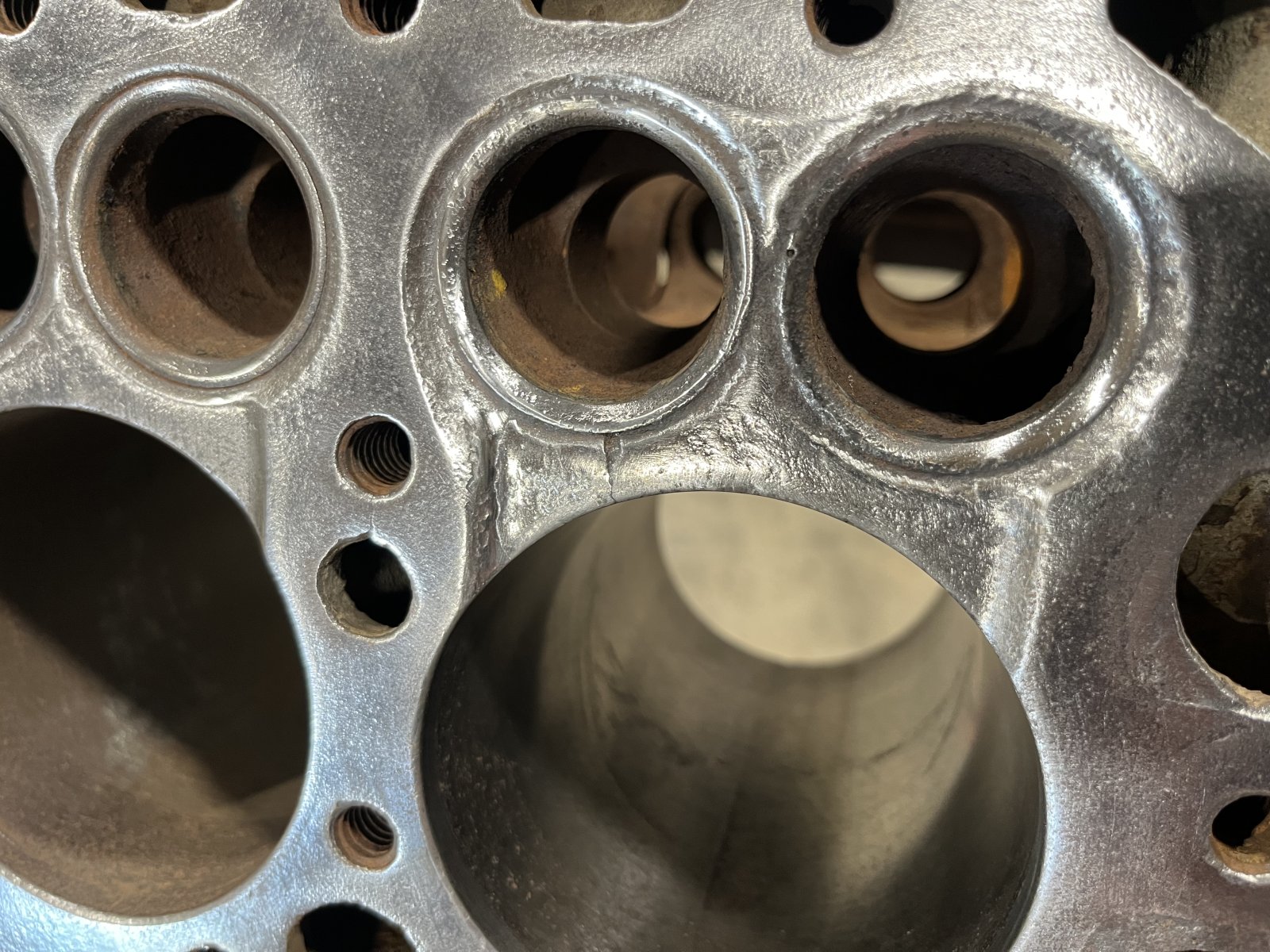

    AEC0DBEB-916D-4A10-B901-0C2CB889B97E.jpeg 5B9EC28F-242A-4B8A-8295-382685AA8B90.jpeg 2E11FE25-ACA5-4E40-9DB6-B5917C66D967.jpeg Me too. I want to run a flathead in my 32 3w but this #6 block is cracked. Do I keep looking for the holy grail or repair the cracks?

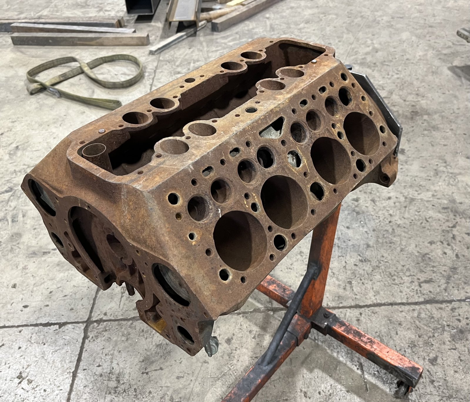

  4. adam401
    Joined: Dec 27, 2007
    Posts: 3,019
    adam401
    Way easier to find a good 49 and later block than 48 and earlier. Ive had real good luck buying them and ending up with a good block 1st shot.
    Personally I wouldn’t start with either of the blocks posted. Too pitted and that second one looks like the valve grinder got away from someone. Not being critical just honest. I’m in rusty New England and we still manage to find good blocks without too too much fuss. Good luck they’re cool once your done

  5. Grumpy ole A
    Joined: Jun 22, 2023
    Posts: 368
    Grumpy ole A
    That deck surface looks rough. The cracks you could repair but how do you clean up the rest of the surface? I am not trying to tell you to stop looking just would like to know how to get it cleaned up.
  6. Bearing Burner
    Joined: Mar 2, 2009
    Posts: 1,211
    Bearing Burner
    from W. MA
    I've got a Weber super 400 cam. Same company the made aluminum Flywheels

  7. chlsnk
    Joined: Dec 11, 2008
    Posts: 246
    chlsnk
    You really get the blocks shiney wire wheel on a die grinder?
  8. 65standard
    Posts: 1,096
    65standard
    91242BC5-CB1A-40E8-BC16-3B35866A06D5.jpeg This is the Weber cam for that motor.

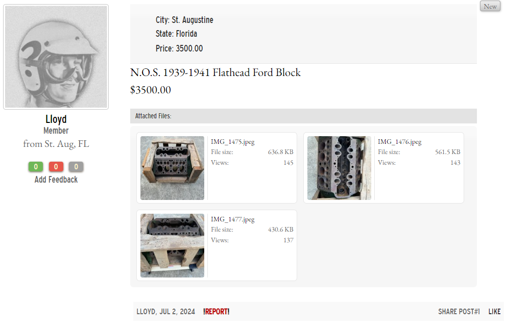

    This is on our cl***ifieds. NOS
  11. 65standard
    Posts: 1,096
    65standard
    I use a wire cup on a 4-1/2” grinder and then a 2” scotch Brite pad on a air grinder

  18. 65standard
    Posts: 1,096
    65standard
    Thanks for all the flathead information.

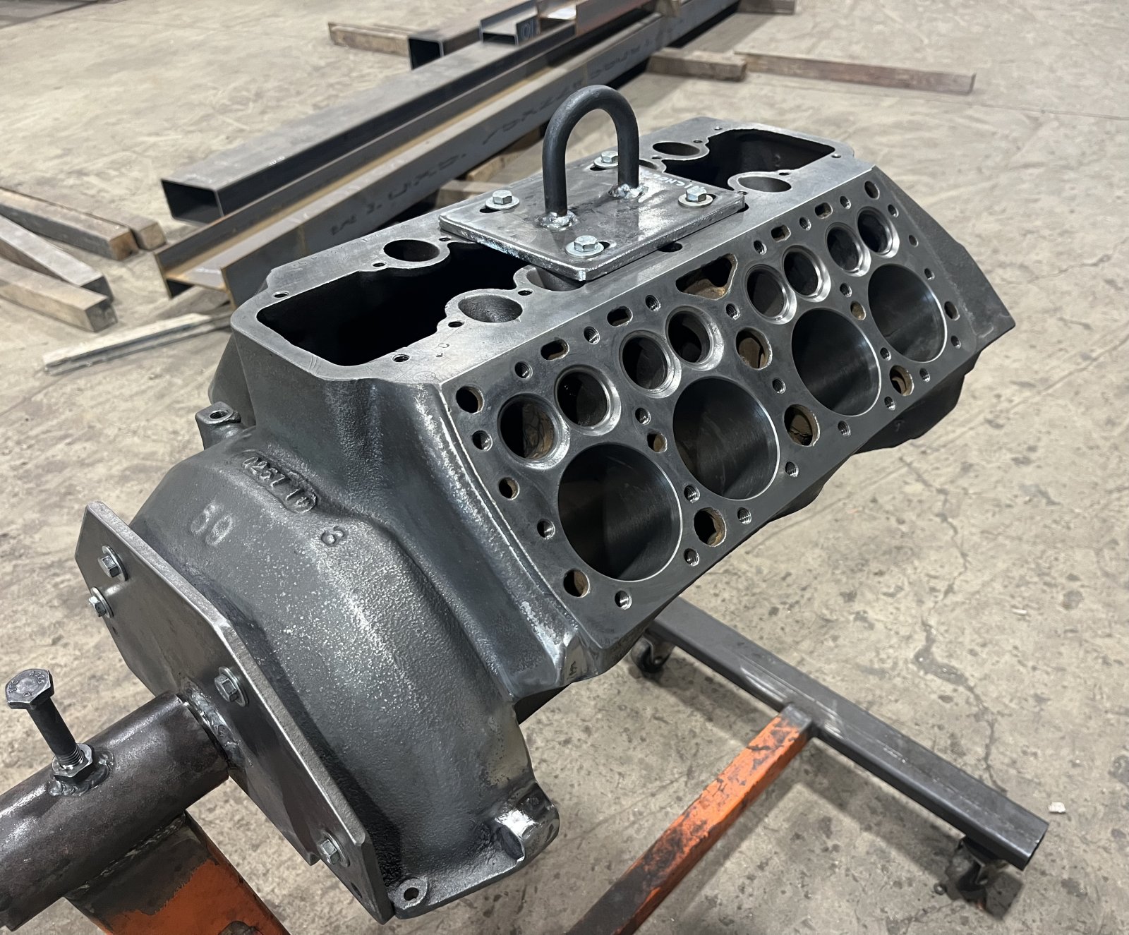

    I’m rethinking about using block #4. It is a remanufactured block. Very nice everywhere except a crack in cylinder #1. I can get it sleeved for $300.
    Thanks for the offers on the new blocks. I prefer a seasoned block over new.
    The nice part about buying all these flatheads is the stroker cranks and regrind cams. I have some 3-3/4 cranks, one 4” crank , and one 4-1/8” crank. I’m building two engines, one 296 and one 276.
