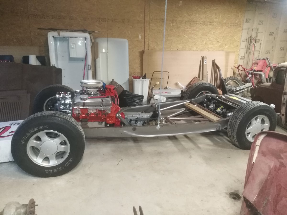

    Got it all drug home today. The rear floor is rougher than I thought it was, but I'm still ecstatic.
    So now for the questions. I'm gonna have to put the front cross member back in as it had jag ifs, is there anywhere that gives dimensions where it should sit? Same question for flathead front engine mounts, is there anywhere to pull dimensions to get it close to factory?

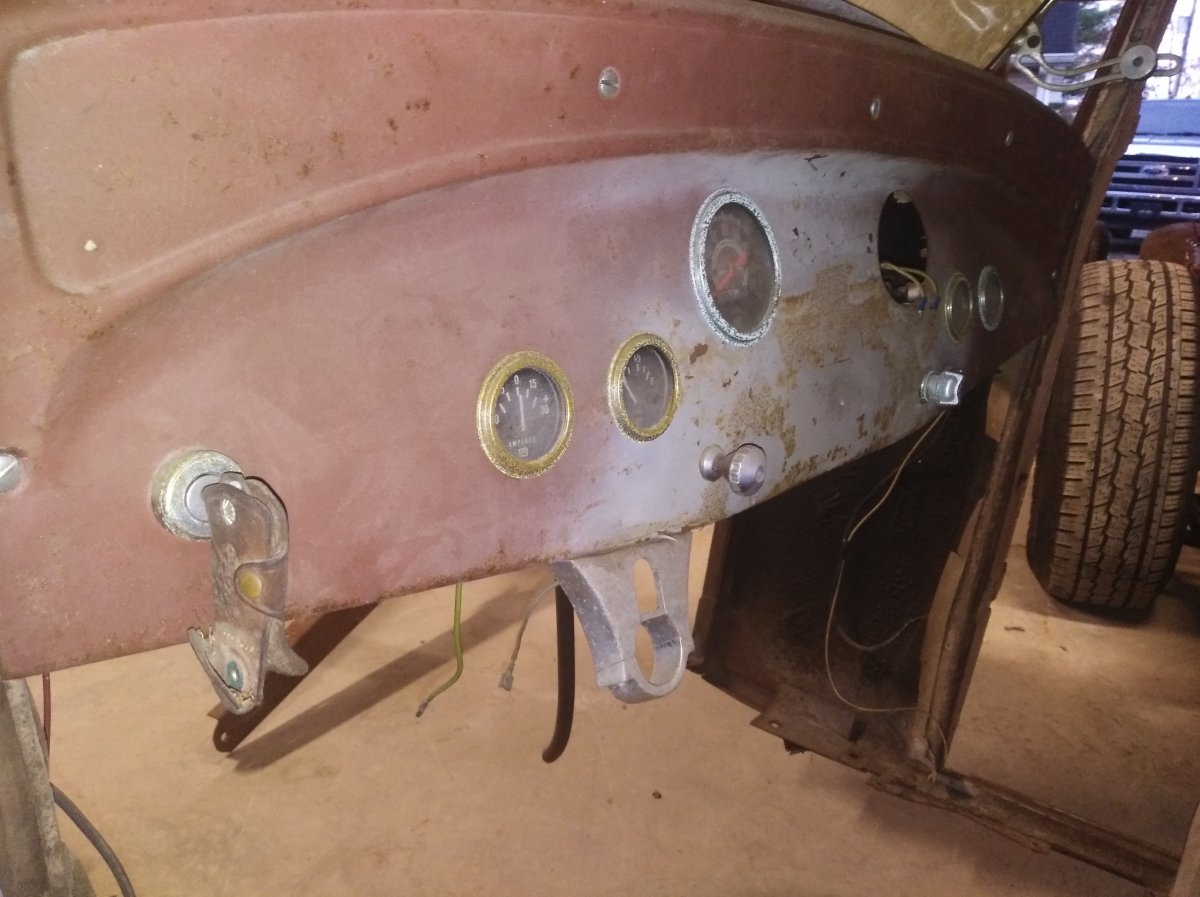

    The firewall, is this the correct firewall? Just smoothed?
    What is the metal piece sitting on the cowl, can't put my finger on where it goes. IMG_20201127_172914.jpg IMG_20201127_172936.jpg IMG_20201127_172948.jpg IMG_20201127_173000.jpg IMG_20201127_173014.jpg IMG_20201127_173027.jpg IMG_20201127_173035.jpg IMG_20201127_173051.jpg IMG_20201127_173118.jpg IMG_20201127_173206.jpg IMG_20201127_173232.jpg IMG_20201127_173250.jpg IMG_20201127_173301.jpg IMG_20201127_173309.jpg IMG_20201127_173320.jpg IMG_20201127_173331.jpg IMG_20201127_173341.jpg IMG_20201127_173354.jpg IMG_20201127_173529.jpg IMG_20201127_173606.jpg
    Either way here's picture overload of some of the haul, still haven't went through a lot of boxes and new bob drake stuff!

    Piece on the cowl is the front radiator splash pan, mounts below the grille shell. The old frame has all the jag front brackets installed already.
  9. paul55
    Joined: Dec 1, 2010
    Posts: 3,491
    paul55
    from michigan
    The brackets hanging down back at the firewall are for the jag torsion bars.

    Awesome, thanks. Yeah all the jag stuff for the front is getting cut out. Going back with a solid I beam and spring.

    I own my own repair/fab shop, you're reading me wrong I believe, just ZERO experience with anything prewar.
    I'm cutting all old front bracketry off to install new front crossmember, hanging firewall and Radiator/grill to check hood fitment, in ase I decide to run it, then building old ch***is to roller with existing jag rear, for now.
    As far as everyone saying to ditch the rear and not be concerned with the heritage of the car, I get that aspect, but it's extremely cool to me that this car was hot prodded in the 60s and even though I'm not going back to it's exact late 60s condition, I'd like to keep a little bit of the spirit of the car alive, like that bitc*in interior!
    That new frame is worth entirely more as a cash sale to me than having to hack the ifs off the brand new one and starting with the same basic frame as I have laying next to it that's still original to the car, albeit already hacked.
    Was told it's a precision frame, heidts front/rear, so it should move easily to fund the rest.
    Does anyone make a reproduction front cross member with OEM engine mount boss's? I've searched all morning and will order one without, but would sure like to use original design

    Nice find build it how you want. If it was mine it would be hard not to put it together full fendered with the hood. I would guess those pictures were taken before the Jag rear was installed since it still has hair pins in front.
    If you want a 32 front crossmember with the motor mounts. You will have to find an original 32 front crossmember. No one makes a reproduction 32 front crossmember only Model A front crossmembers are reproduced.
