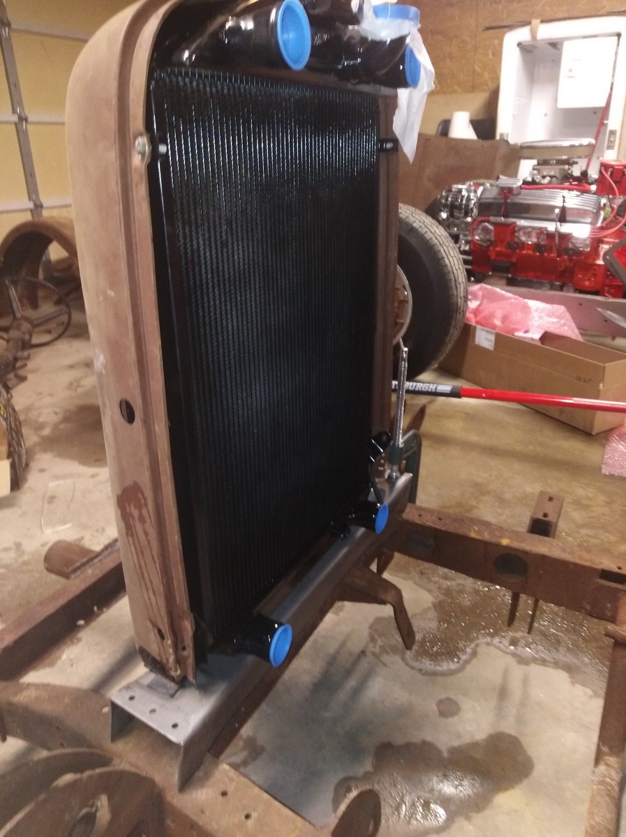

    My walker radiator and so cal front x-member showed up so I had to mock it up to see where the cross member needs to sit since the holes were filled when the jag front was installed. Going to try and get my plasma home this week to hack out all the front jag stuff. Ordered weld on bushings to rubber mount the rear jag cross member since its currently solid mounted.
    Ordered a speedway front axle/split bones kit if it shows up, hope to have a roller by new year.

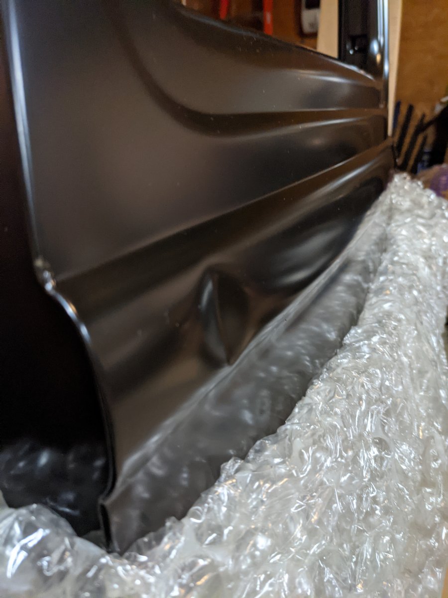

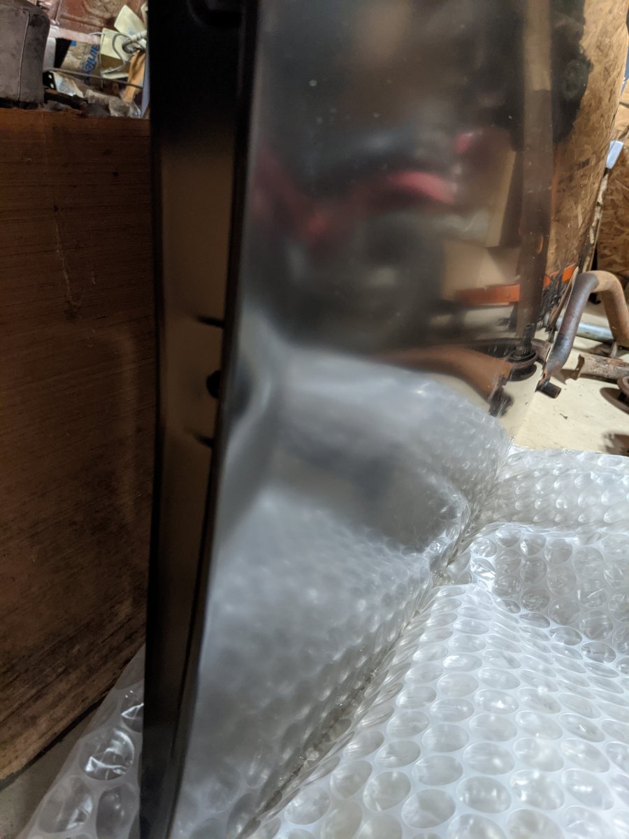

    Well I wish I had good news to post on the new year. Unfortunately my back gave out on the 23rd of December and is just starting to feel better. But not good enough to do much of anything in the garage.

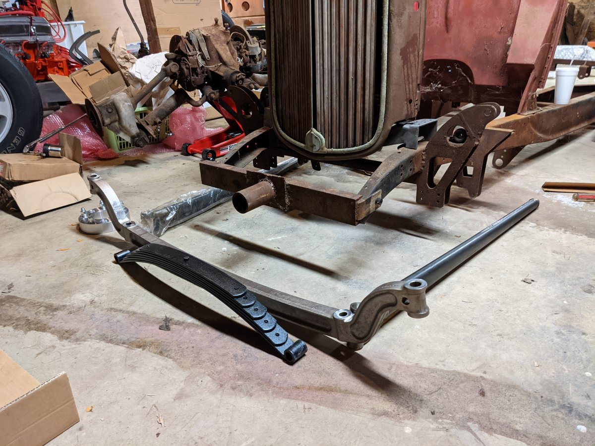

    My front axle kit showed up today, along with a set of new
    united Pacific doors..
    Unfortunately after unboxing there's a good dent in the driver's door and a more subtle one in the p***enger, I almost left them in the packaging to keep them safe, but my gut told me to open them and see, glad I did so hopefully we can get it resolved... Speedway front axle kit looks really good though.

  4. wheeldog57
    Joined: Dec 6, 2013
    Posts: 3,990
    wheeldog57
    Aye aye aye, that ****s about the doors.

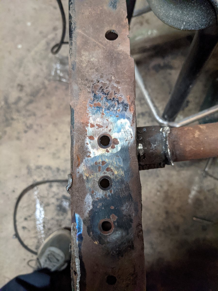

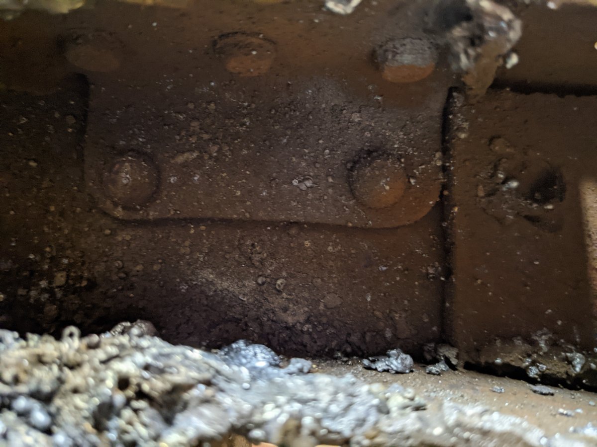

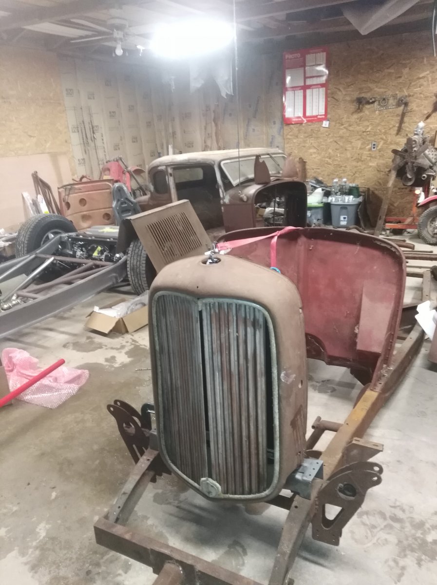

    Backs slowly starting to feel better, last weekend took it easy and started out by cleaning the grill insert up, they had used the pines surround and "spot welded" a mesh insert in, out came the dremel to clean up the spots, luckily they used what seemed like solder so I was able to use a sanding roll on the dremel and "melt" it away and not hurt the original finish then moved on to polishing out the old chrome spreader bars and the pines.
    Also slowly been hacking away at the jag front that was scabbed on, it was a mess, plates on the outside of the frame, tons of weld. But low and behold, thankfully whoever did it just cut the factory cross member and welded around it, so my locating holes are in the frame still! The downside is they are narrower than the socal crossmember, so I need to pull out frame dimensions and see which one is off.
    Picked up a heater as well, I was cruising eBay and kept telling myself when I saw the one that looked "right" I'd know, and not to hurry into one. I love this one, at first glance it appeared to replicate a deuce grill and insert. Plan is to rechrome the "doors" and probably paint the surround that was chrome the body color to make it appear like a grill shell.
    Progress is slower than hopeful, but still there. Trying to find a set of 40 ford 4" fronts and 4.5" rears so I can do a 7.50 rear 5.50 front. PXL_20210117_210049417.jpg PXL_20210117_212619866.jpg PXL_20210124_235213705.jpg PXL_20210121_230307426.jpg PXL_20210109_230404142.jpg

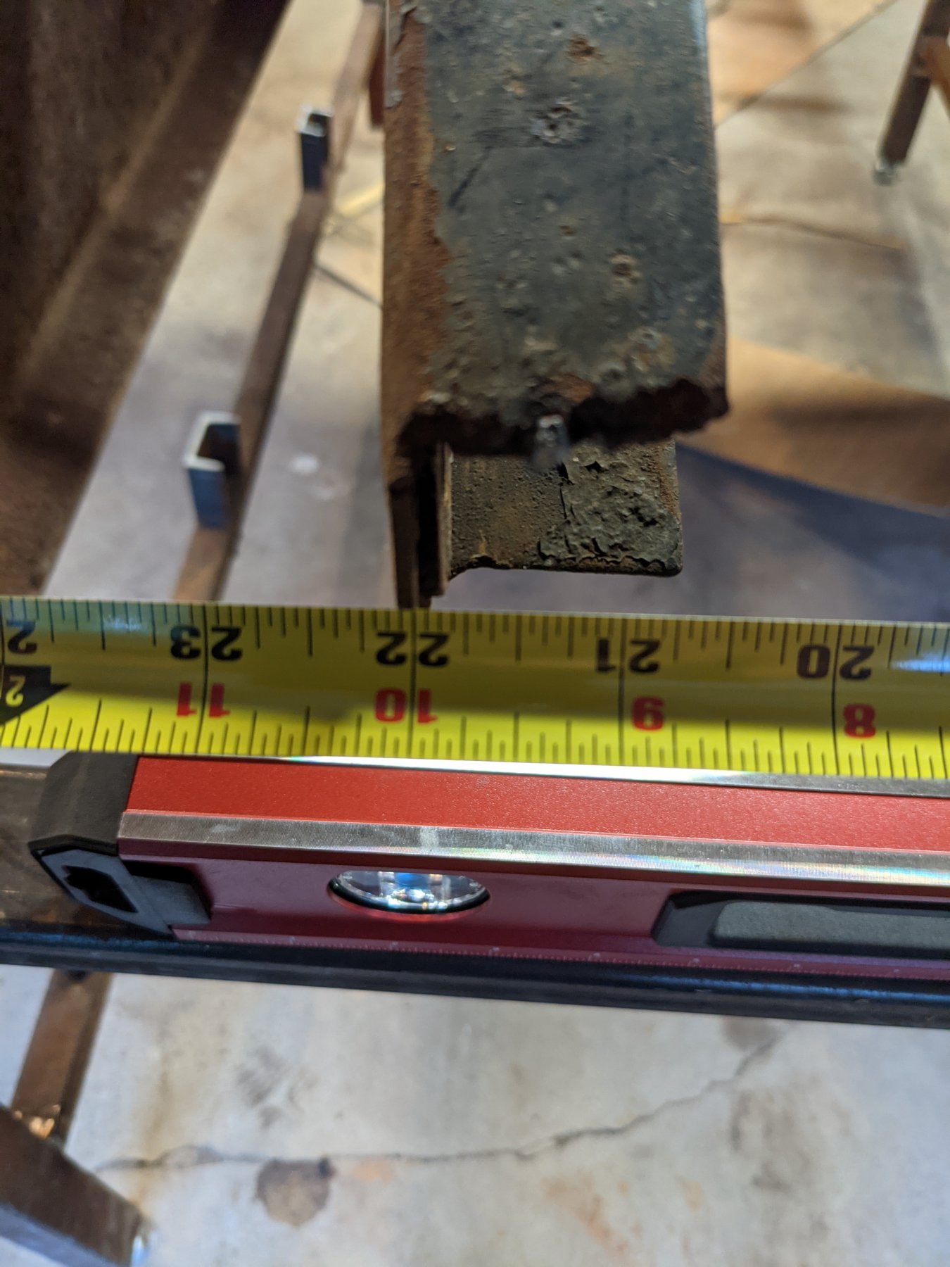

    Also found the front crossmember area squeezed in 3/4", I'd held off on cutting the crossmember that was added in that area ***uming it was put in before cutting the original out to hold dimensions correct, apparently it was not.

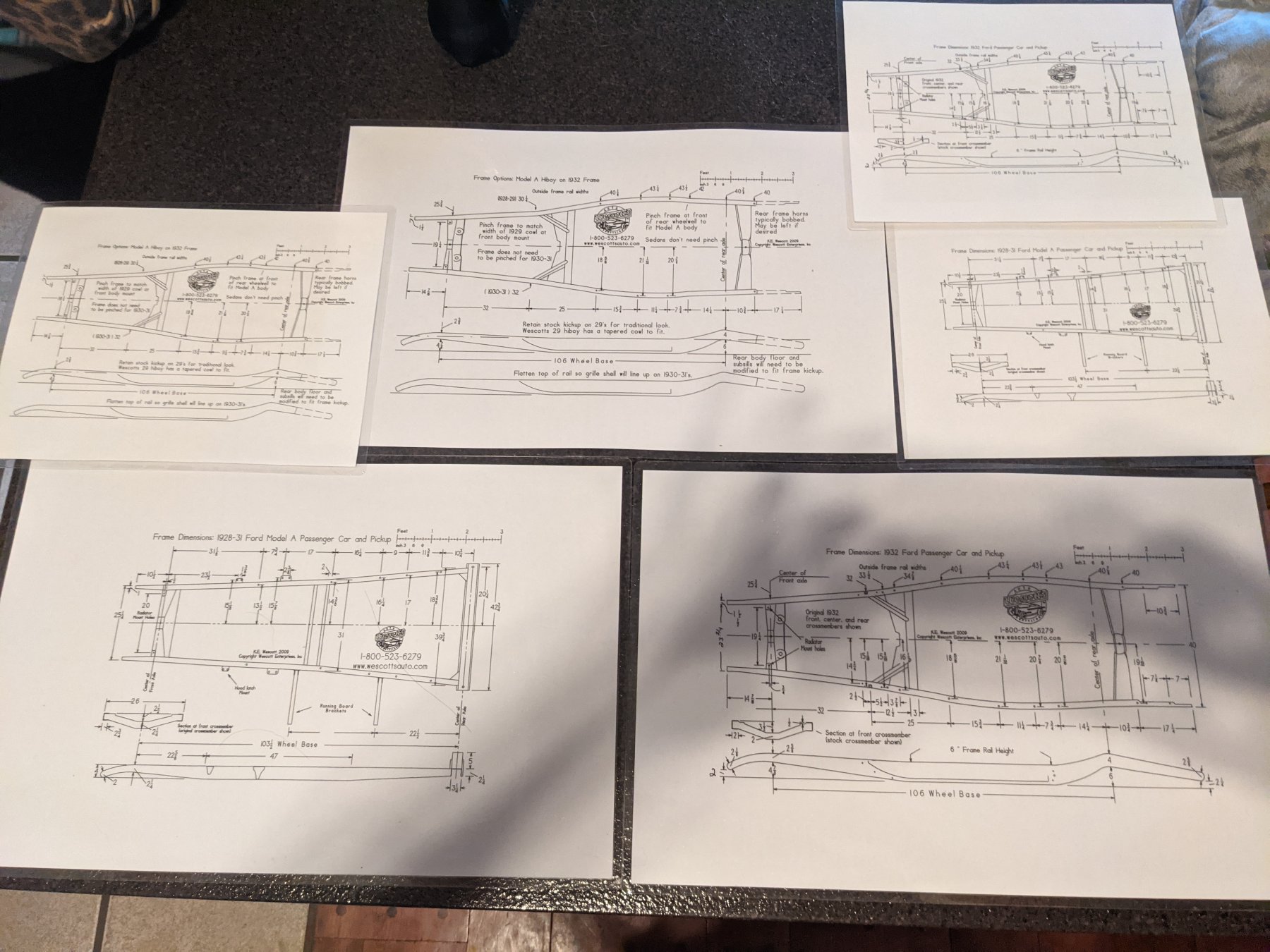

    Printed out westcotts frame dimensions and took them to the local print shop to have them enlarged and laminated so I'm not trying to squint on the one I had! PXL_20210602_234656167.jpg

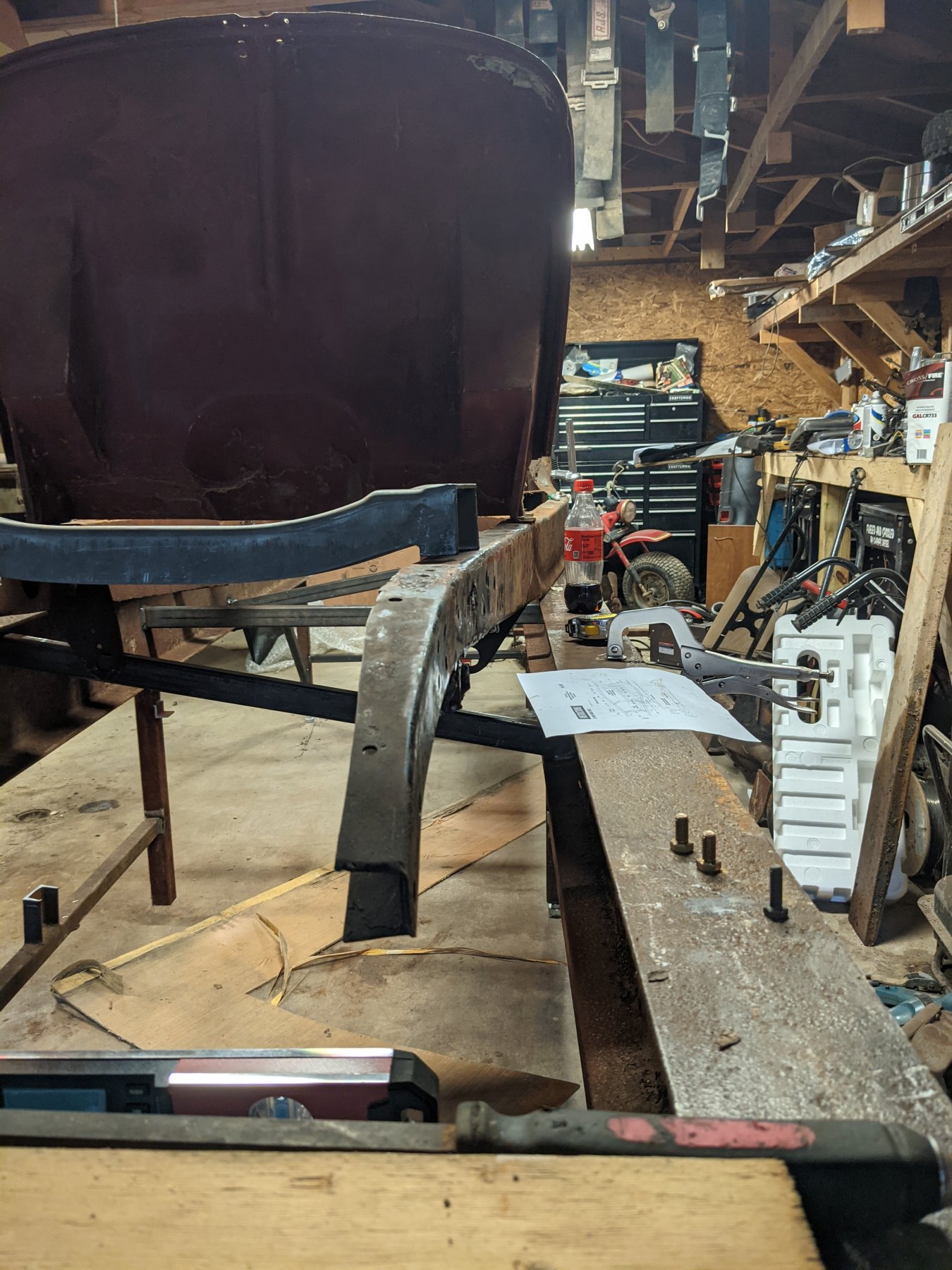

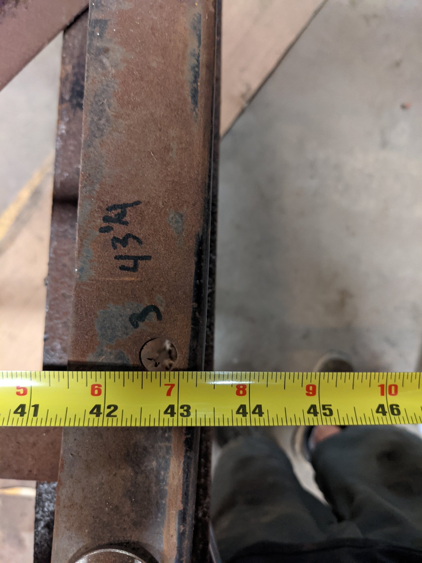

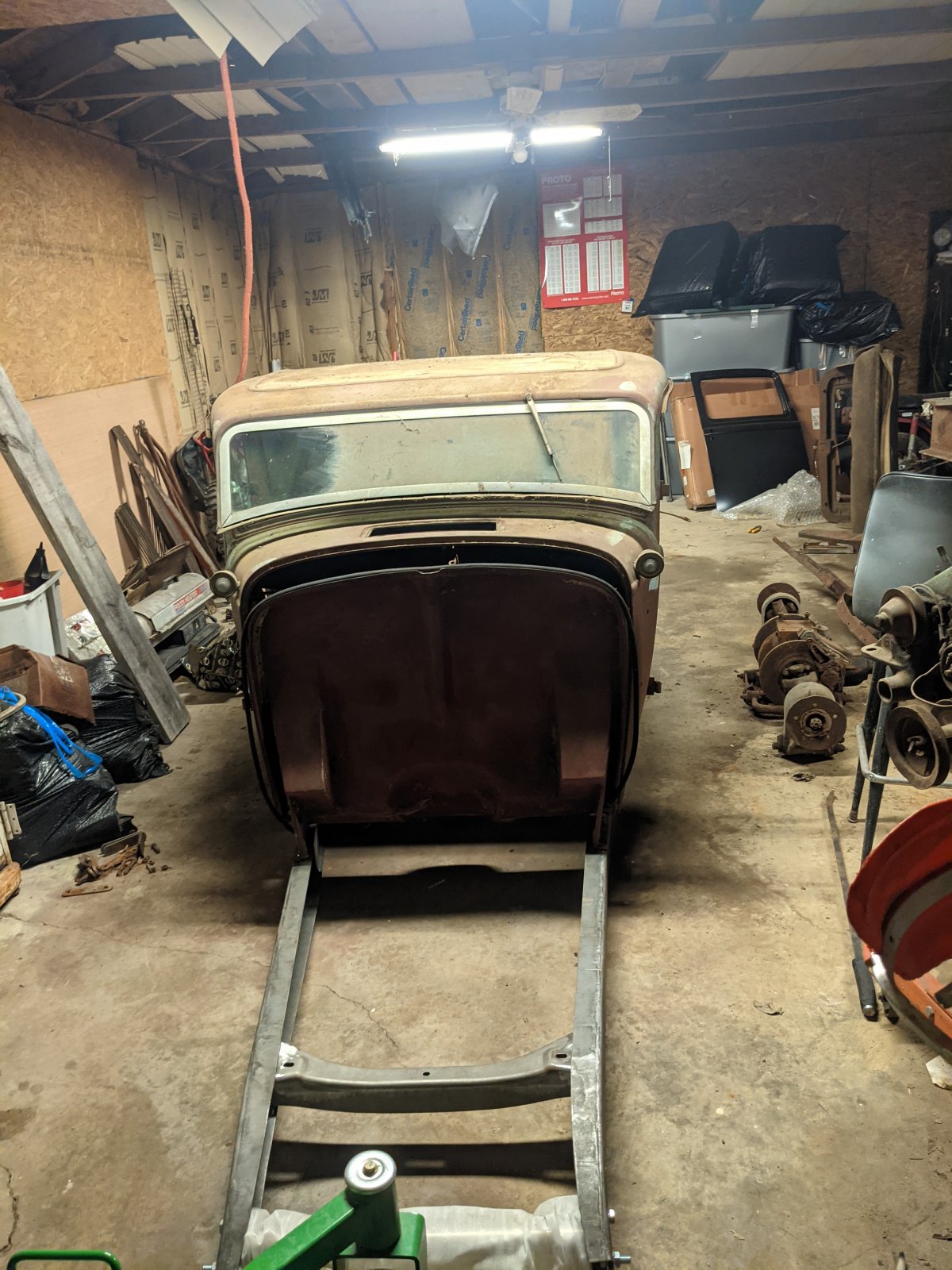

    Long time without an update. I'm sure some have given up. But I have a house remodel, a business, working on my pilots license and a few other money making projects that need attention as well. But we're back at it.
    I'm the end I decided that the original frame was to twisted to try and square without some sort of good solid foundation. So in came new ASC rails to start from (no worries stock rails are tucked away so once the new frame gets done I can use it to build a jig out of to get the old rails where they need to be).
    I squared everything up on my table I built, checked all my measurements, and started welding. Ordered my crossmember kit got it 7/8 of the way done, and thought, I should probably set the body on and check.
    My frame measurements were perfect, body holes line up great... Unfortunately I used the measurements supplied with the crossmember kit, adjusted about 2-3" to what felt/looked right and...... It's not going to work. In the picture of my frame diagram you can see roughly where I put my crossmember when I was laying it out. I sat the body on and realized quickly what had happened. So now I'm deciding whether to notch the floor for my legs of the crossmember, or cut it all out and move it forward. Where the factory k member sat just feels very far forward to me, so I'm unsure of which direction I'm heading to next. I'll probably end up cutting it all out bolting the body down and tacking it in forward of that. The other option I've played out is notching the legs on the x-member down roughly 2.5" to clear the floorboard and leaving them as they sit.
    Any constructive criticism is welcome!
    Once I get the frame 100% the body is coming back off so I can use the frame to make some jig plates on my frame table referencing the factory holes to straighten my OEM frame. Eventually the body will be swapped back to it's original frame, and I'll start searching a A roadster body for the "new" frame. But that's still years away!

  26. alchemy
    Joined: Sep 27, 2002
    Posts: 23,467
    alchemy

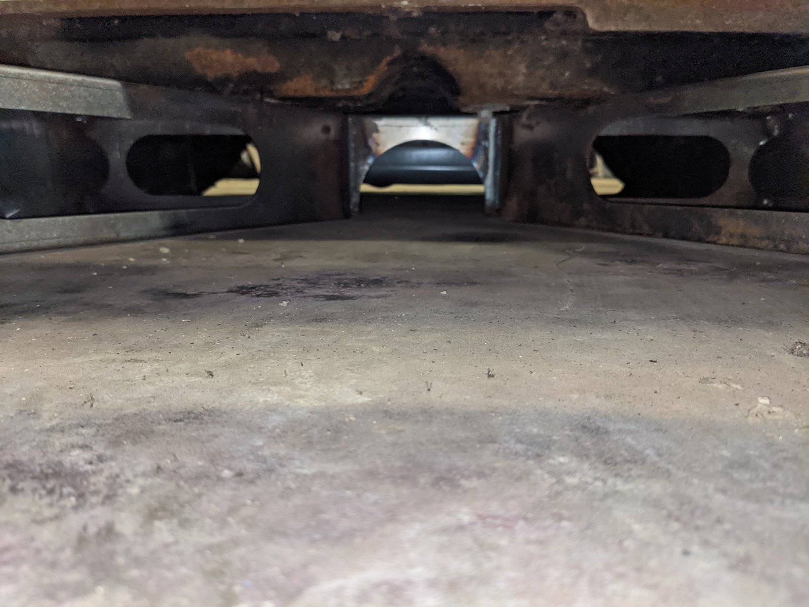

    99% of the guys building a hot rod 32 5-window will remove that short section of the floor under the seat that dips down. They replace it with flat steel or wood, and most any frame will fit underneath now. There are a few rivets and a spot weld or four to remove.
    -Brent- and Binderman01 like this.
  27. Binderman01
    Joined: Dec 31, 2018
    Posts: 102
    Binderman01
    So far so good! That was a very miserable few months!
    That is exactly the answer I was looking for! I saw no reason to need it, but also felt bad hacking it out, if it's just a few rivets and spot welds I'll zip it out and get a body bolted on!

    swifty
    This is the same problem that I had with my current build. My ch***is was built with a 36 style X-member and to suit a gl*** 32-5W body as my engineer was making noises about not accepting my other ch***is. Anyway he finally did accept it so the ch***is was spare. But when I went to drop the UPAC body ( my next build) on it the floor pan under the seat fouled so the pan had to go. Turns out son has a 32 Tudor and they have a wooden floor section under the seat so I now have that wooden floor under the seat. That pan was originally held in with screws same as the Tudor floor.
