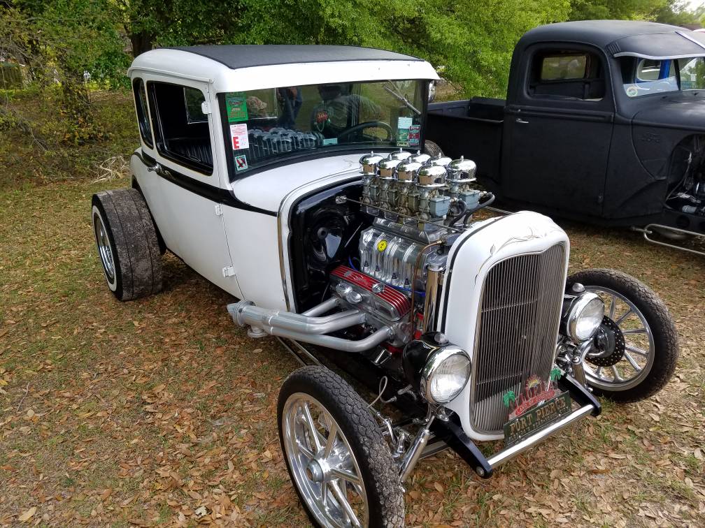

    Nice! I wonder how well it really runs. 8 twos on a blower has got to be a very challenging TUNE! b05d29fd672699427fe9cd122f00bda5.jpg

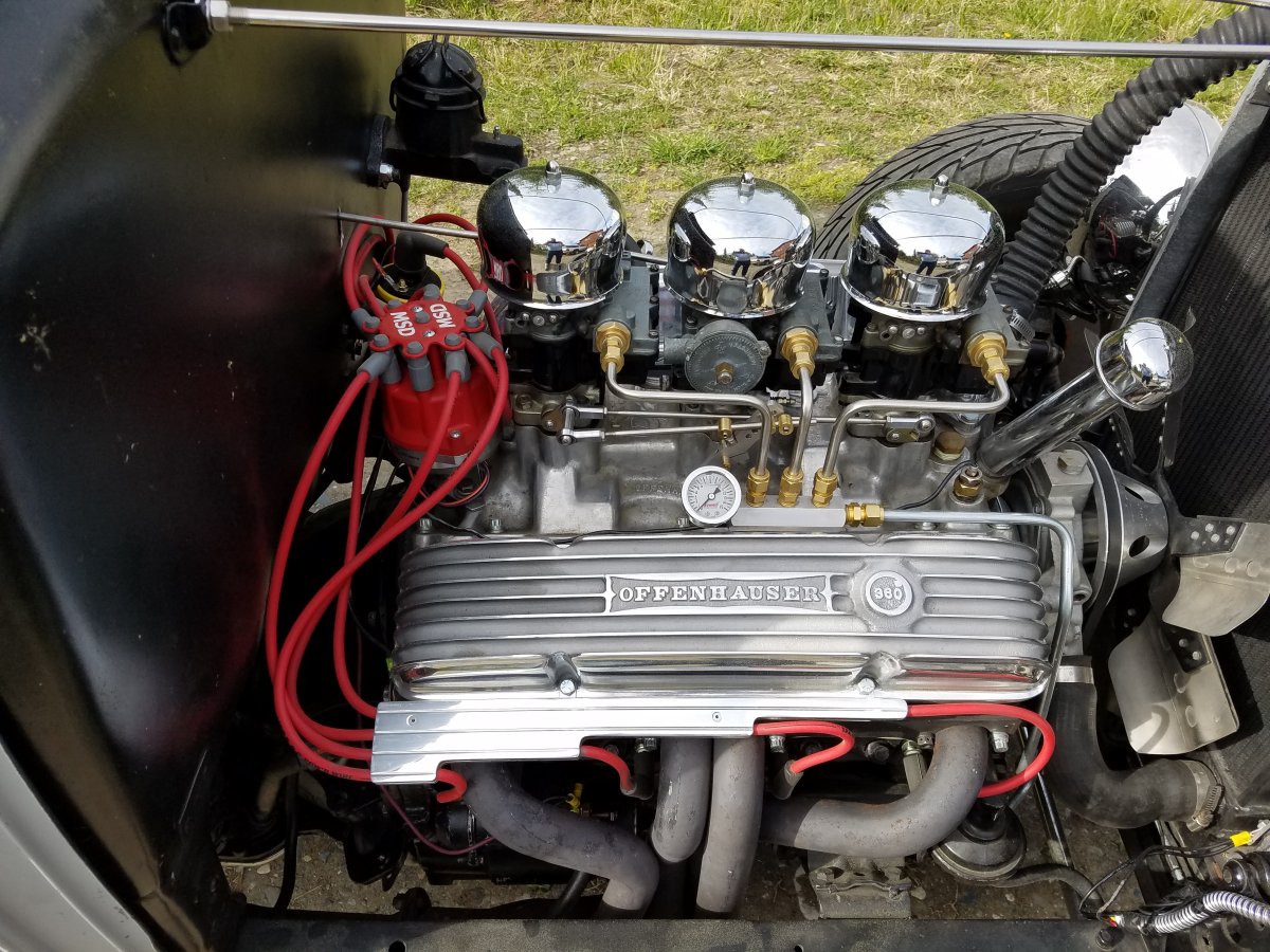

    This was last summer with the 350 SBC which went tu. Unfortunately, the heads on the new 383 will not work with the old Offy intake as the intake ports are too small to match up with the new Performer RPM heads. Really ****s as I liked that 6 pack setup. Oh well, on to dual quads I guess.

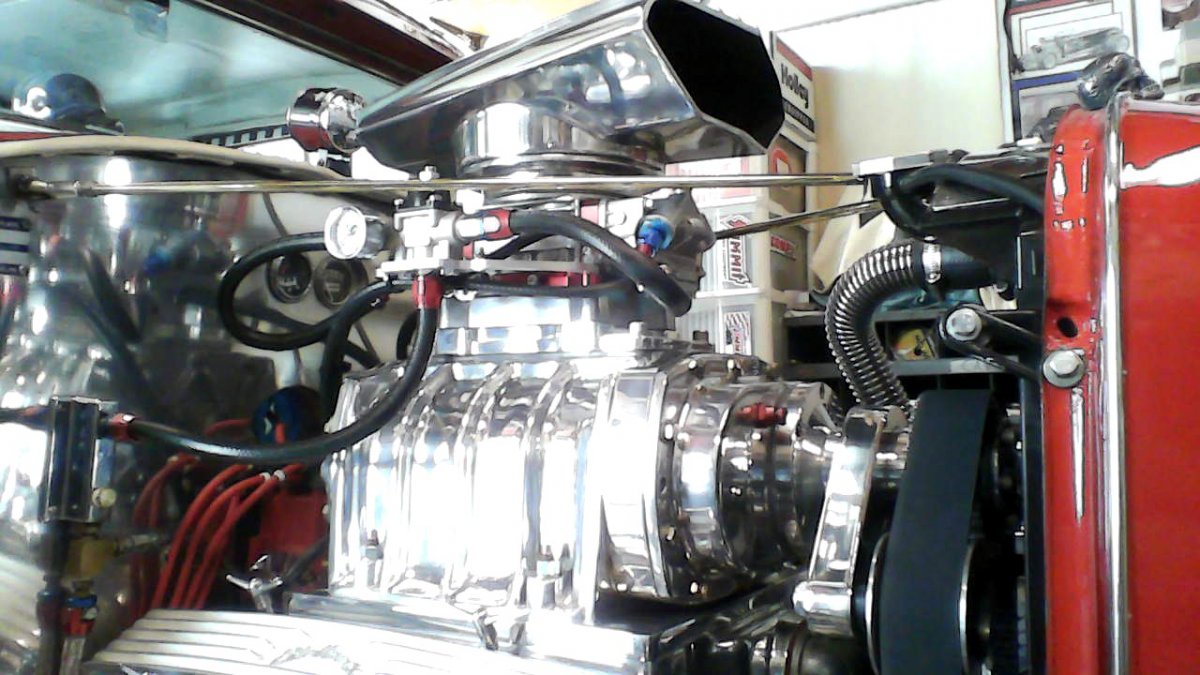

    Well ,today we got to take her out for some more testing. AFR # are good , goes slightly to 15,2-15,5 on a tip in of the throttle. As sone as you give her a little more , just a hair we are at 14s at cruise. At full pedal she is great, low 12s to 12.7. Throtle response is FRIGHTENING ! Next , we go o the track, and lay down some #s. I think I have got her dialed in for the most part. She goes a bit lean on a hair tip in of the throttle at cruise speed, however it is a bit challenging to cruise , idle at speed limit, give her alittle pedal and you are over the speed limit. LOL, My friend with me said on the second hit she was lifting the front wheels for 30 ft. he forgot to bring his camera :mad:. I could feel it and was trying to hold on and watch the readings at the same time. she is way stronger with the 950 DP, and a lot of tuning work, pluse 20 gal. of gas to do so :). A few pics of my monster. LOL.:D WIN_20170423_12_31_50_Pro.jpg WIN_20170423_12_33_10_Pro.jpg WIN_20170423_12_34_39_Pro.jpg

    Sounds like you are getting close to PERFECT. :)

    Yea. I am happy with the tune so far. She is cold blooded, I have to play with the throttle for a minute or two untill she gets a little heat, then she idles on her own, but she has always been like that so no big deal.;):)

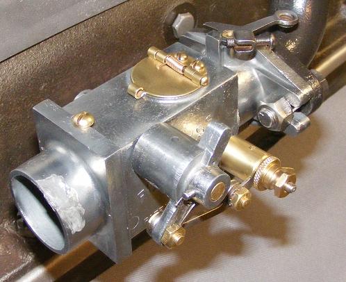

    832fbf4cee35c963c4cb9f22b37519f3.jpg porkn****** those are old floatless carburetors. They were an accessory carburetor for model Ts and i suppose other cars. Without a float you can run them any way you want.

    What if you raised the float level just a tad. Would that fatten up the tip in?

    Yea it might, its not bad at 15-15.2, it only stays there for a few seconds. It is mostly in the low 14s when trying so cruse at a steady state, which is a bit challenging LOL. She likes throttle, not speed limits.:eek:;)

    Sounds like a power valve change or some more accelerator pump.
