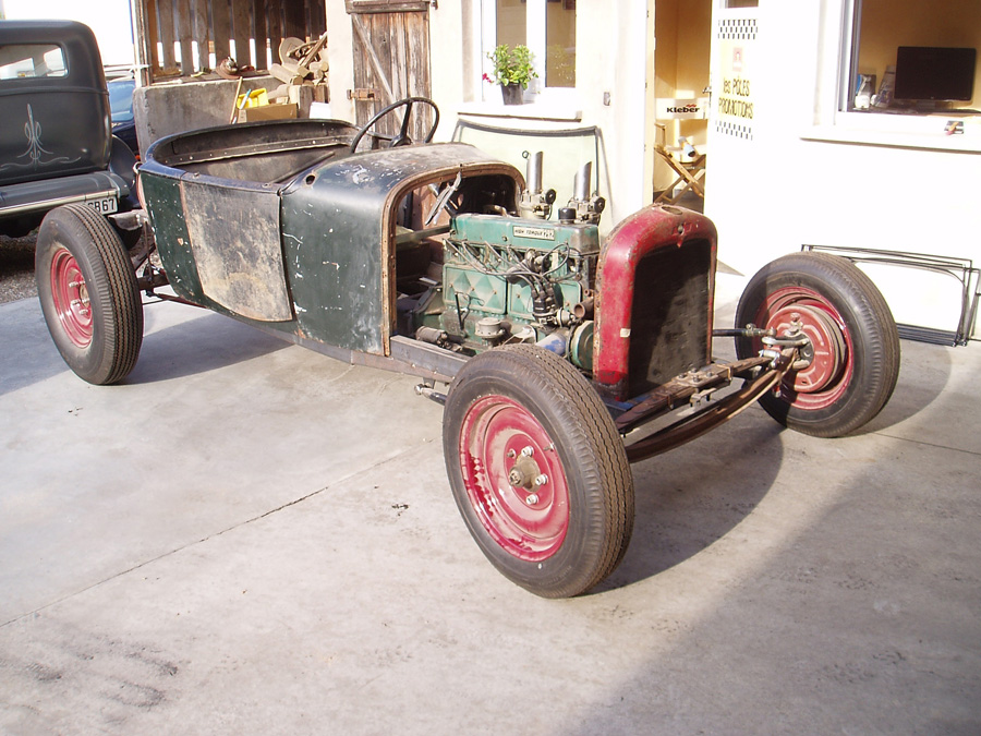

    I spent some time today to do a substructure inside of the cowl, to bolt the body to the ch***is, and also to bolt the MGB pedal setup.
    I was first interrested by using a cl***ical frame location pedal setup, but due to my narrow ch***is and space problem around the clutch, I decide to go swing pedal with this very compact setup (2 master cyl included).
    Another part of the structure will support the column drop (the strange column bracket on the left of the picture is a temporary support, tacked to have the column in the right angle).
    All the pedal setup and structure will be hiden by the dashboard.

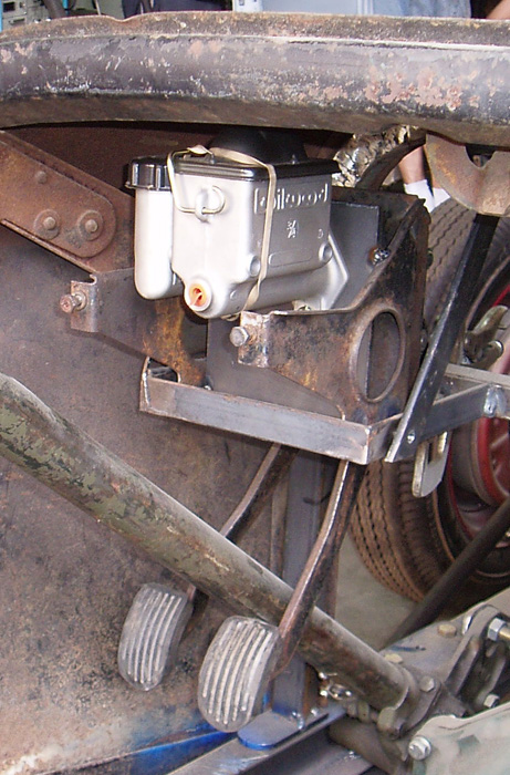

    After some long weeks (months ? :)) without any work on the modified, I was finaly back in the garage this week end..
    worked on a radiator crossmember
    Worked also on the front shock, Armstrong shock lever from a britsih car
    and some work on the pedal box (out of a MGB) to adapt two wilwood master cylinders.

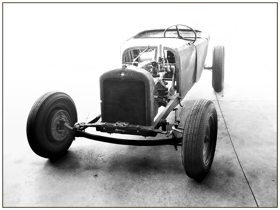

    another "motivation" pic..

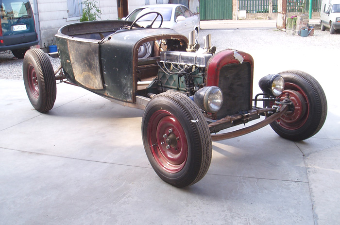

    Some progress those last days...
    -the body is definitely bolted on the frame
    -pedal system is working
    -column drop almost finished
    -shifter ***embly in place and working, with a custom made bracket
    -the floor mock up is done, need now to do the real one with good old wood
    -front suspension done with Armstrong shock lever and (34 PU ?) Ford shock links
    -home made headlight brackets, bolted on, and headlight in place (Citroen Traction Marchal Headlights)
    -most of the box plates for the frame are cut, need now to make a "welding day"...
    and that's all, folks...
    Looks now like a real car, with the headlights !
