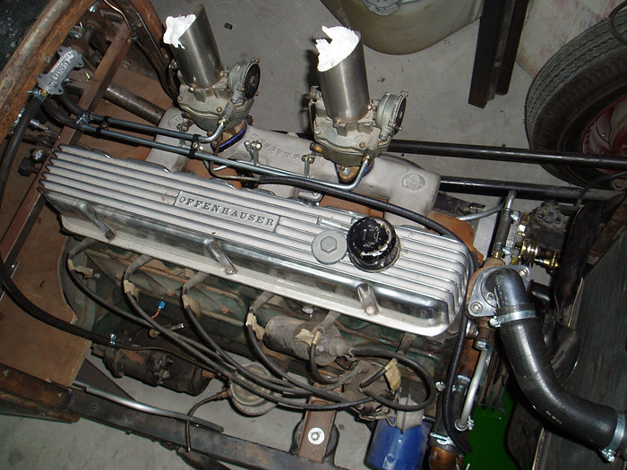

    after rebuilding the carbs, linked everything, finishing fuel lines, water hoses, and water heated the intake with some rigid tubes + hoses, I've started yesterday to fill the radiator.
    When the water start to reach the intake level, I saw a nice double leak around the Offenhauser intake... after checking that, it appears that the intake is leaky ! This intake comes with a water heating system, and, for some obvious casting reasons, there is 2 kind of freeze plugs to close 2 casting holes. And both are leaky !!
    This Offy intake is "made in USA" labelled, but, quality is "China style" !! I'm pretty upset !
    So, after removing the intake water lines (that event closed the "heating the intake or not ?" question) , I've almost started the engine ! but the battery booster was empty, so, engine first start video will be (I hope !) available at the next project update ! Stay Tuned !

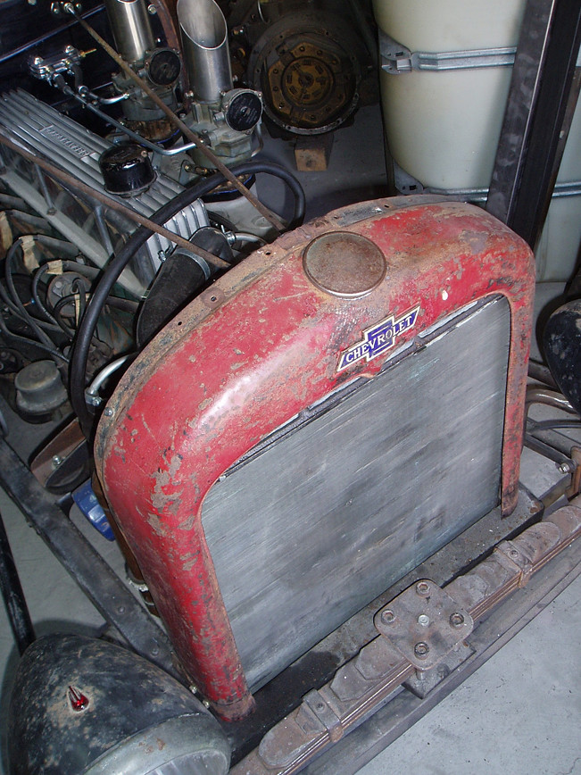

    I don't have a lot of time to work on my modified at this time, but this week i've worked a little bit on it. I've started to work on the firewall (I don't have the original one), and descide to go for a 2 part firewall like on a 28/29 Ford. I need now to add some beads, holes, bolts, to look more "original" . And of course, there will be some accessorries, like a cowl, regulator,fuel block, body tag, and radiator support brackets...
  14. Empire32
    Joined: Jan 16, 2002
    Posts: 874
    Empire32
    from FRANCE
    Some progress ! Firewall is not finished, but I've done some radiator support rod, using Model A brake links, cutted and threaded, and repop bracket on the firewall. I've also made a bracket on the radiator side, supporting also some sheetmetal work to close the space on the top of the radiator. This part is now equipped with a removable aluminium lid, to have an access to the radiator filling. I've put a vintage water cooling information plaque on the lid. Nxt step is finishing the firewall, by creating some beads and bolting together the upper and lower parts.

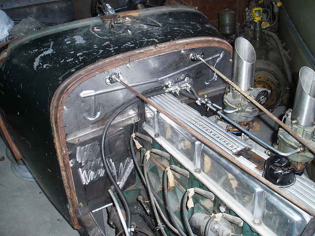

    I don't had a lot of time these past months, but, anyway, I've worked on it a little bit yesterday. Firewall is now equipped with a bead, and almost finished.

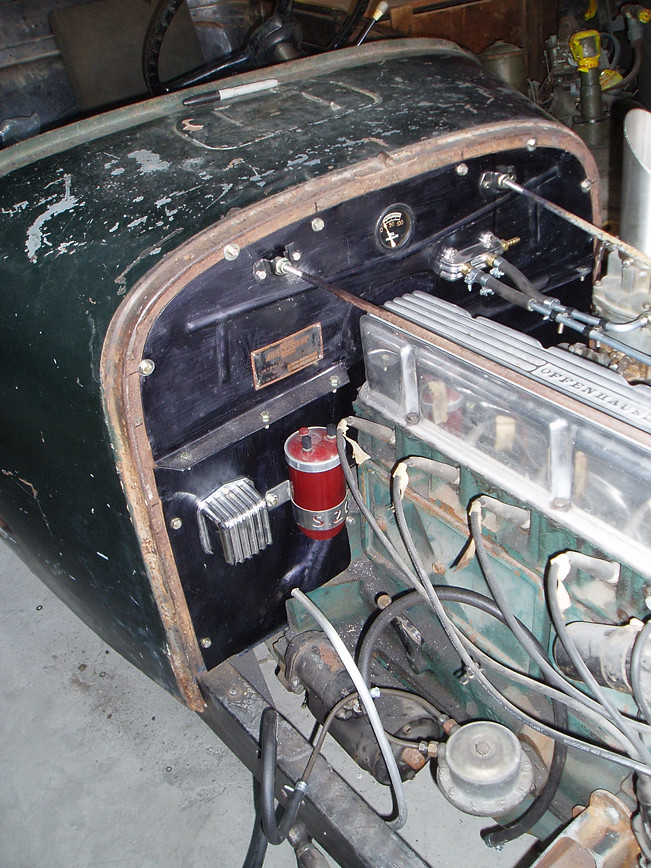

    The firewall is now ok, and bolted on with some accessories.
    I've also put a fake radiator cap, and the dashboard is now adapted and bolted. The body is a Citroen from 1924-25, and the dashboard is from a later Citroen model, around 1932. It's shortened and modified to fit.
