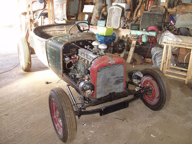

    What is the oil pressure gauge from ?
    Nice place and I love it .
  4. jerseyboy
    Joined: Jul 17, 2006
    Posts: 634
    jerseyboy
    Looks great! Love the pressure gauge location.

    thanks ! I don't know from where the oil pressure gauge come, but it's a vintage Stewart Warner unit. I wished to put it a little bit higher, but there is a square tube structure just behind the firwall at this place.

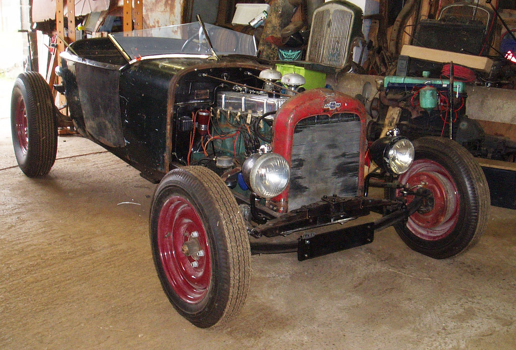

    Some progress: New airfilters, using cheap chinish speedway air filters, by swapping the cheap chromed and louvered caps with some old french Citroen van's center wheel caps.
    Still working on the wiring, using modern cable wrapped in old looking asphalt wire looms. Front & rear lights/turn signals are done, next step, fuse panel and dash wiring. I've started also to work on the dash, dash insert and instrumentation, switches, etc..
    Front licence plate is now bolted ( with a Hamb topper), using a clamp system, so, no holes in the I beam.

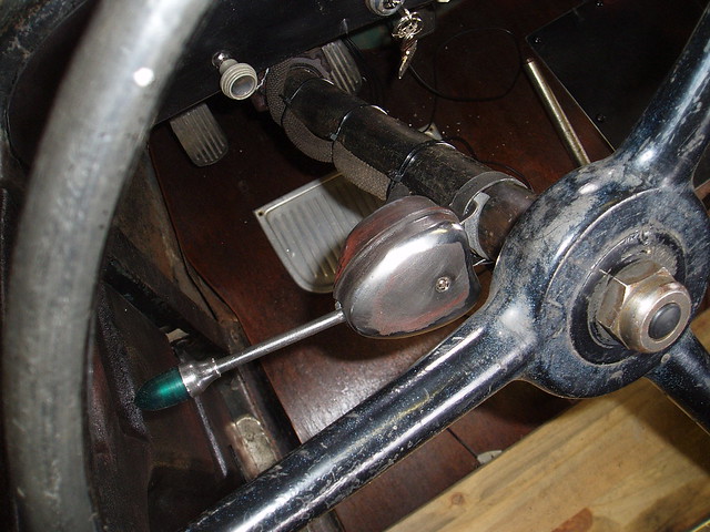

    homemade Fuse panel
    I try my best to ad some fake patina on the cheap taiwan made turn signal switch...
    general view of the dash
    adapted a licence plate light on the 50's Renault plate, also modified in order to bolt the great topper made by Whizzerick some years ago

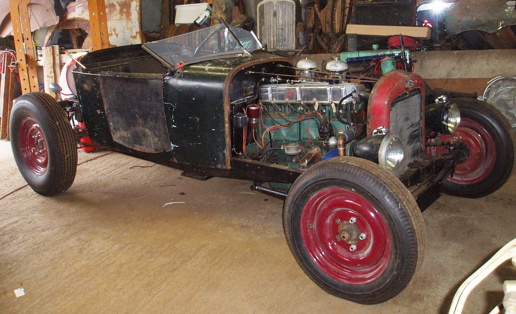

    some progress !
    First, on the exhaust sytem. The langdon split exhaust manifold is cool, but one of the outlet is just right on the steering box ! So, I decided to don't use a double line, and worked on this junction, in order to turn around the steering box, and run under the car. Here we go, with a 2 parts piece (easier to install).
    and on the car, with a Smithy's muffler and a straight tube. Not sure if I will use the muffler, or just have a long tube and an intern baffle, will think about it. If I use the muffler, I just need to change a little bit the angle, to have the exhaust more in the car's axle...
    and worked on some details, not always visible. I changed the hex bolts on the firewal to slotted ones, more "period". finished also the fuel line.

    Exhaust is now done, including hangers.

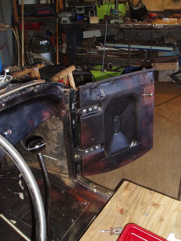

    I made some brackets for the turn signals, made from 30's Renault fender lights (Front light are Citroen Traction).
    Worked also on the door hinges. I don't have the original ones, and they are pretty rare. to be continued

    Home made door hinges done !
    Then, I worked on a Hallock style windshield "sktech" to find a better way to have a windshield, because I wasn't happy with the cl***ic windshield. So, it's just a rough test (here with photoshoped gl***es), I need now to find the better line, height, and then make it larger, and have it aluminium cast...If you have some ideas or advices, Go ahead !
