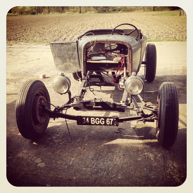

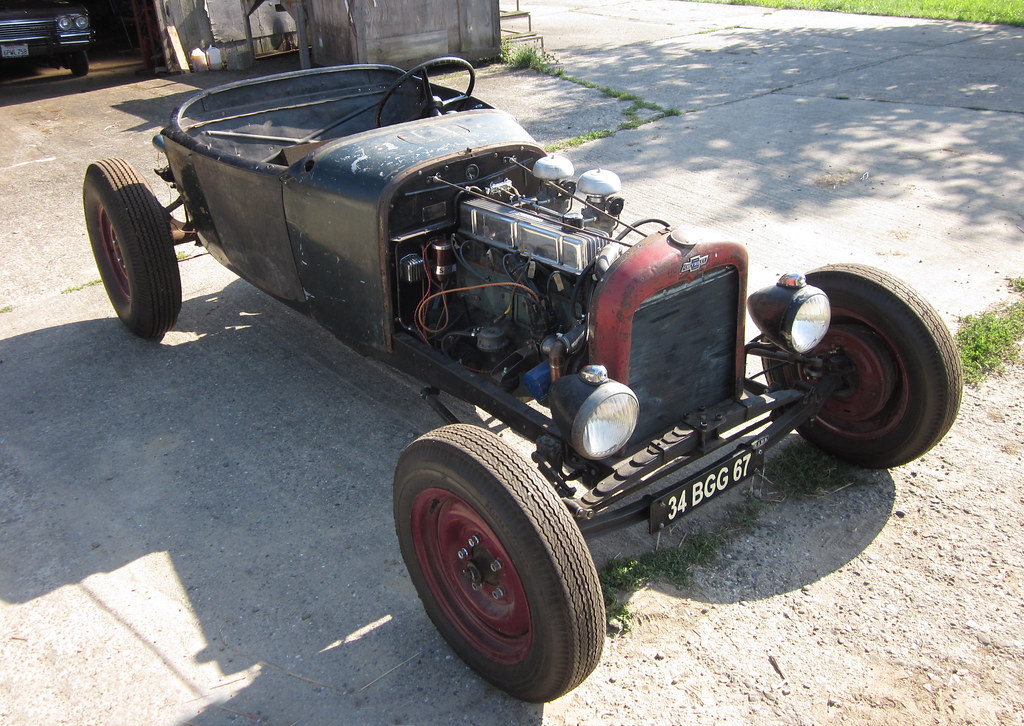

    After a looong break in the progress of the modified project, due to my lack of time, here's some progress, finaly !
    I've put some juice in the break lines, and on my clutch system, and it looks like everything is working.
    Electricity is almost done, lights and blinkers are working now, and I will start the engine soon !
    Here's the beast, rolled out !

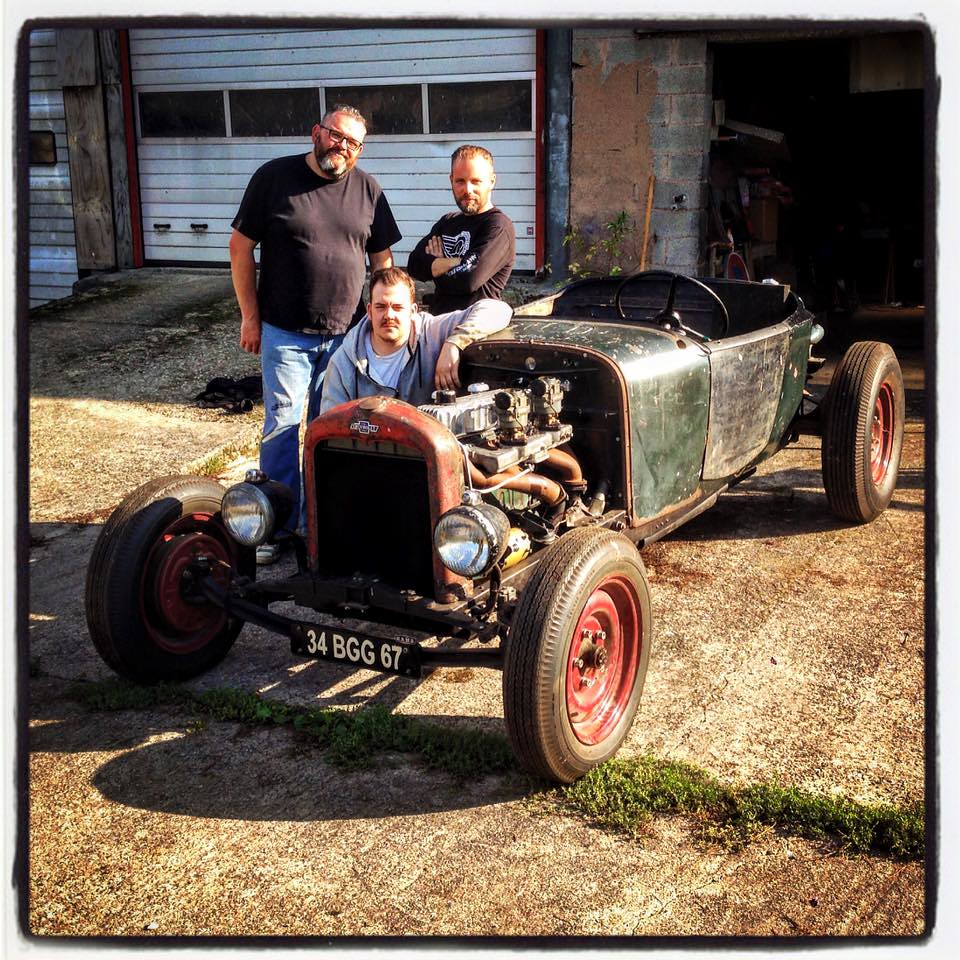

    Some news about the project : I was busy and a little bit demotivated, then the modified stay on the shop for a while. Until this spring, when I decided to work on it again. With a few friends, we was on our way to try to start it, and make the first test ride after finishing the engine wiring. But eventually, we discovered that the engine was stuck by rust, sitting too long in my shop... Then, We decided to be pro-active, and the same day, the engine was pulled out the ch***is, and dis***embled, and the day after, it was delivered to the engine shop. After been rebuilt, the engine is now back on the ch***is, and next step is to try to start it. During the last months, I've also worked on small details (finishing fuel tank straps, swap the radiator for a new one, new clutch, modified battery tray to put a bigger battery, etc...), and I'm close to the end. I hope to try it soon, and then working on dash panel and seat. I hope to hit the road next spring.
    Here's the modified with the friends who help me putting back the engin on it:

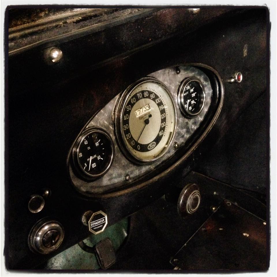

    After some years with almost any progress, the engine crisis from last spring was like a new beginning, motivation wise. So, I worked a bit on the modified during fall. Details, like the dashboard insert, made with the original insert from the Citroen C4 (around 1932) dashboard, and a aluminium plate, and some gauges. I was looking for some turned aluminium, but the best way to have this ramdomly turned look (as on most of the 20's racer) was to made it, with a hand made tool, to turn an actual botttle cork with a drill. The plate is bolted to the insert frame with old slotted screw, and equipped with 2 SW gauge (water temp and engine pressure) and a vintage Ford speedo. The SW gauges has been aged to match.
    mounted on the dashboard :
    I still have a lot to do. Mostly, a windshield frame with home made posts and stanchions (in progress), and then upholstery. But a few weeks ago, I take a big step, started the engine, and drive it a little bit around the shop ! I need now to work on the engine tuning, playing with carbs and jets, but this is a realy big step !
    check out the video :

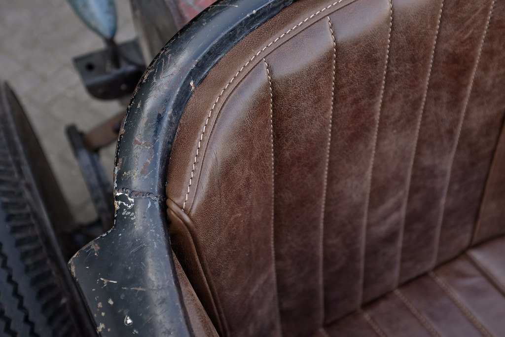

    Some news : I've worked on a new shifter, using a Model A stick, reshaped, and a Lucky Burton knob. Also, a great upholstery job as been done by one of my friend (he's a professional upholsterer), in a great leather, distressed to mtach the patina of the body. Since then, I drove it around 100miles, and until now, everything works great. I still need to work on a hood, and maybe a windshield, but I love it without windshield.
