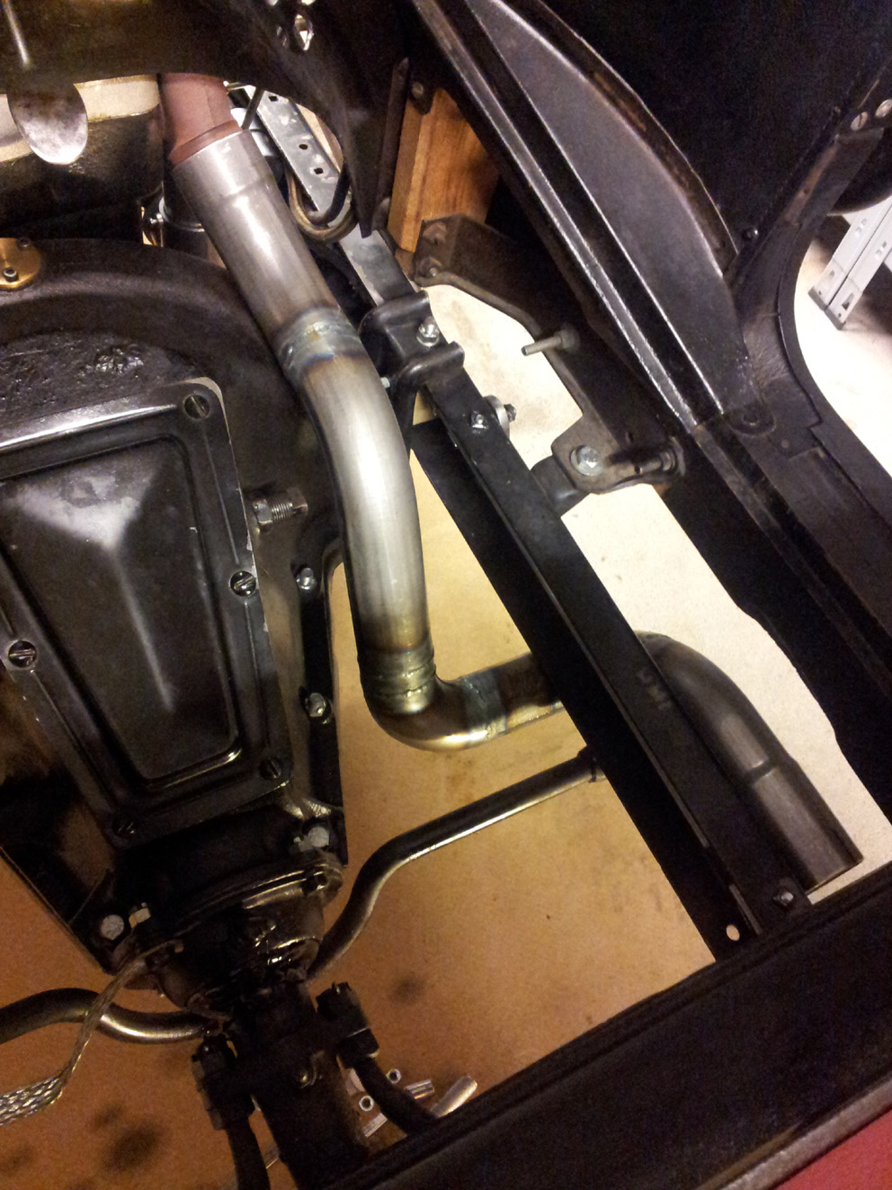

    After a longer run tonight, I could not understand why all the neighbors would grill at the same time, but it was just my car that caught fire... The exhaust pipe is too close to the body wood and even though I wrapped the tube with heat protection it smelled burning cedar tree och whatever Ford used. Must be rebuilt..

    No, luckily it was just a part of the body wood closest to the exhaust pipe about six inches
    so it's an easy fix.

    Well i now understand that the headers wrap was'nt enough, because the body wood took fire, so i had to redirect the exhaust tube. Now it avoids the fuel line, body wood, floor panel, an eventually over filled and dripping gas tank and it's a perfect holder for the new 2" copper exhaust tube...

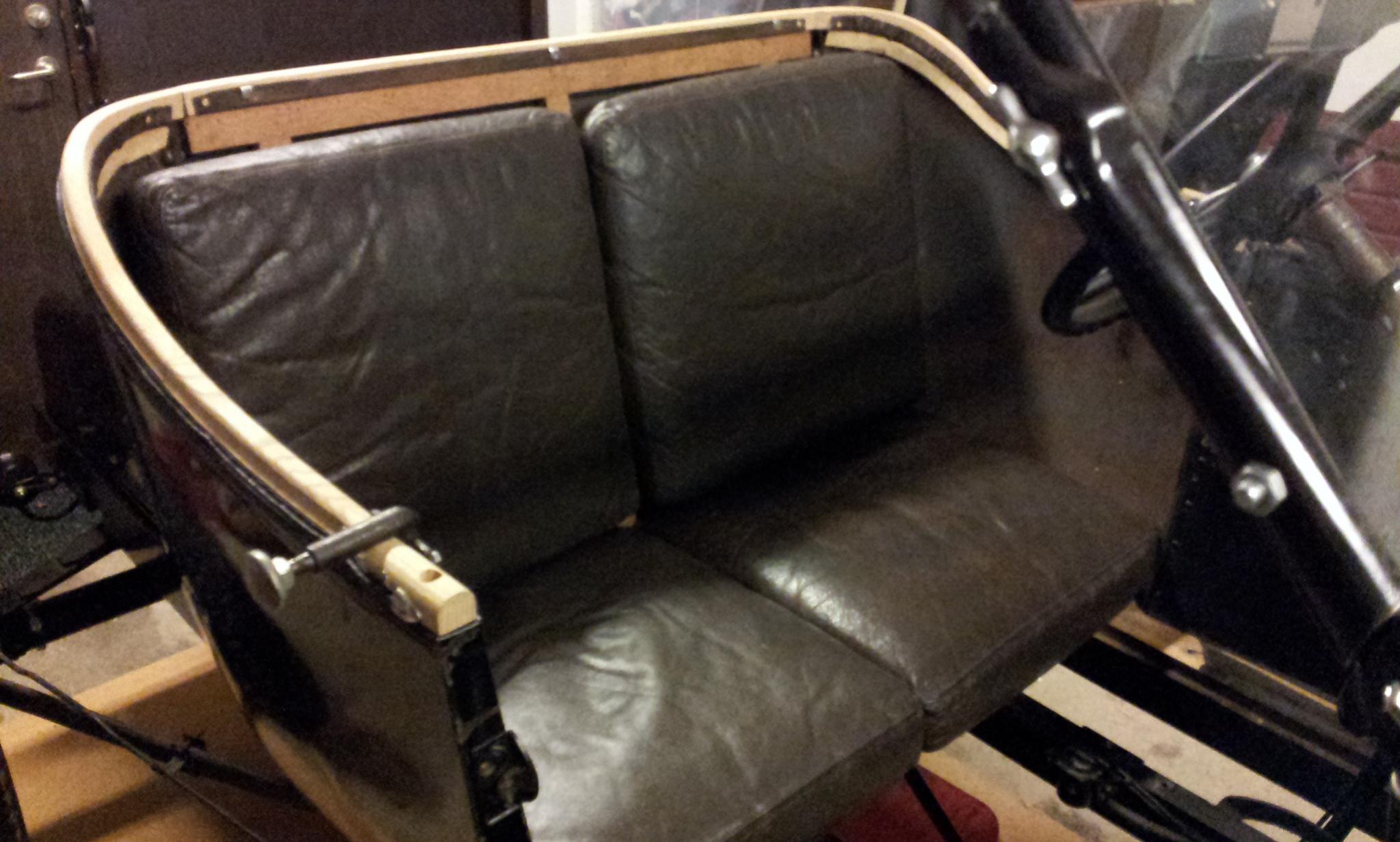

    Well, actually i like a bench seat more then two seats, but i saw some really nice ideas here on the HAMB, so i start looking for some couch ideas, from real leather sofas.
    Found a nice sofa far from here on the swedish Graigs list.. so i decided to make an offer. Hey -i pay Your price, but i just want the cushions.. that's ok?
    Today they arrived and was soon tested in the little T. Now i sit very comfortable with my head under the top edge of the windshield. Real leather and nice worn. Not black nor brown.. more like ... used.
    I still have to lower the steering column.. if i frontal crashes i will have the horn ****on right in my forehead...
