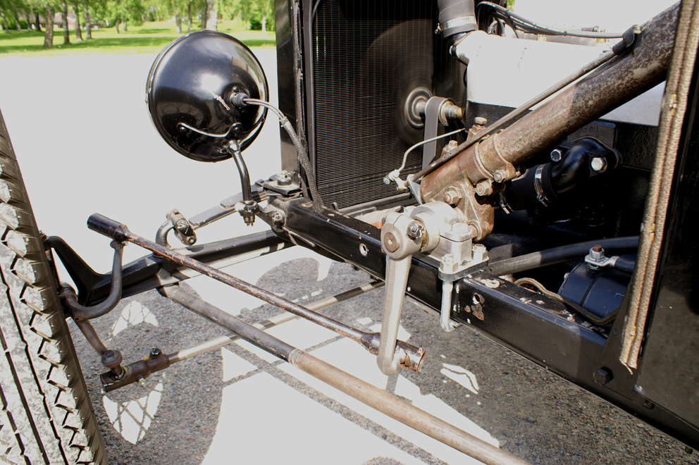

    I am wondering what spindles you are using on that front axle - I am trying to find some that will allow me to use a conventional box with a drag link that clears the spring perch.

    Kume, I used the original model T spindle from 26-27 which lowers the car a Little bit more then the 17-25. The best is if You can find a pair of spindles from U.K. they are the lowest ones. Together with a Mercury front axle You will have several inches without any bending.
    Well.. to Your question. I have model A steering arms that suits the T spindle without any modification. BUT.. You have to warm and bend the arm to clear the spring perch. Heat until the metal is Cherry red, bend the arm and let it cool SLOWLY by it self.

    Also forgot to tell You that the tie rod ball is cut off and relocated to the underside. Drill a hole and put in a weld in style one.

    I am fitting 1927 chev spindles which have very similar steering arm configuration to the A and a higher stub axle to the T (about an inch higher ). The problem is bending the steering arm to clear the axle and spring perch without affecting the steering geometry.

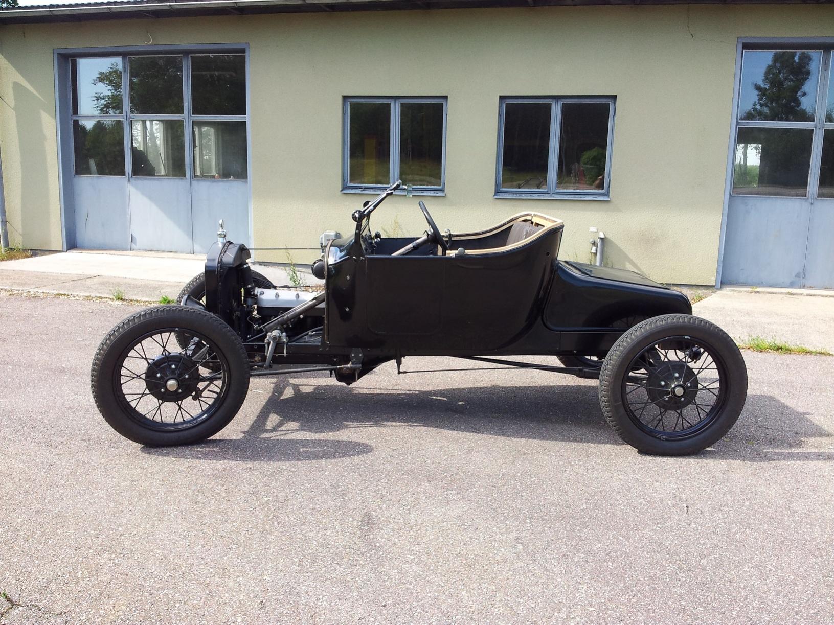

    The driving season is coming rapidly so i spent some time in garage today preparing the jalopy for the upcoming events.
    A couple of weeks ago i also could check one line in the book of Dreams.. the jalopy was featured in the latest issue of Swedish Gasoline Magazine. YES..!!
