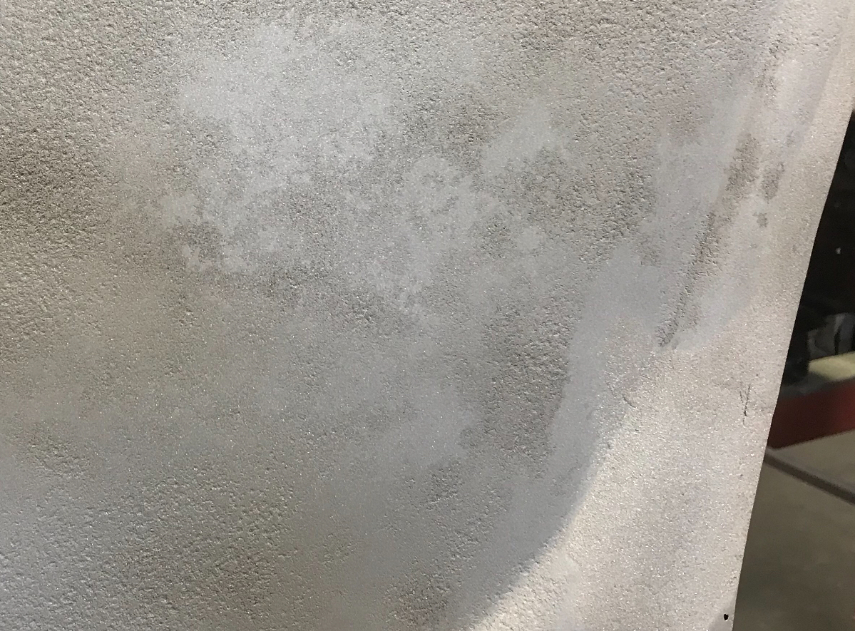

    More from Jim...
    In the the original Hamb thread from 2009, when the car was originally discovered, some people posted that the car should be cloned, re-bodied or that there would not be much original car left to work with. That was just not an option for us!
    Our goal from day one was to preserve as much work that Jimmy Summers had his own hands on as possible. This meant we had to plan everything ahead from the moment we started to start pulling it apart, and blast it to bare metal. We were very careful to try and leave as much of the original Jimmy Summers installed lead as well.
    Since Jon (Schuchart) knew we would have to replace the door skins, since they were rotted not only on the bottom, but in the middle where the fade-aways were bolted on, we did not blast the lowers, or any part that we knew we’d be replacing.
    The big news was that we had always heard stories about what a master metal man Jimmy Summers was, but it was not until we got the car back from the blaster and saw how amazing his metal work was on the chop that we got the full picture of how amazing his skills really were.
    The metal is a little scarred from rust, but you can barely see where his cut lines were.
    Keep in mind, this was 1940, when this car was only four years old, when Jimmy did the metal work on this car !
    This is the first time in over 75 years anybody sees this Jimmy Summers metalwork in bare metal.
    More to come. Jim
