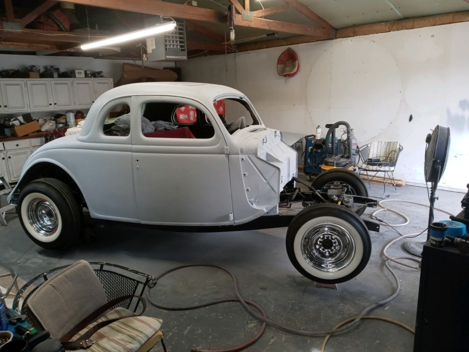

    OK, with the sub rails and floor handled, it was time to start fixing the cowl.
    We took the bottom 6 inches from the crushed donor body and grafted them to our cowl.
    Jon then made some very basic angle brackets that were exactly like the ones Jimmy Summers used in 1940.
    This is a place where a lot of builders try to get crafty and show off their fabrication skills and over engineer things.
    Our goal here was to put the car back exactly as it was.
    Nothing better, nothing worse.
