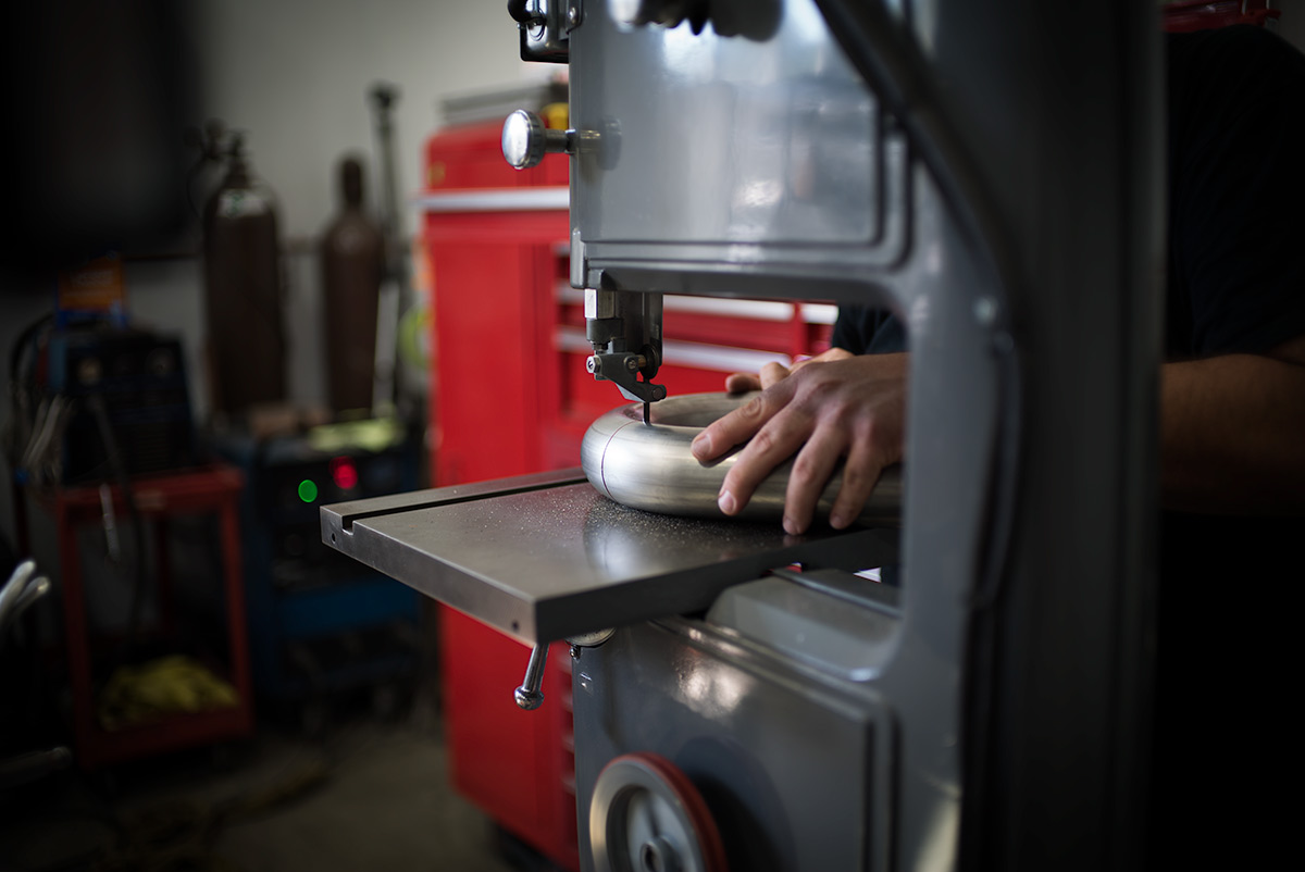

    Today is the first of what I'm thinking will be a few days of working on exhaust... Patience is a virtue on this **** man...
    63fdsnr and Cyclone_racer like this.
  6. Tidy exhaust is definitely a time sink
  7. A time sink, but definitely worth it. Great job.

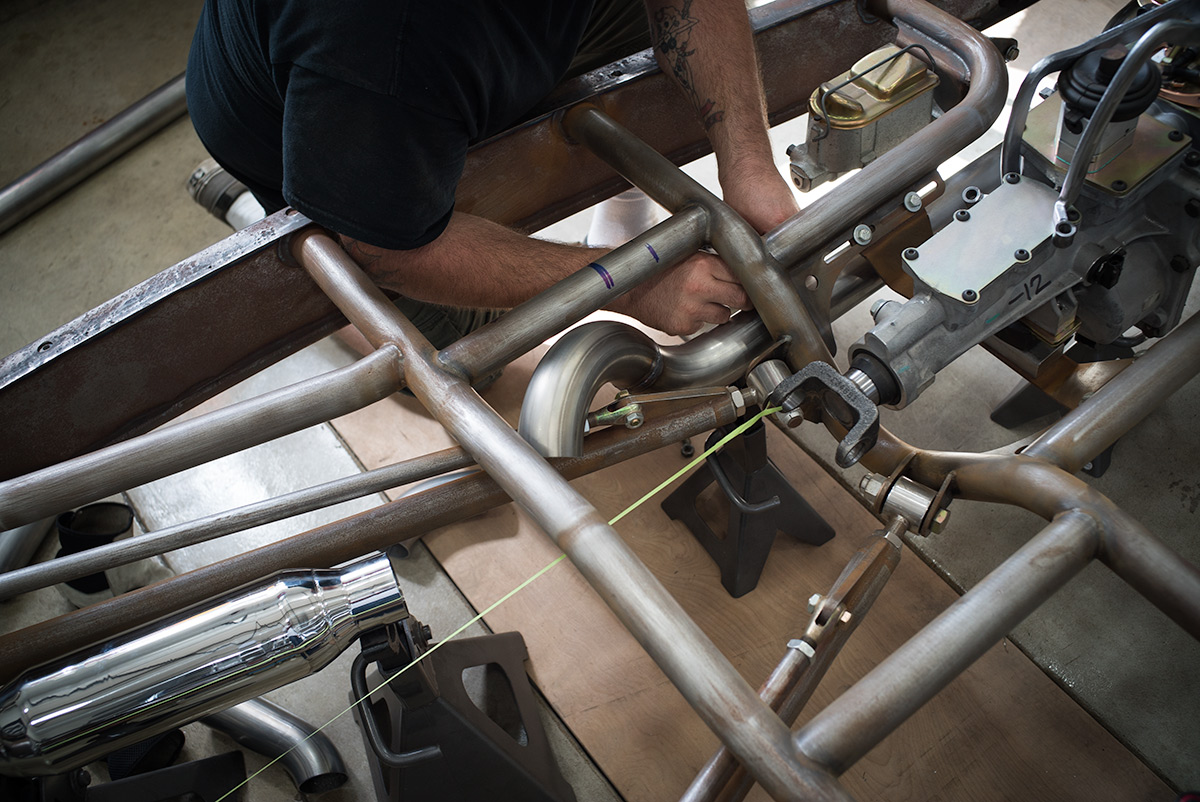

    Keith just sent me some more photos of the exhaust work he did today; so clean and I love that he is keeping it all tucked in the frame. A pet peeve of mine is exhaust that hangs down like a cow's udder; that kills the profile of a car. Not here man, not here.

  25. Very nice plumbers work. If you ever tried to cut a bent tube square you can imagine what this means. Job well done.

  26. How's the speed reduction working on the saw Ryan?

    Having done that myself more than once, I know how true that is. But it's a challenge I enjoy. I hate exhaust hanging below the frame...and I like it exiting just under and parallel with the rear horns.
    My verdict is this one is right!
  28. Ditto Tony.
    Out of curiosity, what size (dia.) was the bulk of that exhaust built at, and was it just stepped at the headers, or prior to getting to the rear suspension pivot mount?
    Admire the detail, and appreciate the effort to capture it.

    It's the little bandsaw that could. I put one of those real expensive bi-metal blades on it and it's still sharp as hell...
    Yeah, at the collector... The exhaust is 2.5"...
