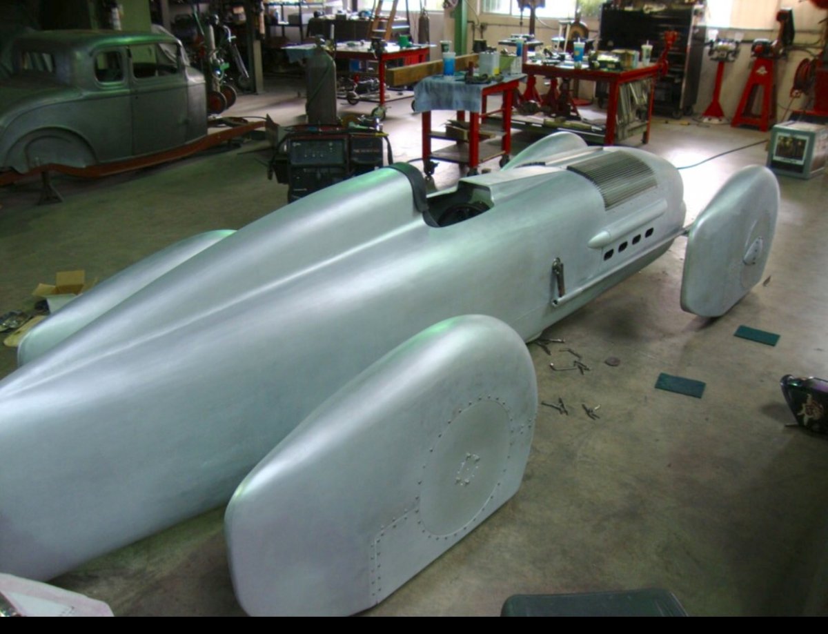

    image.jpg Love the link to Jeb Scolman's Stutz Black Hawk recreation. And yep, there you are, lurking in the shadows....
    KCsledz likes this.

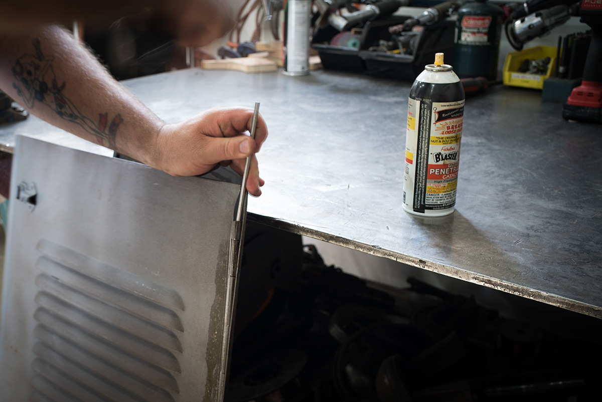

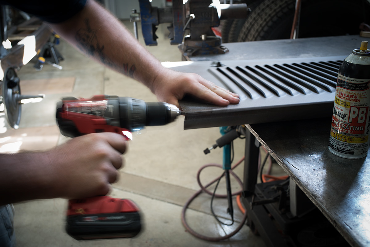

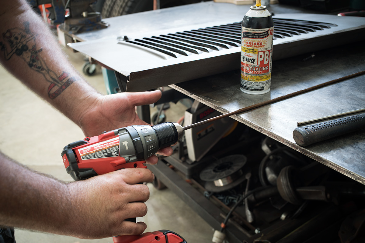

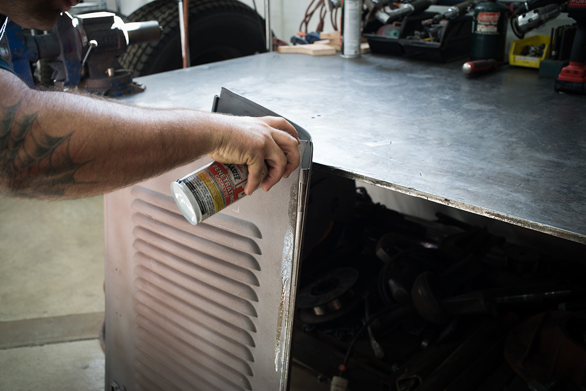

    How about a quick piece of tech that comes straight from Vern Tardel?
    Ever tried to remove the hood side rods from a '32 hood? It can be a true pain in the *** - right? Well, not anymore.
    Step 1: Spray the hinge down liberally with PB Blaster.
    Step 2: Using a punch, drive an inch or so of the rod out of the hinge.
    Step 3: Flip the hood end for end and chuck up the exposed length of rod to your favorite drill.
    Step 4: Pull the trigger on that ***** and pull gently. Done.
