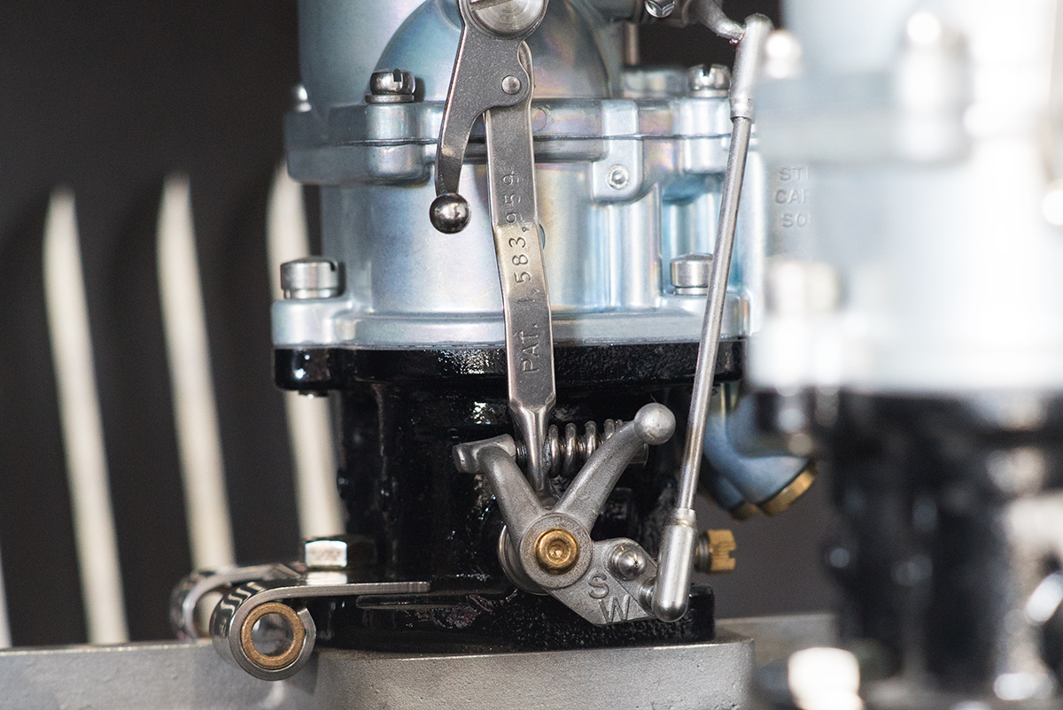

    So linkages on log manifolds are complicated beasts... Keith got a "bright" idea though. If he cut the arm off a stock throttle shaft and put it on the reverse side of the shaft, he would have a push arrangement instead of a pull - simplifying the linkage. So...
    Here's how they look stock:
    Here's one being cut:
    And here's one almost finished:
    Brilliant, right? Only, we didn't realize that Clive actually makes a push style shaft... Limey *******! Oh well, good exercise anyhow!

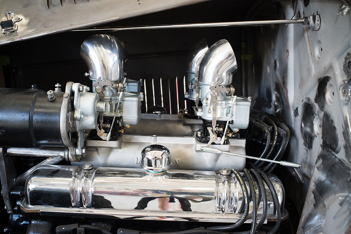

    The body is still at paint... But Keith farted around today and made a linkage for the nailhead. Check it out:
  28. 3dnsouth
    Joined: Mar 19, 2006
    Posts: 1,216
    3dnsouth
    from North Ga
    Really nice job on the linkage.....clean and neat. Do the intake manifolds move apart much as the engine gets hot? Just kind of wondering about any bind or is that figured in/allowed for(if they do move).

  30. Ryan
    Joined: Jan 2, 1995
    Posts: 22,900
    Ryan
    ADMINISTRATOR
    That's a valid question that I'm not smart enough to answer with certainty. I'd think though that any movement would be negligible.
