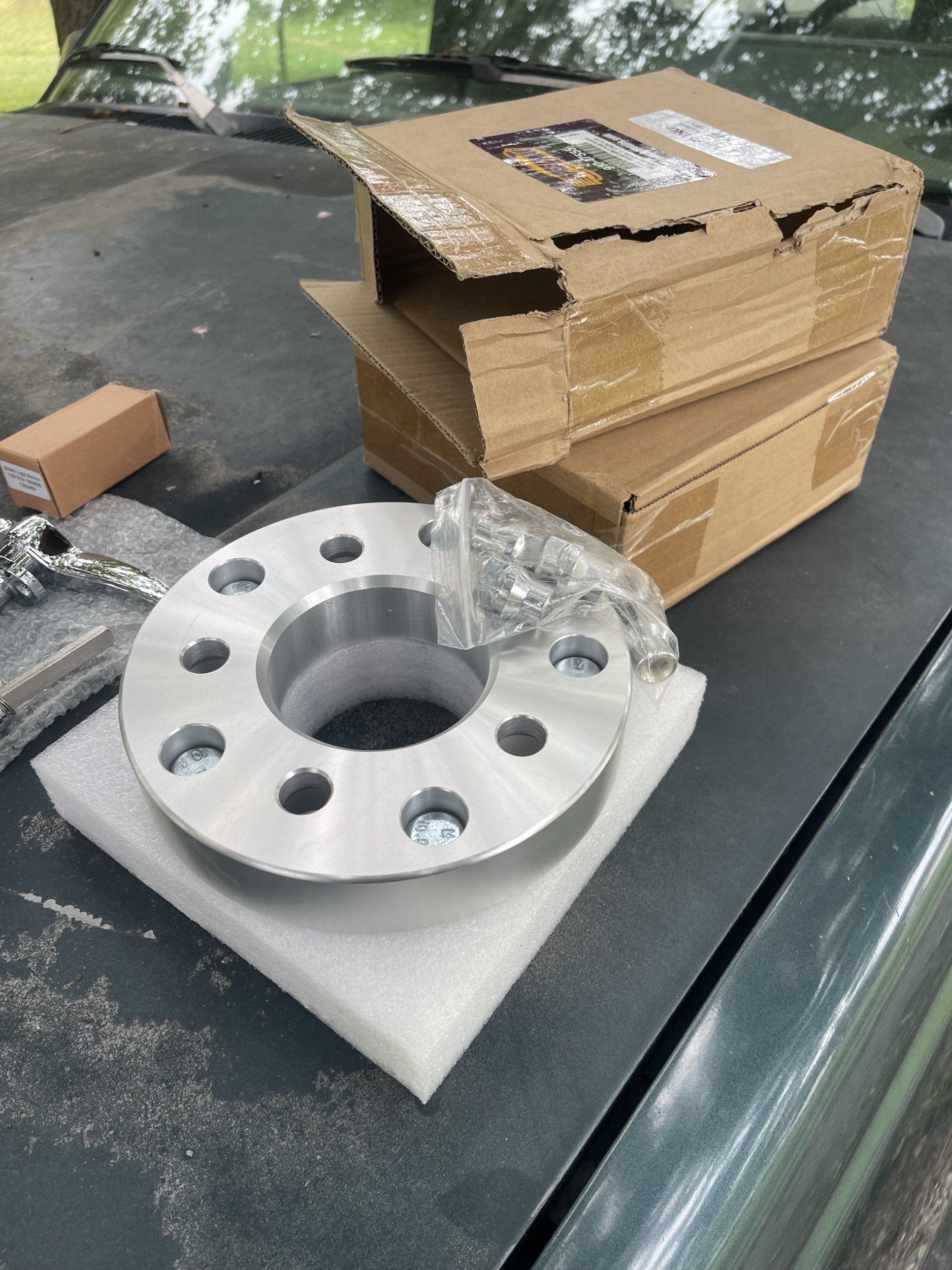

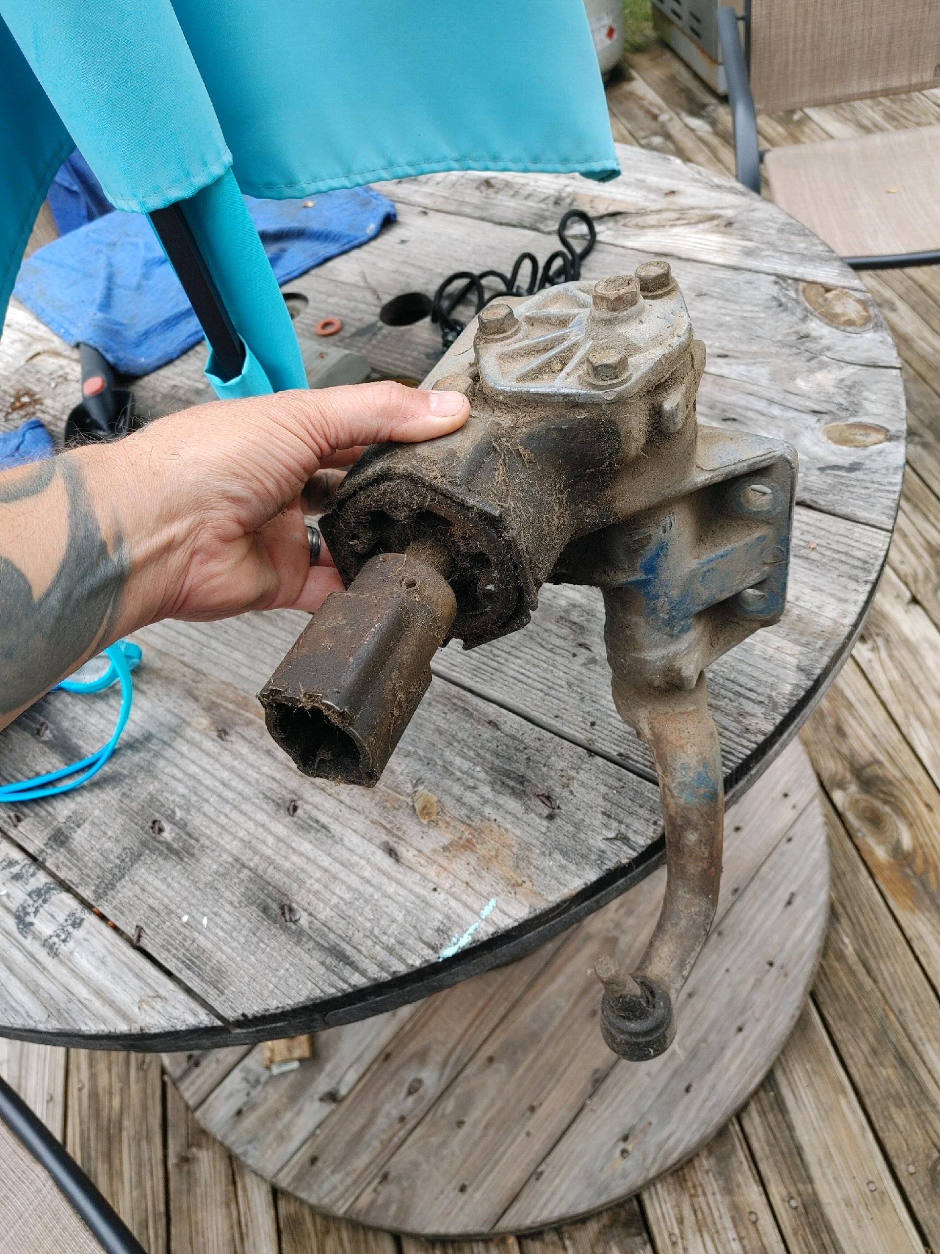

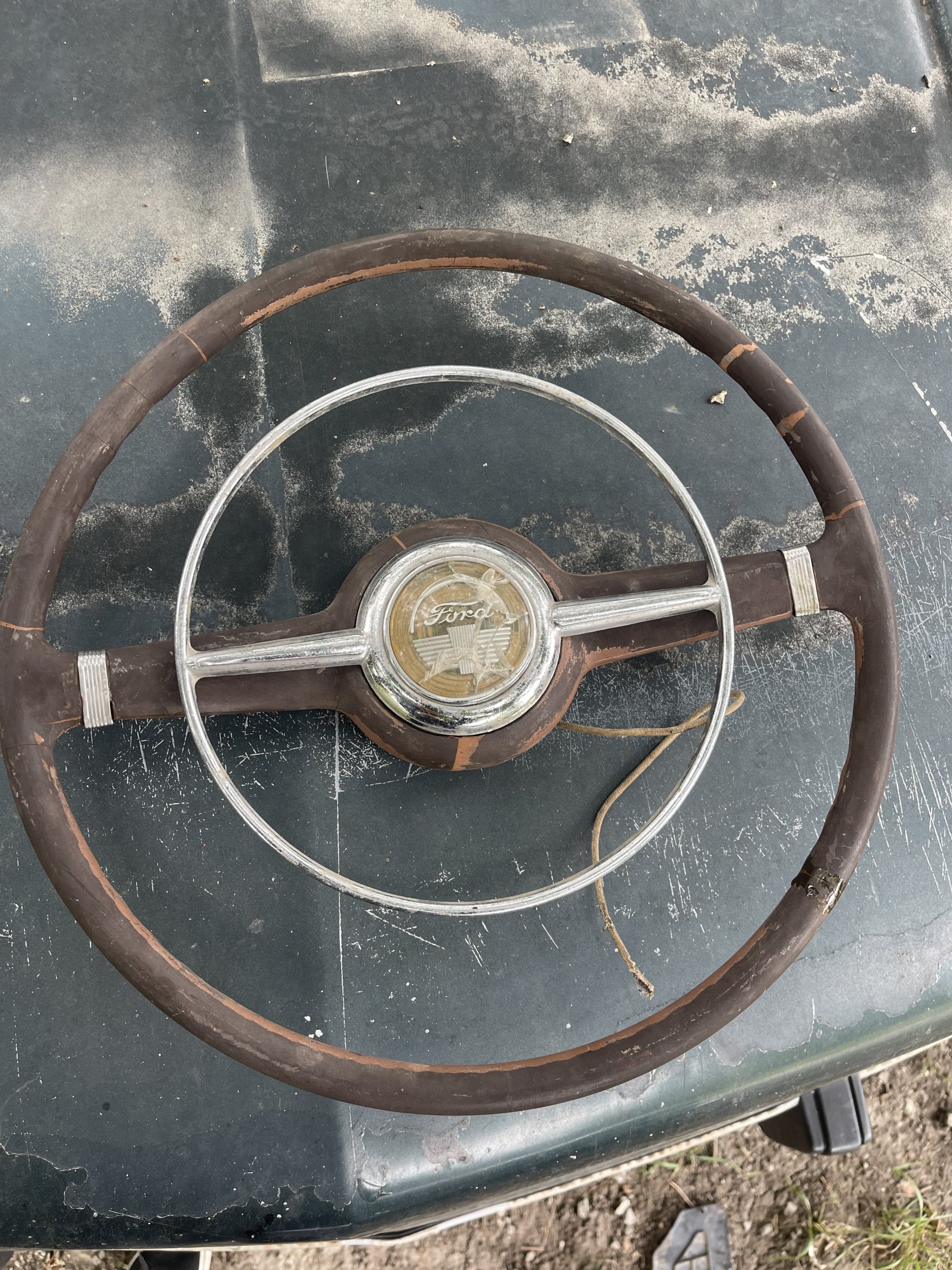

    Brought a pile of parts over to Joey last night. Got an A body Mopar steering box and a 46 ish wheel from @Tim I had the ring and ****on from a swap meet from Jimmy years ago. Plus a pile of little stuff needed to make it a “car”

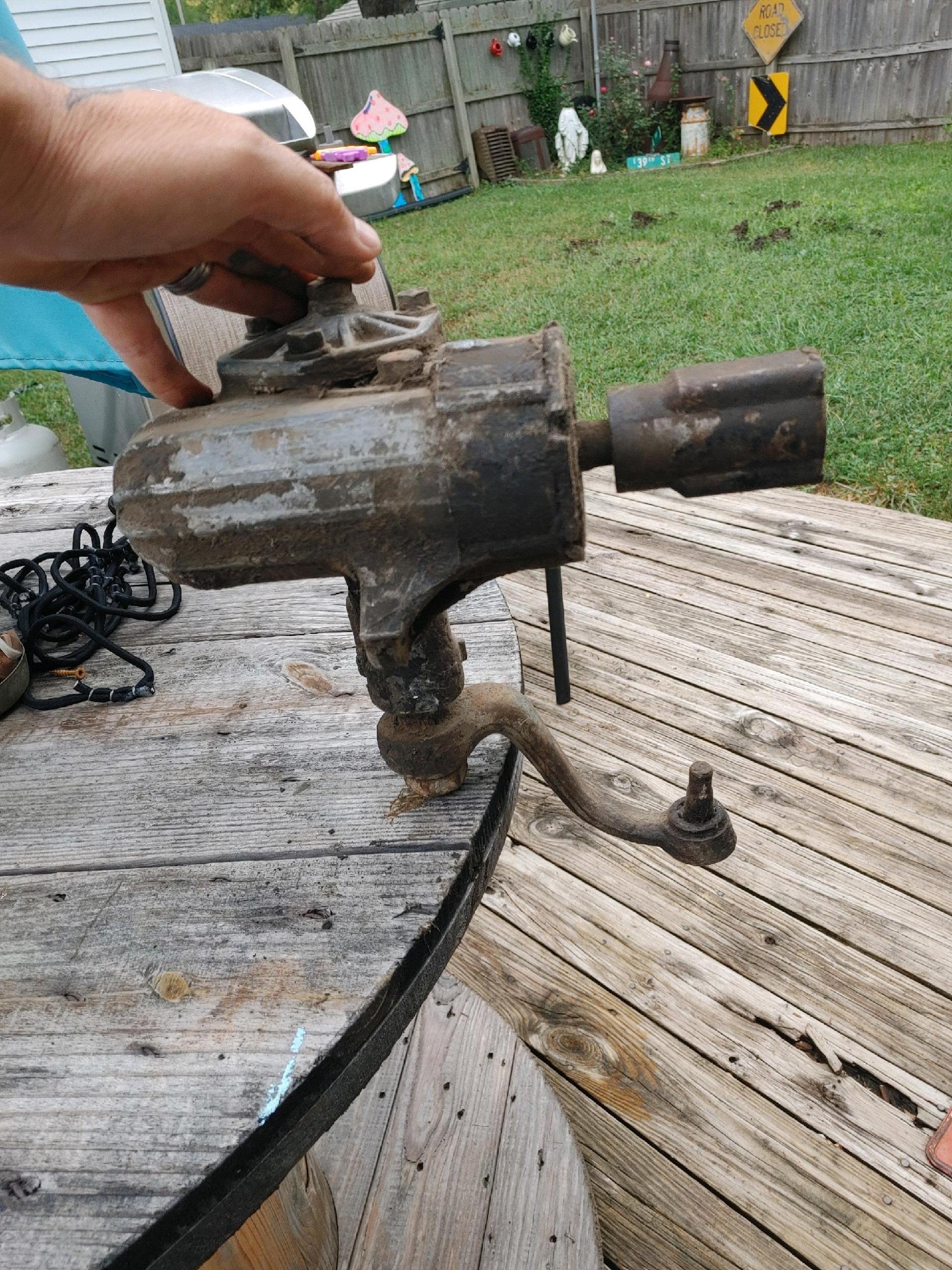

    Is that steering box aluminum? Seemed like it might be. Bet @Bandit Billy would have it polished up enough to get your eye balls sun burnt lol
  12. Bandit Billy
    Joined: Sep 16, 2014
    Posts: 16,467
    Bandit Billy
    I'd shine it!
  13. coupe33
    Joined: Nov 23, 2004
    Posts: 686
    coupe33

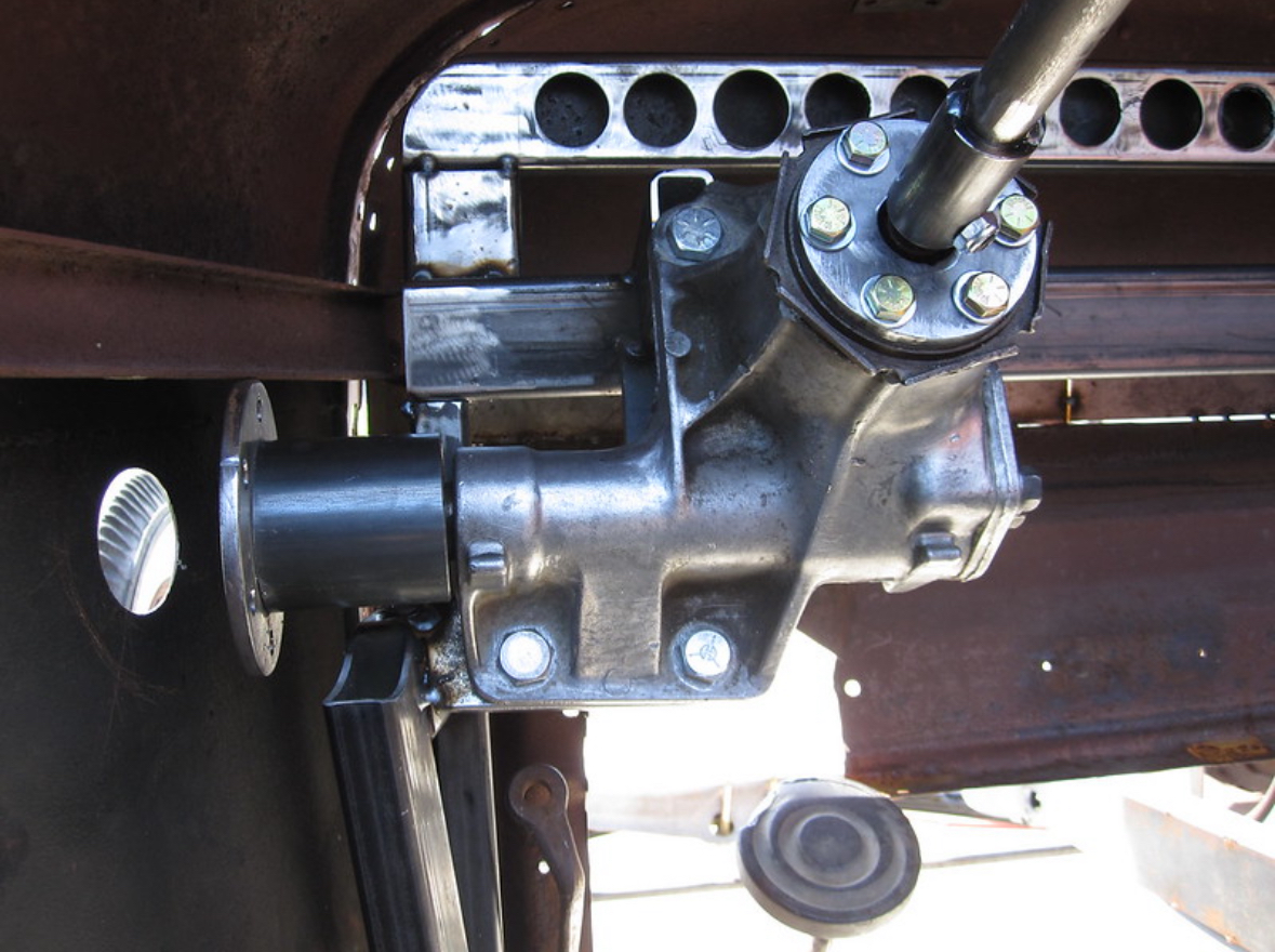

    A body Mopar steering box? What advantage does it have over cross steering and where is it mounted?
    Stogy, chryslerfan55 and porkshop like this.
  14. Tim
    Joined: Mar 2, 2001
    Posts: 20,827
    Tim
    from KCMO

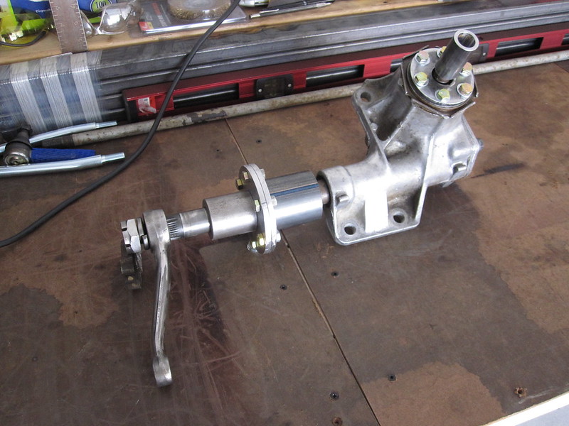

    @coupe33 its the box the majority of people use to get cowl steering. Bolt it to an under cowl hoop generally.
    as far as why he got one, he needed a steering box upgrade from a model A box and it was available.
    as far as why not cross steering? Because the car is already set for side steer and he wants to keep it that way.

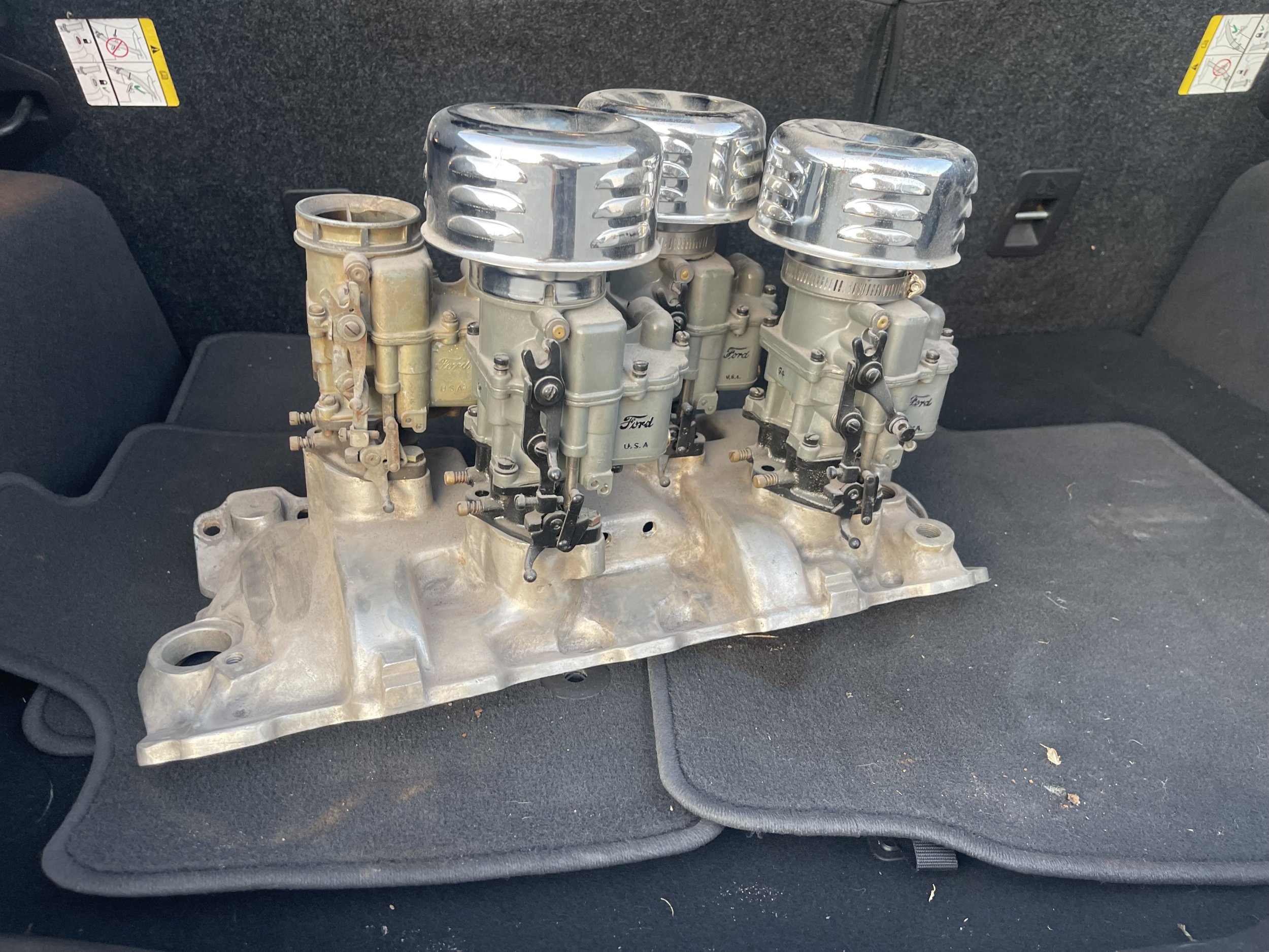

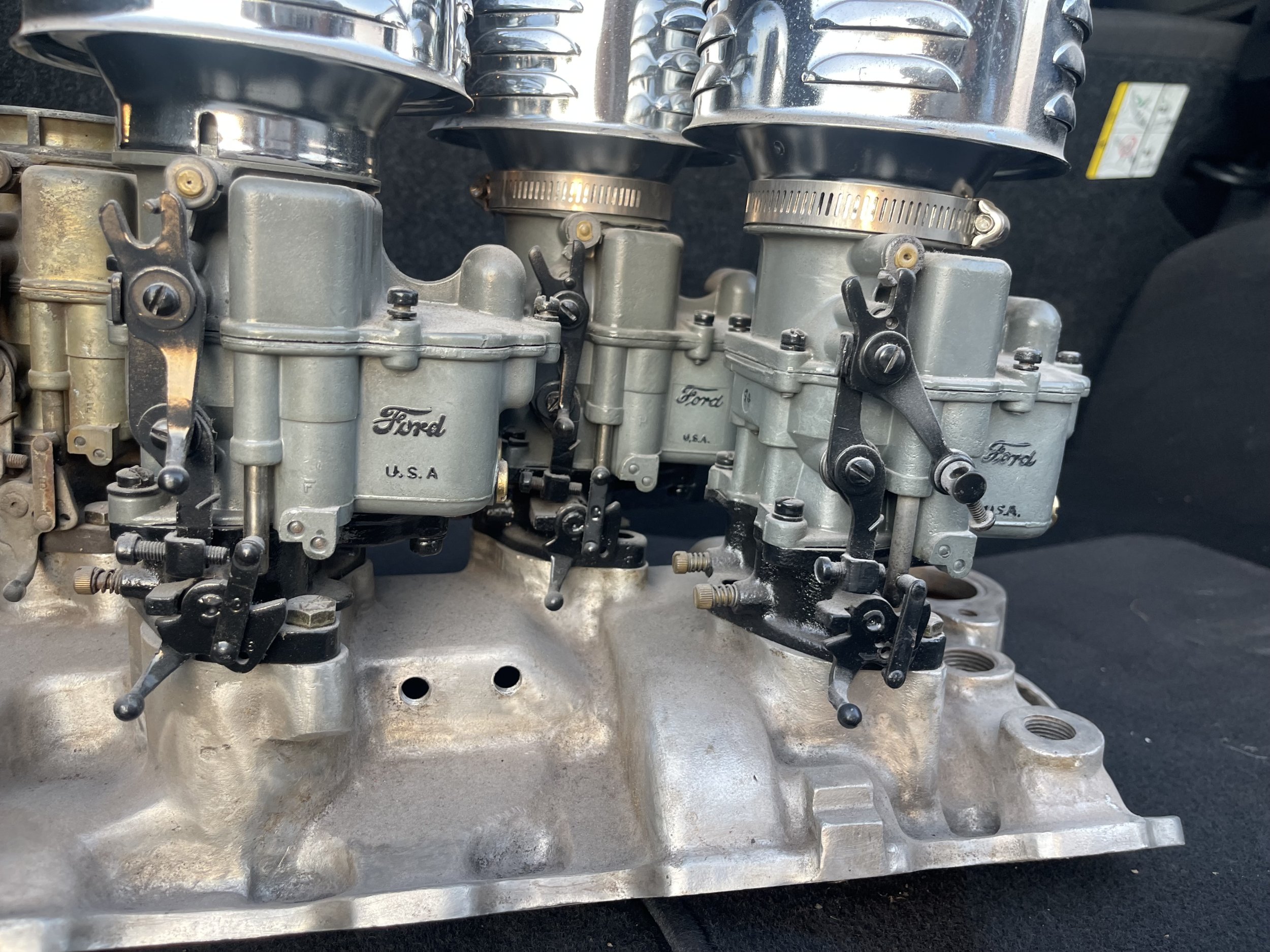

    so of course we mocked it up with my 4 carb weiand manifold...
    and that's all I've got for this week. tune in next time!

    it was free.
    that's it, literally the only reason we are even attempting it.
    Otherwise I probably wouldn't bother since its HUGE.
  17. Tim
    Joined: Mar 2, 2001
    Posts: 20,827
    Tim
    from KCMO
    5 window body
    4 carburetors
    3 pedals
    2 tail pipes
    1 cool hot rod.
    simple math really lol

    I made a mount for the steering box, and then ran the shaft, u-joints and supports.
