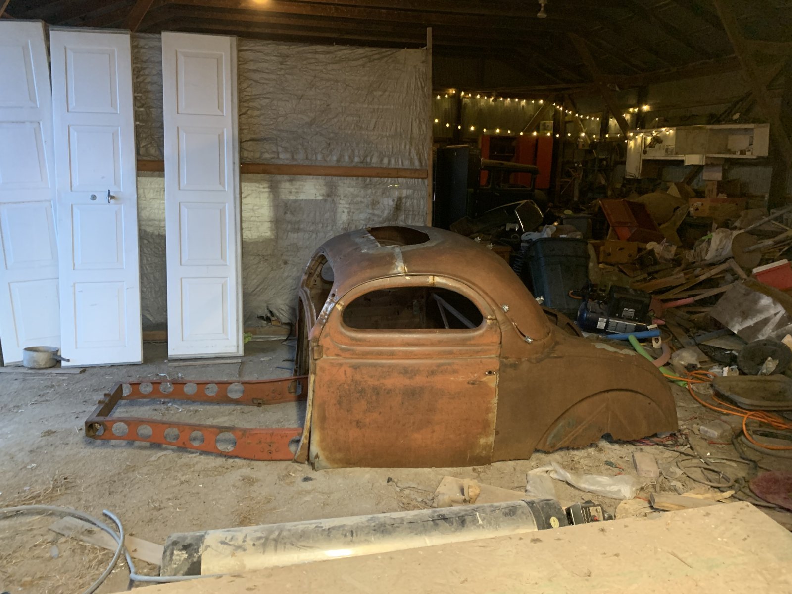

    Since I can remember I've always wanted a 33/34 and its time to be real they aren't doing anything but getting further out of reach, a buddy of mine had been toying with the idea of turning a 35/36 into something that resembles an old lakes 33/34. But called it quits after clamping the roof back together with body clamps and that's about the time I show up with some money and a truck. I buy the body and a set of 34 frame rails he had and set off on my way home with an idea brewing,
    IMG_6427.jpeg 3C822FB9-8438-43E4-A615-4A0891445A16.jpeg 31613F0D-0428-43CA-85A7-2FCEB57E13EC.jpeg IMG_5310.jpeg IMG_6418.jpeg IMG_5906.jpeg IMG_7366.jpeg C559F539-F22B-4E46-B05A-3D05931439E2.jpeg IMG_5269.jpeg IMG_5348.jpeg IMG_7360.jpeg IMG_7360.jpeg IMG_5348.jpeg IMG_5269.jpeg C559F539-F22B-4E46-B05A-3D05931439E2.jpeg IMG_7366.jpeg IMG_5906.jpeg IMG_6418.jpeg IMG_5310.jpeg 31613F0D-0428-43CA-85A7-2FCEB57E13EC.jpeg 3C822FB9-8438-43E4-A615-4A0891445A16.jpeg IMG_6427.jpeg
    Once home I looked at my recent acquisition and realized its gonna need............ everything its simply jus a set of doors and a roof that's clamped together, BUT man it has the look, I go about my business finding every piece of a 36 ford cowl and hood I can get my hands on... after some horse trading and a bit of money I had my nose. I was still in need of a piece to make it have that charm a model 40 has. Joey happened to have a war year Packard grille hanging on the wall and for 20$!! I couldn't p*** that up!

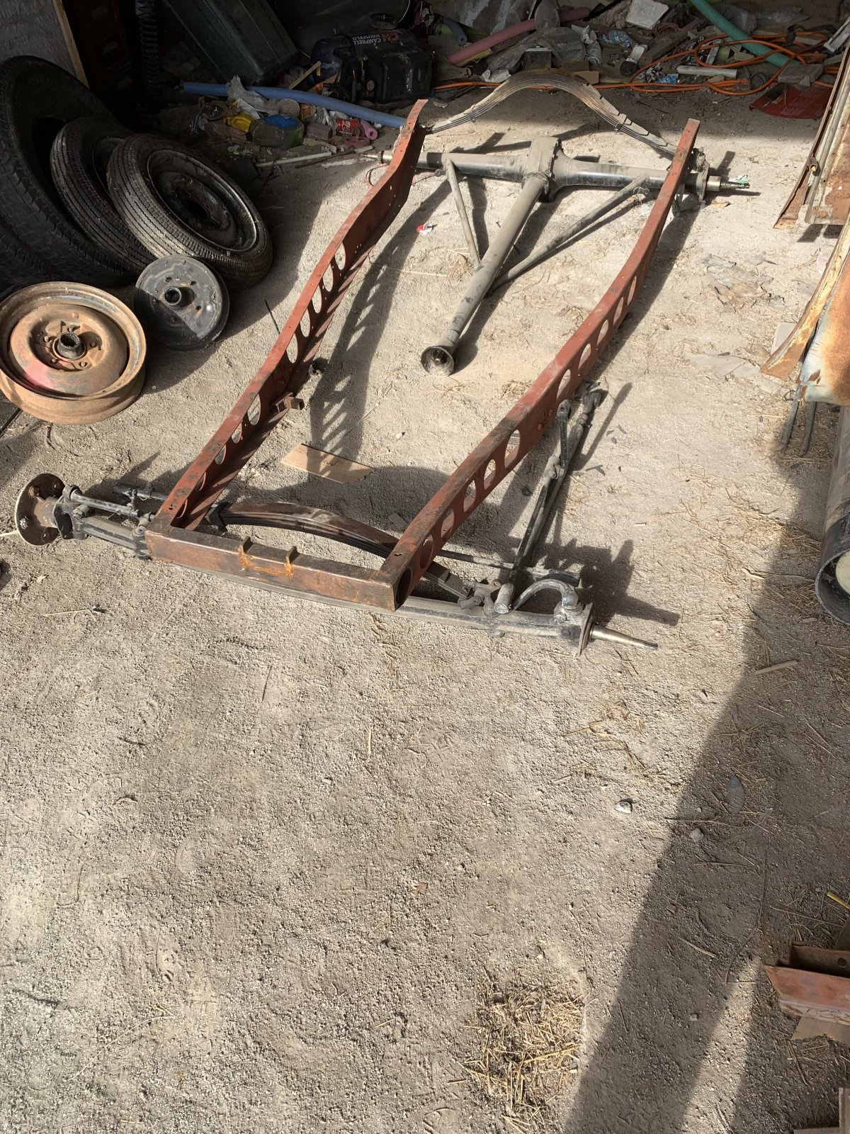

    I set about making the frame rails square and put in a model a front and rear crossmember as I'm using both an A spring on the front and rear so jus made sense for what I had. Turns out the frame rails used to belong to an local dirt tracker Bill "Smitty" Smith he bobbed the frame and drilled HUGE lighting holes the length of it many many moons ago for an old Bonneville car of some kind still trying to find the history on that.

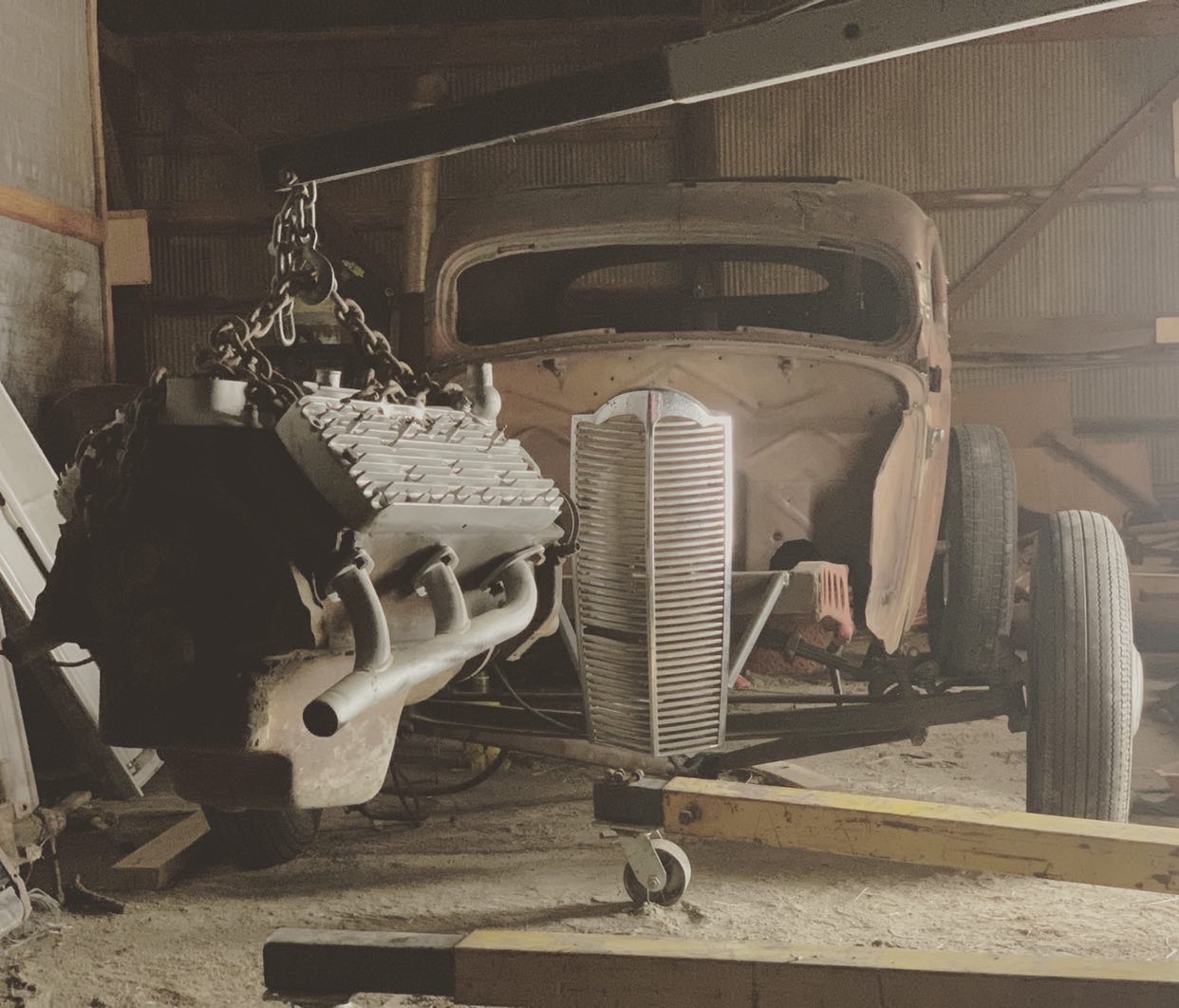

    The heart of my little speed coupe is going to be a 239 ci flatty I did some trading for equipped with a set of FENTON heads and matching Dual carb intake, and a set of 94's backed by an old ford 3 speed I believe is out of a 39 Ford.

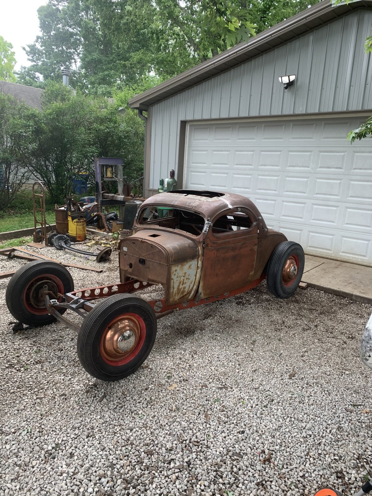

    Ive never seen a 35/36 look better with out fenders but cut them every which way and put 29/29 quarters on it and now we are talking! things are subject to change and get further finished its all a mock up now but becoming more and more a car. Pulled the engine and ****** back out today so I could begin the process of shortening my torque tube about 8 inchs or so to get the flatty where i need it. Ill update as I piddle on it im still in the midst of getting my T coupe ready for spring with its new flathead so it may be hit and miss on the posting from time to time!
