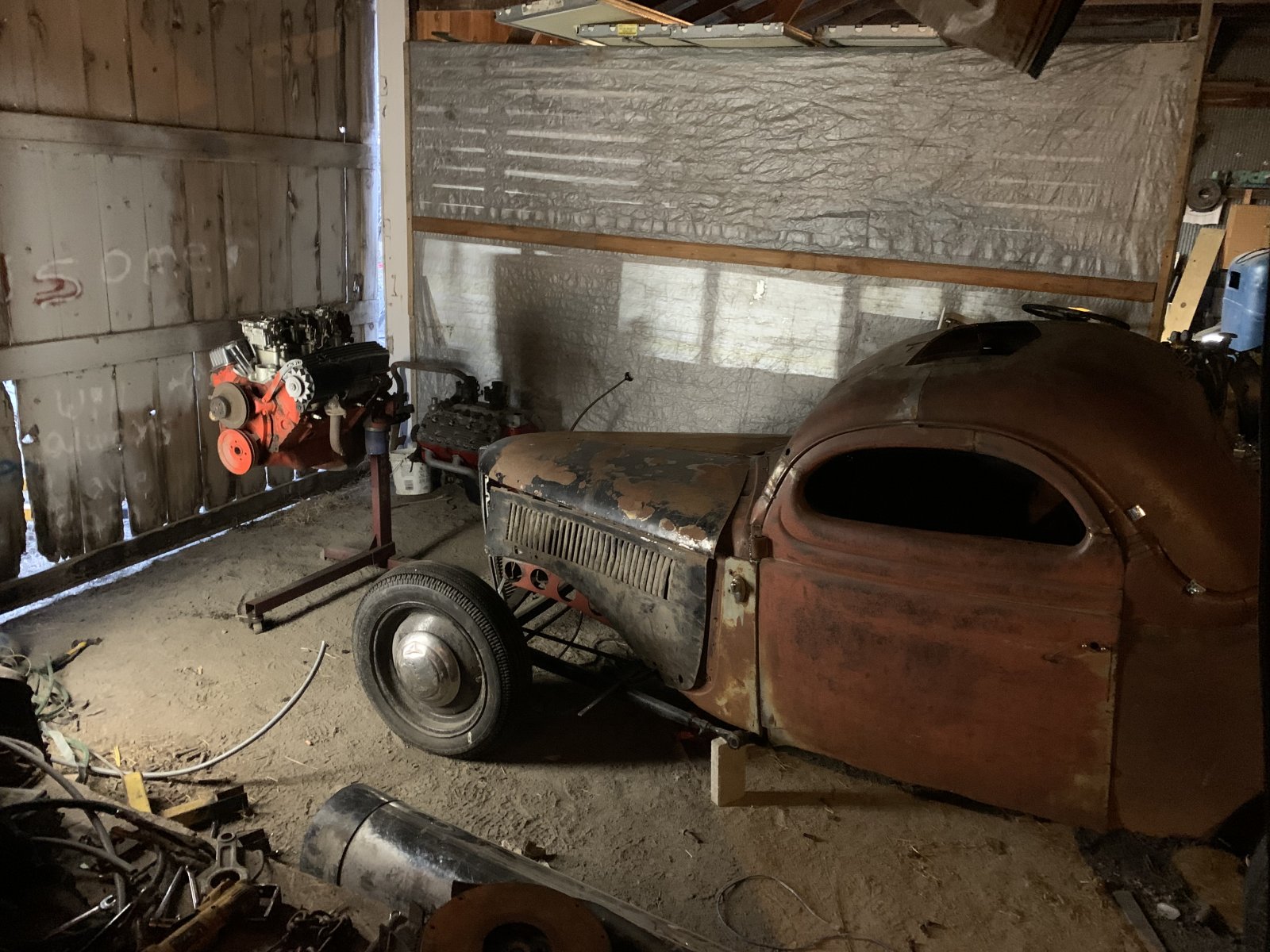

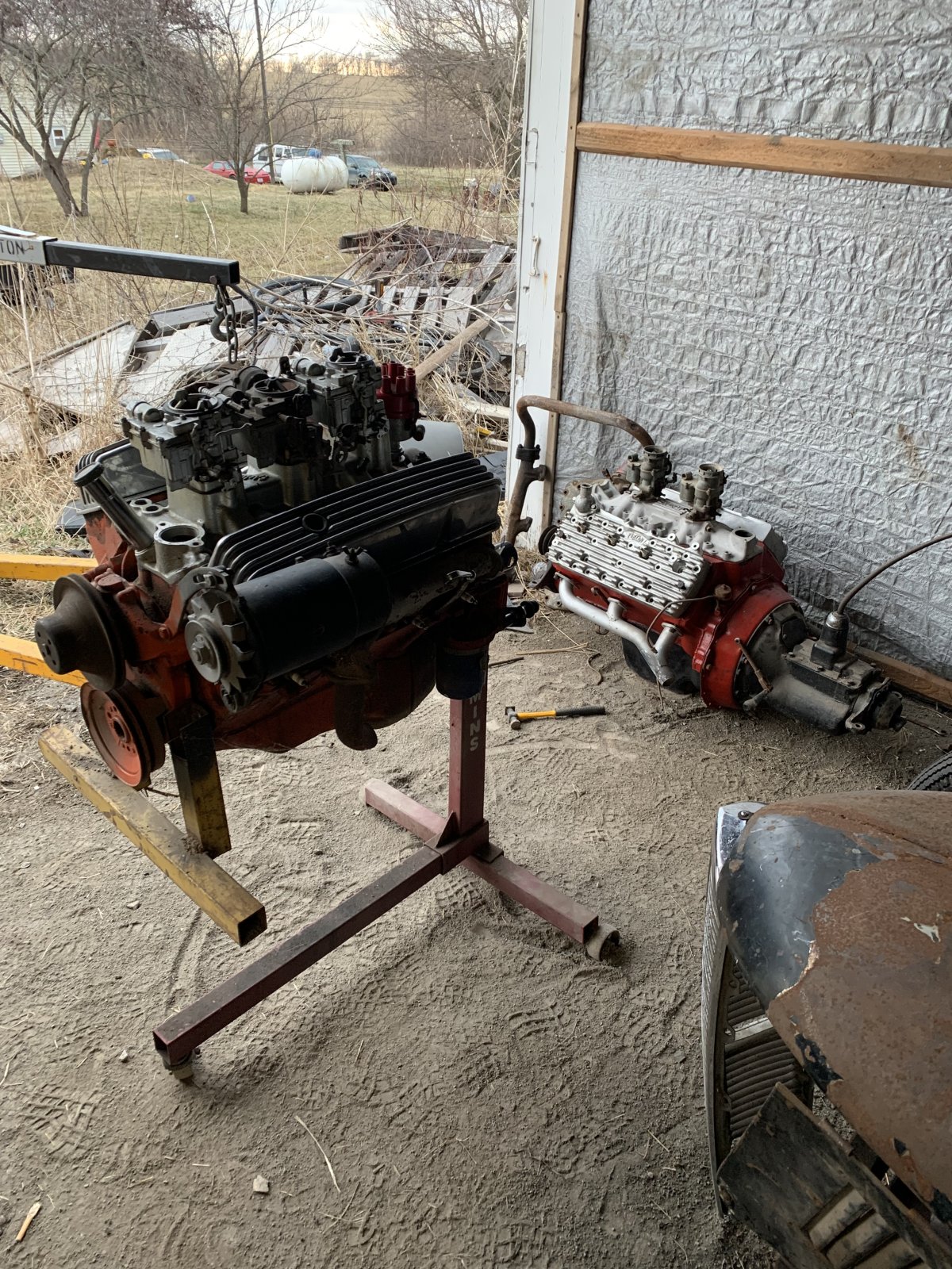

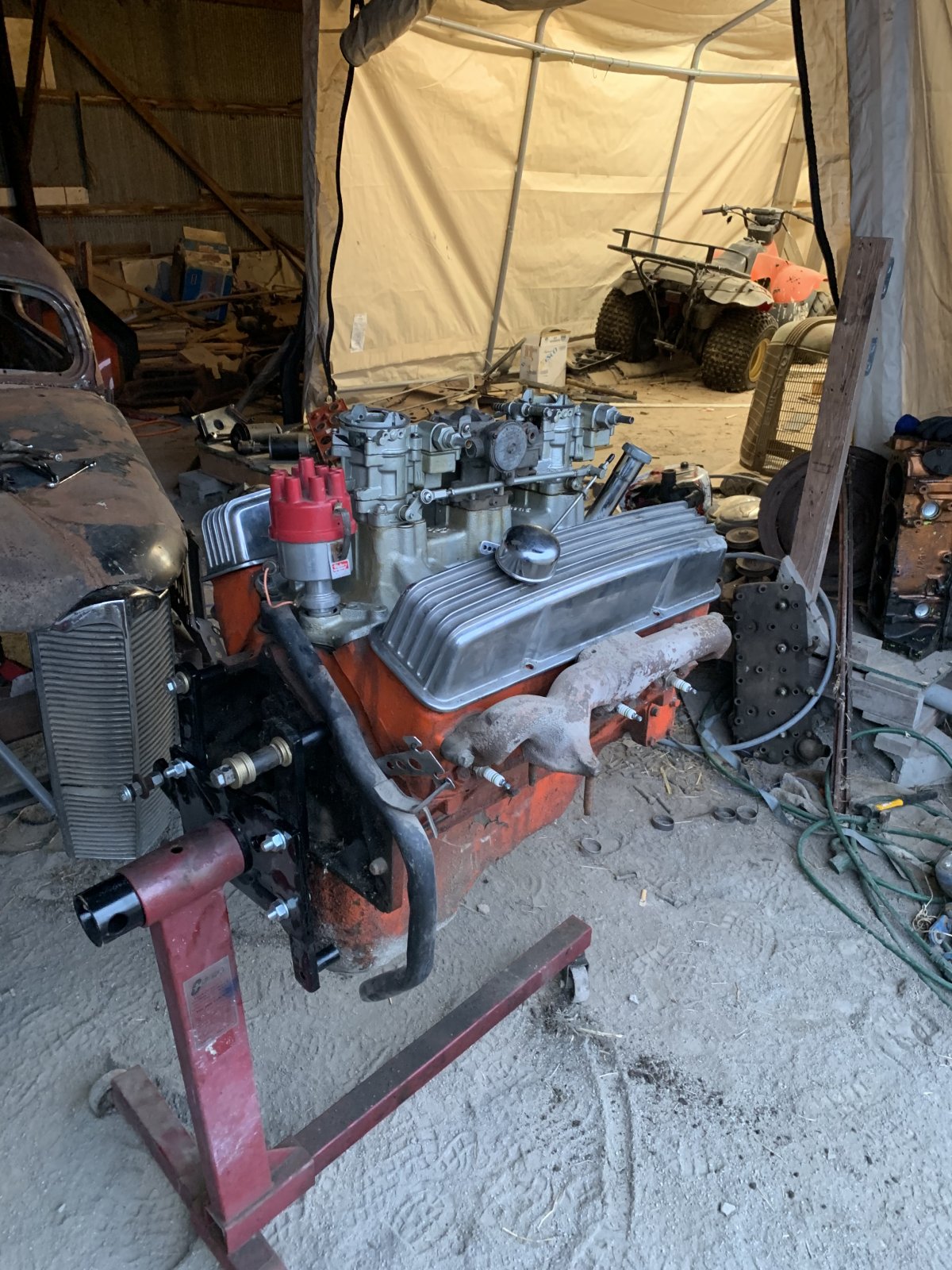

    56E6DC69-3108-4280-8182-2BC3D8FB61C7.jpeg well not much to report this week as ive been workin on my T coupe and a Joeys sweet roadster. But I did bring home something worth looking at and maybe even the Mill for this old jalopy idk time will tell as I do love my little flatheads. Its not a "belly ****on" like most. Ive drug home a running take out 265 with an eldebrock 3x2 and a neat mallory. Toying around with the idea of hopping up the 265 with some power pack heads, bigger cam, getting rid of the pulse oiling, and an open drive banjo and some kinda three pedal job to shift it.. what do you fellas think?

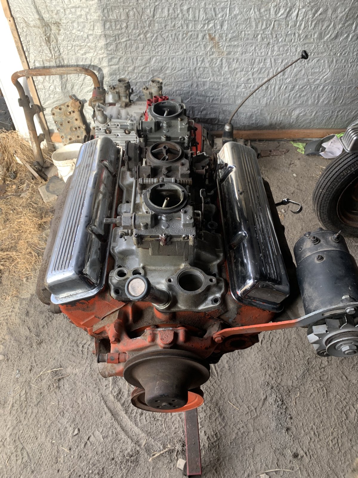

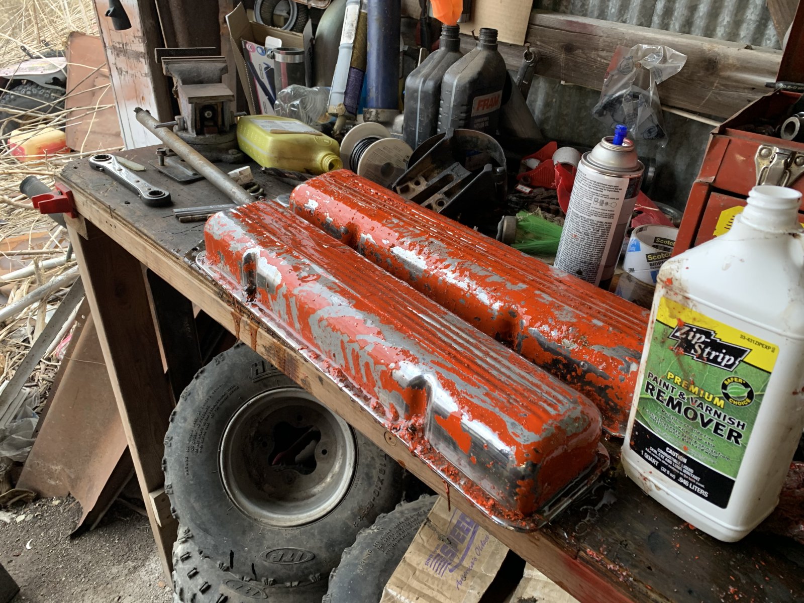

    660EAD90-2B66-4683-92CE-A211461BEAF1.jpeg Little shop clean up yesterday and stripped a ton of old orange paint off these valve covers but I see why they were painted, they have some rust and fine Brillo pad scratches it appears but they may polish up a little more,
