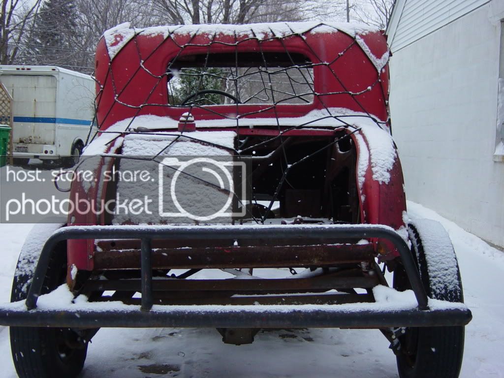

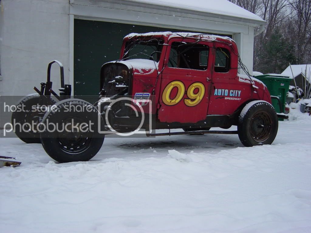

    I recently stumbled across an old 32 speedway car for sale while cruising the internet. Anyways after asking a few questions we came to a deal and i'm now the proud owner of the roughest 32 i'm yet to see lol.
    Anyways having done some research it first raised it head back here on the hamb in 2008 and has some super cool history..
    https://www.jalopyjournal.com/forum...ndow-race-car-junkyard-via-ebay-score.238230/
    I'm from the UK and with a bit of luck its leaving Chicago heading my way in a few months.
    Problem is i'm a little stuck as to what to do with it?.
    I haven't got the space or the inclination to keep it as it is and equally know its never going to be a show car without some serious investment.
    The way i see things i kind of paid for the Ch***is / ***le and running gear so the body is just a bonus.
    Going forward i think i'm going to need to fabricate as much as i can to keep costs down.
    So guy's got any tips for trying to save an old 32? 48372836_820477588300458_6078417680723869696_n.jpg 48372836_820477588300458_6078417680723869696_n.jpg 65830400_2413684538739572_2240902425093341184_n (1).jpg 65874640_2903656529773315_1545575974676987904_n.jpg 65931259_339455453622013_805944720399269888_n.jpg DEC_0296.jpg DSC00524.jpg DSC00527.jpg

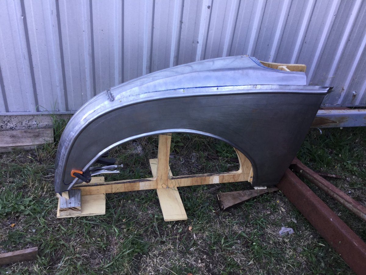

    As sad as that is, there is no need to despair, most of the important bits are still there and thankfully patch panels exist.
    If I was in your situation I would be investing in a Shrinker/Stretcher, English Wheel, Bead roller and hammer and dollies. Once you have them get onto YouTube and watch as many metal shaping videos as you can.
    I shaped this up earlier this year.

    Not too much to report, The 32 finally arrived here in the UK and iv'e spent a little time here and there where i can.
    So far i managed to chop off all the additional bumpers / Roll cadge and floor. Even managed to find the original rear frame horns which had been folded 90 degrees to attached the rear bumper.
    Managed to pull the front end and i was shocked how straight the front Axle and wishbones are. Cut the welded shut drivers door and managed to get it off the car ready to go over my buddies to hopefully be repaired along with the Deck lid. Slow progress but at least somethings finally happening to the ole' Coupe

  9. Greg Rogers
    Joined: Oct 11, 2016
    Posts: 1,043
    Greg Rogers
    That sure is neat. Auto City Speedway is still in Flint Michigan.

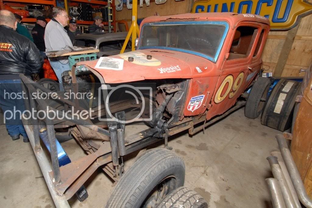

  14. jakespeed63
    Joined: May 1, 2005
    Posts: 2,867
    jakespeed63
    Looks like Don's old Jalopy. No shortage of good advise/expertise and parts, within these walls.
    Like #drylakesppedshop said, breaking it down into small bits is the key.
