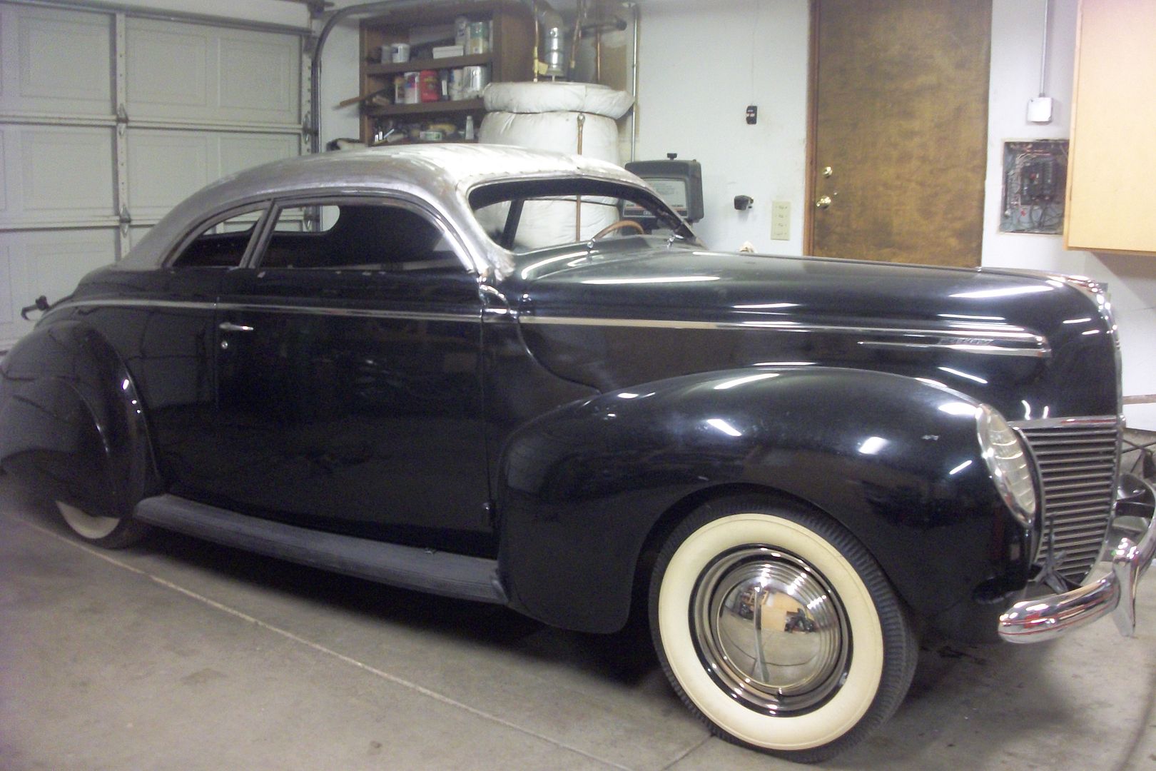

    Im starting to work on the stainless. I had to heat and reshape the quarter stainless and it's starting to look pretty good now. Still needs a lot of work but getting closer.

    Great kevan
    The angles on the side trim looks perfect :))
    Just what i have in mind
    And the chop is looking so good
    Thanks Buddy

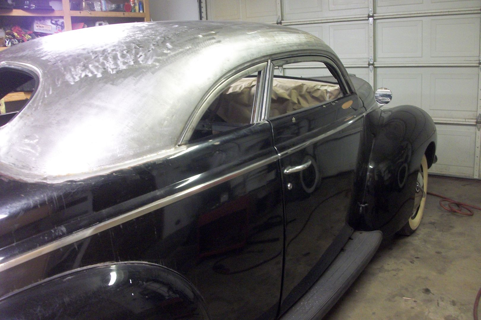

    Getting closer on the stainless. I used a piece of quarter inch plate instead of the thick stock B Pillar. The results are really nice and has clean look. When you use the stock B pillar and stainless it looks like a 4" wide post when finished.

    Holy cow, Kevan...that 1/4" plating trick is genius! Chop looks really great...beautiful shape!

    Very clever with the B pillar! Perfect solution.

    Wow man,you are a true craftsman.The chop is perfect love the slanted B-pillers.keep up the good work,enjoyed so far.

    Kev,you never end to surprize me...great trick on the B pillar...Tim will be smiling for years with this beautiful timeless custom...great vision and skills on the whole team,hat off

    That B-Pillar is really clever Kevan. The thinner pillars give the sides a completely different look.
