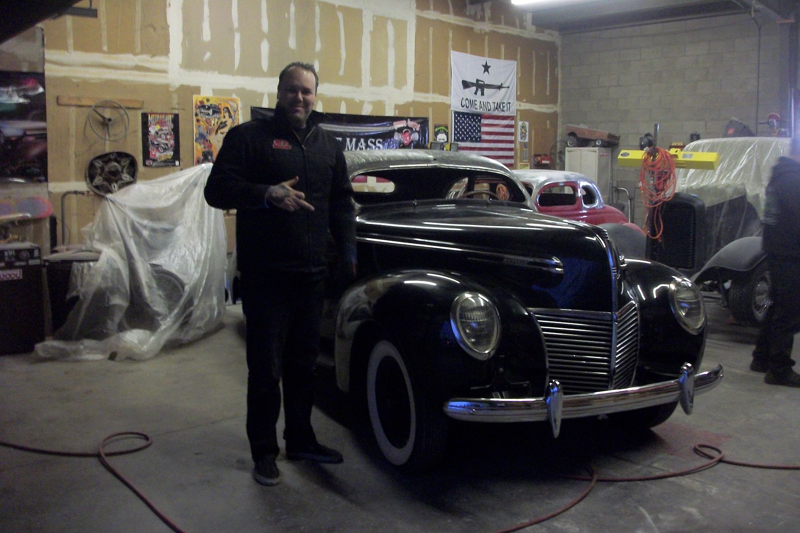

    Sorry for not posting much in the last few weeks. I've been doing some long hours trying to get the car ready for paint. All the little details seem to take forever but it was finally ready enough to go down to the paint shop today.
    loaded up and ready to take down to Adam the painter. Looks a little funny without the quarter window stainless.
    My merc is getting the boot and coming back home while Tims car gets ready for the full treatment!
    Adam (aka Suge White) ready to get to work! By the pictures you would think the car just needs the roof repainted, but it has lots of little flaws and small dings, dents, and other issues so it will be getting the full repaint.
    So we got a little over a month to get the car painted, gl*** installed, headliner redone, interior put back together, new tires mounted, chrome work done, polish all the stainless, lower the front of the car, etc, etc, etc.....:eek:
