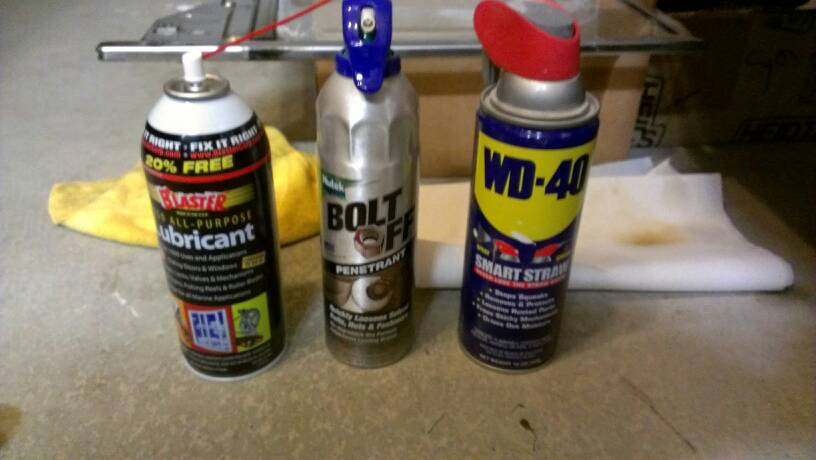

    Working on the windows. I've got some cerium oxide, and hand polished the gl***.
    The frame screws are stuck, so I threw a smattering of WD-40 on the screws. I ruined two hand screwdrivers trying to get them loose.

    Try repeatedly soaking those screws with PB Blaster.You can find it almost any parts store.Works better than Wd40 I've found.
    Where did you buy cerium oxide?

    Just last week I read on the HAMB about 50/50 mixof trans fruid and acitone, I tried it, seemed to work great so far.

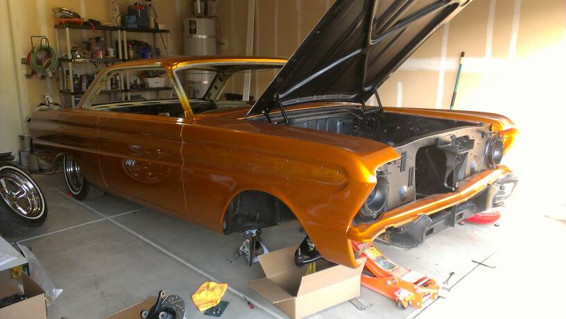

    Little by little.
    Cleaning up the front end for final ***embly. A couple cans of POR-15 Ch***is black, some vaseline to protect joints from overpay, and some elbow grease. Working on a break issue where there's virtually zero clearance between pads and the rotor.

    This can is available at yer' local GM type store:
    I'm too lazy to mix anything up...
    It's never failed me....

    I dunno' what your tryin' to do but I've had success with this, too:
    Kinda' pricey though....

    Awesome Falcon! what size wheels are they front and back? 15x?-front and 15x? reversed-back and what size are the tires?
  30. Kustom.Falcon
    Joined: Nov 1, 2010
    Posts: 502
    Kustom.Falcon
    Hey thanks! Working out some issues with my front brake setup right now.
    Front: 15x6 standard, rear: 15x7 reverse
