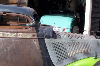

    Tony and I eventually got out to Renee' and Sam's a bit past 11a.m.. Over an hour later than we had said we would be there. Ah ha, side tracked again!
    It was good to see SpencerT's 5W body back on the ch***is. This hot rod is shaping up to look like it was built back in the day.
    Geoff aka whodaky

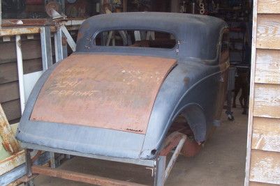

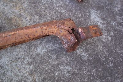

    Next I looked at what my job on the 5W would be. You see this body had spent much of it's life upside-down on the ground. Because of this the roof was pretty bad, as were the door tops.
    Sam was lucky enough to score another roof ( it had been chopped at some point ) a couple of years ago at Bendigo swap meet. But he has had no luck finding door tops. I looked at what there was of the original door tops and said I think I should have a go at making new ones.
    [​IMG][​IMG]
    So these door tops would be coming home with me. I spent the rest of my time taking measurements, as well as being entertained by Spencer T
    Geoff aka whodaky

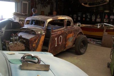

    Later in the afternoon Sam showed us what he had been doing to their spinner coupe. He has a '49 Olds grille he has been thinking of using, but he wasn't happy with how it looked. So Tony and I offered up a few new ideas on how it could be used. All of a sudden I think Sam saw it in a whole knew light. However I am not sure Renee' likes it,.... yet!!!!
    Sam has the engine out and is having it rebuilt. He has been doing a fair bit of bodywork and hopes to get it in color ( maybe not shiny) for this year's Chopped run.

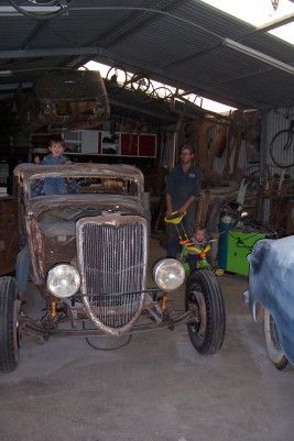

    The next day would be Sunday and I would be leaving to come home. My plan was to get away at 1p.m.
    After breakfast on Sunday Tony, Zoe (Rita and Tony's grand-daughter, who had stayed over-night), myself and Lucy went for a walk around the nearby lake.
    When we got back we rolled the 3W out of the garage to get some photos. We mocked up wheels, bonnet sides and inner guards. We just wanted to see how everything looked together.
    In person I could tell the grille shell needs to come back a bit. But seeing it then in person we are pretty pleased at how it looked overall.
    Geoff aka whodaky

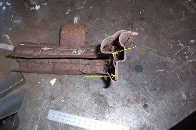

    A number of posts back when I was talking about our day at Renee' and Sam's. I mentioned that I was bringing the door tops from Spencer T's 5w home with me to make new ones.
    Well on the weekend I started on them. After much thought and looking at the originals, I came up with how I would start on these.
    I will be making each door top in 3 main sections. Each consisting of an inner and an outer.
    Below is an image showing where the sections will join approxiamately!
    Geoff aka whodaky

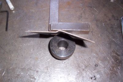

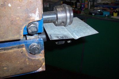

    My intial shaping was done on the bead roller.
    I actually used my biggest rolls that would form a bead. However rather than centreing the upper roll in the lower I actaully set it up off centre.
    I did this, so that I would only get a sharp press line one one side of the bead. As I would be shaping the other side of the bead in my hand folder to form the top radius on this piece I am making!
    The image below shows the profile I achieved with the rolls being offset to each other.
    Next I flattened out the slight radius on the left hand side as seen in the above image. ( whoops, I photographed that different, what was shown on the left side in the previous image, is now on the right side in the below image, but now flattened out ).
    Geoff aka whodaky

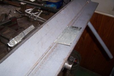

    Something I forgot to mention. Prior to doing any forming on this piece, I marked out a series of equally spaced 'bend lines', to ***ist me in maintaining a 'square piece' through this whole forming process.
    I will continue these posts tomorrow night.
    Geoff aka whodaky
