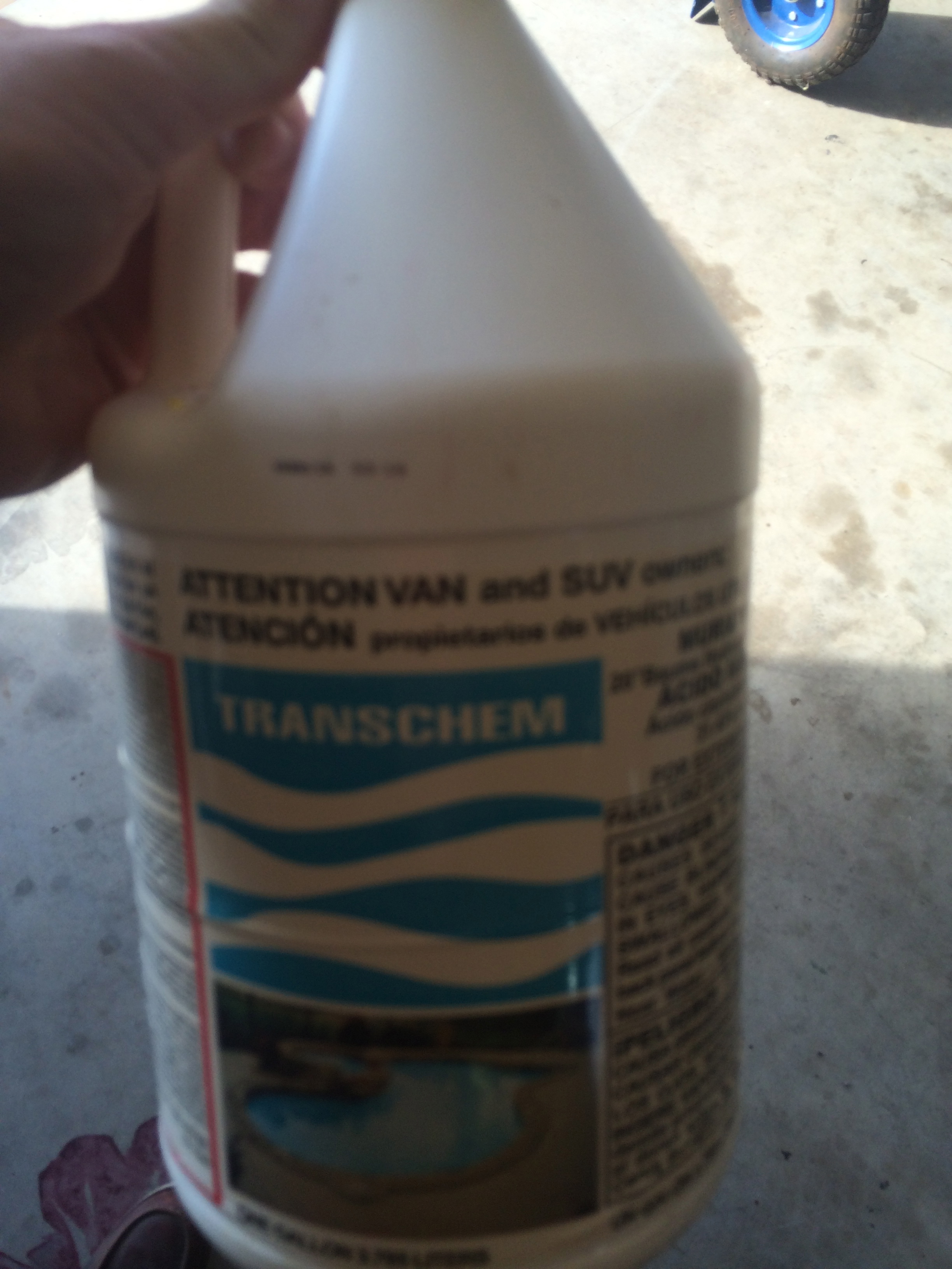

    OK, not a lot going on here, but I did get a few crucial things done that will eventually hold up progress if I didn't get them knocked out. The goal is to get the frame finished up, so that I can get the bed ready to go on. I need the floor space.
    So, I decided to address my used, but still usable gas tank. It was original to my 36 and it always plagued me through high school with fine rust clogging up the filters. I have been reading up on my internet mochine about using acid to remove the rust, so I figured I would give it a try.
    IMG_1374.jpg I bought a gallon of muriatic acid for cleaning a swimming pool. It was about $6. I made some cover plates to cover the fuel sender hole and the fuel pickup areas temporarily to enable me to roll it around and let the acid do it's magic.
    I poured all of it in the tank at once and let it soak for about an hour, rotating it ever so often.
    The thing that was common on the sites most folks were complaining about was flash rust after rinsing. So what I figured I would try would be the phosphoric acid after using the muriatic acid. The muriatic acid is much faster and more aggressive, so be careful with it. This next pic is not going to be much help, but I just wanted to show you what it took out of the tank. his was a clear liquid to start with. Don't breathe this crap. Don't get it on the concrete either.
    So, I decided to dump the contents into this bucket and then neutralize it with baking soda. I bought the giant boxes at the dollar store. Then I rinsed with water and just as I had read it flash rusted instantly. So, I used the phosphoric acid (Ospho) to convert the metal which puts a protective coating on the steel. It's a lot slower, so I just used it for a follow up.
    I think if I ever do it again, I will skip the rinse with water and just add the Ospho and use that as a rinse agent, then after the coating has taken hold, rinse that with water. It eliminates the flash rust step. I put the Ospho in for about 8 hours. I was working in the shop, so I would occasionally go out and rotate it. It came out like new and I think for about $25, it was worth saving. One thing I forgot was, that after I had rinsed the Ospho out with water, I hung it upside down for about 4 hours, letting it drain, then I put about a gallon of gas in it and sloshed it all around to kind of get a little petroleum base on it.
