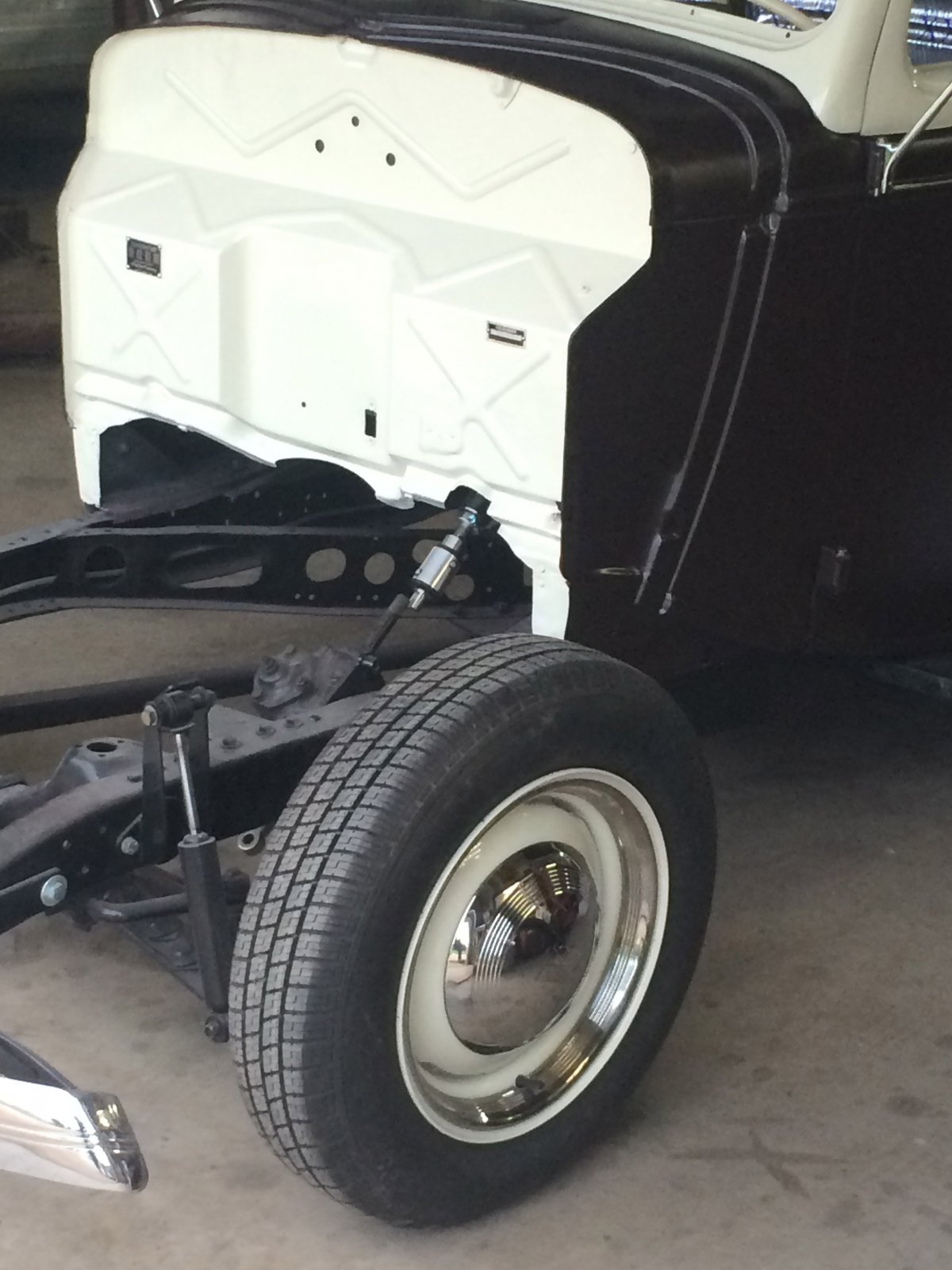

    Not a lot getting done, but I did get some new shoes for the Produce truck. I ended up putting a 1957 Ford Pass car rear end under the truck and I couldn't find any info of the tire size/wheel offset etc. I am documenting this to save some poor sucker a lot of work.
    Here are some pics and wheel/tire size references.
    I wanted to run a big tall tire on it without sticking out of the fender, so I opted for a 15" x 8" wheel with a 4" backspacing. I bought BFG 235/70-15's. Here is a pic of the spacing etc.
    I wanted to run a classic looking cap, so I have always gravitated to the 1940 Standard caps and the ribbed beauty rings. I bought repops. I can't afford the time to search out OEM caps, just to be a purist. If I lose one of these, it's $20.
    I'll post a few pics of different angles. The rear of the truck will have to come down a little. I am thinking 2" blocks should suffice. I don't want to slam it too much, because I need to have a little there when I hook the travel trailer or the race car trailer up.

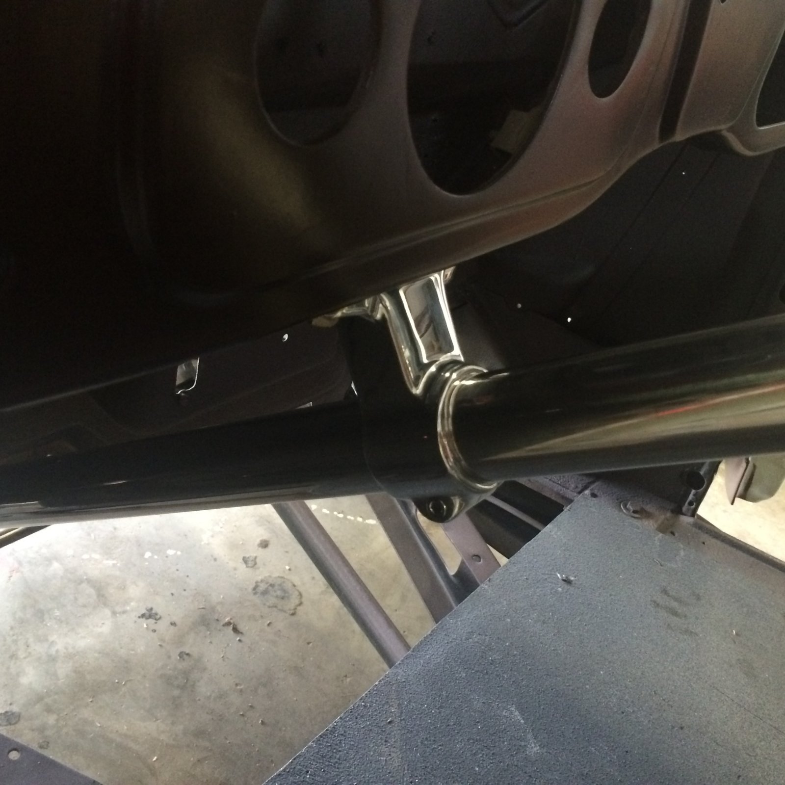

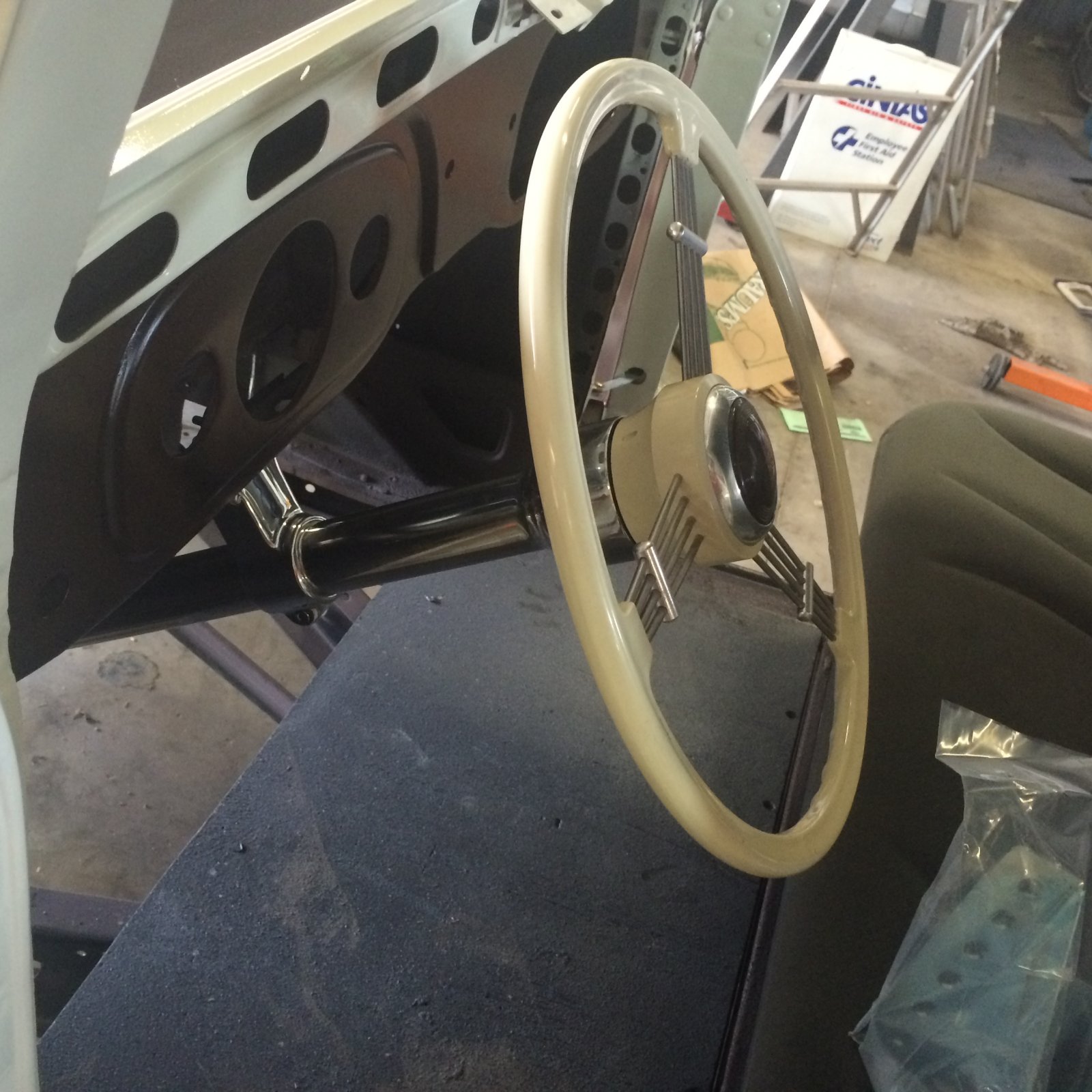

    So, for those who were worried about the blue tape holding everything together I finally got the coupling installed. It turns really smooth. I'm pretty happy with the way it all lined up. no u-joints to worry about.
    I finally put the tie rod in permanently and semi-adjusted the alignment. It's close enough for now.

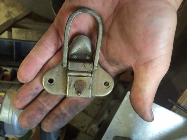

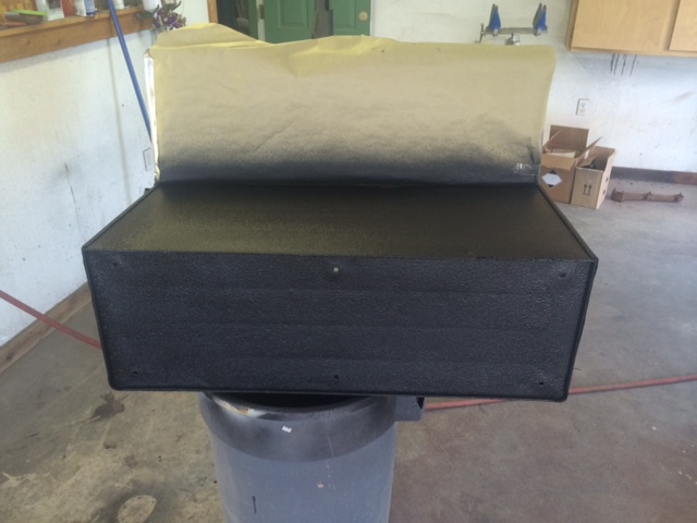

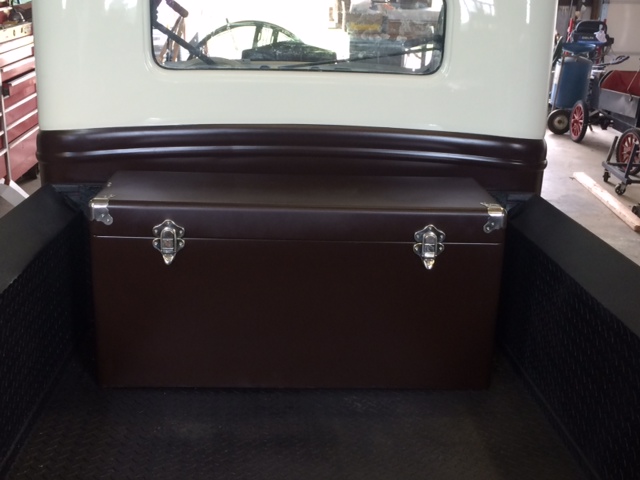

    So, the wife and I decided we needed some storage since this will be pulling our vintage travel trailer. I pondered it for a while and remembered a trunk that my grandpa gave me. It was a trunk off of an old Overland I believe that his mother used to have back in the 20's. I have been dragging this thing around for 30 years.
    The first thing I did was sandblast it and spray the inside, the back and the bottom with bed liner to weatherproof it a bit. I should be a sales rep for Raptor as much as I pimp this stuff.

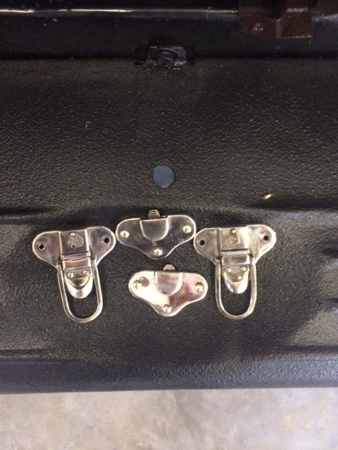

    Then I drilled off all the hardware pieces . They don't make stuff like this anymore. Quality that lasts 100 years.
    A few minutes on the buffer and it looks like new.
    I ran by the Help rack at the local parts store and bought 6 shock mount rubbers. I mounted the trunk on those and bolted it to the bed of the truck. It serves as isolators and also it raised up the trunk to allow the water not to pool against it and rust out the bottom of the trunk.
    Looks like it belongs there.

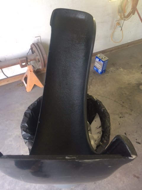

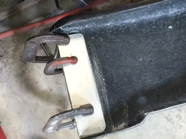

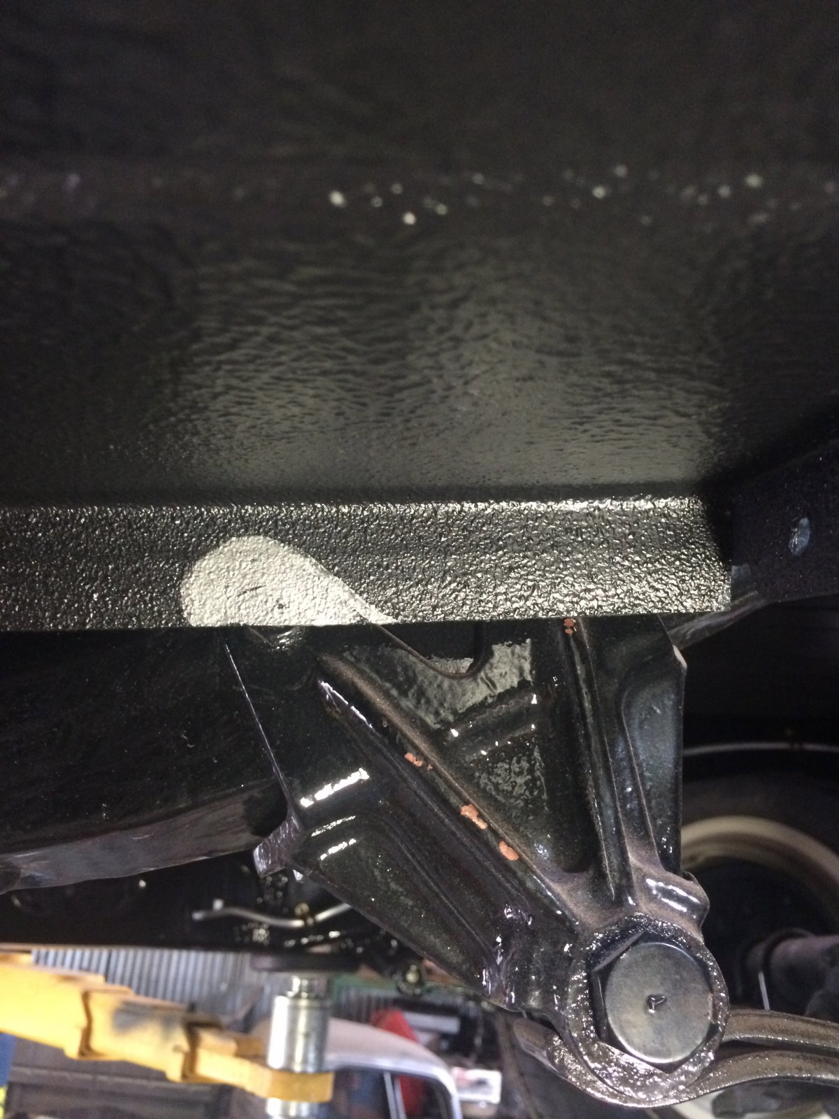

    I'm not a huge proponent of fiberglass parts, but every once in a while, I figure I got a deal. I bought a set of these fiberglass rear fenders at a swap meet for $80 pair. I decided to gamble on them. Fast forward 25 years and I actually have something to use them on. We just kinda collect 35-37 Ford pickup parts, knowing some day we will need them.
    These were kinda light weight compared to today's standards so I opted to beef up the area where they get the most abuse, the front side where they attach to the running board. So, I had some .125" aluminum and I fabricated some doublers to attach, to help beef it up someone decided to jump up on the running boards.

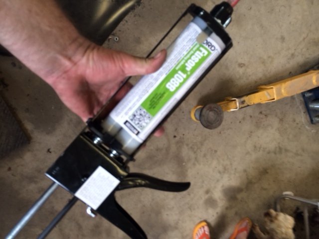

    I did some research and I settled on an epoxy resin that actually has a G rating from the DOT.
    It's called Fusor 108B. You have to buy the large gun if you get the big tubes like I got. I found one on Amazon for about $35. It mixes in the tube as it comes out. Pretty slick.
    I let it dry for a few days, even though it said it would be good in an hour. I had plenty of other stuff to do. It worked awesome. It worked so good I used it to install my newly fabricated battery box. I popped a couple of holes in it, dropped 2 bolts in to draw it up tight and it worked perfect. Water and air tight seal. battery box.jpg
    Here's a pic after the obligatory Raptor coating.
    Then I just back drilled it and installed it.
