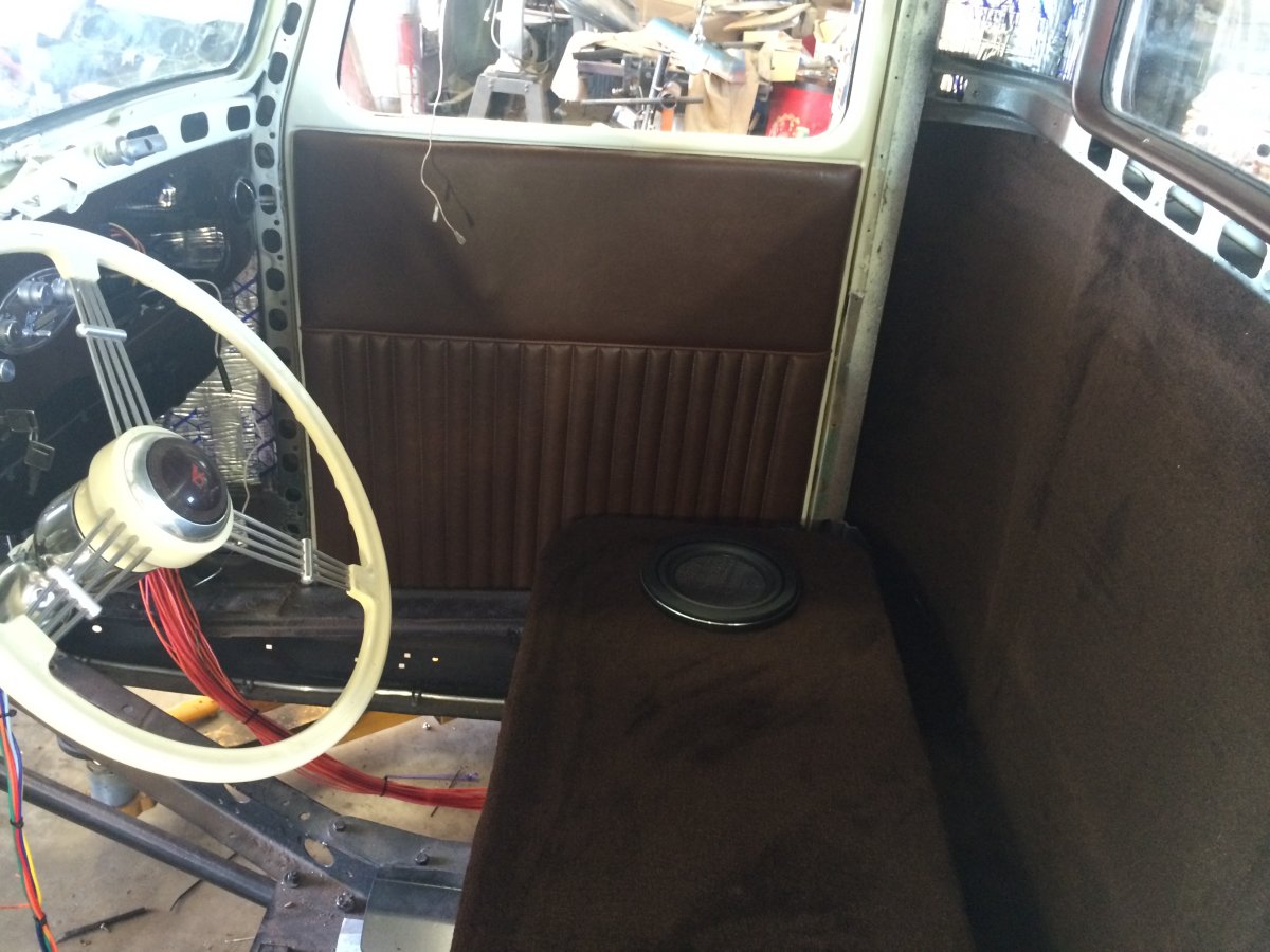

    Roothawg
    So, progress is slow. I did get one of the doors completed with regulators, new fuzzies, new glass etc. Threw some fat mat on the door for dampening and had to try out my new door panel. I covered the seat base as well. I ended up with extra carpet so I glued it to the back wall of he cab for sound deadening. Plus it kinda reminds me of the old 70's vans I grew up with.

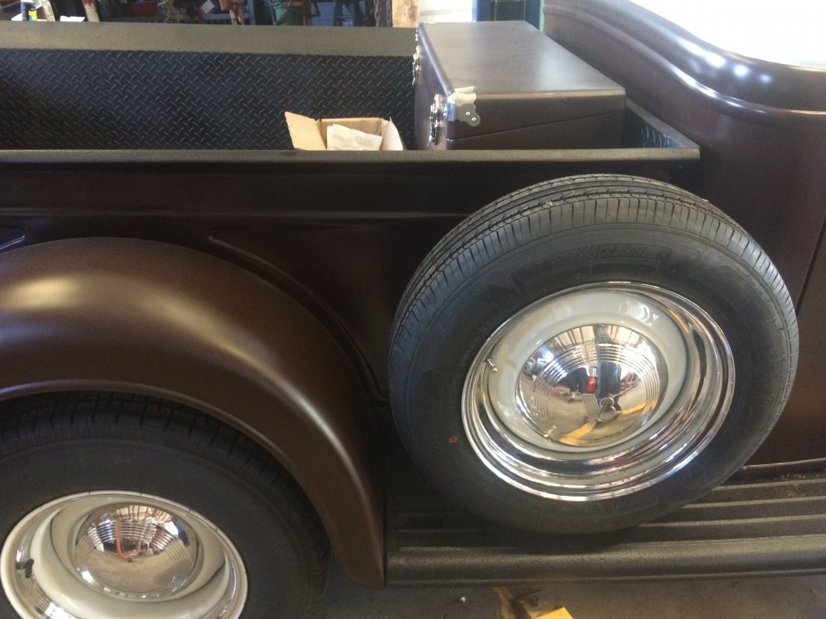

    I bought the wiring loom extension from Haywire, so that I could put the panel under the seat. It came in and we had some issues, so a tech call is in order for Monday morning. So, I had to resort to doing some of the less glamorous and more menial tasks, so I installed my spare tire carrier and spare. Big whoop, I know..........
    I did go ahead and wire up the Vintage Air AC unit. I still have a lot of wiring to accomplish, but finishing the cab interior os a priority.

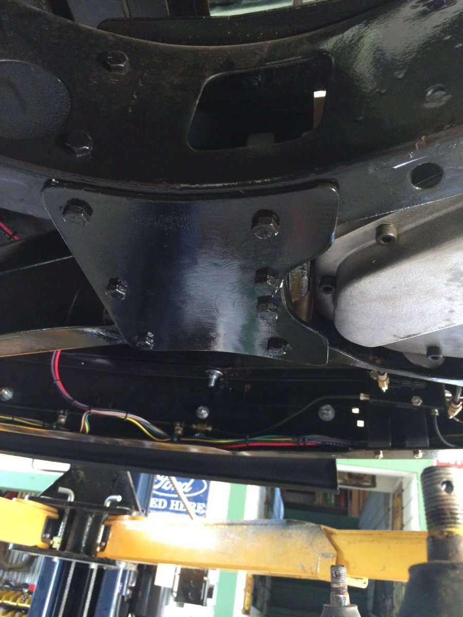

    I did finally get the motor and tranny stabbed this weekend. I'll do a little write up on the motor later. The main thing folks were curious about was the 200-4R overdrive tranny install. Well, I gt it done this weekend and it really wasn't as bad as I had expected. I did have to trim some on the lower flange of the X member and I carved up my Chassis Engineering wishbone plate pretty good, but it is still plenty sturdy.
    I had the TH350 transmission plate installed and then I changed horses in mid stream, which ended up not being that big of a deal really. I plan on driving the crap out of this pickup , so an overdrive was mandatory. The 200-4R and the TH-350 share some similarities. For instance, the footprint is pretty much the same. I was able to use an existing driveshaft that I had from a 36 p/u that had a TH350 in it.
    The transmission mount was also the same as the TH350.
    First I trimmed the lower flange to clear the oil pan.
    I trimmed about 1/3 of the Chassis Engineering plate off of the front. I ground the tranny mount plate off the CE pice to reuse on my new design.
    So, after some trial fitting, I smoothed up my hatchet cuts and threw some rattle can paint on the pieces.
    You can see the tranny mount plate after I transferred the piece.

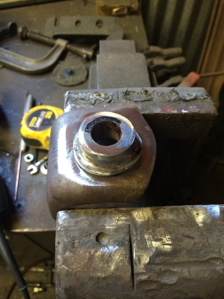

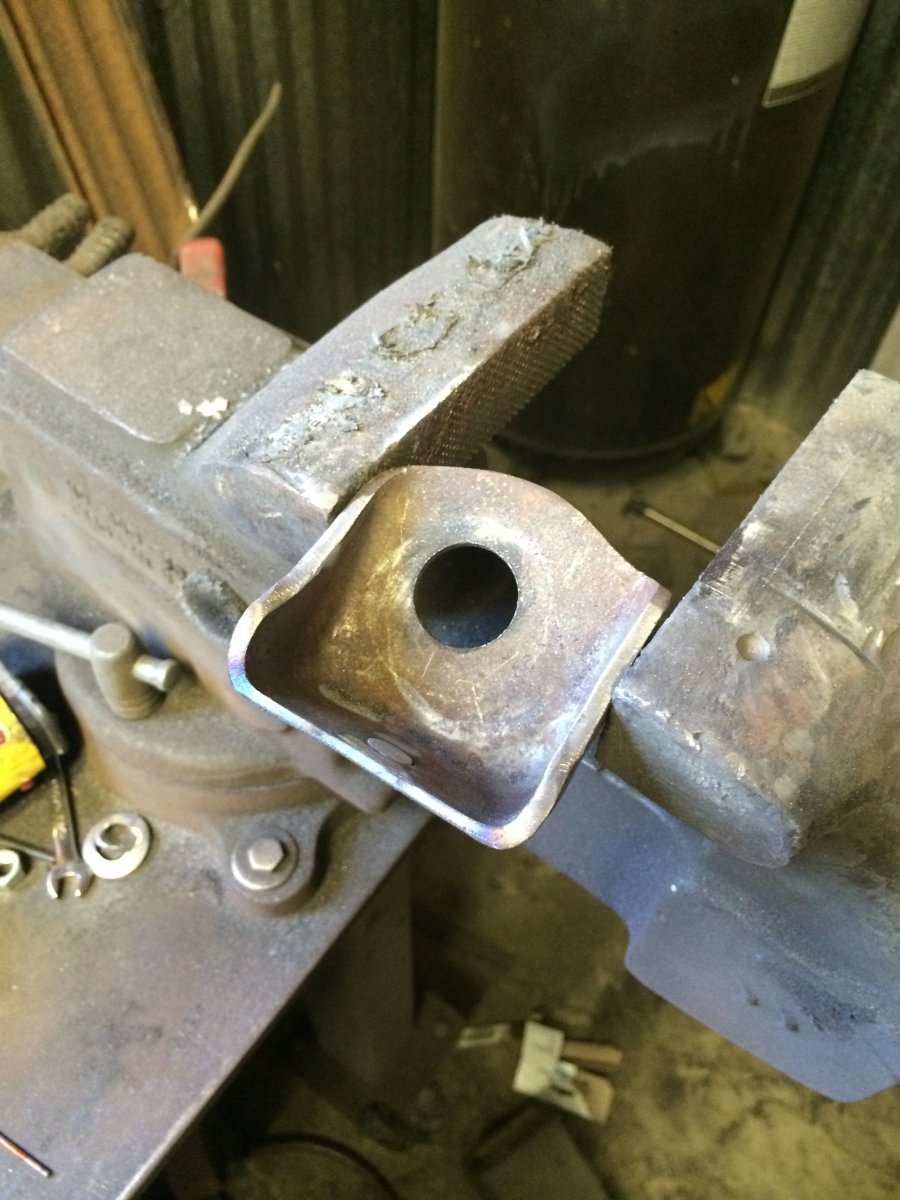

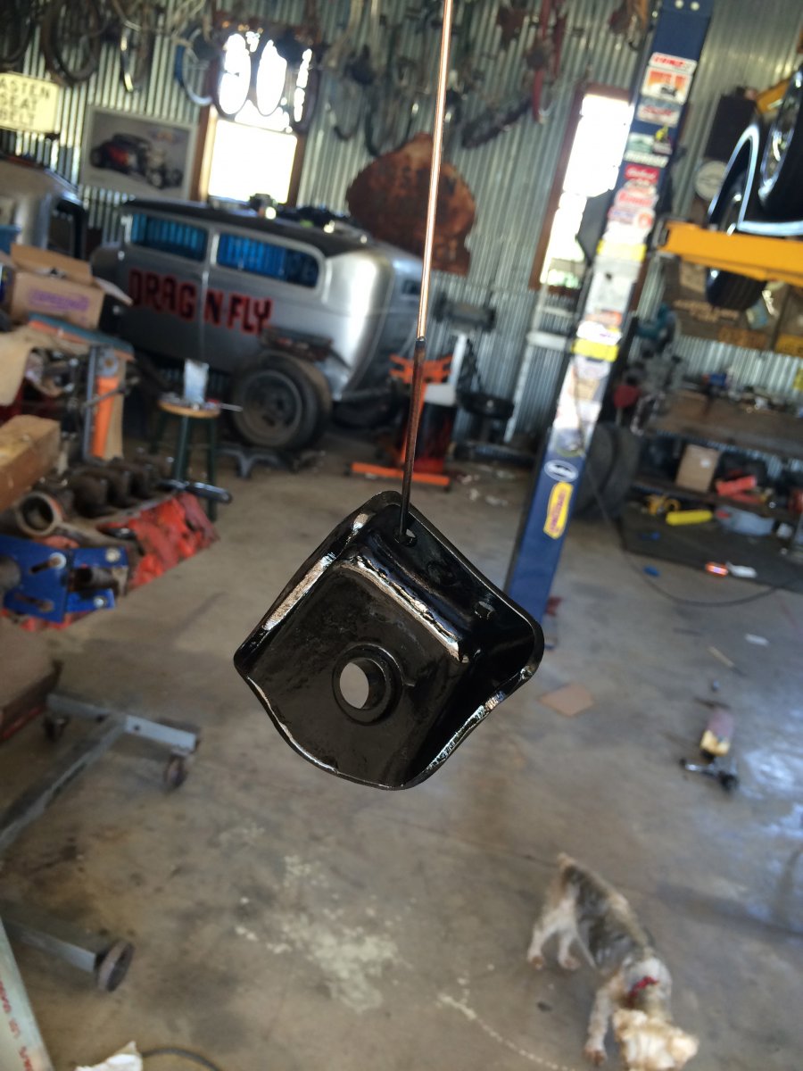

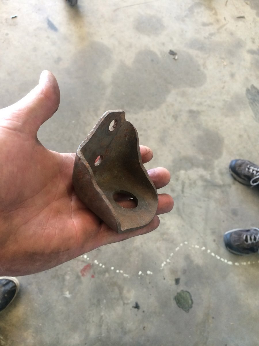

    The problem was that I lost the split wishbone mount points. I started digging around in my stash and I found an old 216 motor mount that I had been hanging on to for some unknown reason.
    I welded up the holes and trimmed a small portion off the top to square it up. I cut the tapered bung out of the old CE plate, transferred it to the bottom side of the motor mount plate. IMG_2316.jpg IMG_2317.jpg
    Popped a couple of 5/16 holes in it and mounted it. The pics are kinda hard to see. I used an existing hole in the frame for the forward mount bolt.
    I'll post a couple of pics from different angles to kinda show the mounting.
    I wanted a factory looking mount that would hold up and I think this should work out. Only time will tell.

    I'll post a few shots from the underside after it is all back together.
    The driver's side may prove to be more difficult. I have a lot less room on this side and the speedo cable or pulse adapter will have to come out through the frame. I cut a 1-3/8" hole to access it. I didn't get to finish, because I still need another motor mount to get it all done.
  27. That motor mount is pretty trick. Do you think widening the wishbone triangle will effect geometry at all?
  28. Roothawg
    Joined: Mar 14, 2001
    Posts: 25,794
    Roothawg
    Nah, it's only about 2" wider than previously.
