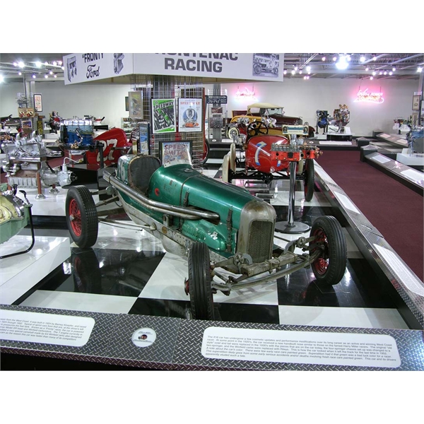

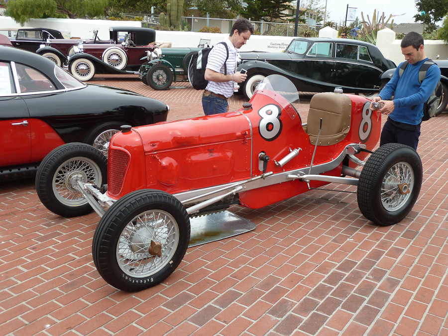

    Here are a few examples of what I am aiming for with this build. image.jpeg image.jpeg image.png
    Hopefully less crashy than this one!

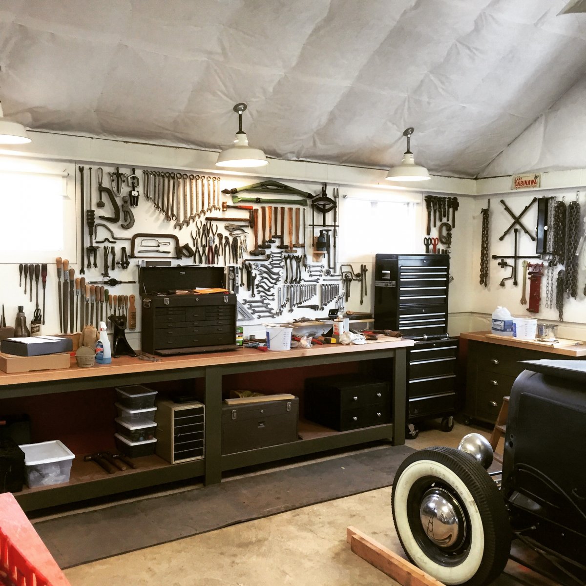

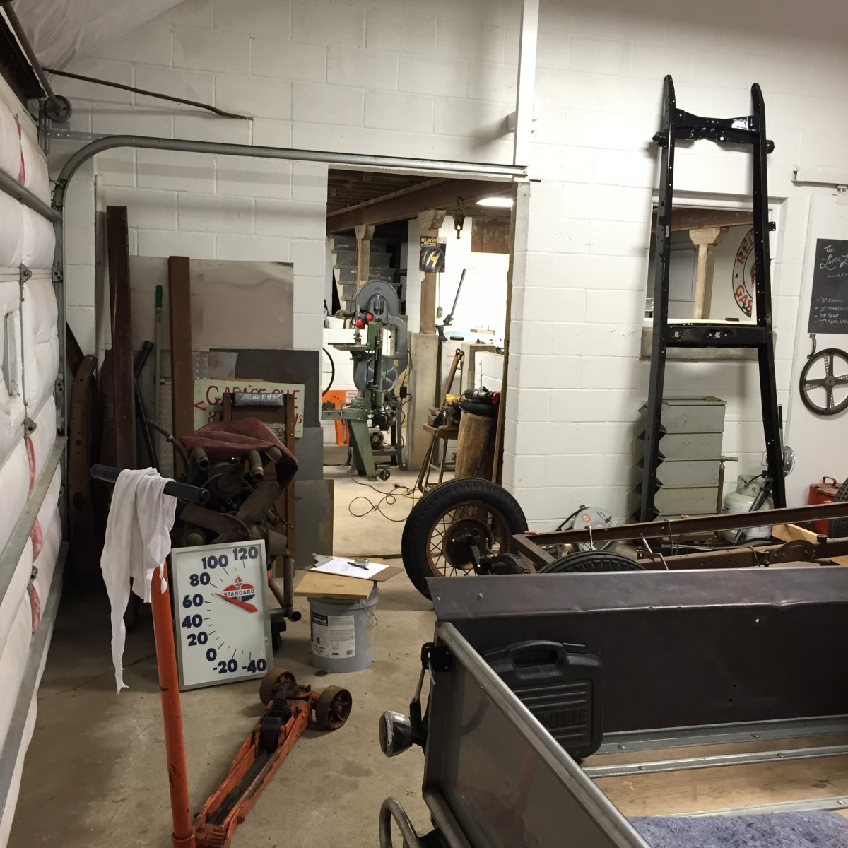

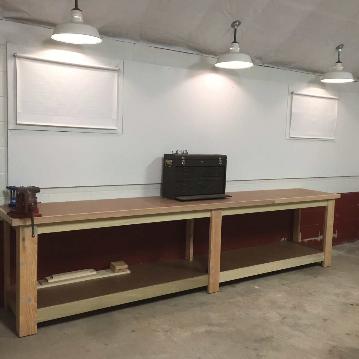

    Thank you. I only just started getting the shop together last winter but it has come pretty far. Electricity is limited out there at this point to one plug (120v) downstairs and one up. I really miss my TIG and will have to think about getting that going before I start on the body. Right now I am welding everything with my little 120V wire welder with flux core wire :oops::eek:. It actually kind of suits the build as it resembles stick welds. I did manage to get most of my salvaged lighting up and the place painted. Also some benches and the tool wall which I love! I also insulated the ceilings and put up house wrap to brighten things up a bit.

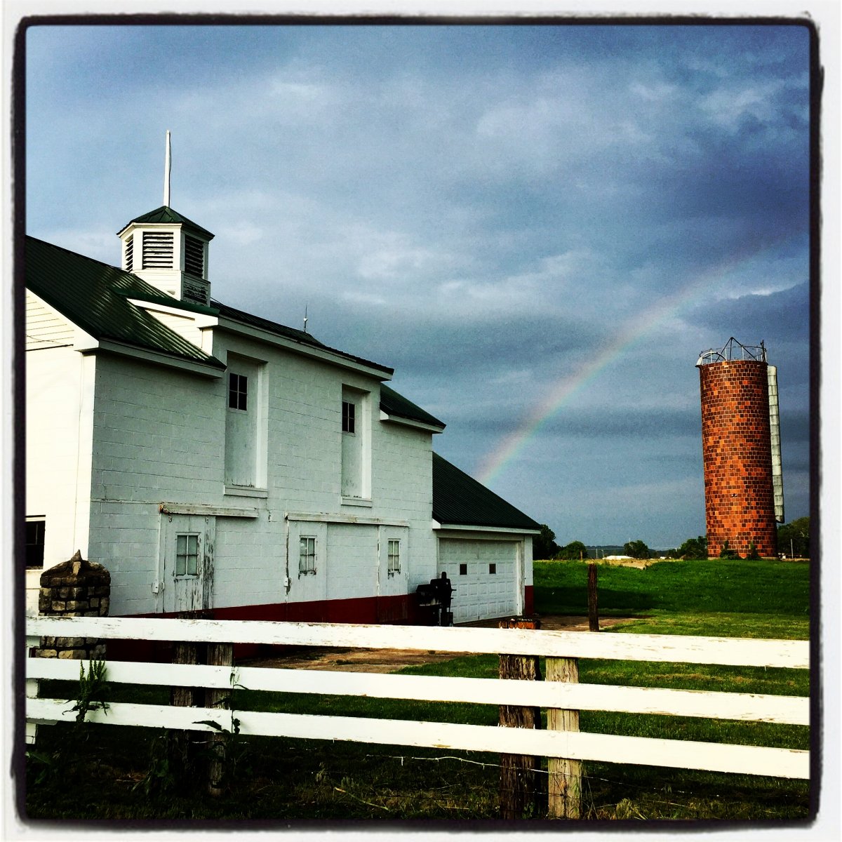

    image.jpeg image.jpeg So this is in the two car garage portion of our dairy barn on the far right end. It was built in 1946. image.jpeg
    This is looking from the garage end to the other side where I have a welding area and other areas set up in the stalls. image.jpeg

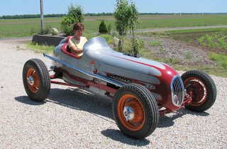

  16. Tim
    Joined: Mar 2, 2001
    Posts: 20,174
    Tim
    from KCMO
    The belly pan really helps nail the proportions on that single seater! Very cool
  17. Wow that is fantastic! Did you retain the closed driveline? I was planning on heading in that direction as what few examples I've been able to find pictures of from the period still had TT's. If you happen to find those ch***is pics I'd love love love to see them! I'm kind of just flying by the seat of my pants here, ha!
    I agree! Some form of belly pan is a must for mine for sure!

  22. clem
    Joined: Dec 20, 2006
    Posts: 4,672
    clem
    Especially when you consider the camera technology of the day. Probably explains why the dust is in focus and not much else.

  24. Thanks for checking in John!
    Thanks Leo!
    I found that pic on eBay and it is hanging in the shop as inspiration. It is so good!

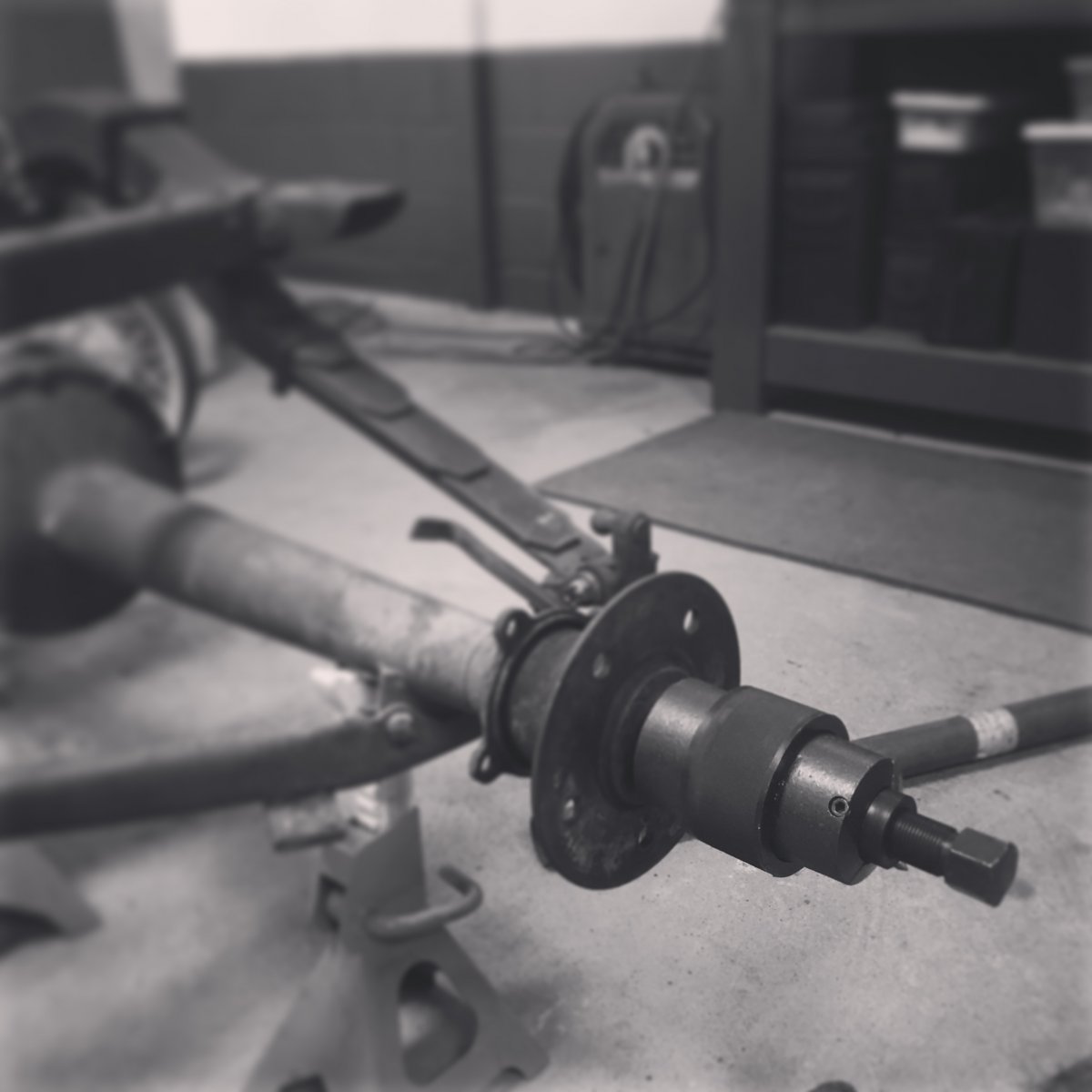

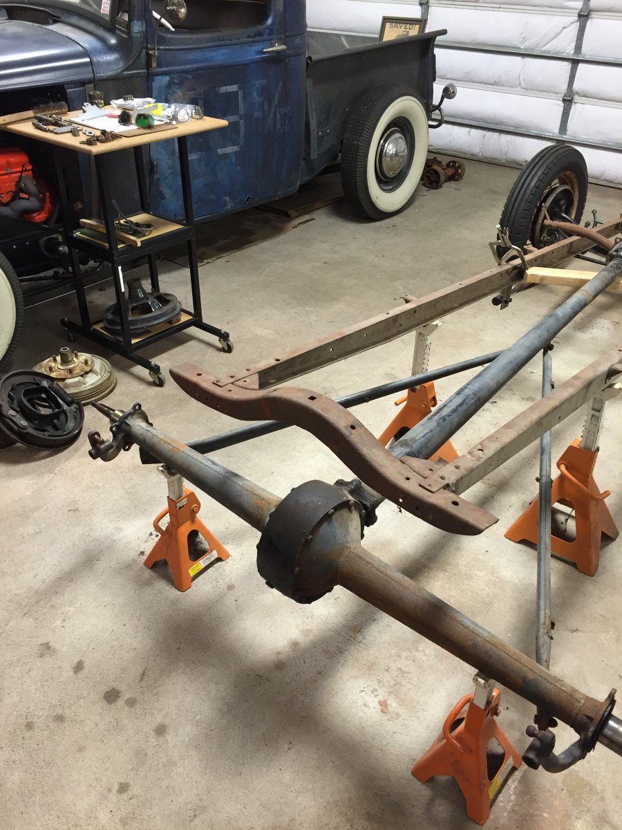

  25. I had a spare '34 rear that I got with the front axle when I bought it so decided to put it to use. I heated and straightened out the hangers since I am using a T rear spring. I started pulling the hubs since I want mechanical brakes (it had a juice conversion from who knows how long ago.) Well, my plans were foiled when one of the hubs refused to budge! Two different pullers, heat, 10 pound hammer, no avail. The key was twisted and spun and evidently welded to the axle taper...poop. image.jpeg

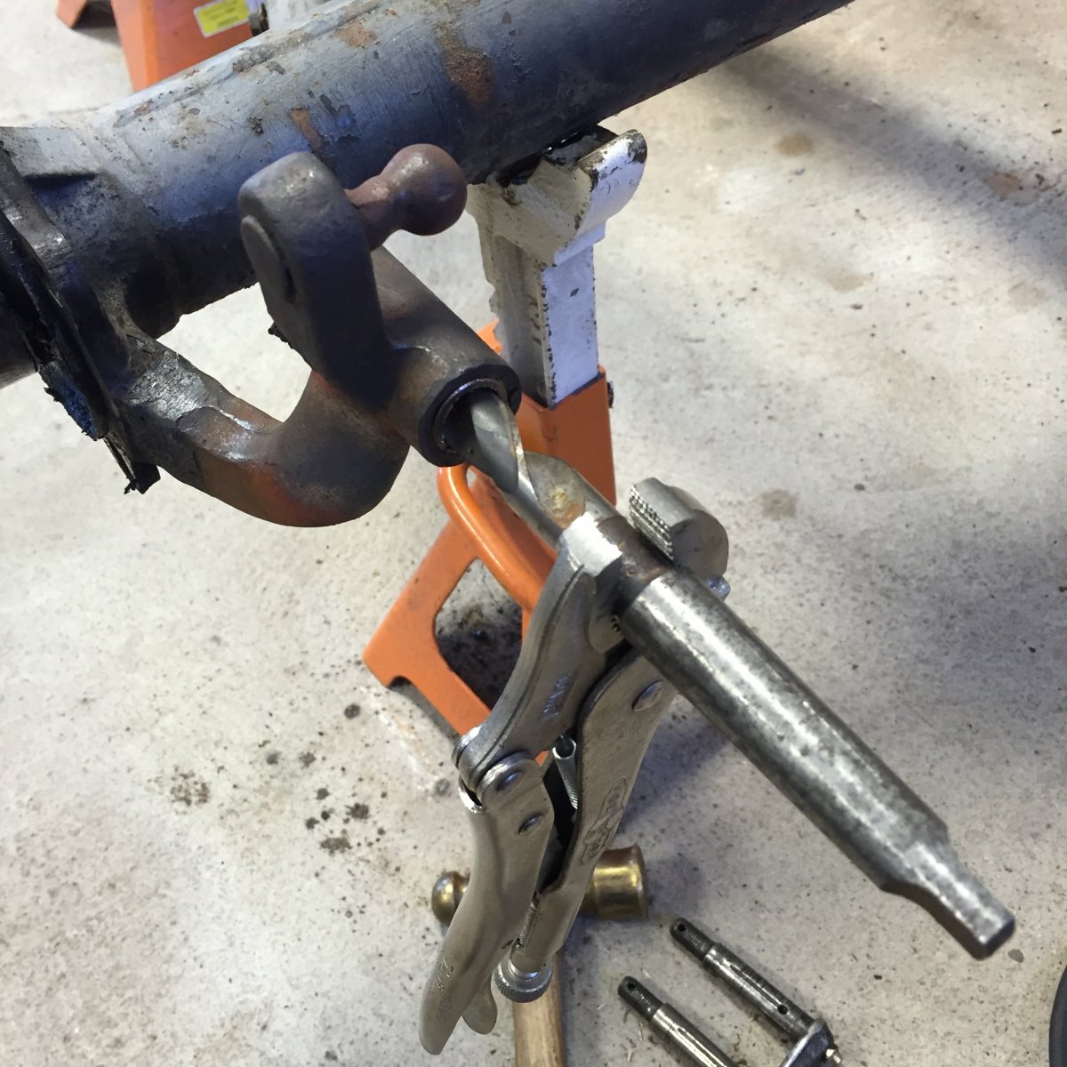

    Fortunately I had another complete rear to use so I repeated the spring hanger heating operation and put some new oilite bearings in place. image.jpeg

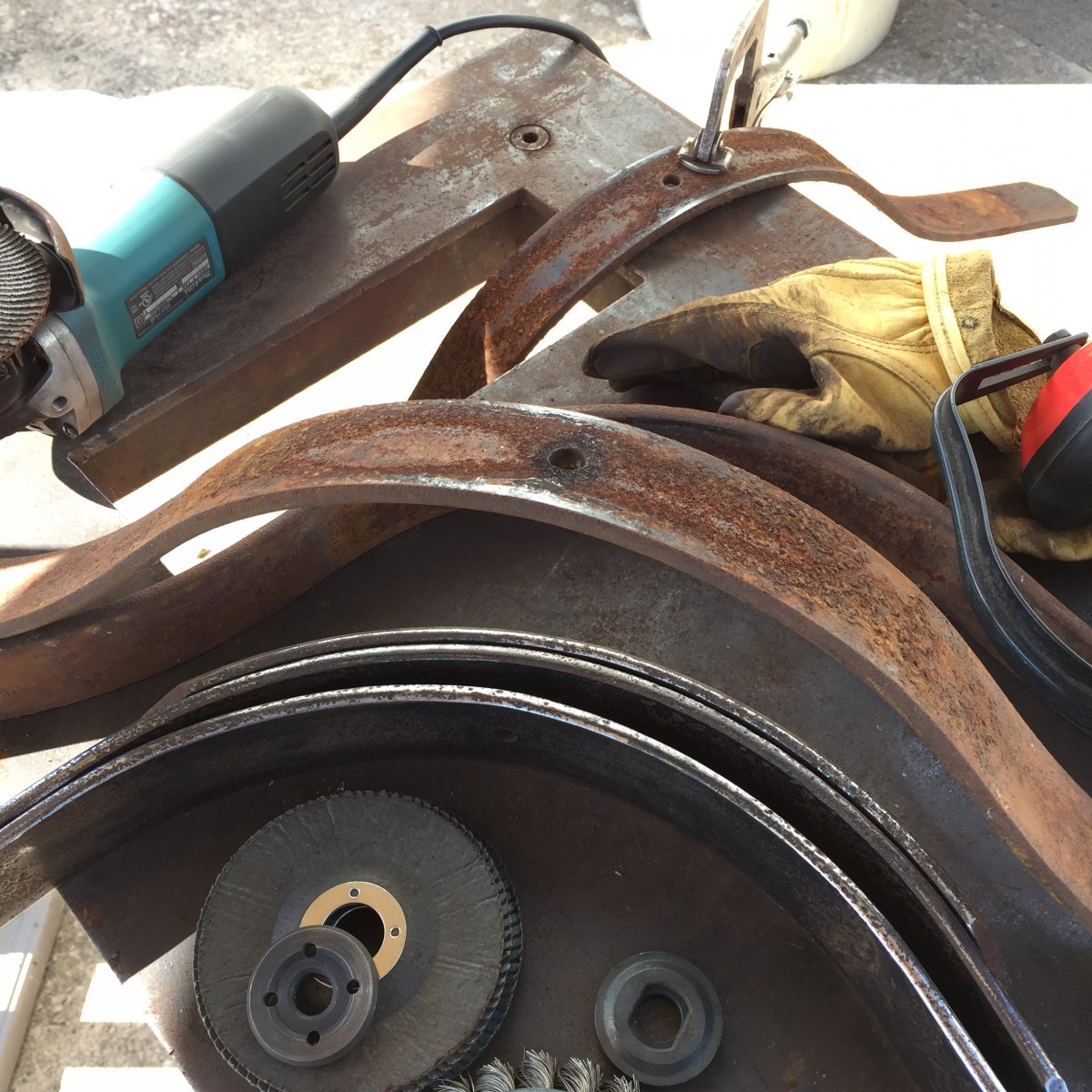

  29. I cleaned up my T spring, removed a couple of leaves and set it on the ground. image.jpeg image.jpeg

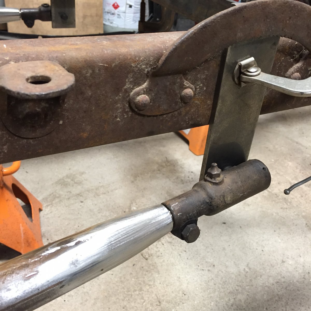

    I then turned my attention back to the front and decided to use some of the wishbone bungs that Cory Taulbert @CTaulbert offers. They are a super nice product! I had some 1/4" cold rolled steel left over from another project and made some brackets to roughly locate the front end at this point.
