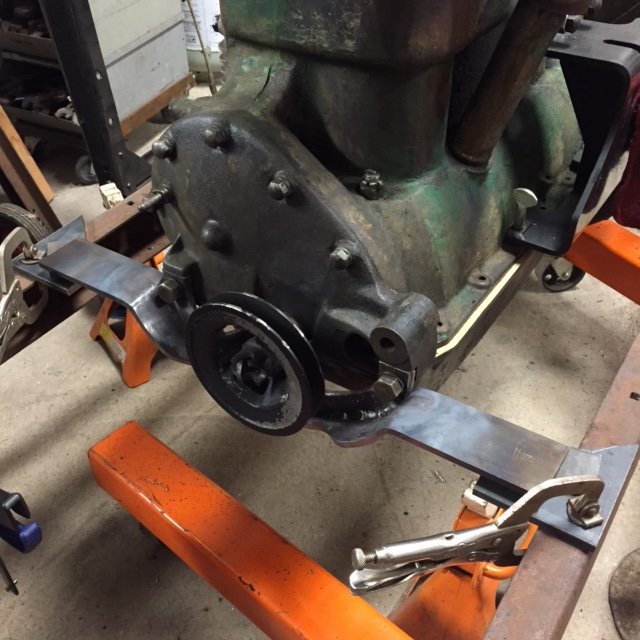

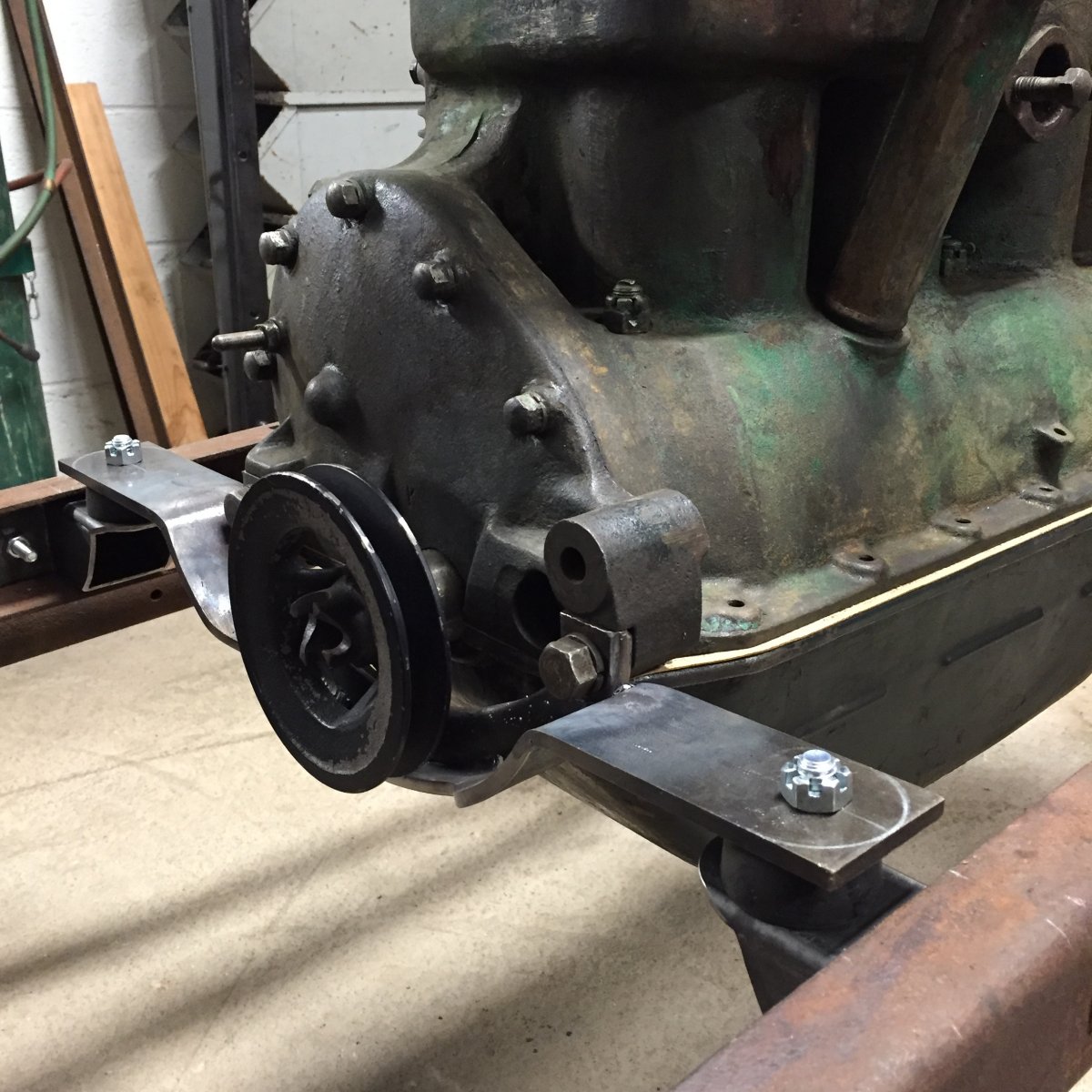

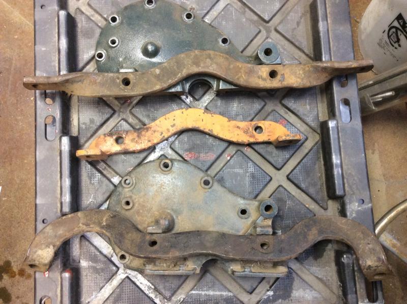

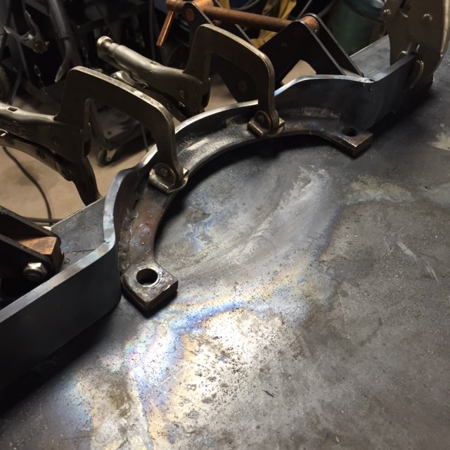

    Instead of making a new front motor mount why not use a Model B. You have three different ones to choose from and can use the V8 rubber donuts.

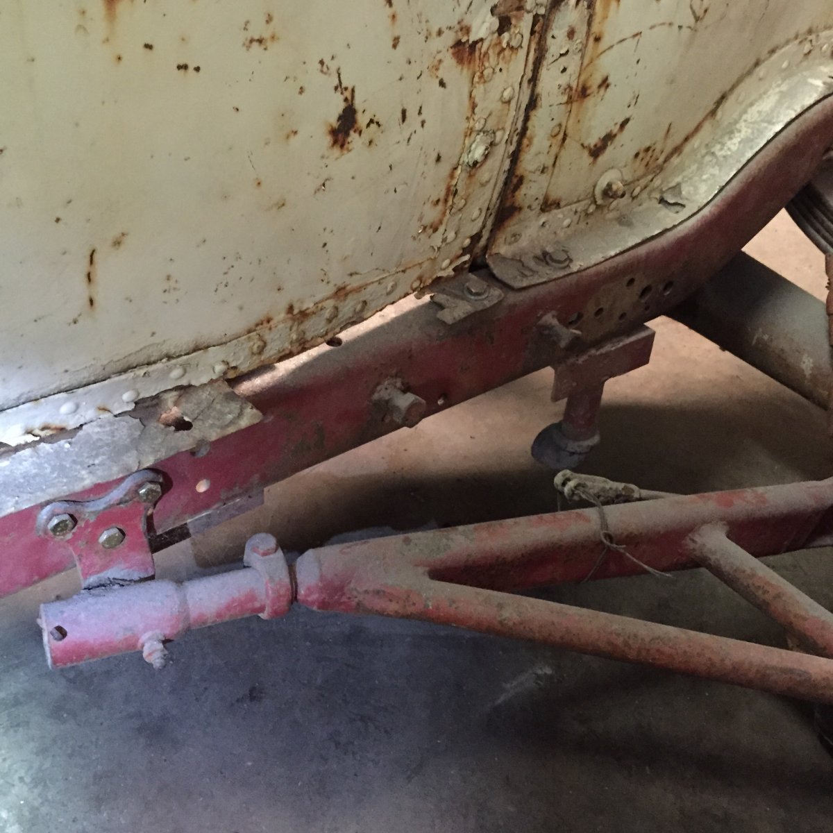

  10. I wanted one but couldn't find one before I started making mine...
    ClarkH, gwhite, kidcampbell71 and 2 others like this.

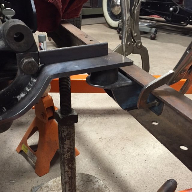

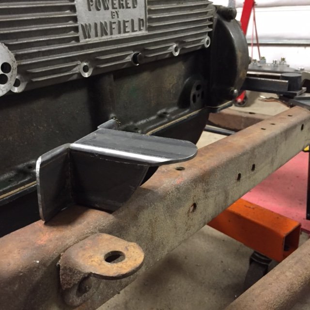

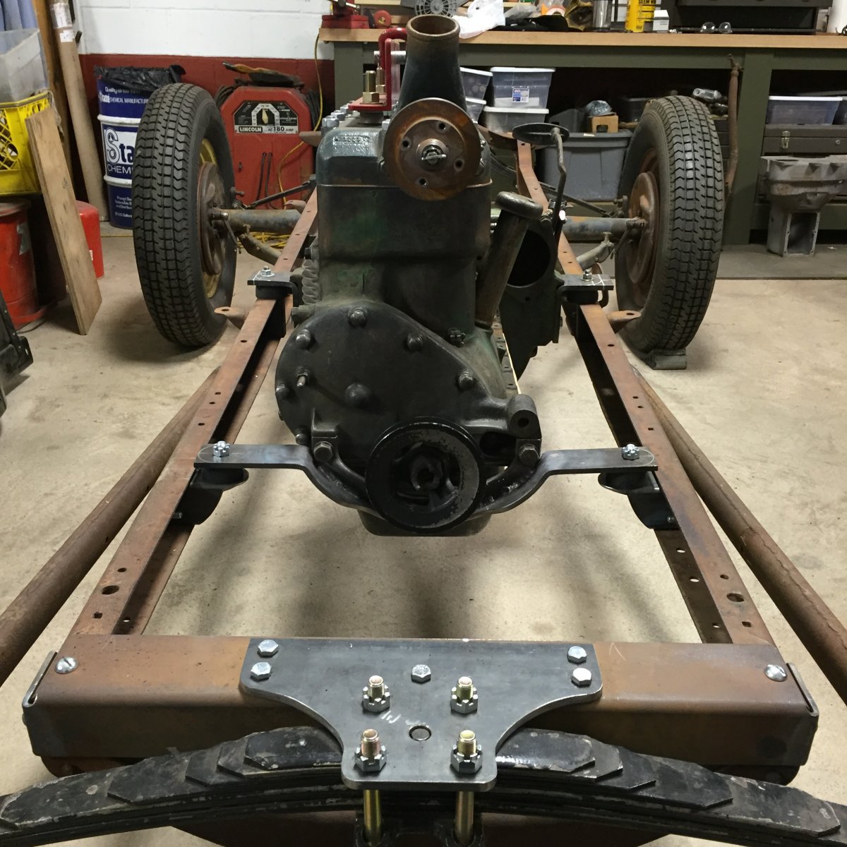

  11. Then I made these to bolt to the frame. I wanted them to resemble the body mounts as I like their shape.
    More rubber "stoppers."
    brEad, ClarkH, kiwijeff and 5 others like this.

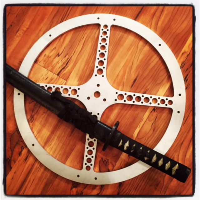

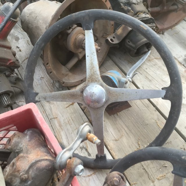

  15. A thread popped up today that reminded me of a couple pics I forgot to share. I was fortunate enough to get one of Kevin Lee's steering wheels to use for this project. The only problem is that it is way too nice for the first iteration of the racer. He has given me his blessing to scrud it up but I'm not sure I can do it just yet!
    While perusing the swap meet this spring I spotted this Bell(?) 17" wheel and snapped it up.
    I cleaned it up a little and I will probably wrap it with friction tape to use for the "as found" version of the car.
    It will get connected to a Model A box that will be set up for center steer kinda like this mess on my buddy's old track T.
    brEad, Stogy, bct and 3 others like this.

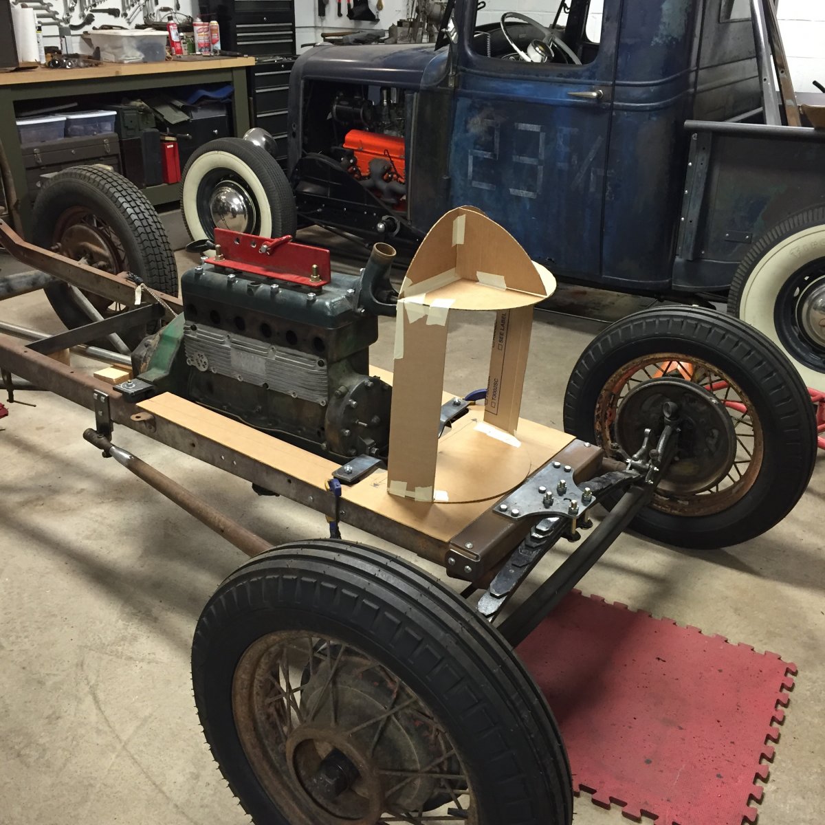

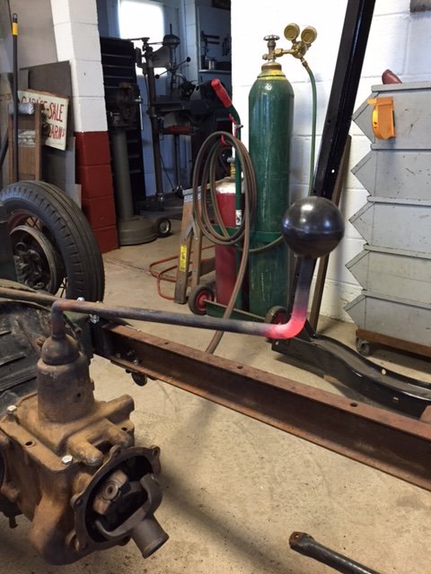

  16. Here it is drilled and bolted up. I will be gusseting it either top or bottom (haven't decided which yet?)
    Here's a mockup of a proposed grille shape. I've also toyed with the idea of modifying a '32 shell.

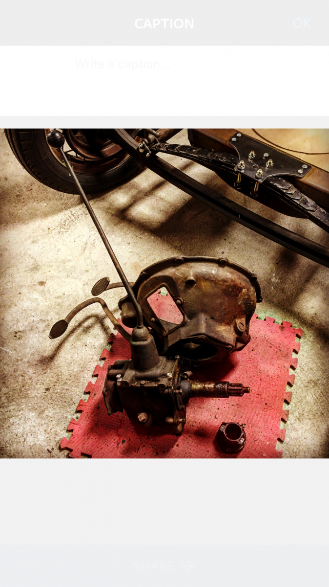

    Then it was onto the transmission. I had this one attached to another engine that is destined for the T roadster I spoke of earlier. I have a 'B' trans that I'll use for that one and put later gears in it.
    brEad, gwhite, whtbaron and 5 others like this.

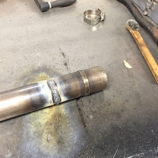

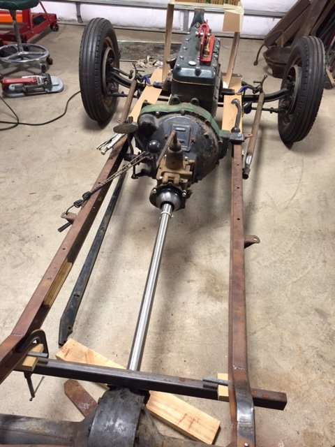

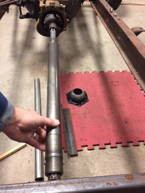

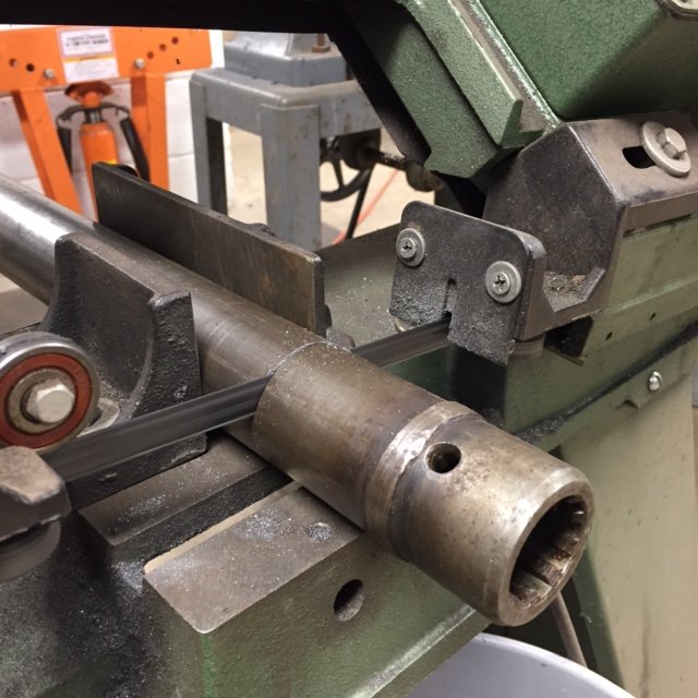

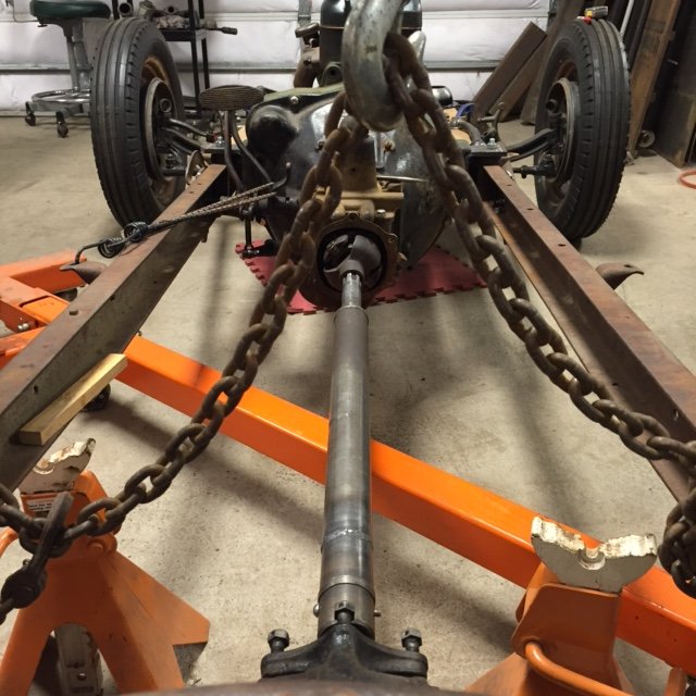

  17. With the transmission cleaned and bolted up it was time to sort the driveshaft. I had some tubing lying about that was close enough in diameter to aide in mockup and final measurements. I've never messed with a closed driveline before so I've been dreading this part!
    I also did a little bending on the shifter trying to figure out the seating position.
    Here we go...
    I've been preheating with the rosebud to get good penetration with the little welder. (And a heavy 'V' groove of course)
    And here it is back in place.
    gwhite, Stogy, bct and 3 others like this.

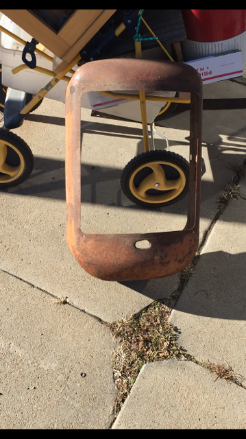

  30. Thanks everyone! So this is weird... After all that grille talk yesterday morning I went to run a few errands and when I happened by the antique store this was beckoning to me from the sidewalk! $35 later and it was mine.
    Now I know it's a tractor grille (Allis Chalmers from what I can tell?) but it reminded me a lot of this one...
    Before paint 1927
    So, while not exactly what I envisioned it could work with a little slicing and dicing? For $35 I certainly was not going to leave it behind, ha!
